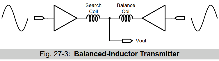

                            • Proximity methods -- frequency shift, loading, and off-resonance -- are inherently less sensitive than IB methods or PI. In the mid-late 70s A.H. Electronics and Gardiner tried to stay competitive with TR and TR-Disc but could barely keep up, and when VLF motion detectors arrived it was game over for them. However, there is another mono coil method that gives IB-like results:
                              Something similar was used in the Minelab Go-Find models.
