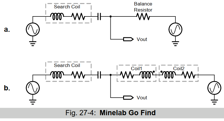

  • The gofind uses an impedance bridge strategy as a means of reducing noise and simplifying coil topology over balanced DD or OOO coils. .... it was hardly your state of the art detector when marketed though being sold in the sub $200 bracket.

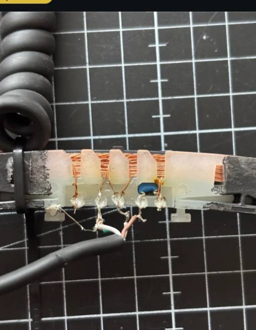

    Below is detail from the coil connection .... theres a cap across one of the coils ...RX maybe or is it in series ? ...
    The patent talks about impedance change and noise reduction but not really ground reduction / X cancellation.

    • I'm just suggesting the approach as a way to make an equivalent VLF detector with a mono coil. It otherwise has the same responses as an IB coil. The Go-Find version resonates the search coil and replaces the balancing coil with a resistor-equivalence by using matched anti-phase resonated coils, all stuffed into the coil housing.

        • Hi Carl,

          this is for sure a good KISS project destined for my software sanity project.
          Proposal a)
          This is like an LCR-measurement setup (Impedance measurement).
          Proposal b)
          This is more interesting as I can push more current to the TX coil. I like it.
          Coil1 and Coil2 should be realised as a variable inductance (screwable ferrite core inductor housing for both coils to match the search coil impedance).
          We can tap a TX reference signal on one side of the feed to make synchronous detection possible. Then the impedance change can be measured.
          I will try both versions to see the SNR and sensitivity. I like it due to mono coil design.
          Aziz
          • Hi all,
            the proposal a) is by far enough. Instead of balancing, the balance resistor is used to limit the coil current. I don't need the balancing as the signal won't be amplified further or to behave like an IB RX-Coil.
            The sensitivity is not bad for the simple mono coil design. But the coil needs absolutely good shielding. The phase shift is more stable (1/1000 degree stable) and sensitive than the amplitude change (slightly more noise).
            Aziz
