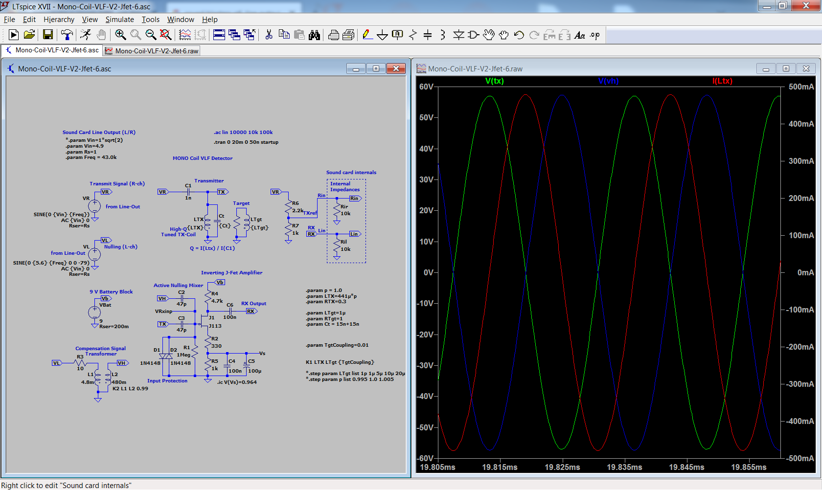

              • Hi Sergey,
                I was referring to my basic & simple solution. Your configuration differs too much from my.
                Below is the schematics I am referring to:
ID:	448697 Even the source coupling capactor C1 (1n) is quite high, it is degrading the Q down to approx. 30. Still enough to work with. I can push up to almost +/- 500 mA to the TX coil (with only 17 mA source current).
                The compensation mixer (C2 + C3) would attenuate the target response 50% and with input impedance R1 (1Meg) and base current of J1 would attenuate it slightly further.
                So the j-fet amplifier amplifies the difference signal and does the high input -> low output impedance conversion (Lin impedance approx. 10 kOhm). So the target signal isn't further attenuated.
                The sound card Sound BlasterX G6 is operated in the high-gain mode (delivering up to +/-6 V peak voltage).
                The signal transformer is 1:10 in this example.
                This shows only the basic concept. Fine tuning must be done yet.
                Aziz

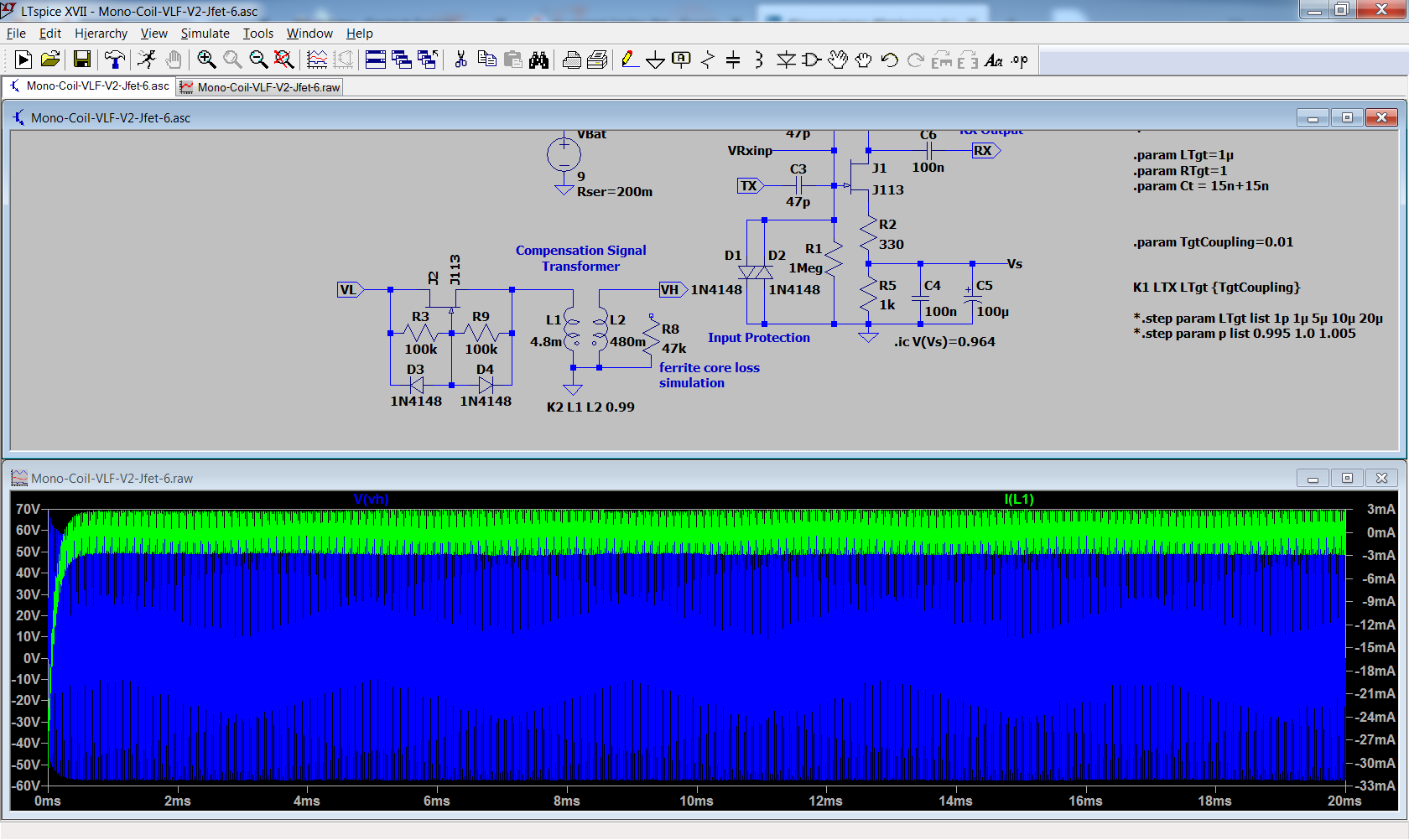

                • here is the LTspice file for your convenience, playing, tweaking, adapting & arranging ..
                  • BTW,
                    the Sound BlasterX G6 has an output current protection circuit built-in. That's the reason, why I have a high inductance primary coil for the signal transformer. On initial condition, the high current through the primary coil could trigger the current protection circuit. And the sound card switches totally off.
                    But there is a software work around. Start with 0 V output voltage and increase it steadily to the desired output voltage level during 5 - 10 seconds maybe. This should avoid the current protection triggering. And we could reduce the primary coil inductance at the end.
                    A series resistor R3 (10 Ohm) helps too. But it has also a damping function to the signal transformer transfer characteristic.
                    Aziz

                      • Hi all,
                        I have found a ferrite ring core (Do=26 mm, Di=14.5 mm, H=20 mm) to try the step up signal transformer.
                        I don't know the core material anymore. But the AL is approx. 12000 nH/N². Could be a bad core material with high losses. I don't know.
                        I have to build a nice tool to wind the secondary windings on the ring core. It is difficult to wind up to 100 or more turns on the ring core. The secondary windings will be partitioned into several sections to lower the parasitic coil capacitance.
                        I will try to keep well below the resonant frequency (load capacitance C2 + inductance of the secondary coil winding of the signal transformer forms an LC resonant circuit).
                        At resonant frequency, there would be much much more compensation voltage generated. Ring core losses at resonant frequency could cause heavy temperature drifts too.
                        Let's try the save region first and look at the temperature drift. Could be a knock-out issue.
                        Aziz
