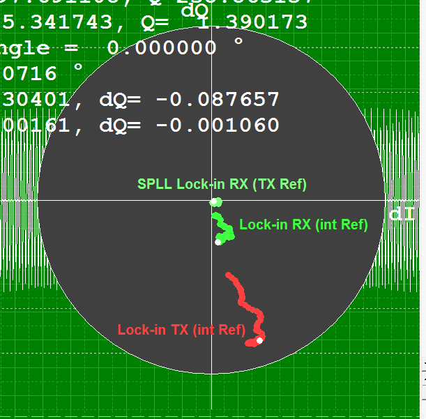

    • Hi all,
      this is the best proof of concept of SPLL I/Q demodulation. I am observing "worms" now and looking where they go.
      The SPLL Lock-in demodulation delivers a much more stable (low drift) and low noise output.
      Whereas the other Lock-in demodulations of TX and RX with an internal reference signal (software) have large drift and noise outputs.
      Look at the "worms" now:
      Cheers

        • Hi Marcel,
          Originally posted by Marchel View Post
          It looks very good, would it work even if I only have the demodulated signals pI and pQ ? or are pTX and pRX also needed.
          pTX is the reference signal out of the transmit coil signal (tapped with capacitive voltage divider)
          pRX is the receive signal out of the receive coil
          To demodulate I and Q of the RX signal, we need the TX reference signal. The software PLL creates internally a clean and normalized sine and cosine reference, which is locked in into the TX signal for the RX Lock-in demodulation.
          The comparison above shows the demodulated I/Q changes.
          Two demodulated signals (RX=green and TXref=red) use an internaly digital generated demodulation signals (sine/cosine) for the Lock-in demodulation.
          The light green is the software PLL demodulated Lock-in output.

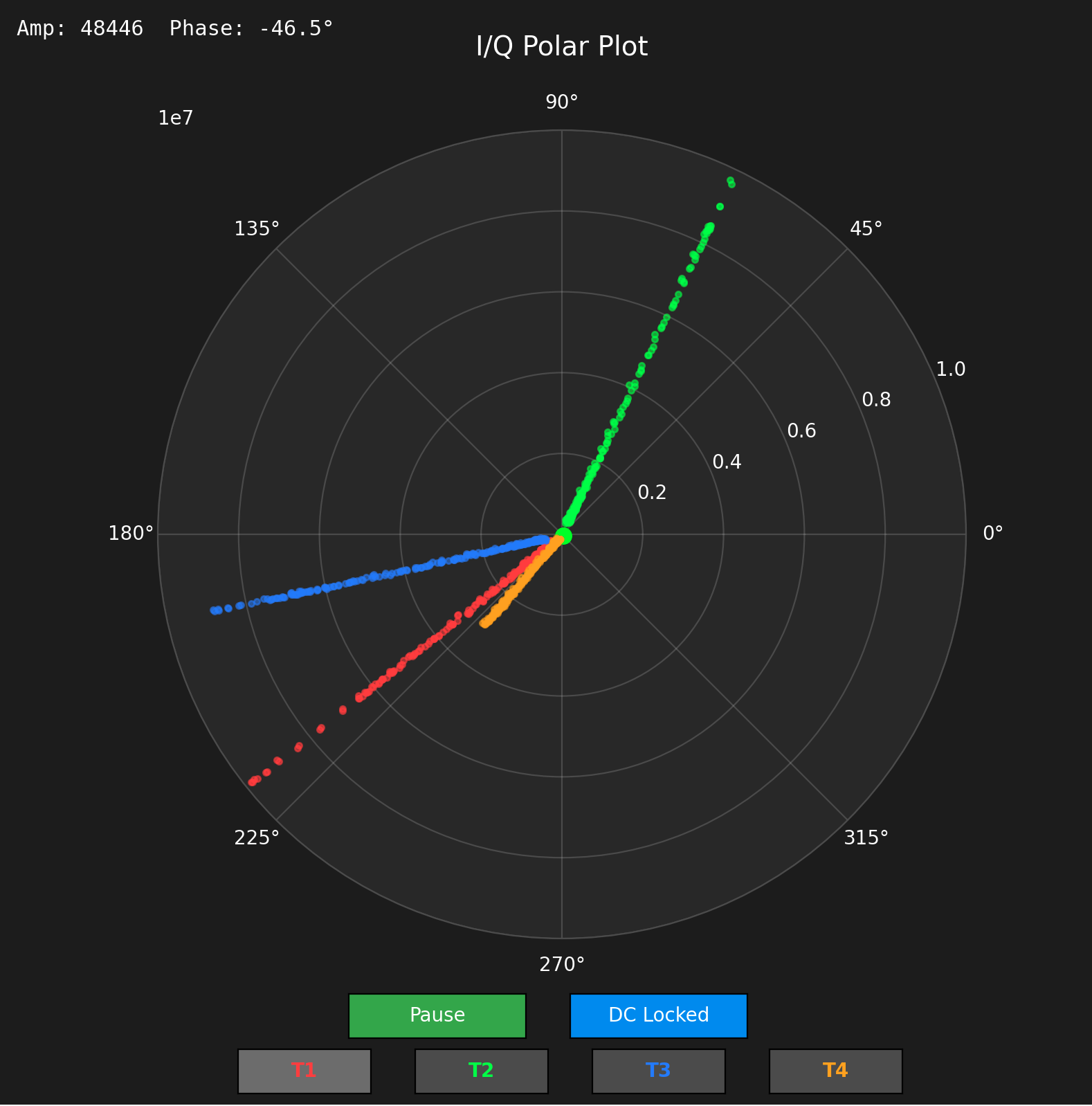

                Mate if you are getting worms ... you need to go see a doctor :rotfl.
                The IQ display should be rock solid with no worms.
                Below is what I get out of the h743 board in real time from real targets.
                The green vector is a ferrite target.
                The blue vector is a 10x10 cm foil.
                The red vector is a 5 x 5 cm copper pcb.
                The gold vector ... is a gold ring.
                The only thing I have not done is normalise the phase ( ie I am just using whatever phase the TX is set at ) .....
                The scale is set at 1e7 that is one part in 10 million ... so our sensitivity is around 100 - 150 nanovolts.
                The display is generated by a python script that takes the captured IQ samples and sends them to the PC via the USB interface that is built into the H743 chip.
