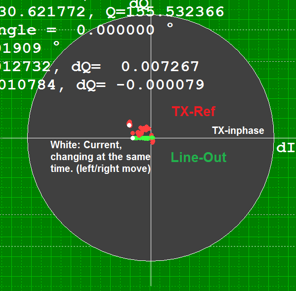

    I have visualised the changes of both Lock-in demodulator channels and watched them real-time in the dIQ plane without making a linear regression model. My eyes are making the linear regression model in real-time.
    The TXref in-phase noise does correlate with the line output noise of the sound card.
    The quadrature-phase noise does not. I don't see any relationship yet.
    So the line output noise on the transmit frequency can be modelled and eliminated to some extend only.
    All the issues won't be there, if we would have an external clean and pure digital clock signal for the transmitter.
    The PLL/clock generators of the sound card does produce too much noise.
    Aziz
    • This is the visualisation of both dIQ channels. White dots are the current measurements. Green is the line out channel change. Red is the TXref channel change (mono coil TX signal).
      You see, that there is almost a free lunch there. Maybe a small snack.
      Aziz
      • Hi all,
        how to interpret the in-phase line out noise?
        The in-phase line out noise is the fluctuation of the line output amplitude.
        Whereas the quadrature-phase noise is the dominating EMI noise picked up by the TX-coil. This has a Gaussion (White) noise nature and can't be predicted with linear regression models. It all makes sense.
        So this analysis wasn't for nothing.
        We can improve the SNR in mono coil VLF and IB-Coil VLF configurations now. Both configurations must have two demodulators/channels (TXinp/TXref, TX/RX).
        I can focus to the high power High-Q IB-VLF soon.
        Aziz
