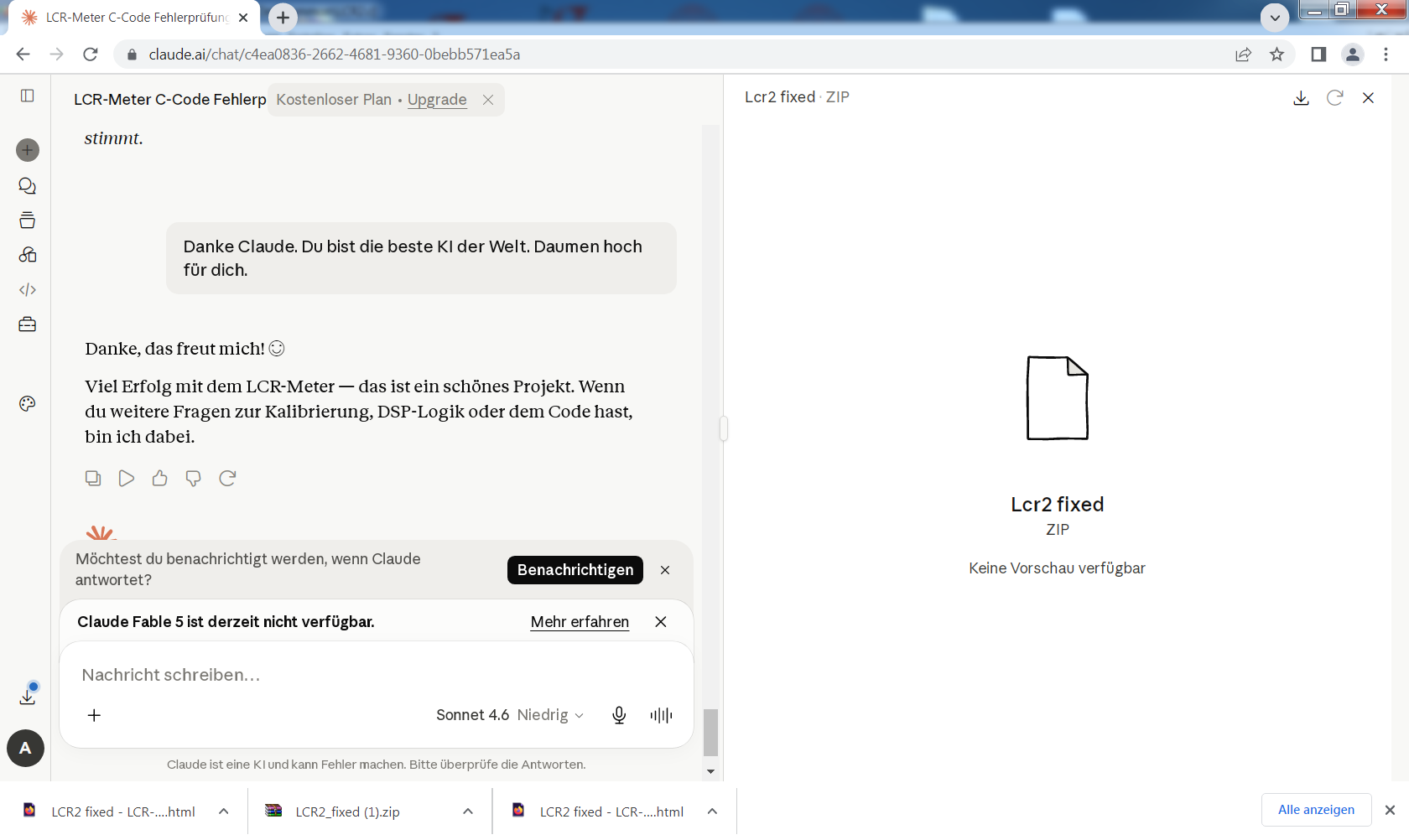

    well, I can work with Claude Code with minimum settings (low effort mode).
    It is better than waiting and not getting any answer.
    It fixed the LCR meter code for me finally.

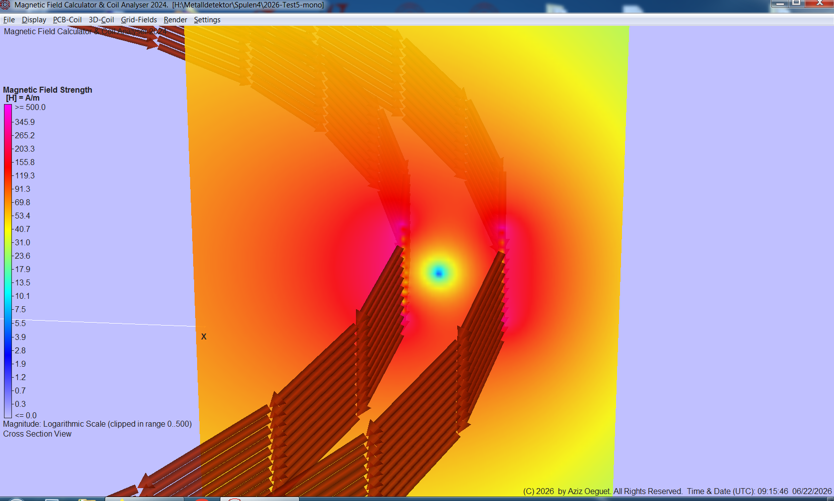

            • Hi all,
              where to place all the capacitors in the coil housing of the mono coil VLF?
              A place, where the magnetic field is quite low would be optimal.
              There is one good possible solution. Two solenoids connected in series, as basket weave winding to lower the coil capacitance a bit.
              Approximately in the middle of the two solenoids (slightly nearer to the inner solenoid) is a good place, where the magnetic field gets cancelled.
              Along the ring of low magnetic field, this is a good place to put all the capacitors.
              This picture shows, where it could be:
              Click image for larger version  Name:	Mono-Coil-VLF-where-to-place-the-Capacitors.png Views:	0 Size:	430.7 KB ID:	449884
              Aziz

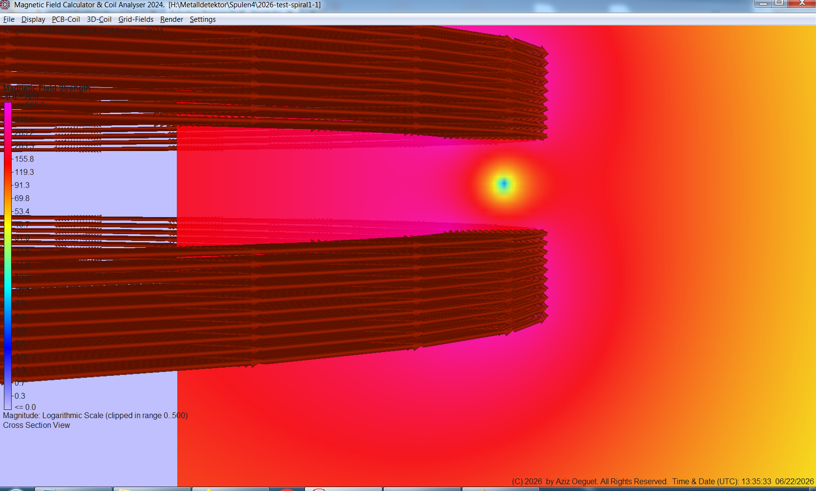

              • Hi all,
                what about my ribbon cable mono coil? Where to place the capacitors?
                Ribbon cables can't be wound arbitrary. Best to do it as a spiral wound, which isn't best solution for coil capacitance. This isn't critical if operated in VLF mode however.
                We have to divide the mono coil in two spiral coil parts, connected in series.
                In my example below, I use a 10 core ribbon cable. All cores are connected parallel to lower the coil resistance.
                I have taken 16 turns for the lower coil half and 16 turns for the upper coil half in my coil simulation. The mono coil consists of total 32 turns.
                As you can see, between the coil halves, there is a minimum of magnetic field region. At this place (as a ring), the capacitors can be placed.
                Of course, we could take two different coil radius halves too. Let's look at it next time.
                Aziz

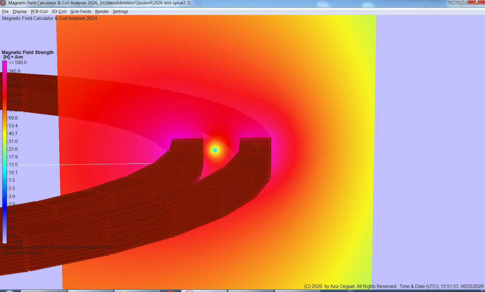

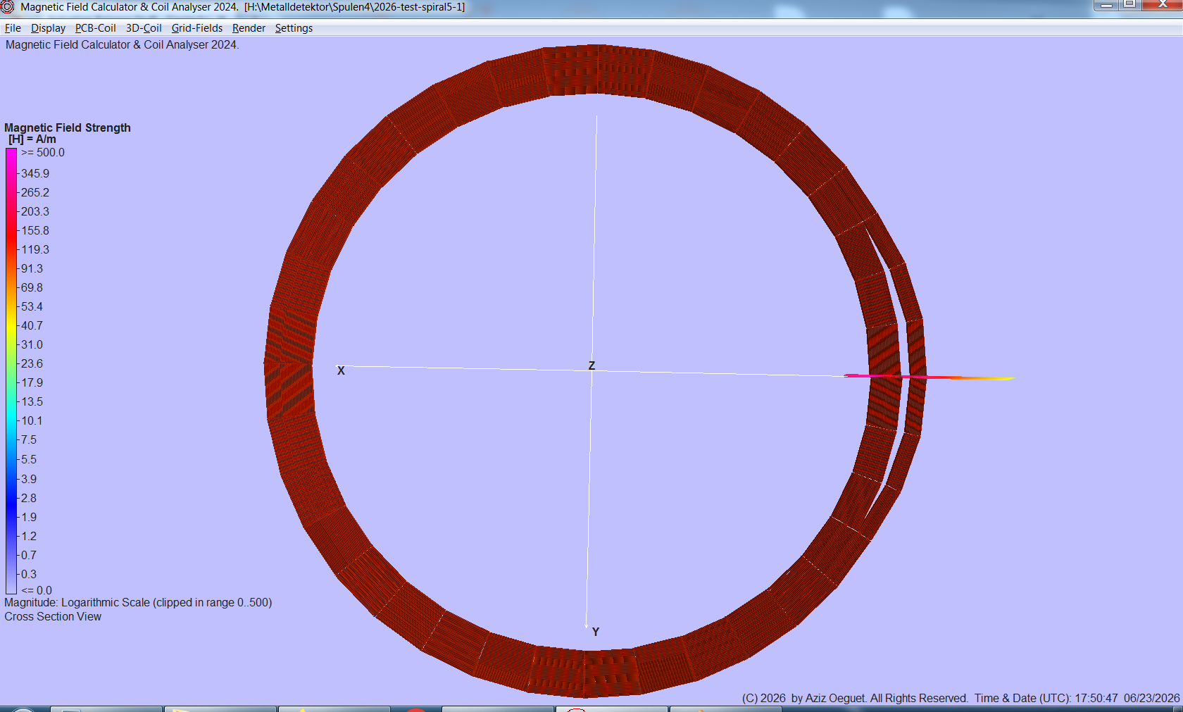

                • This is the gap between the coil winding bundles with the ribbon cable mono coil.

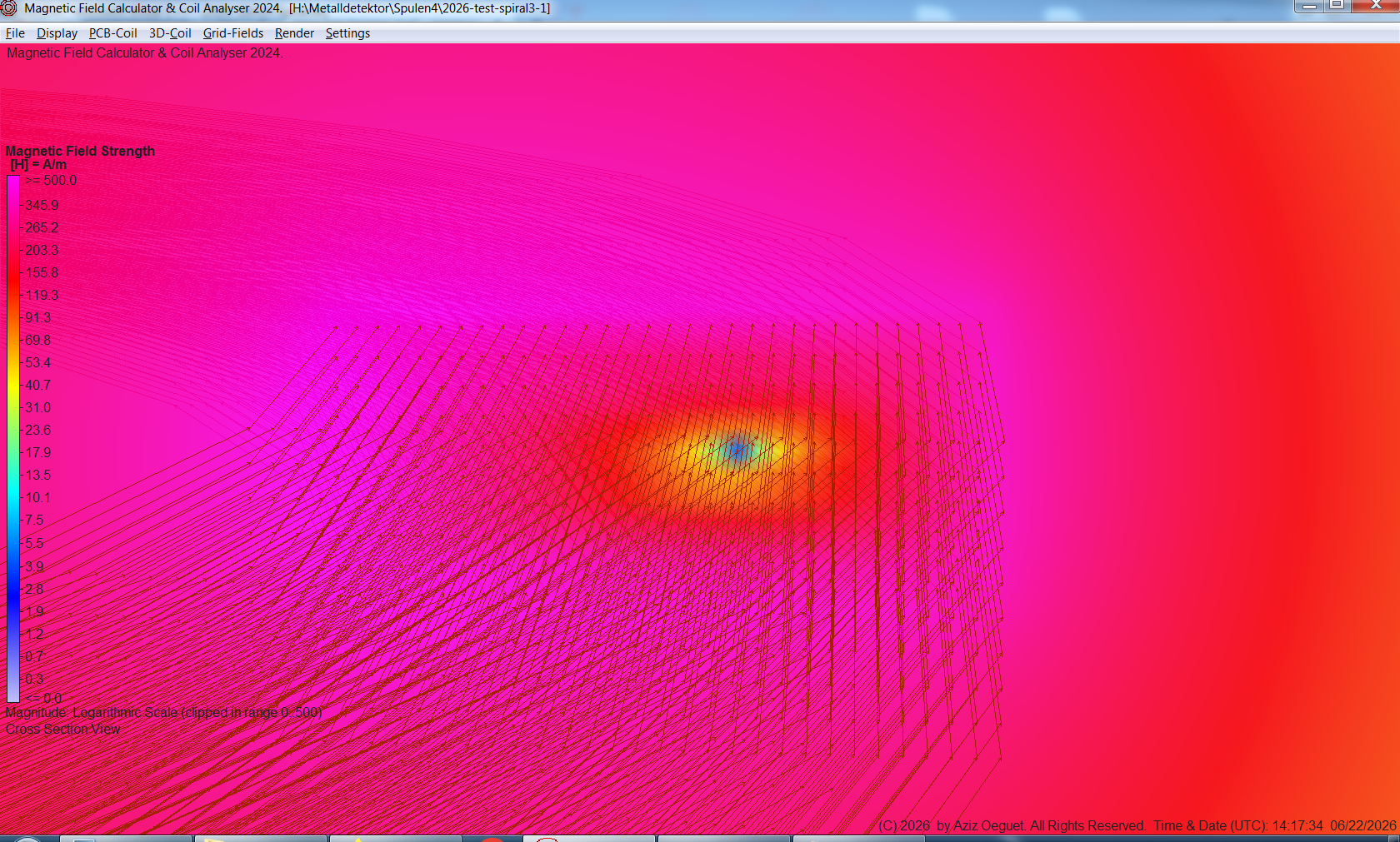

                  • Now there is a magic trick, where we can leave a gap region to place the capacitors. This region is limitted to the whole capacitors volume space. In other regions, there won't be any gap.
                    To show this, I have changed the wires to single line wire model. So you can see, where the region is.
                    It is approx. 1/3 of the bundle width from the outside of the coil. A limitted gap region of let's say 1.5 cm (radial) x 4 cm (circumference) should be enough.
                    The coil will be wound around the gap regions, if this reached.
                    Is this novel?
                    A limitted gap region within a coil bundle to place the capacitors? Or other parts?

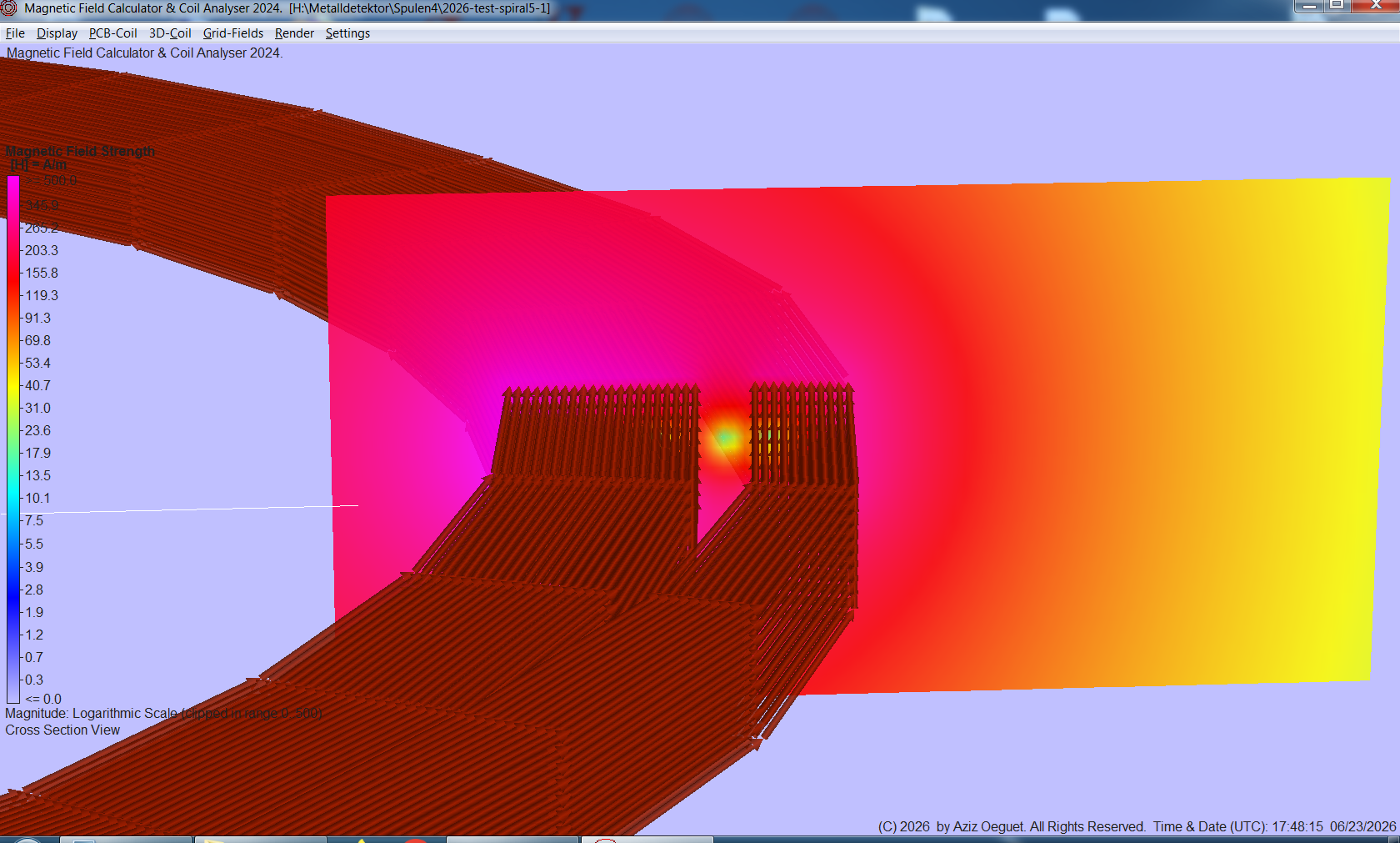

                      • Hi all,
                        we have finally found an elegant way to "hide" all the capacitors even in inside a thick mono coil bundle made of plain standard ribbon cable. And the capacitors will be nicely shielded with the whole coil bundle too. Yes, the capacitors needs to be shielded as well. And the ribbon cable acts like a true HF litz wire (parallel 10 or more stranded individual wires).
                        I will leave a small stripe of gap between 1/2 to 2/3 of the coil bundle width during winding the mono coil and place all the hard wired capacitors there then.
                        Two thin and shielded stereo earphone cables going from the detector coil directly into the sound card. They can be really thin and flexible. They won't bear significant power (µPower).
                        I have to look, how much ribbon cable I can use for the mono coil and I have to solder them together, to get a 30 - 40 m long ribbon cable. Enough for a mono coil.
                        Aziz

                              • Hi all,
                                this is what I mean with limitted gap region in the coil bundle for the capacitors.
                                Top-View:
                                You can see, that the other regions don't have a gap in the coil bundle. It is as large as necessary to place the capacitors there. + same gap to the windings is required (2 mm).
                                Cross-Section:
                                2/3 bundle width for the inner windings
                                +gap for the capacitors
                                1/3 bundle with for the outer windings
                                Cheers
