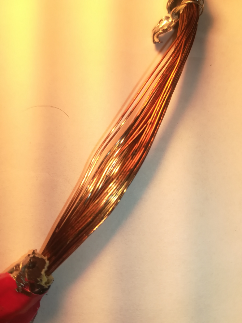

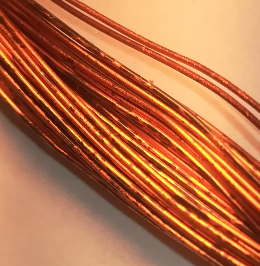

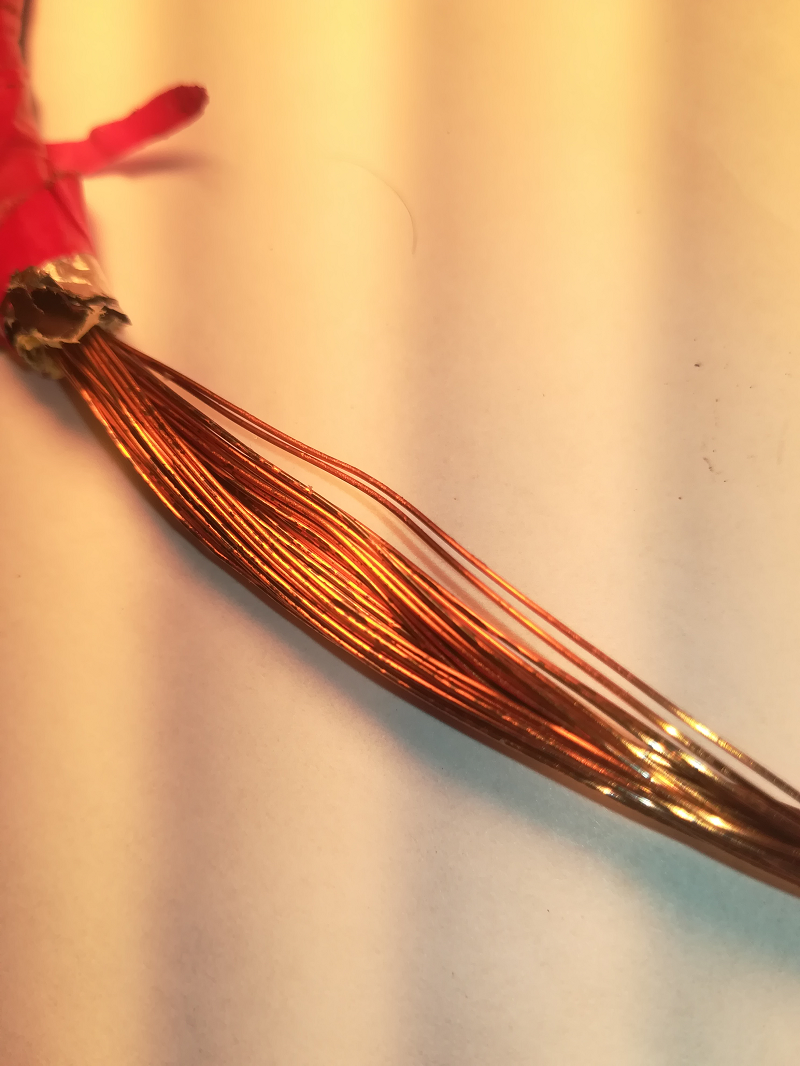

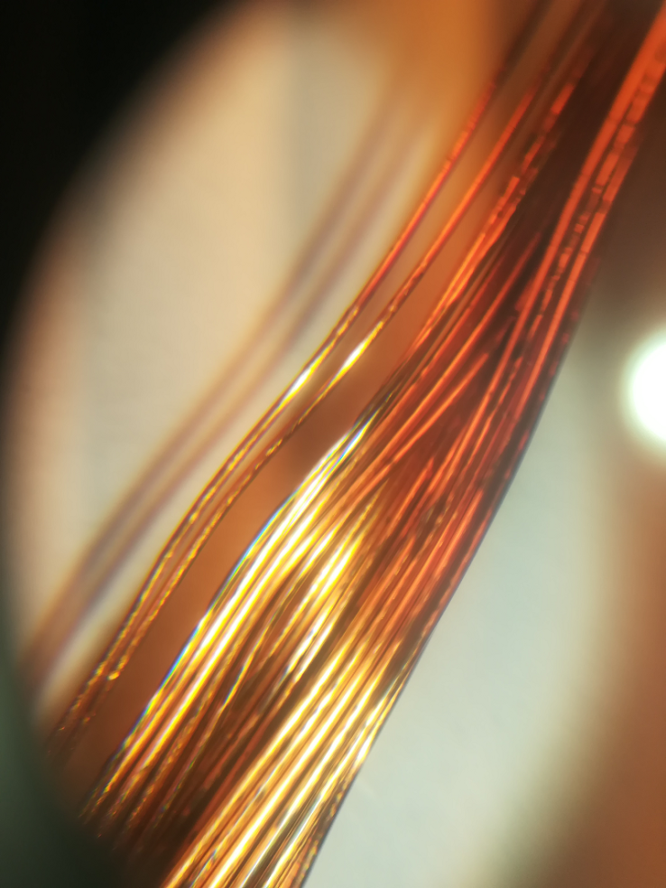

                      • #56
                        Hi all,
                        OMG, this is the outcome of the big hammer. I have hit something.
                        Bzzzzzt, puff, smoke. No joke this time.
                        I spent at least two hours searching for the reason. I didn't find. The test board is alive. The mosfet is alive. Everythings seems to work. But still not transmitting. Something smells burnt and the mosfet is getting hot. It shouldn't get hot.
                        Well, Murphy's Law has struck again.​
                        Finally, I checked the tune capacitor Ct1 and the TX coil.
                        There we have. My transmit coil has burned out. It has now something around 5 µH and 0.3 Ohm now (it should have 1.1 mH and 4 Ohms).
                        And why the hell was my transmitter so noisy?
                        I have finally disassembled my old TX coil. Fck! Enamelled copper wire (0.5 mm). Looking very strange! What happened to the enamel coating?
                        Look:
                        Click image for larger version  Name:	Coilwires1zoom.png Views:	0 Size:	989.3 KB ID:	444646
                        Every dark region had a fine and destructive spark over the time using high flyback voltages (200 .. 500 V). Dark regions had been corroded over time.
                        The last spark welded an interwire connection and shorted internally the coil finally. Somewhere.
                        There must be 1000' of little sparks. Even much much more.
                        And this is the reason for, why my transmitter was so noisy during the recent tests.
                        This was my next task to search for noisy sources. It's done now.
                        I need to wind a new TX coil. I need a wire, which can withstand the high voltage (600 V) and high current rate.
                        I am looking for coated tinned litz wire. AWG 16 or thicker (AWG 14).
                        There are more pictures in this post. Have a look and think of wires for coils.
                        Cheers
