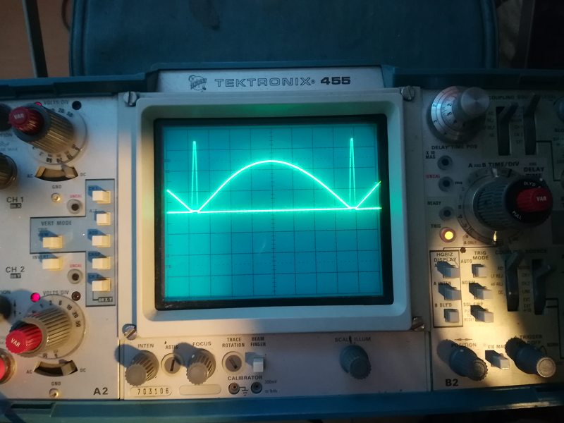

    Hi all,
    now the promissed pics and proof of work. It is a messy work at the moment however.
    Look, I have reached the optimum operating point.
    Click image for larger version  Name:	TEM2-Scope.png Views:	0 Size:	688.2 KB ID:	444691
    The flyback voltage is approx. 340 V, the Vc node at approx. 14 V. I have operated the TEM2 transmitter with another battery source (6*1.2 V) during searching for the issues.

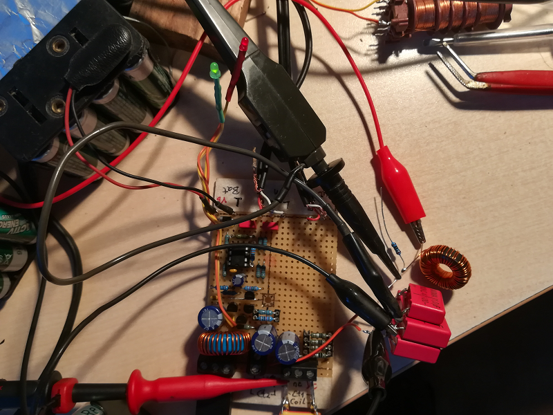

    What a mess!
    Click image for larger version  Name:	TEM2-Test-board1.png Views:	0 Size:	876.2 KB ID:	444692

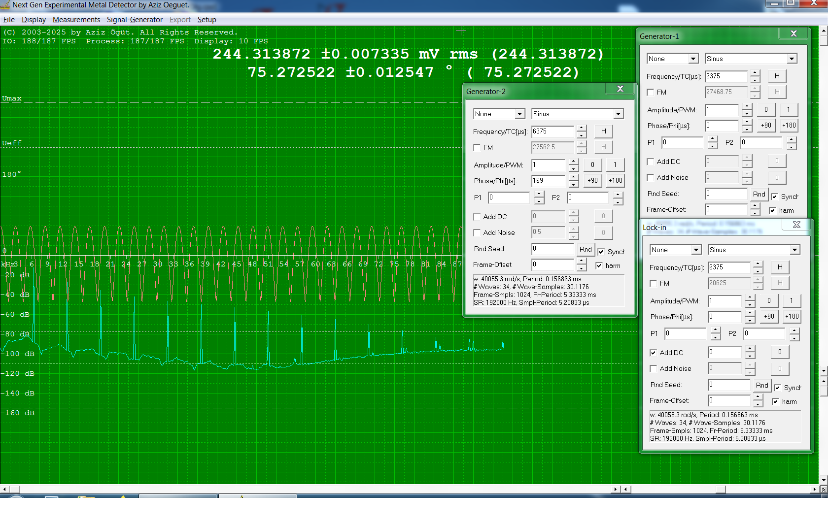

    And the FFT spectrum of the TXref output:
    Click image for larger version  Name:	TEM2-FFT.png Views:	0 Size:	208.0 KB ID:	444690
    Well, the SNR (signal-to-noise ratio) is approx. 75 dB. Could be better. It is still noisy.
    The choke L1 on the bread board is disabled.

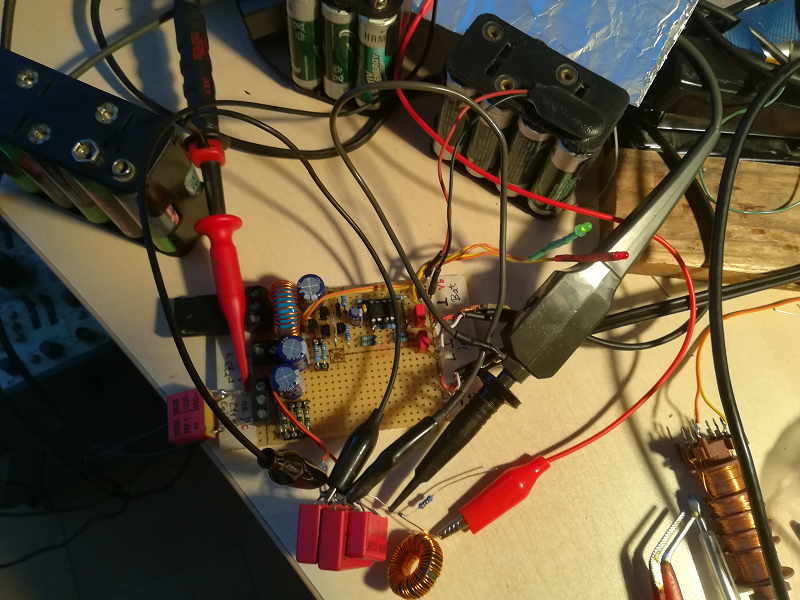

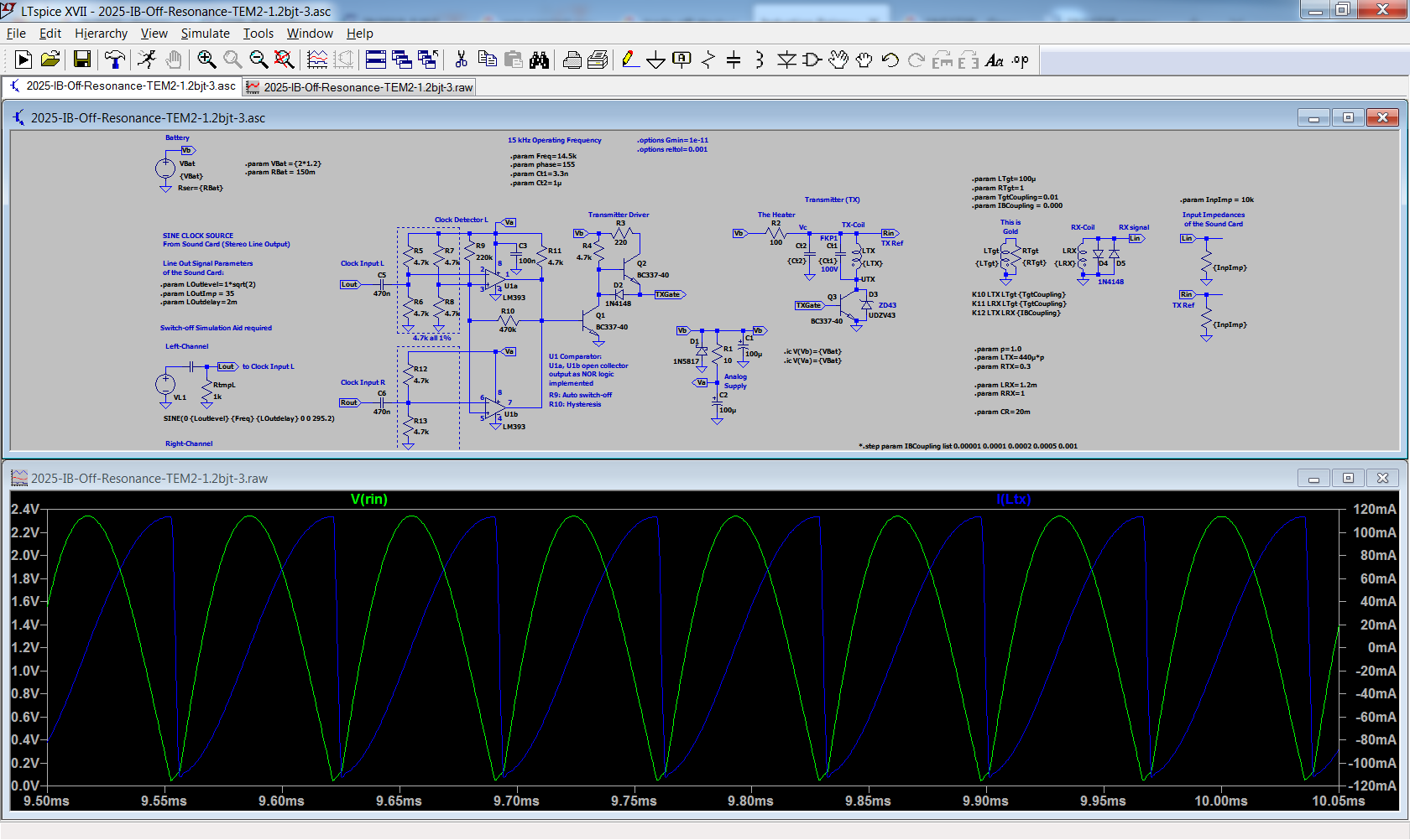

            Look,
            the circuit simplifies a bit. This is the simple low voltage BJT version, limitting the flyback voltage below the break-down voltage of the transmit transistor (BC337-40). The TX-coil current will swing between approx. +100 and -100 mA. The TXref signal between 0 and 2.3 V. Enough to feed it into the sound card input.
            Operating voltage 2*1.2 V, 43 mW power consumption, 18 mA battery current. Max flyback voltage is 40 V.
            This is a nice circuit. Ready to burn out some parts?
            Click image for larger version  Name:	Off-Resonance-TEM2-BJT1.png Views:	0 Size:	152.8 KB ID:	444711 Cheers
            PS: There is no choke anymore. The heater resistor has taken the job for.
