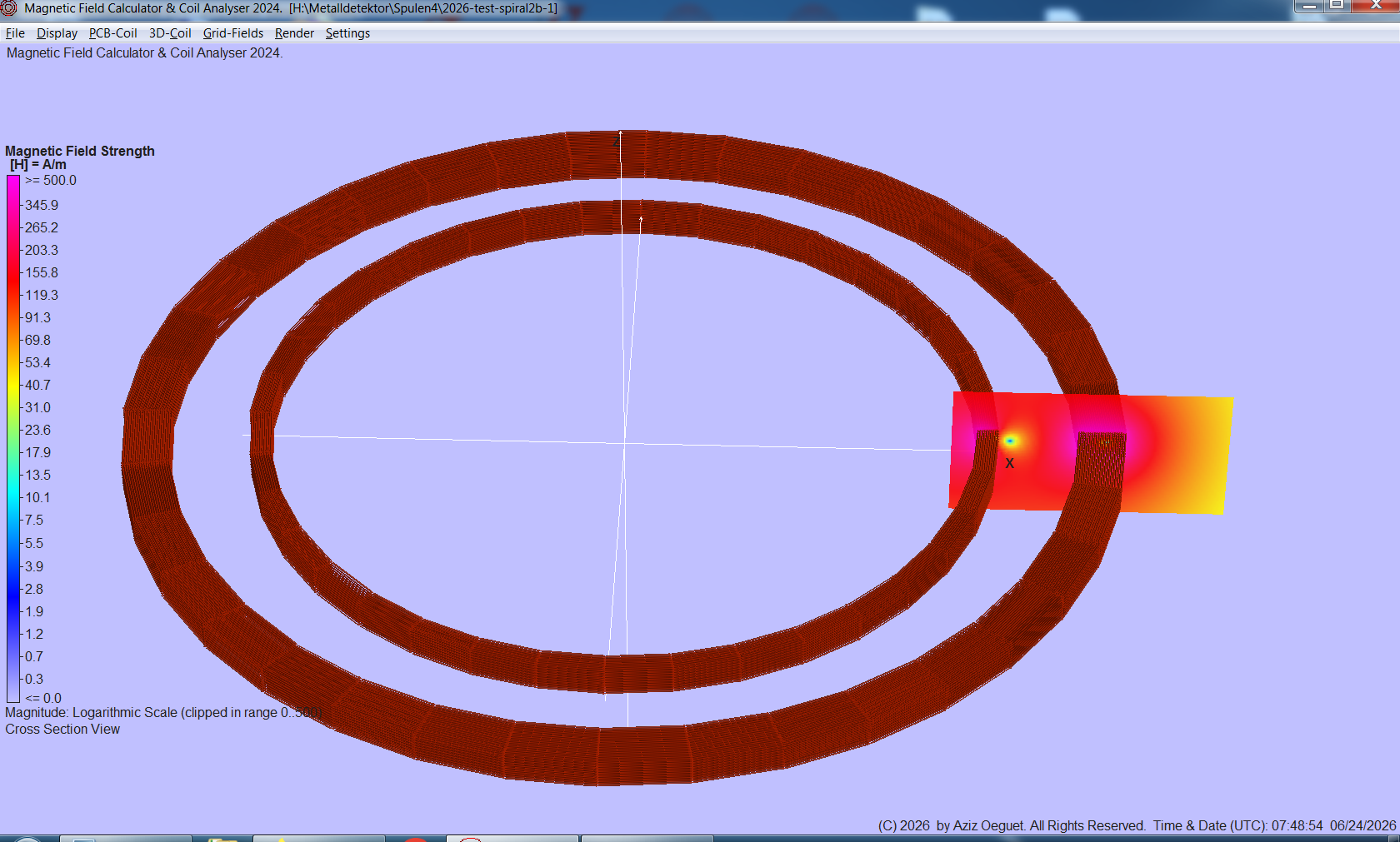

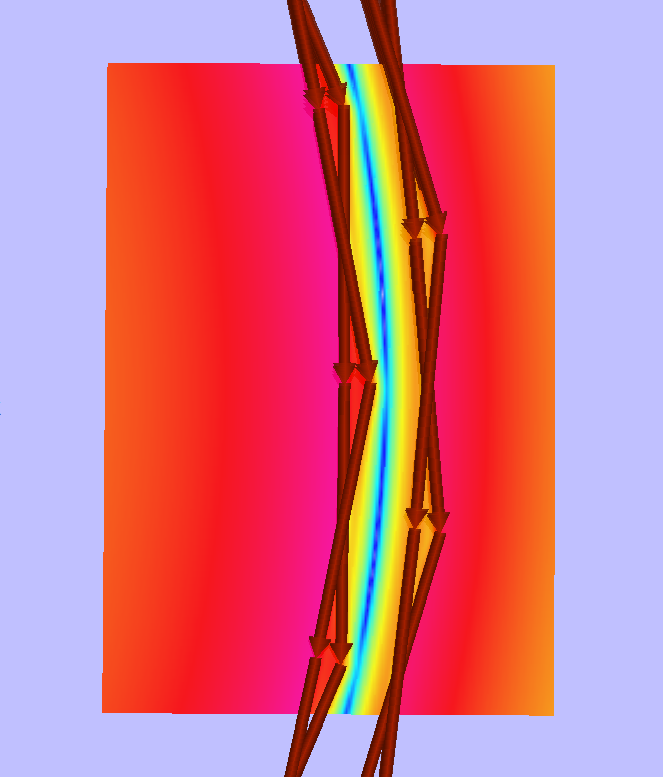

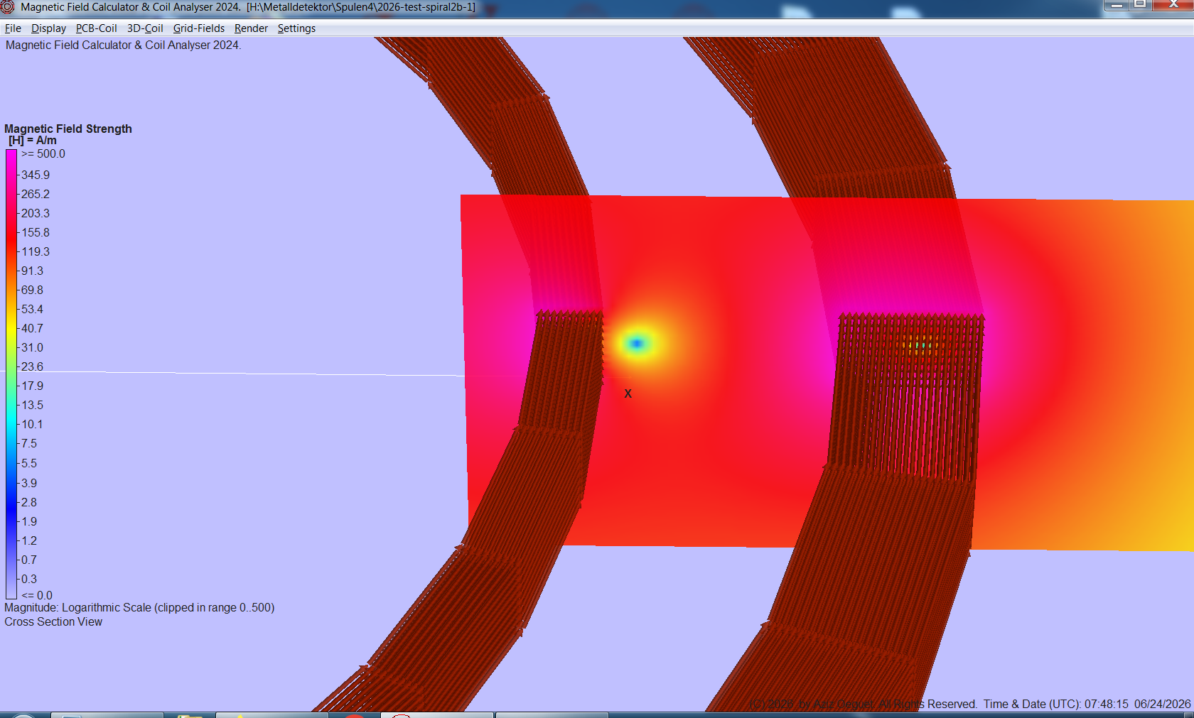

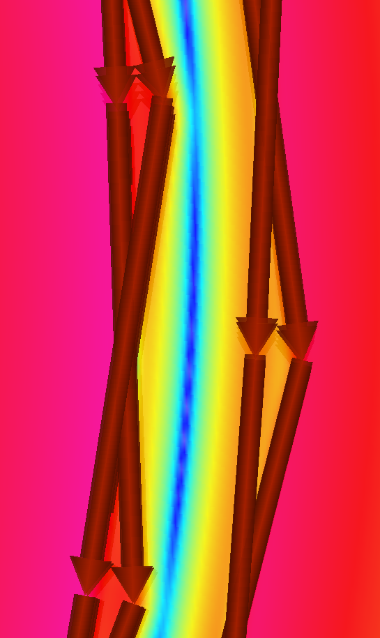

    splitting the big mono coil into two different concentric co-planar halves makes also sense. It is a combination of a small and large coil, so sensitive to small and sensitive to big targets. A compromise for different reasons.
    I have put 1/3 total turns count for the inner coil half and 2/3 total turns count for the outer coil half. The bigger coil dominates.
    The total mono coil acts like a mono coil of diameter D using the geometric mean formula:
    D = sqrt( (1*D1/3) * (2*D2/3) ), where
    D1 is the mean diameter of the inner coil,
    D2 is the mean diameter of the outer coil,
    The null-zone (B=0) is easier to access for soldering the coil connectors and capacitors. This is the only reason for making such a mono coil. A compromise of all.

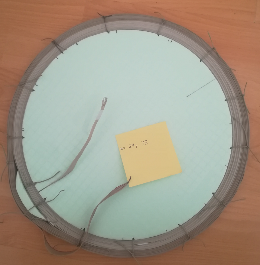

                • Hi all,
                  this is my first test attempt on winding the ribbon cable mono coil with gap. I have used 34.2 m (so it wasn't 35 m).
                  Inner diameter 30 cm. Total N=33 turns count. And there is even enough gap space left for bigger capacitors (the fallback option).
                  It is very easy to wind such a coil.
                  Aziz
                  • Oh well,
                    I can't use the ribbon cable mono coil. The proximity effect will degrade the Q of the LC tank heavily. Although the skin effect is reduced, the proximity effect dominates here. Very very much.
                    fuck!
                    I can even measure it's effects on inductance change and ESR of the coil.
                    Weave it (making a weaved ribbon cable) or using a true HF litz wire?
                    Weaving would take a lot of time as I would separate each strands and weave it by hand, that every strand changes its position across the geometric position evenly. Every 2-3 cm.
                    This is the art of weaving carpet science. Really.
                    Aziz

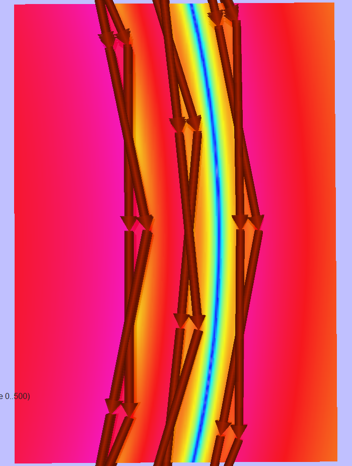

                        • Hi all,
                          I have been looking for optimal place for the capacitors in a two row basket weave mono coil.
                          The mono coil with lowest capacitance and low proximity effect.
                          If I take the number of turns for the inner coil (N1) 0.866 times lower than for the outer coil, the zero-zone (B=0) is in the middle of the large gap area.
                          There is even enough space for bigger capacitors.
                          The outer coil will have more turns (N2) and this is good: more depth.
                          The cross-over points are interleaved to reduce coil capacitance further.
                          N1 = 0.866*N2
                          BTW, sqrt(3) / 2 = 0.866 (rounded). It is a good harmonic formula. Google AI found this for me for my initial 0.8 and 0.85 value.
                          Cheers
                          • Oops,
                            my fault. Looked at wrong figures.
                            N2 = 0.866*N1.
                            The outer coil will be slightly lower turns count. This is bad.
                            • Now for a three row basket weave mono coil with N1, N2 (N1=N2) and N3 turns count:
                              N1 = 0.866*N3
                              N2 = 0.866*N3
                              This time N3 > N1, N2. This is good.
                              The B=0 zone is approximately (averaged over the large gap area) in the middle.
