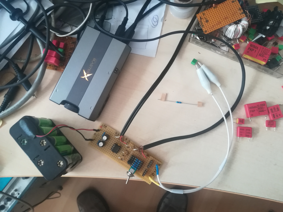

                • Hi all,
                  I have added j-fet buffers to the LCR breadboard. It is using a very simple rail-splitter for power supply. It works.
                  I can measure D, Q, ESR much more accurate now.
                  It is still critical for low value capacitors (< 1nF) : This breadboard is not convenient to achieve more accuracy for D, Q and ESR measurements.

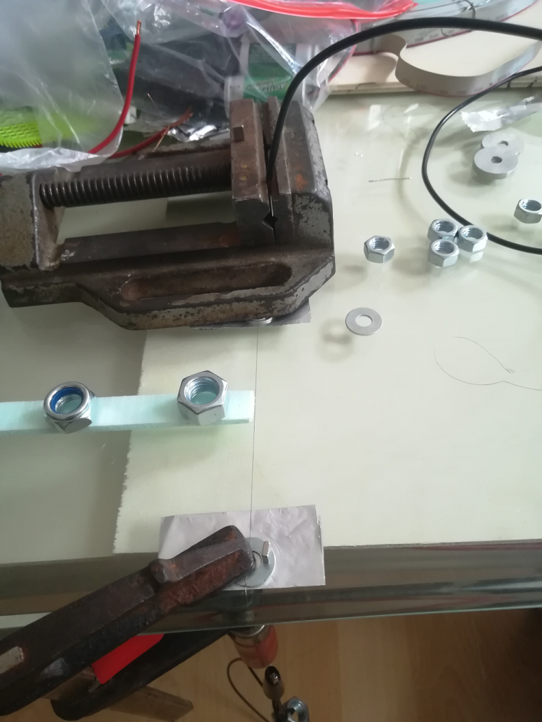

                          • Hi all,
                            I haven't found any convenient distance spacer stripes for my ribbon mono coil yet.
                            This frustration has been ended up with topping McGyver.
                            So I have built yet another precision XPS cutter system with thin copper wire for hot wire cutting. The cutting process optimization took a while.
                            I have now enough 1 mm thick and 13 mm wide XPS distance spacer stripes. Cut from a 5 mm thick XPS sheet.
                            The ribbon mono coil will be rewinded soon. I hope, there is enough wire for 20 + 10 turns. The distance spacer eats more wire length.
                            Aziz

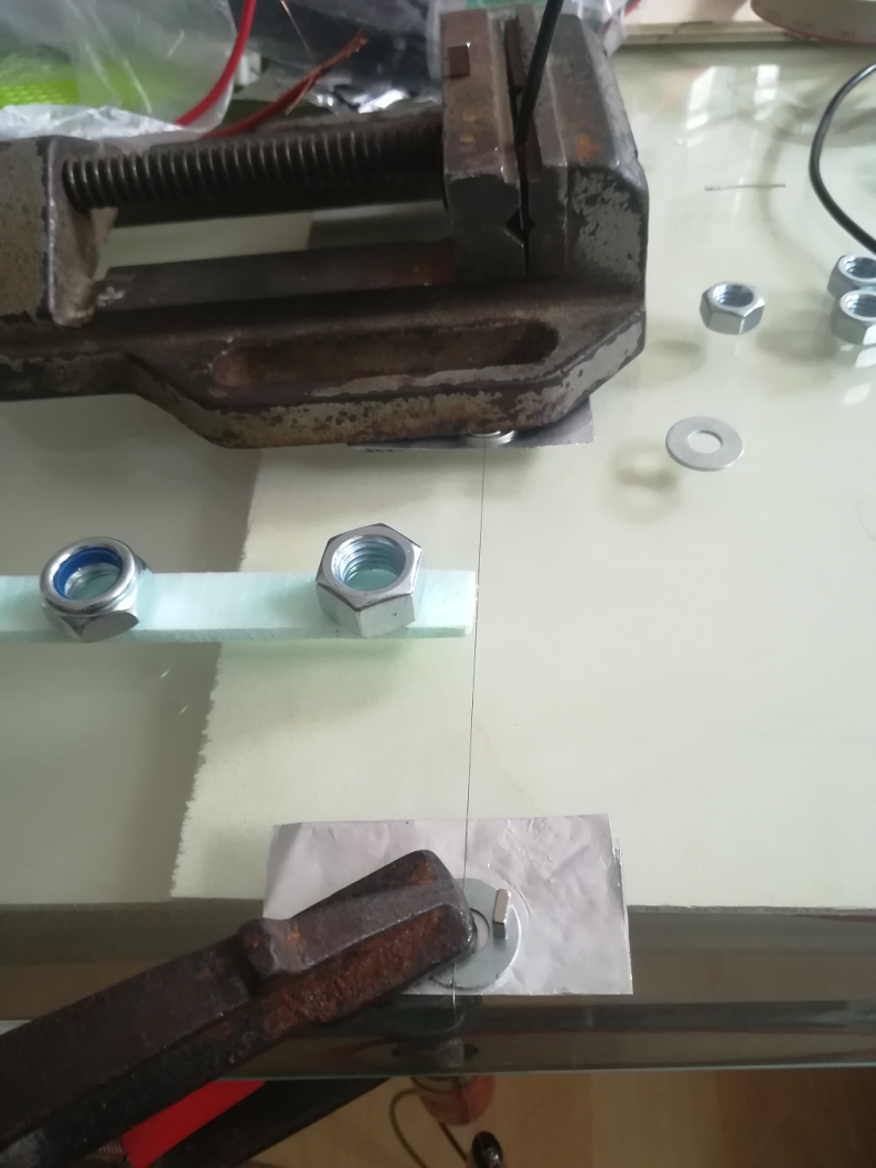

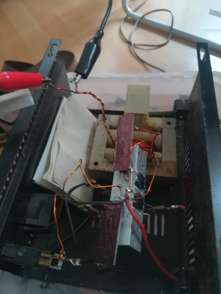

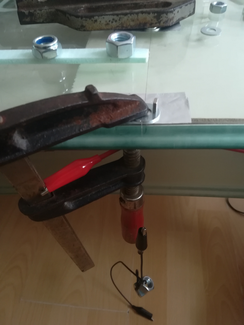

                            • This is my XPS cutter system Version 2.
                              I had to modify my old car battery charger. I have wound additional secondary coil windings to the power transformer. 1 Vrms and 3 Vrms AC power.
                              The 1 Vrms winding worked well. 3 Vrms was to much and the cutting wire corroded and ripped off quickly.
                              Power lines are kept very low resistance (thick wire). So the total energy will be dissipated in the thin cutting wire. No power resistors were used.
                              If you don't have constantan wire (heating wire), this version works very well.
                              The thin tinned cutting wire is out of a small piece of single strand AWG 28 ribbon cable.
                              Don't invent the wheel once again. This precision XPS cutting system works very well.
                              It is kind of MacGyver invention.
                              Aziz
