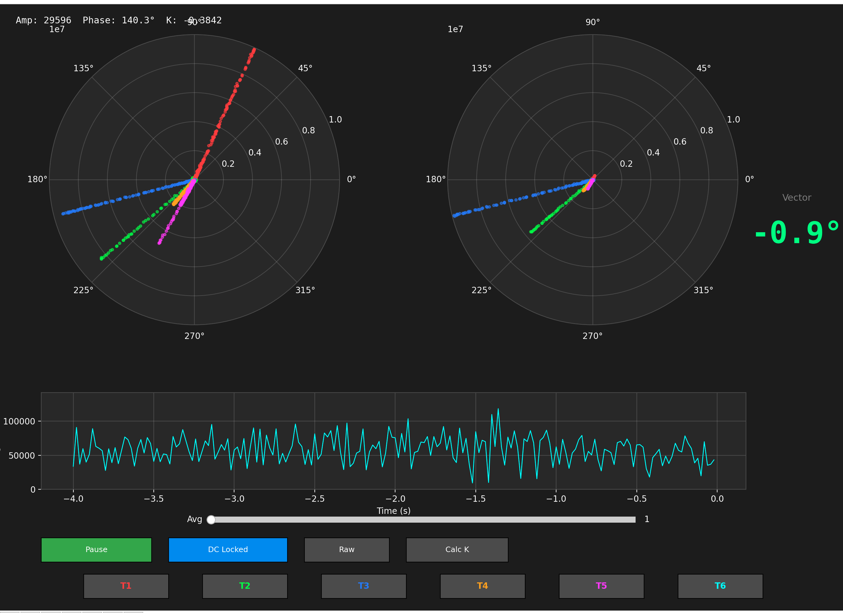

  • Originally posted by Marchel View Post
    I have a coil for a Minelab Vanquish that uses a square wave signal.
    The CC coil drives a semiresonant coil. The CC is required to boost the TX current. If you just use a purely resonant coil ... its a big mistake - you've lost your reference.
    • Below is the ground balance in operation.
      The polar plot on the left shows the target responses ( this real live data from the detector ).
      The T buttons allow me to save the responses.
      The polar plot on the right shows the IGB ( instant ground balance ) applied to the same data.
      Yup there is no free lunch ... you lose some target strength ( esp the silver ring purple trace ... because it is almost in the same angular plane as the ferrous ground )
      However the ground is almost knocked down to zero ( right plot )
      Of course this is only one frequency ... and we are only using 15% of the H7 CPU cycles. :-)

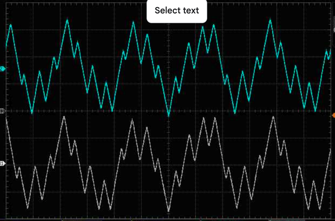

          The TX circuit is based on the XP Deus 2 FMF coil and their coil works well and achieves very good results so I think it will work well.
          XP DEUS II transmit waveform ... looks kind weird. Unless you have their algorithm life will be difficult. What we can say is that thier coil is not resonant.
