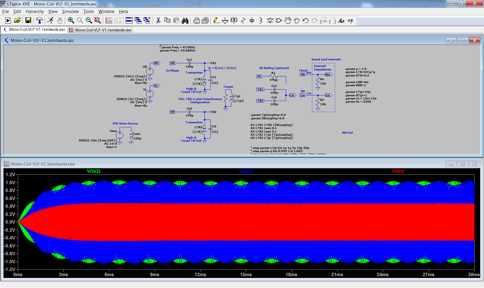

          I'm going to test the world's first dual-resonant high-Q IB-anti-interference (AI) TX VLF gizmo. Both TX coils are in AI configuration and would cancel the induced EMI noise.
          Both TX have high-Q and very narrow bandwidth (-> very low noise EMI picking). The AI configuration gives the EMI noise on the transmit frequency the rest.
          It has a big coil searching area too (OO or DD IB coil configuration). Both TX coils are acting like a receive coil.
          This is, what I mean:
          I have injected a large EMI signal into the TX coils inductively. Both are nulled after they have been added together (Lin is free of EMI noise).
          SPLL can decode the Lin signal with reference TX signal.

                      • Hi all,
                        regarding the two TX anti-interference coil configuration:
                        We can work with some mutual inductance coil coupling. So they don't to be in induction balanced position. It has the benefit that the identical TX coils can be placed on the same plane (not overlapping). Two D-type formed flat spirally wound TX coils, wound in the same coil former.
                        Critical part is matching the two resonant LC tanks to the same frequency (the product of each L*C must be same). As we can not change the inductances of the TX coils, we have to do it with appropriate pairs of selected and matched capacitors connected parallel. Or with a trimmer capacitor (not appropriate, expensive, low capacitance values). The coupling capacitors need to be matched as well.
                        Can we achive 1% accuracy of the TX coil inductances? I don't know yet. We have to try it out.
                        Can we achive 1% accuracy of the capacitors? Probably yes, if we have lot's of capacitors for finding best matches.
                        Can we achive an EMI noise rejection of 40+ dB? Very difficult. We have to try it out.
                        This is a very challenging difficult task.

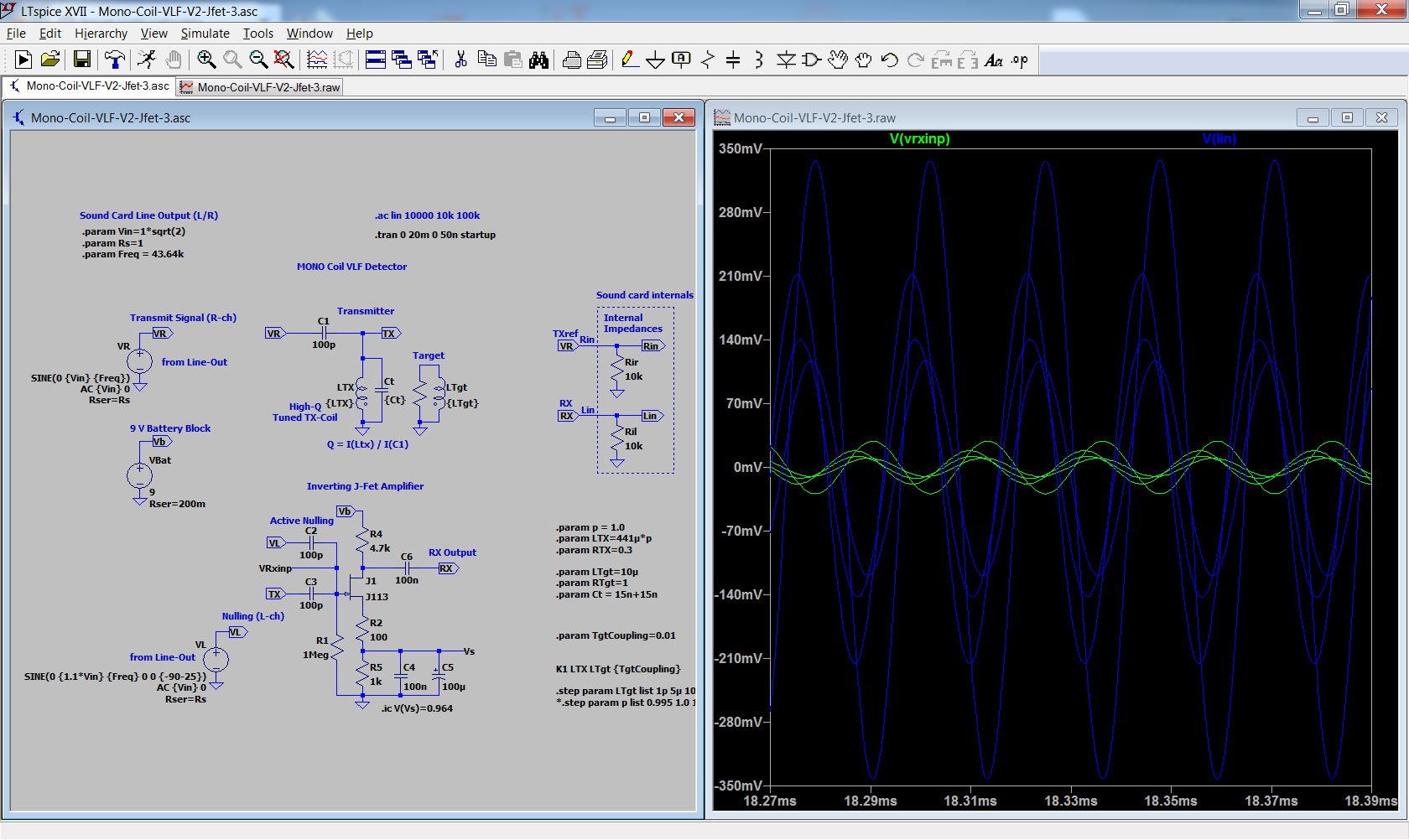

                        • Hi all,
                          I know how difficult it is to build complex coils​.
                          And I still like the mono coil VLF. The coil is not critical and so simple. Let's give it a last chance. The last option, I would like to test yet in the mean time.
                          Let's put an JFet-Amplifier with high input impedance so we don't fck up the High-Q of the transmitter. And we want to amplify only the tiny voltage changes from the TX coil.
                          We need a subtracting reference signal with appropriate amplitude and phase lag. This can be supplied on the second line-output channel.
                          We are pseudo nulling the TX signal and putting it to the amplifier.
                          I know, we are putting more noise to the system: Line-out for the nulling TX signal and the j-fet amplifier itself.
                          Would this improve our mono coil VLF performance? :remember
                          It would definitely improve the Q factor of the LC network. The TX signal won't be loaded much.
                          We know the answer, if we give it a chance.
                          Below is the simple j-fet amplifier solution. There are low noise j-fet op-amps available. This would be the next stage.

                            • Hi friends,
                              my 100 m long 1.5 mm² tinned litz wire came yesterday. This is a nice coil cable. 2.6 mm diameter total thickness. I can make the final flat spiral (pan cake) search coils soon.
                              But I will focus to the mono coil VLF design first. This gives us more detection depth potential.
                              What I can say is, that we really need active circuit design (high impedance buffer/amplifier). Active nulling or a difference amplifier is mandatory to get maximum out of the mono coil design.
