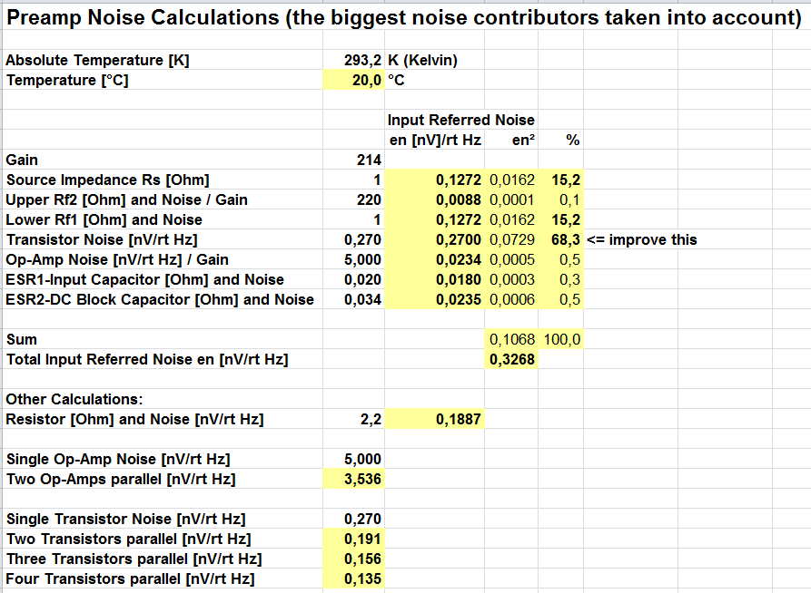

                  • Hi all,
                    I have made an Excel table for predicting the input referred noise en for the preamp.
                    You can see, where the big improvement potential is. And very remarkable fact is, that the op-amp noise contribution of the NE5532 is really very very low.
                    If we change to two parallel transistors, we are in game for the 0.3 nV/rt Hz challenge.
                    The zipped Excel table in the attachment is for playing and dreaming of ultra low noise silence.
                    Cheers

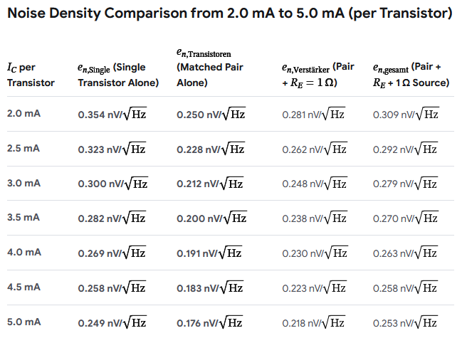

                    • Hi all,
                      two matched PNP ZTX951 parallel transistors will get the following predicted input referred noise en according to the Google AI answer.
                      According to the table, it even makes sense to reduce the collector current a bit as there is not much bigger improvement with higher collector currents.
                      We don't want to burn much battery energy and to heat the transistors as well.
                      Nice. I should ask for 3x PNP next time.
                      Aziz
                      • Yup,
                        3x PNP at 3 mA collector current is even better than 2x PNP at 5 mA collector current.

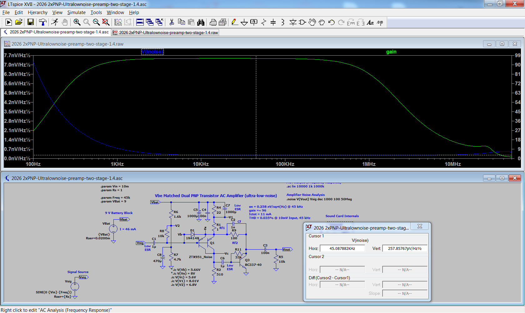

                        • Hi all,
                          I couldn't help me. This discrete AC preamp gets below 0.3 nV/rt Hz.
                          But, it is an heater! Almost 50 mA power consumption at 9 V. Nevertheless, it performs quite well.
Name:	Discrete 2xPNP two stage preamp-1.png
                          Now forget this design.
                          I am going to use the op-amp design.
                          Aziz
