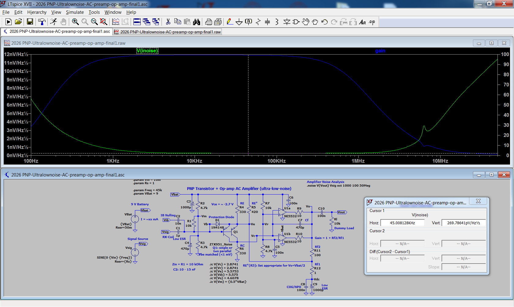

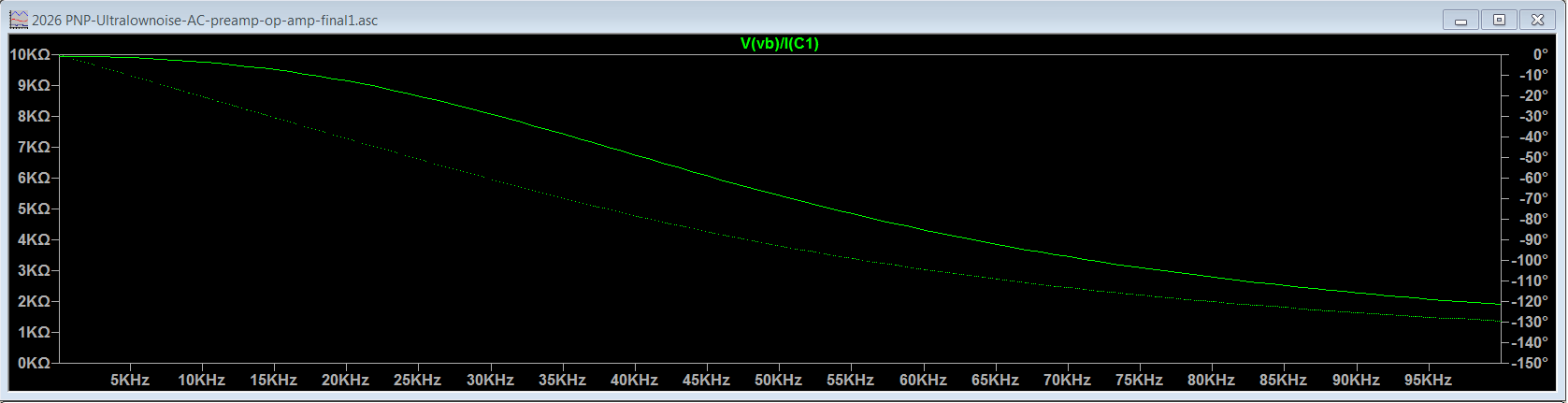

            • This is it.
              Schematics & Noise performance of the pre-amp:
Name:	2026 PNP-Ultralownoise-AC-preamp-op-amp-final1.png
              Input impedance:
Name:	2026 PNP-Ultralownoise-AC-preamp-op-amp-final-input-impedance.png
              Full LTspice files included.
              • Hi all,
                by paralleling two op-amps, the op-amp noise of NE5532 is beeing improved by sqrt(2) factor.
                5 nV/rt Hz -> 3.54 nV/rt Hz
                At gain 100, it's contribution to the input is 3.54 nV / 100 -> 35.4 pV/rt Hz. So it is completely irrelevant. The dominating noise source is still the pnp input transistor.
                And we have effectively doubled the load resistance of 100 Ohm (Rf2) into 200 Ohm compared to a single op-amp. Or doubled the current drive capability of the single op-amp.
                What can we do, if the distortion is too much or want to reduce the gain without lowering the load resistance further (Rf2)?
                We could slightly increase Rf1 from 1 Ohm to 2.2 Ohm or higher. But this will cause much more noise and we will never get to the 0.3 nV/rt Hz level.
                The other option without losing noise performance (keeping Rf1 = 1 Ohm):
                We have to upgrade the NE5532 to an other dual op-amp.
                - With more drive current capability or
                - Rail-to-Rail output.

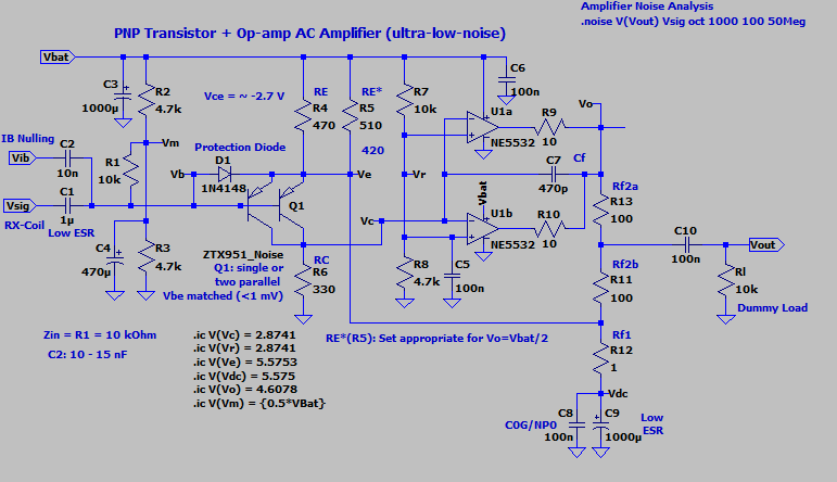

                Rail-to-Rail output option:
                As we don't have the big 2.0 - 2.5 V head room to the power supply rails (0 V, 9 V) with the rail-to-rail output option, we could increase the total gain of the amplifier. So we can rise the load resistor Rf2 (for instance doubling it). At the same time, we could voltage divide the output of the amplifier. This voltage divider can be realised in the feedback loop (splitting Rf2 resistor into two Rf2a, Rf2b resistors). There we have it.
                This modification is shown here:
Name:	2026 PNP-Ultralownoise-AC-preamp-op-amp-final1-output-voltage-divider.png
                I have doubled the total gain (total Rf2 = 100+100 Ohm) and divided the output voltage by two. If I don't change the op-amp, I am limitted to half dynamic range only.
                So the load resistance Rf2 is being rised to 200 Ohms and the op-amp won't hopefully clip or distort the signal at the output. You see, we would require rail-to-rail output op-amp here.
                Or we could increase the battery voltage. Hell, don't do it. The power consumption... It will turn into a big heater ..
                Aziz

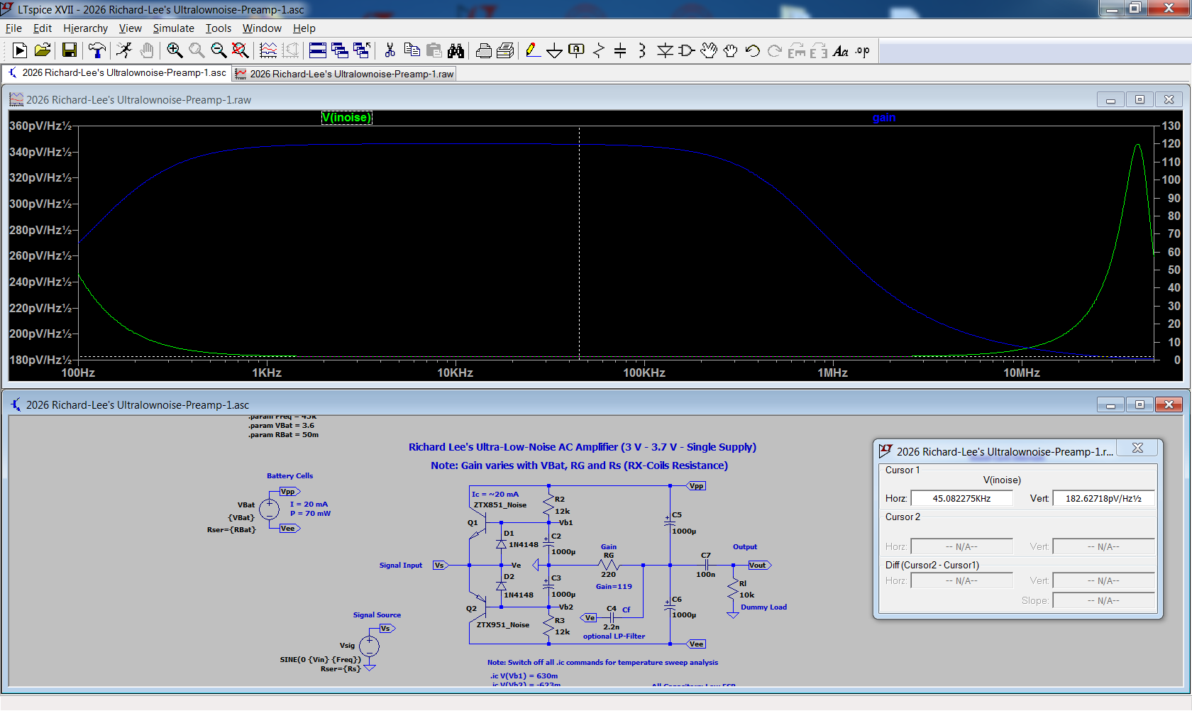

                      • Holly cow!
                        The single NPN/PNP ZTX851 / ZTX951 pair with Ic=10 mA each in Richard Lee's Duraglit Special does get directly
                        en = 0.2 nV/rt Hz
                        With input impedance of approx. 1.4 Ohm.
                        Mission accomplished.
                        Vbe matched two NPN, two PNP does even get 0.17 nV/rt Hz.

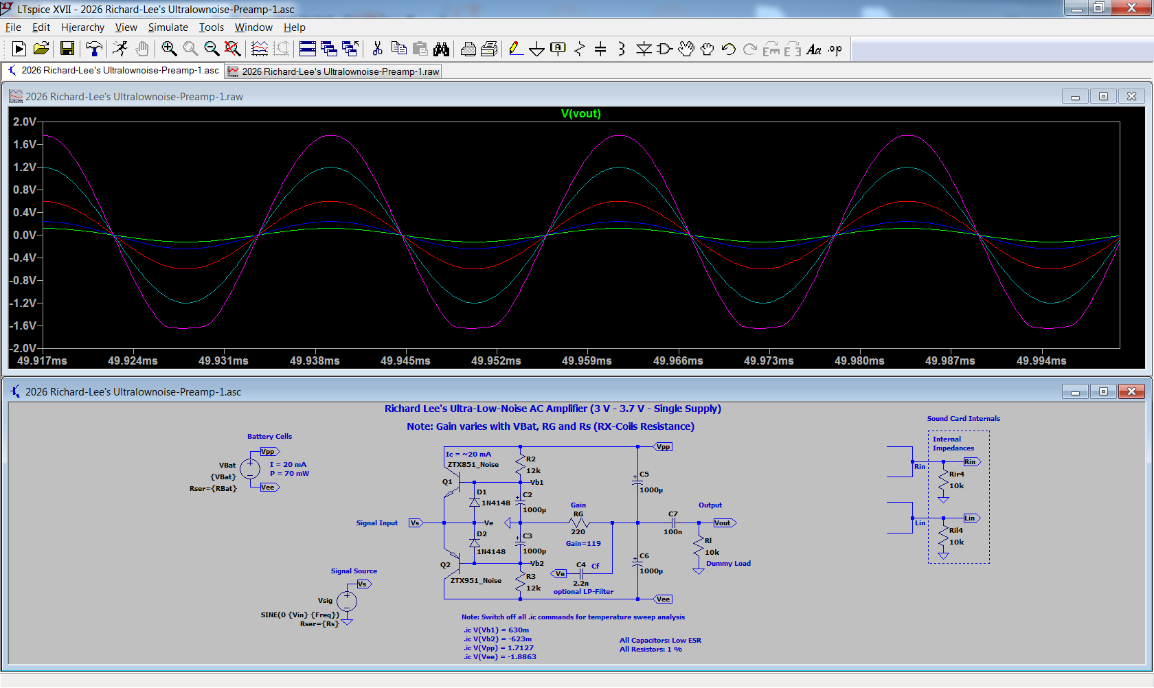

                        • Oh man!,
                          I was really shocked about the simulated "temperature dependency" of the Richard Lee's preamp in LTspice.
                          With floating power supply rails, where the amplified signal "rides" on these rails, it is difficult to simulate the temperature dependency of the circuit.
                          After all, I had to switch off any initial operating point definitions (.ic commands) . It worked then.
                          These are usually required for proper .noise, .ac and .tran time domain analysis.
                          Now the temperature dependency is really acceptable. The gain varies only appr. 3% with 50 °C temperature difference (0 °C - 50 °C).
                          Offset voltage? What an offset? We don't need any. We don't want it. We are ignoring it. We have an AC coupled input and output.
                          Aziz

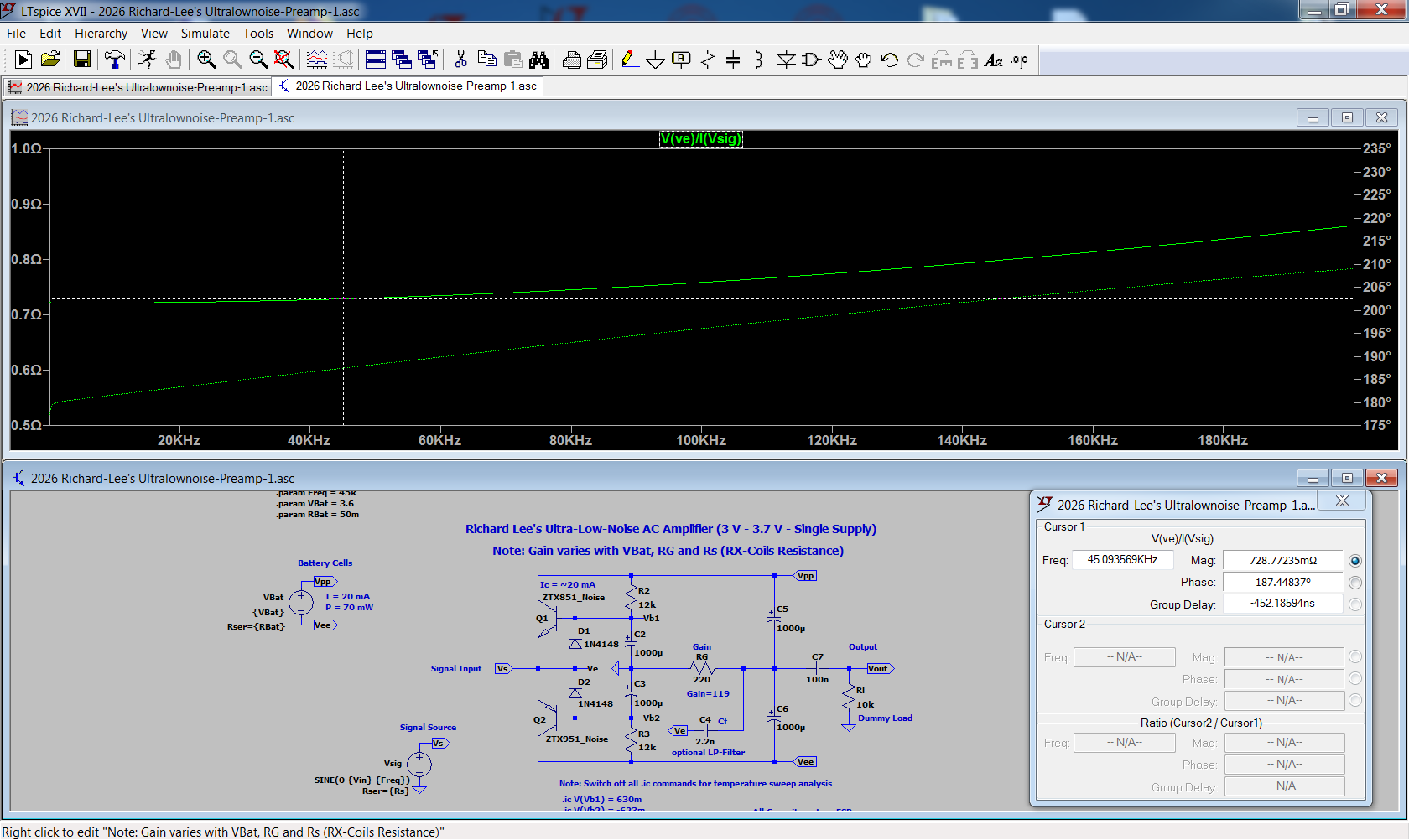

                          • Hi all,
                            I have just checked the impedance matching via series resonance RX coil input. And also the IB nulling (via resistor) with some residual IB-mismatch.
                            It works very nice. The AI is correct.
                            The unknown mystery have been solved (my former reduced sensitivity observation).
                            New limits (en = 0.2 nV/rt Hz) have been broken too.
                            We can afford to increase the collector currents (Ic). The gain stability and THD improves. Ic can go up to 20 mA or more.
                            Input impedance decreases with more collector current. I have right now 0.83 Ohm.
                            The total power consumption will be the collector current.
                            With RX coil resistance of 1 Ohm: en = 0.185 nV/rt Hz
                            With RX coil resistance of 2 Ohm: en = 0.227 nV/rt Hz
                            Either 2x1.5 V standard battery cells or 3x1.2 V NiMH cells or single 3.6/3.7 V Li-Ion cell.
                            ​And the circuit is very very KISS.
                            More later... stay tuned..

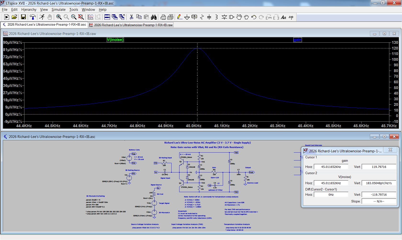

                            • Hi all,
                              I have increased the collector current to ~20 mA. Single NPN/PNP transistors.
                              I have determined the dominating noise source for this configuration.
                              If the source resistance Rs (RX-Coils resistance) is below 0.55 Ohm, the dominating noise sources are the transistors.
                              If Rs > 0.55 Ohm, the dominating noise source will always be the coil itself (thermal resistor noise of course).
                              A receive coil with such low resistance Rs will get heavy and unrealistic.
                              Rs between 2 and 4 Ohms is more realistic. So the RX coils resistance will always dominate the noise.
                              As a consequence of this: We don't need any paralleling more transistors.
                              We are limitted by the fkn RX coils resistance. I have reached the max. possible limit now.
                              (Wait! I can cool down the front-end... with liquid nitrogen.. )
                              Aziz

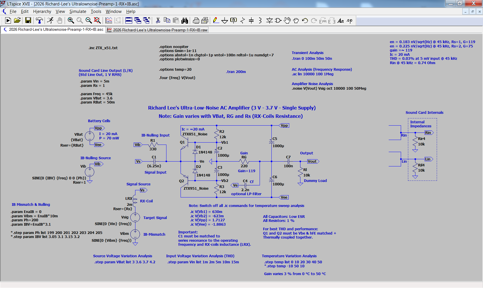

                              • Hi all,
                                this is the final schematics of the Richard Lee's Ultra-Low-Noise Pre-amp.
                                Two versions included:
                                - Pre-amp without RX coil (plain amplifier characteristic without impedance matching)
                                - Pre-amp with RX coil attached (impedance matched, IB-Nulling, but disabled in the simulation file)
                                LTspice files also attached.
                                Cheers
