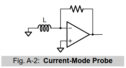

                      pity, but we can't use low input impedance (Rin) amplifiers.
                      I don't see why not. You can "read" the RX coil signal in current mode, as I did with the MagFieldProbe in ITMD3:

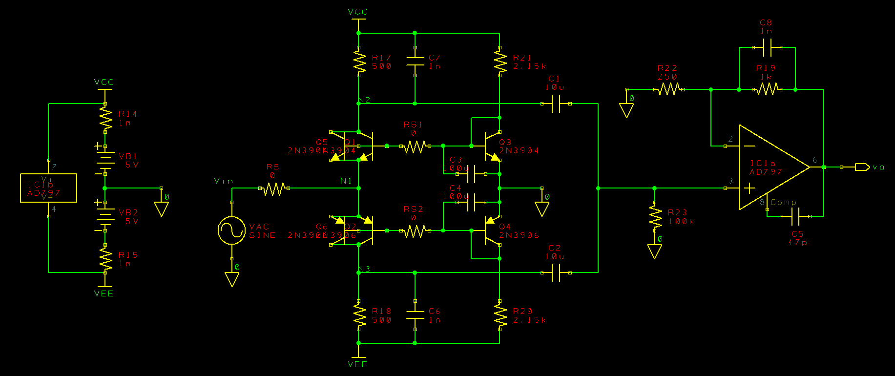

                      Here is a version of Lee's preamp I was playing with a few years ago:
                      You can replace the the Vin signal source with an RX coil and it will work just fine. There is a caveat: you lose the input derivative of the RX signal that you normally get with a voltage-mode coil.
                      • Hi Carl,
                        no, it won't work.
                        Things dramatically change, if the Vin signal source comes from a coil.
                        I will post a direct circuit comparison later, which shows this.
                        Aziz

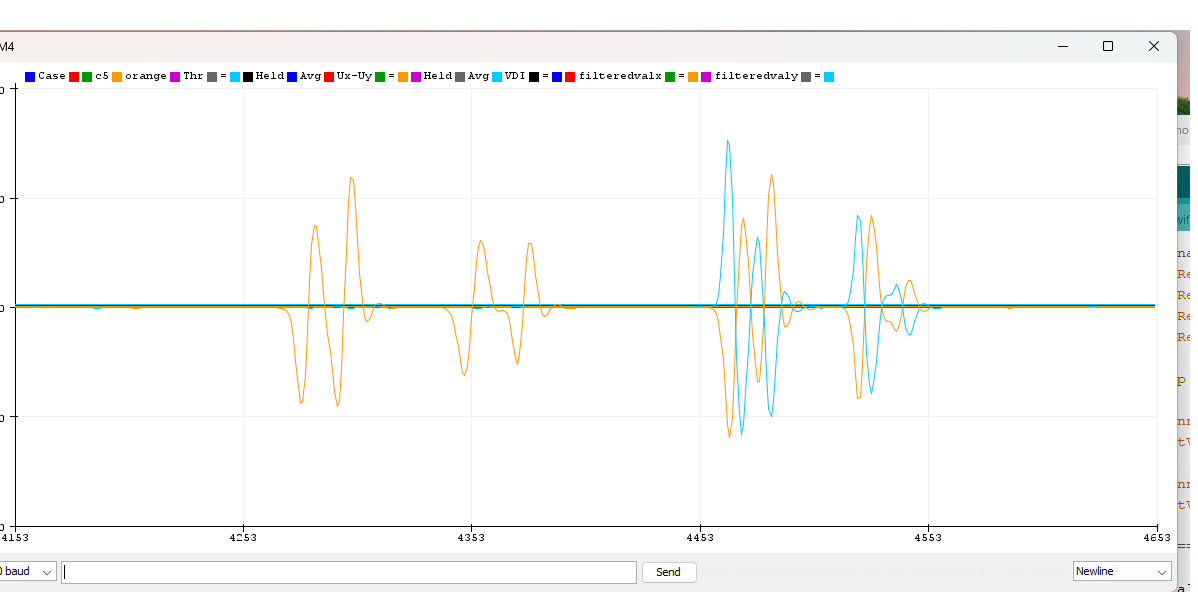

                        • Click image for larger version  Name:	image.png Views:	0 Size:	48.9 KB ID:	453195perfect ferrite balance, the first it is a ferrite, the second an​y metal, the blue it is a Uy, orangre Ux

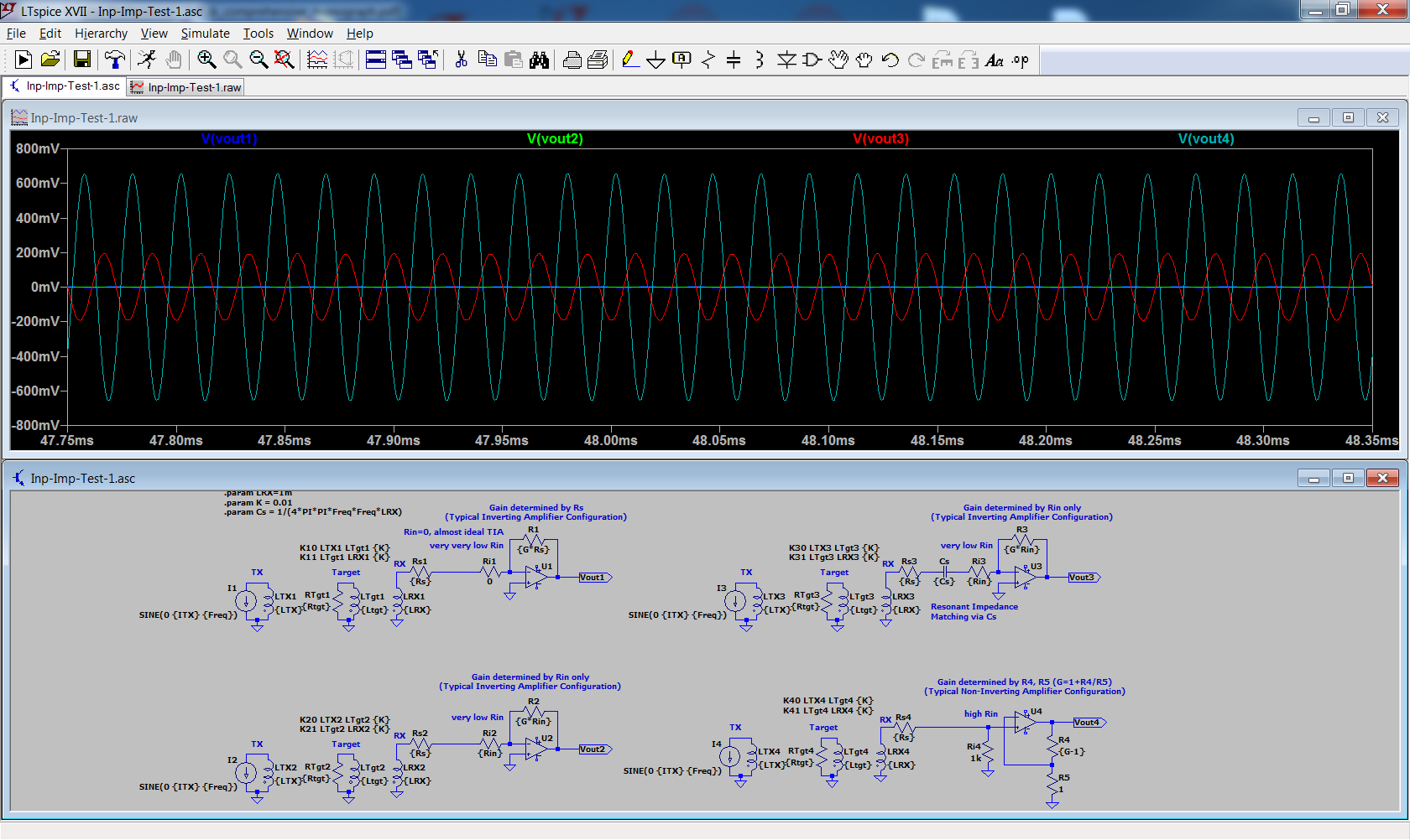

                          • Hi all,
                            I have made a comparison circuit simulation using the data in the recent AI paper.
                            4 independent configurations with ideal op-amps (Level 1). The low input impedance amplifier is made in inverting ideal op-amp amplifier configuration.
                            The high input impedance amplifier in standard non-inverting configuration with a load resistance at the input simulating the input impedance.
                            As the operating frequency of 45 kHz is very high, the reactance of the RX coil dominates heavy. It is acting like a choke in very low input impedance amplifiers.
                            This is really a revealing evidence.
                            Look at the spice simulation file in the attachment.

                            • Hi pito,
                              nice. very nice.
                              I should look at the ferrite induction balancing. Maybe I can leave the IB-nulling part and drive the TX with differential input (more TX power).
                              Aziz
