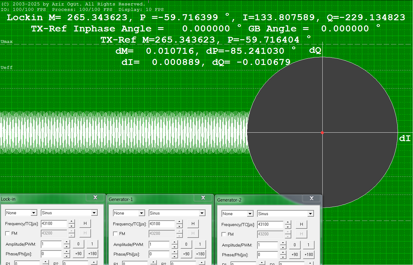

ID:	445388 This is my initial state:
                  IQref is set, so the dIQ is zero (almost due to EMI noise).
                  Operating frequency is set to 43.1 kHz (almost at resonant frequency).
                  The demodulator delivers a magnitude M of 265.3 and a phase angle of -59.7 °. If I rotate the dIQ vector back to the I-axis, I can measure the real responses. The red dot in the IQ plane shows the actual dIQ vector. I have implemented a history of the dIQ vectors, so you can see the response changes back in time (angle, magnitude).
                  So lets look at different target responses, where we are in phase with the TXref signal. The dIQ vector will be rotated to the I-axis next time.
                  to be continued..

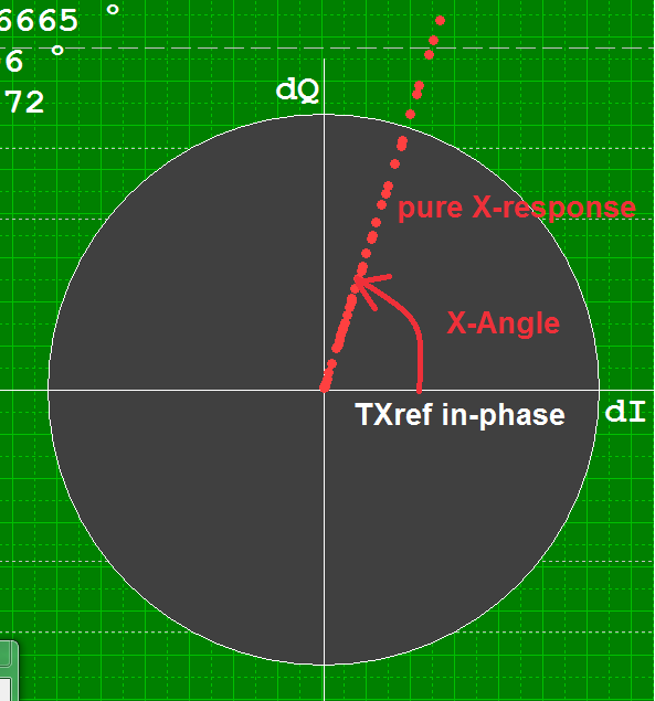

                  • Let's look at the pure X-response by placing a ferrite or hot rock to the coil:

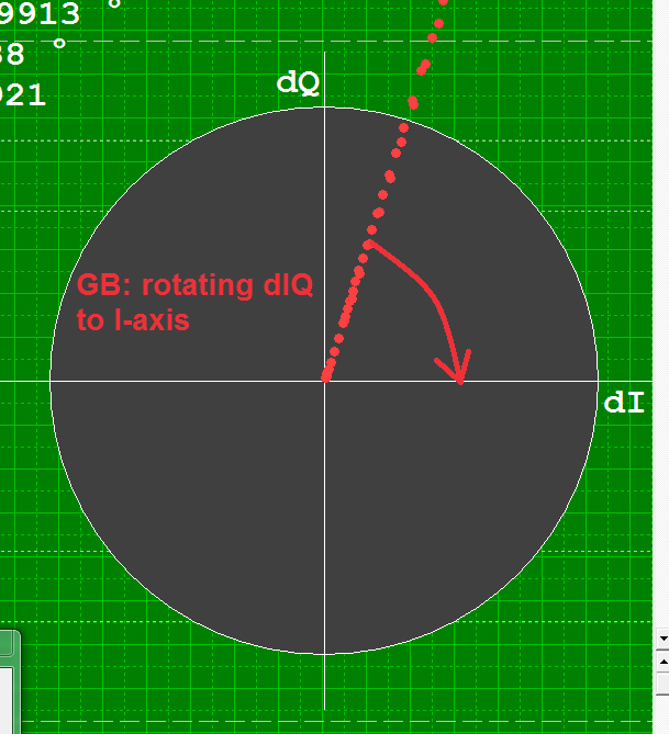

                    The GB process is to rotate the dIQ vector to the I-axis:
                    If we do this, we have made the ground balance procedure.

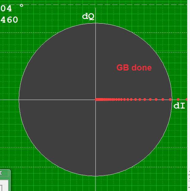

                    All pure reactive response will go to the I-axis:

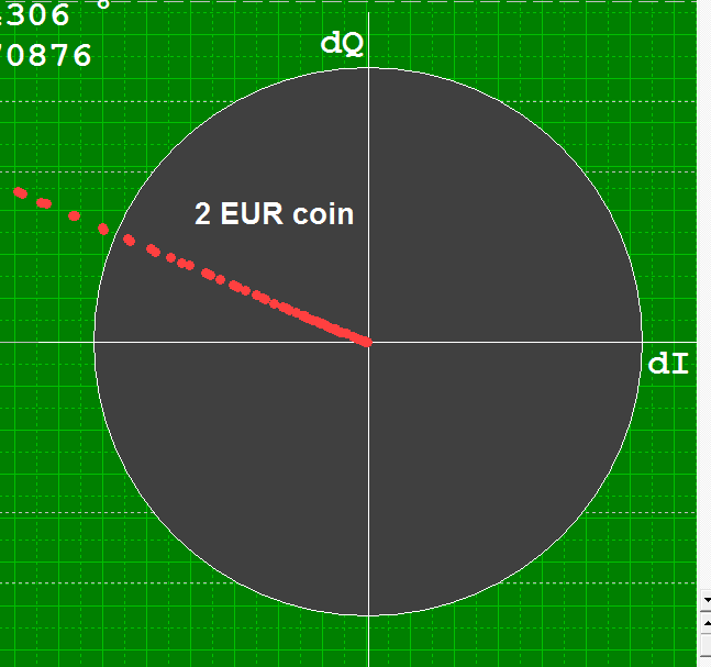

                    So we are ground balanced now. Lets look at the response of a 2 EUR coin:

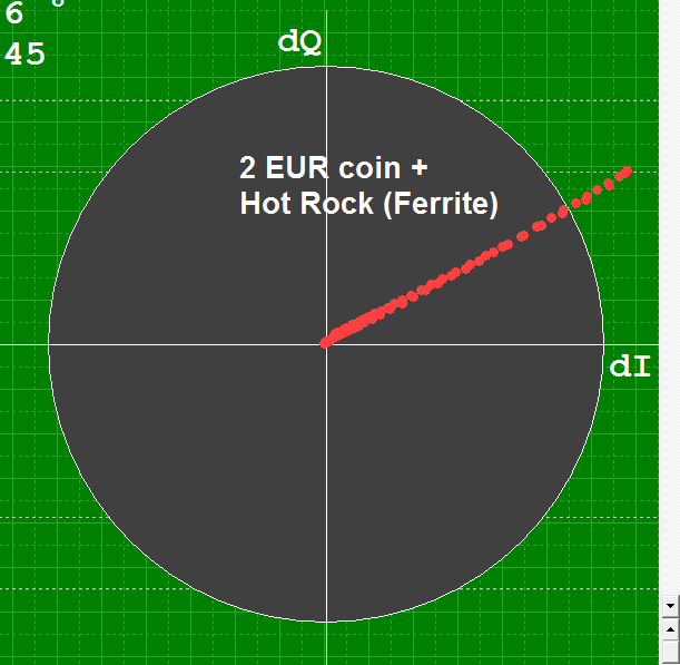

                    Now let's put the 2 EUR coin with a hot rock together:
                    You see the big difference?

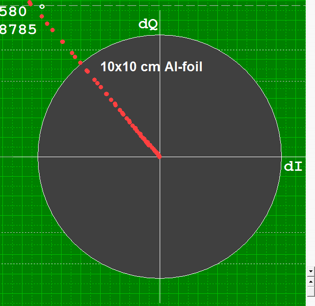

                    Let's look at a 10x10 cm thin Al-foil only:
                    Since we are ground balanced, the target signal can be read at dQ part. The imaginary part of our dIQ complex number.
                    You see, this is the most simplest mono coil VLF, which works with the standard GB projection.

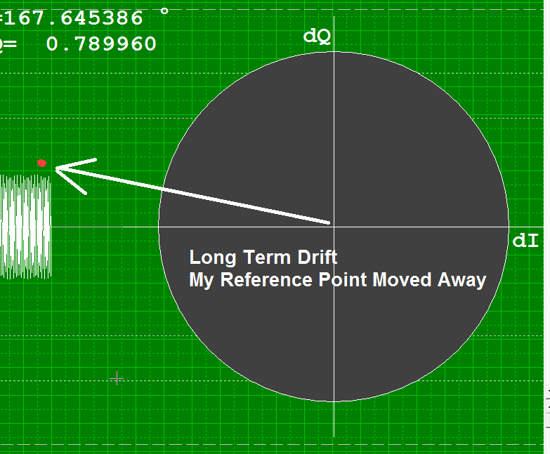

                    • And this happens to my reference point. A long term drift happens:
                      The tracking will help to keep the dIQ zero.
                      • BTW,
                        VDI can be obtained by the phase angle of the response dIQ. You have to map the full 180° angle range into a VDI index number 0..100 or so.
                        Look at the response of the 2 EUR coin alone and with hot rock together now.
                        You see, that the VDI is not reliable in discriminating a target.
                        Only the shovel will ensure you a 100% reliable discrimination by digging out the target.
                        :rotfl
                        Aziz
