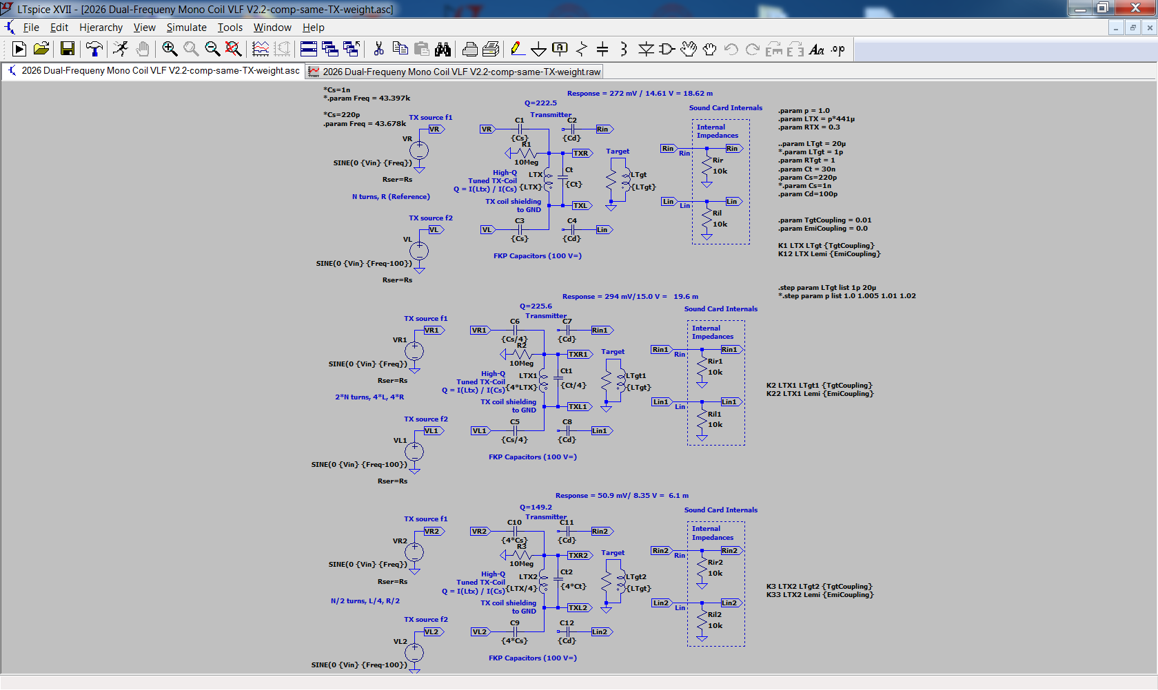

                        • Hi all,
                          I know now, which foil capacitors I need:
                          A big bunch of various FKP2 (WIMA) capacitors. Available from 33 pF to 33 nF at different voltage ratings.
                          And I have found a small mono coil with true HF litz wire in my box for testing (~600 µH, ~1.8 Ohms, 20 cm diameter). It isn't shielded yet however.
                          The outcome of my brute force mono coil LTspice analysis is:
                          Let's say, we have 200 g copper wire for the TX coil.
                          Our reference: Take the wire as is. TX coil will have L inductance, N turns count, R resistance, 200 g copper.
                          Comparing against
                          - We take the wire and use it as two strand wire: We get L/4 inductance, N/2 turns count, R/2 resistance, still 200 g copper
                          - We take half thinner wire, double the turns count 2*N, we get 4*L inductance, 2*2*R = 4*R resistance (thin wire has double resistance), still 200 g copper
                          For a constant weight of TX coil (x amount of copper), use the wires to increase the coil inductance and resistance instead of lowering the inductance and resistance.
                          If the TX current gets too much, the (ohmic) losses dominate and the Q decreases and hence less target response. You will have temperature drifts perhaps too (heat).
                          So use the amount of copper to increase the TX coil inductance.
                          A TX coil inductance above 300 µH is ok (minimum). Better go for more inductance.
                          The second argument: Losses on the tuning capacitors
                          High value capacitors have much higher losses. Particularly on high frequency usage.
                          If we want to use low value tuning capacitors, we have to use high inductance TX coils. But this is most desired due to first argument.
                          Another argument for low value FKP2 capacitors is, that they are compact and relative small. Perfect for placing in coil housing. And also perfect for paralleling them.
                          This is the free lunch.
                          Aziz
                          • This is the LTspice simulation:
                            Simulated on the same resonant frequency.
                            I have even disconnected the measurement ports.
Name:	2026 Dual-Frequeny Mono Coil VLF - same TX coil copper weight.png
