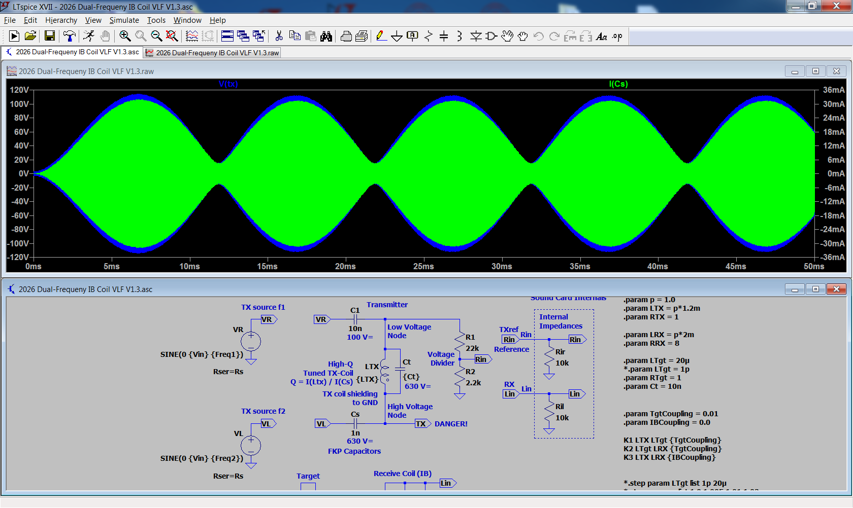

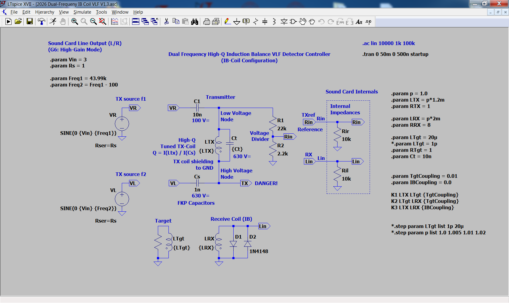

                      • Hi all,
                        this is my latest KISS Dual-Frequency Induction Balance VLF Detector Controller for sound card use.
                        Operated at moderate power consumption in high-gain mode of G6 (mid-level output, TX coil voltage up to 100 Vp).
                        The Q of the LC tank is still high enough (approx. 10).
                        At maximum output level (7 Vp), the TX coil voltage will go up to 250 Vp and the sound card may get hot too. It is very likely, that it switches itself off due to high current protection triggering.
                        Anyway, this is a KISS power beast.
                        The search coil is an IB coil. You will get very high sensitivity and depth.
                        The very sophisticated digital signal processing will also allow operation of heavy ground mineralisation.
                        All parts must be placed inside the coil housing. The coil cable bears only low voltage and low current and can be a thin and flexible shielded stereo earphone cable (2x Stereo, Input, Ouput).
                        You need low loss, high voltage rating FKP (Foil) capacitors.
Name:	2026 Dual-Frequeny IB Coil VLF V1.3 - 1.png
                        Cheers,
                        Aziz
                        • PS:
                          On very mild ground mineralsation:
                          It can be operated at single frequency in differential mode.
                          On heavy to severe ground mineralsation:
                          Two frequency mode (f1, f2) -> 4 I/Q vector processing required.

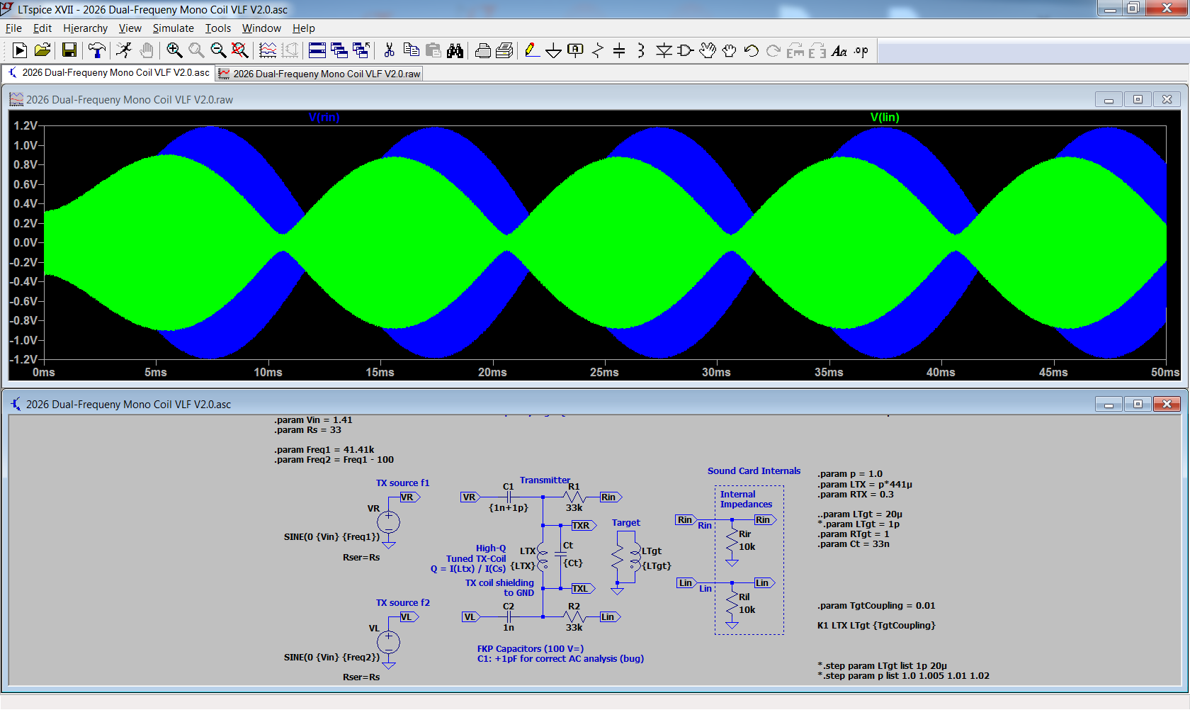

                          • We have a good IB-VLF base now.
                            Now back again to pure mono coil VLF:
                            - It must have high Q.
                            - Less power drain. High power efficiency.
                            - Must work with standard line output level (1 V rms) and with every sound card this time.
                            - KISS & cheap design.
                            - All parts in the coil housing.
                            I know, the circuit can be made much more elegant this time.
                            We need a KISS masterpiece.
                            AI isn't smart enough to help me.
                            But I'm working on this right now:
Name:	2026 Dual-Frequeny Mono Coil VLF V2.0.png
                            Differential input mono coil. So we are processing both input channels at two frequencies now.
                            And I have found a real bug in LTspice in AC analysis.
                            I had to destroy the symmetry of the circuit by adding 1 pF to C1. It helped to override the bug.
                            Cheers,
                            Aziz
