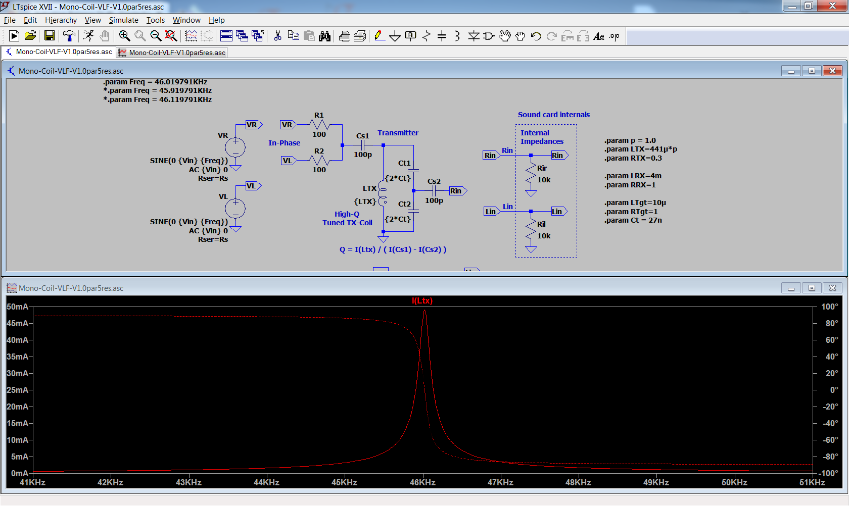

            • Hi all,
              this is the basic tuned High-Q transmitter I am going to test soon. Q is almost 300 (theoretical without the losses of the capacitors).
              Note, that the coupling capacitors Cs1 and Cs2 are kept very low to maximize the Q. The series split of the resonant capacitor (Ct1, Ct2) is required to decouple the LC-network from the input impedance of the sound card. So the LC-network may not be loaded much by source and measurement impedances.
              The phase change around the resonant frequency is very very steep. Bandwidth (BW) is very low (<200 Hz). So it minimizes the incuded EMI noise outside of the BW. This could increase the detection sensitivity on mono coils. Also the ground effects.

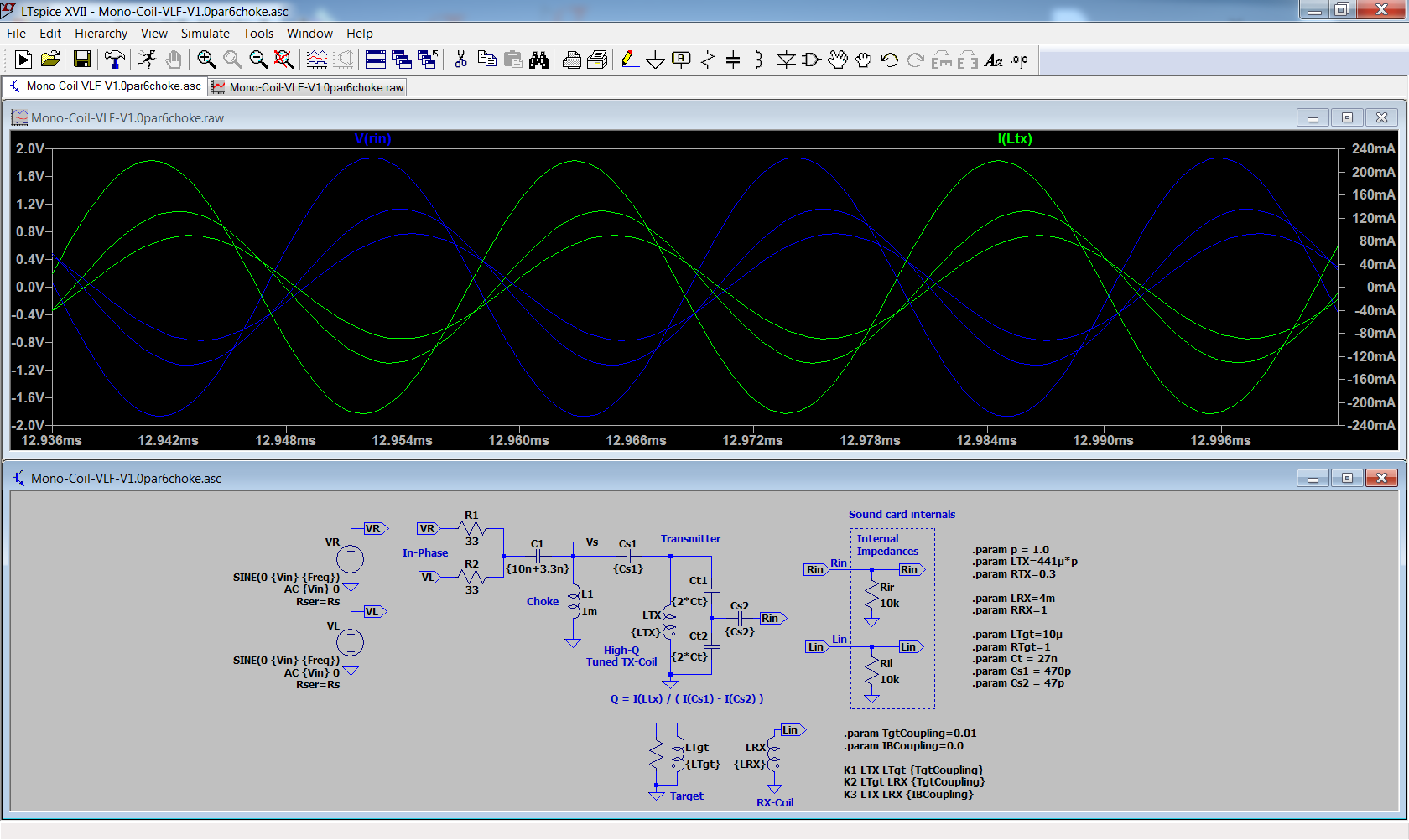

                  • Hi all,
                    this is the high-power High-Q transmitter I am talking about with additional capacitor (C1) and choke (L1). So there is enough power to operate it even in IB-coil configuration.
                    Note, that the input is only 1 Vrms (+/- 1.414 V peak to peak, typical line-out level). We can increase the input coupling capacitor Cs1 to get more power (470 pF in this configuration). This won't degrade our TX-Q much.
                    By carefully setting C1 and L1, we can increase the TX power further. It's own resonance frequency should be lower than the LC-tanks resonant frequency. C1 and L1 is beeing operated at low-Q only and it steps-up the line-input voltage.
                    Click image for larger version  Name:	High-Q-TXpower.png Views:	0 Size:	132.8 KB ID:	445228
                    The configuration is very sensitive to TX-coil inductance changes and resistive losses. Let's look, where we want to operate it:
                    - close low side to the resonant frequency
                    - at exact resonant frequency
                    - close high side to the resonant frequency.
                    Aziz

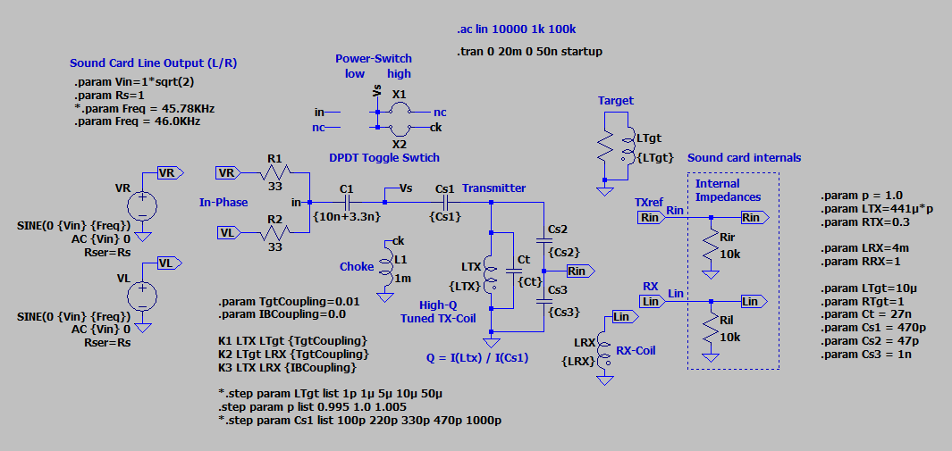

                        • Hi all,
                          I have changed slightly the LC-tank circuit. And put a DPDT power toggle switch simulation via jumper.
                          There is only one big tune capacitor Ct (instead of two bigger). FKP1 foil capacitor with low losses if possible.
                          The small capacitors Cs2 and Cs3 are now doing the voltage division (capacitive voltage divider).
                          Keep Cs2 as low as much. Change Cs3 if required.
                          Cs1 is a compromise between power and high-Q. Make Cs1 bigger and you get more power to the TX coil but the Q will go down.
                          Below is a zipped LTSpice simulation file for your convenience. It simulates a time-domain circuit behaviour for -0.5%, 0% and +0.5% change of TX-coil inductance approx. 200 Hz above the resonant frequency. If you make an AC analysis, Q can be calculated in the graphs. Q = I(Ltx) / I(Cs1), this is now the correct calculation.
                          Aziz

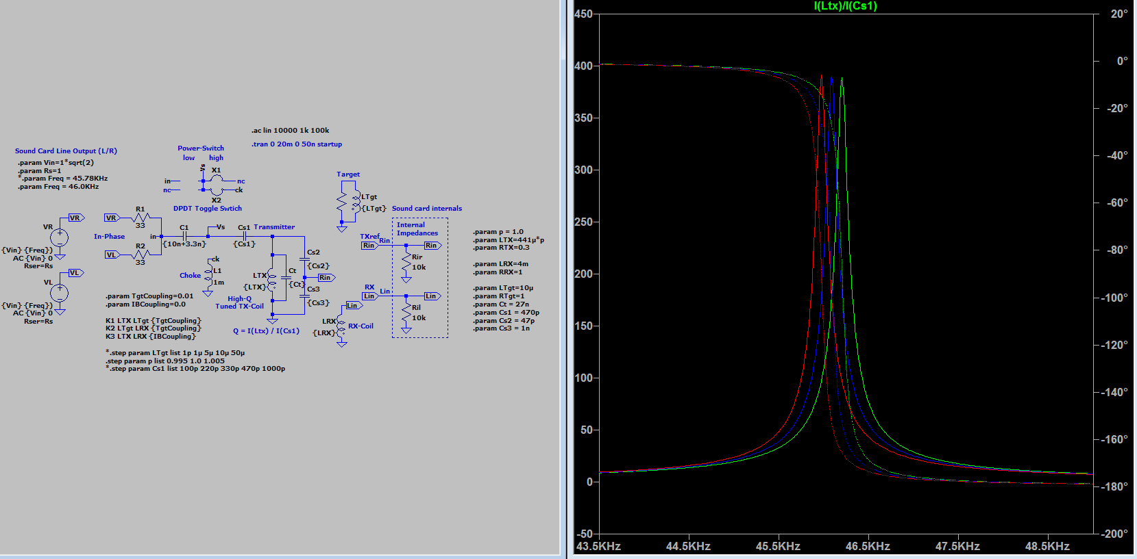

                          • This is the Q-Graph. It is close to 400 with given values (capacitor losses not taken into account however).
