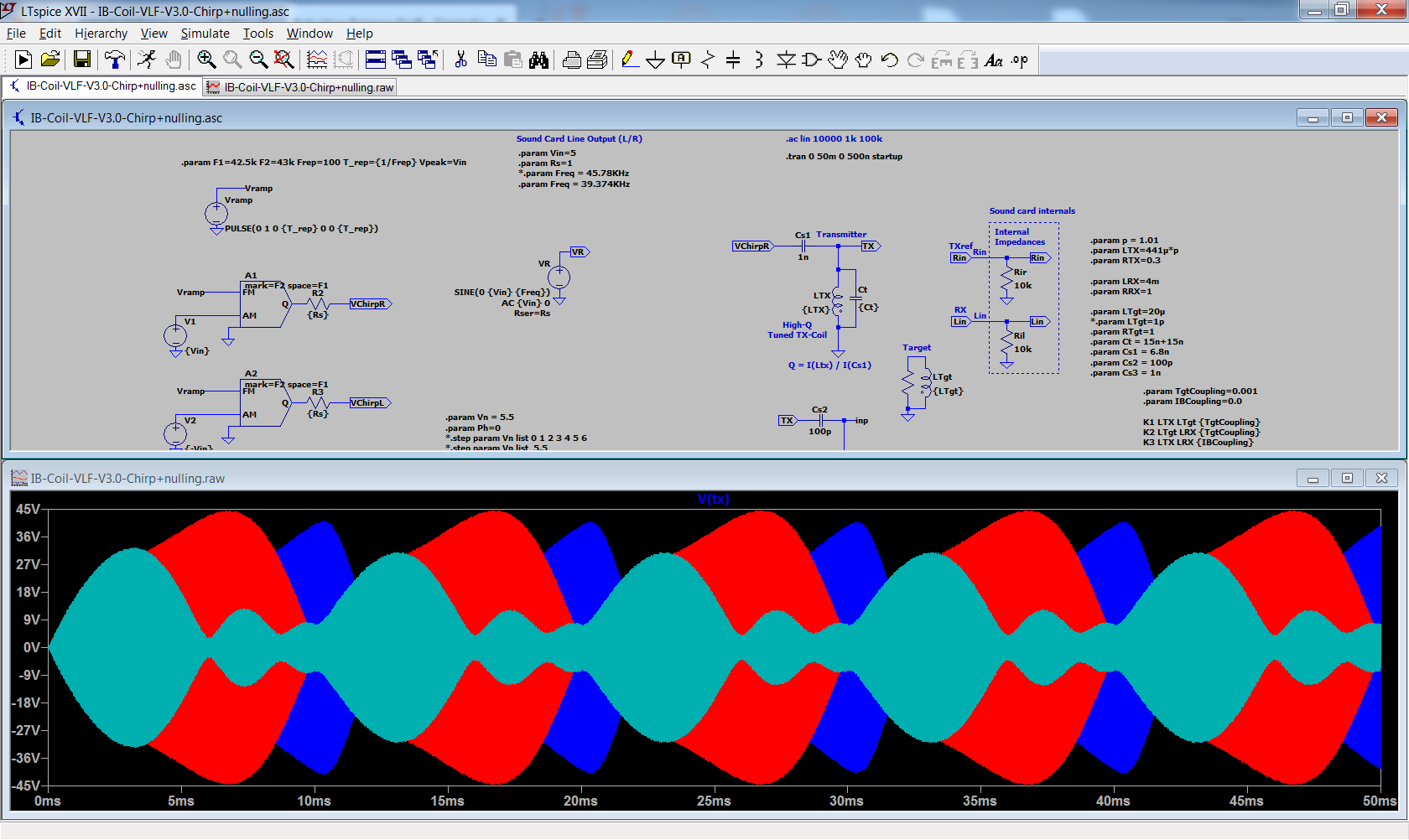

    • Well ok,
      the nulling won't work on chirp modulation. Too complex issue.
      The TX voltage varies still too much for 0%, 1% and 2% TX inductance increase.
      It is really nice, that LTspice has a modulate module to make chirp modulation possible. The AI told me how to use it.

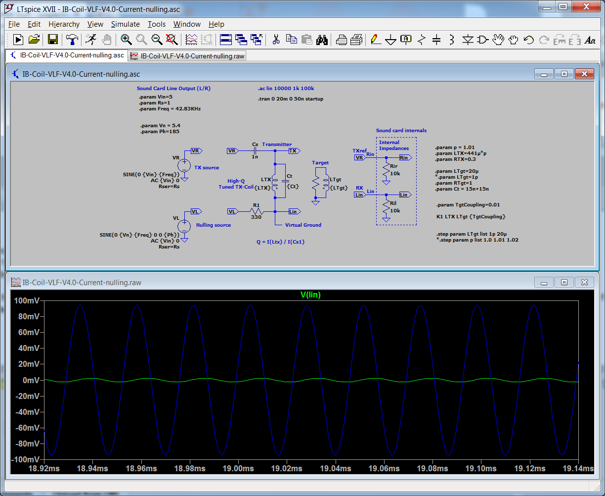

      • Hi all,
        well ok. The problem with the high impedance signal path has been solved and there is no j-fet amplifier required anymore.
        Also the mixer has been radically simplified. It's really a KISS masterpiece now.
        The mixer has been reduced into one resistor (R1).
        Provided that, the ground mineralisation isn't much, the following basic LC-tank with active nulling can be used and the signal source can be directly fed to the input of the sound card.
        It is now a quite low impedance path (impedance aprox. R1/2, so much lower than 10 k Ohm).
        Click image for larger version  Name:	Mono-Coil-VLF4.0+Active-Nulling.png Views:	0 Size:	118.5 KB ID:	448951
        Aziz
        PS: And no external battery required anymore too.

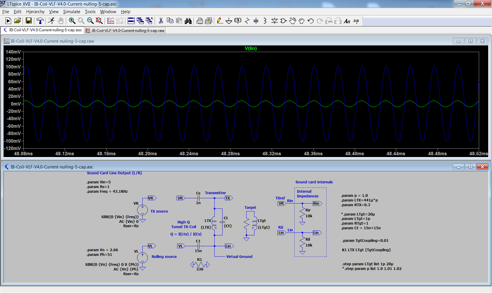

              • Hi all,
                I have replaced R1 with a capacitor C1. It is more power efficient and should not produce temp drifts.
                Same principle.

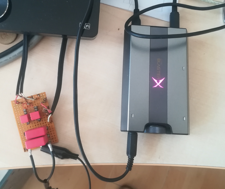

                    • Hi all,
                      my new breadboard is ready to fire it up.
                      On a single frequency resonance, it is the most sensitive hot ground/ferrite detector ever.

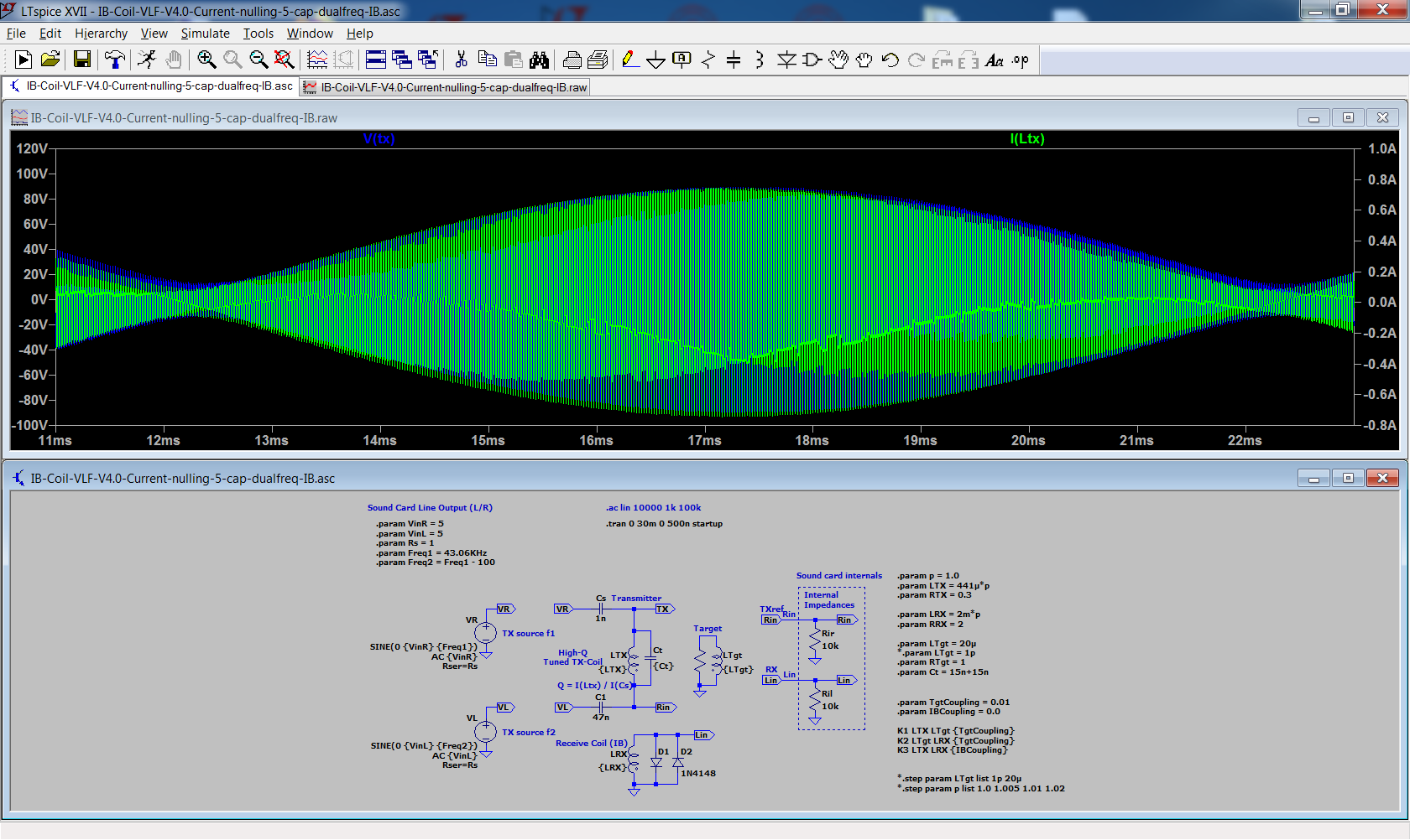

                          • Hi all,
                            the circuit needs to be optimized further.
                            In order not to attenuate the line input level in the sound card much (due to big TXref and small RX coil signals), the TXref signal needs to be divided by a simple resistor voltage divider. So two resistors will be added further. Thats all.
                            This will be my ultimate ground breaking VLF-IB detector.
                            It will even operate on pure iron ore grounds (severe ground mineralisation).
                            Note, that we are not fixed to the in-air resonant frequency. We can adapt it for severe ground types. And the frequency distance (df = f2 - f1).
                            So it will cover some ground mineralisation variation too.
                            And we can push up the TX power as we have the voltage divider for the TXref.
                            The Sound BlasterX G6 can deliver at least up to 100 mA current @ 7 Vp output for each channel (but it gets hot).
                            We can have way above 100 Vp TX voltage. But this is really not required.
                            A source current of 20 - 50 mA is enough. Multiply this with Q and we have the TX coil current peak.
                            Aziz

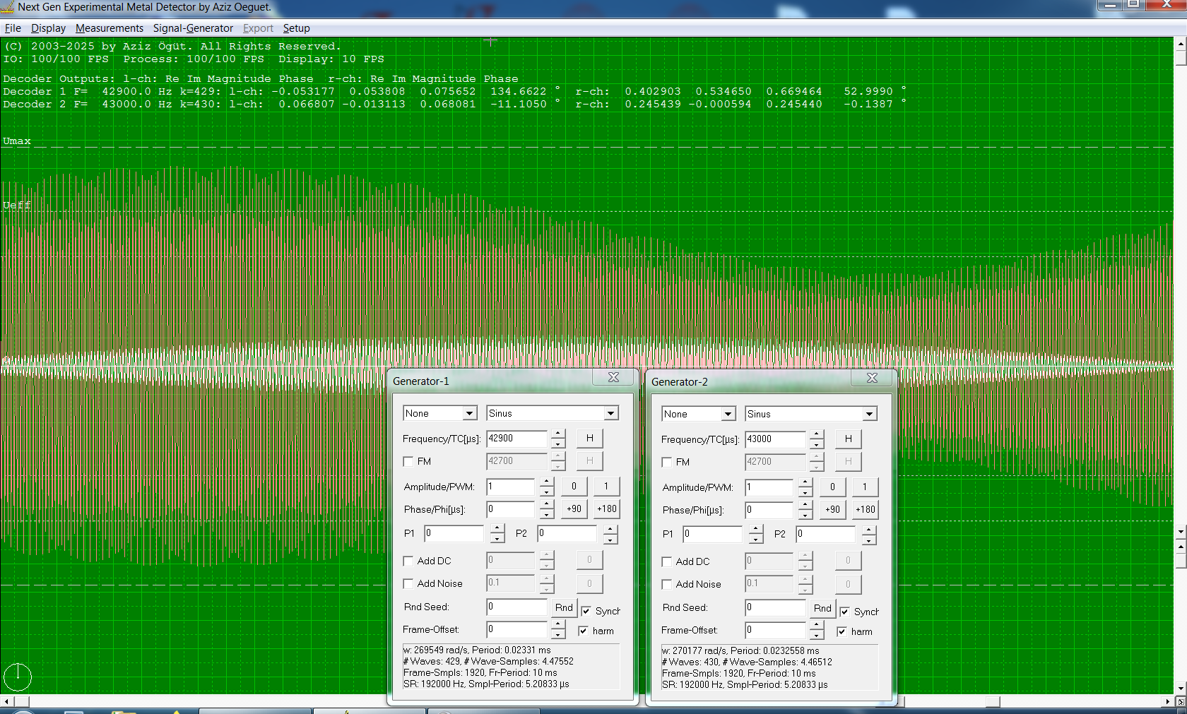

                              • Hi all,
                                I have now the decoded 4 I/Q vectors visible. I'm using the Goertzel as it is the most efficient.
                                All the ground and target information is there now.
                                I have observed a nice and distinc response change on the intermodulation frequency (in my case 100 Hz).
                                Especially on the envelope curve of the intermodulation frequency.
                                The X-response differs from R-response.
                                One possible way to process a single channel:
                                Hilbert Transform -> Envelope -> FFT of Envelope
                                FFT delivers the frequency spectrum of the envelope. Note, that the FFT is being used for the very narrow band intermodulation frequency. We get a much finer frequency resolution. Whole spectrum response in the 100 Hz bandwidth is visible.
                                Using only the magnitude spectrum of it, we can use the linear combination method to get rid of the ground response (simple processing variant).
                                We also could use phase spectrum too. Or an array of complex I/Q vectors.
