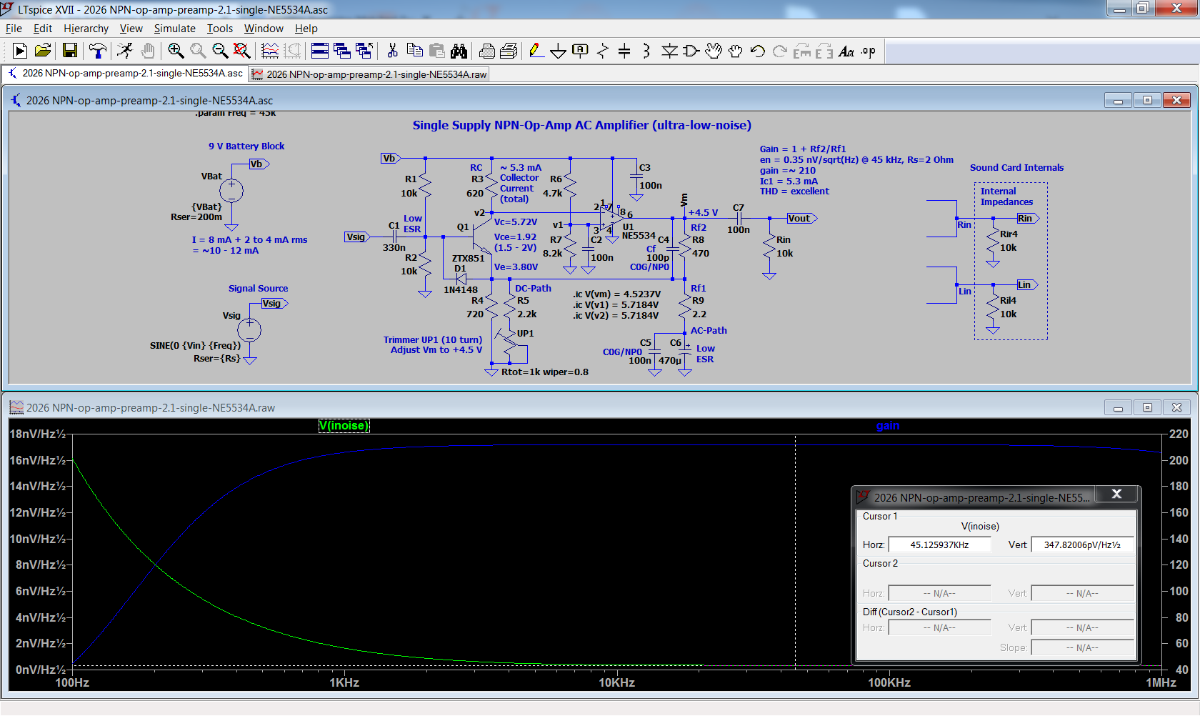

      this is it. The ultra low noise AC pre-amp with compromises.
      With Rs=2 Ohm (RX coil resistance) and even with relative low gain feedback loop resistor R8 of 470 Ohm, it is achieving at my operation frequency of 45 kHz 0.35 nV/rtHz input referred noise density. This is acceptable and realistic. The op-amp should be able to drive the R8 with ease without any significant THD degradation.
      The capacitor C4 (Cf) is absolutely mandatory for stable operation of the NE5534 (uncompensated).
      The capacitor C2 (100 nF) at the non-inverting input of the op-amp reduces further noise.
      Some capacitors must have low ESR or must be C0G/NP0 type.
      The Diode D1 is to protect the transistor Q1 during start up and down conditions (or electrostatic stress cause). It prevents reverse biasing of Q1.
      Input impedance Zin is 5 kOhm (Zin = R1 || R2 )
      I have taken C1 as high as possible to lower the noise (lowering source impedance) and to cut-off the unused low frequency part.
      BTW, lots of op-amp spice models do not model the dynamic power supply consumption. So the total power consumption is 10 - 12 mA depending on the source signal level at 9 V battery operation.
      AI tought me a lot. But I have corrected him a lot more.
      This is the schematics:

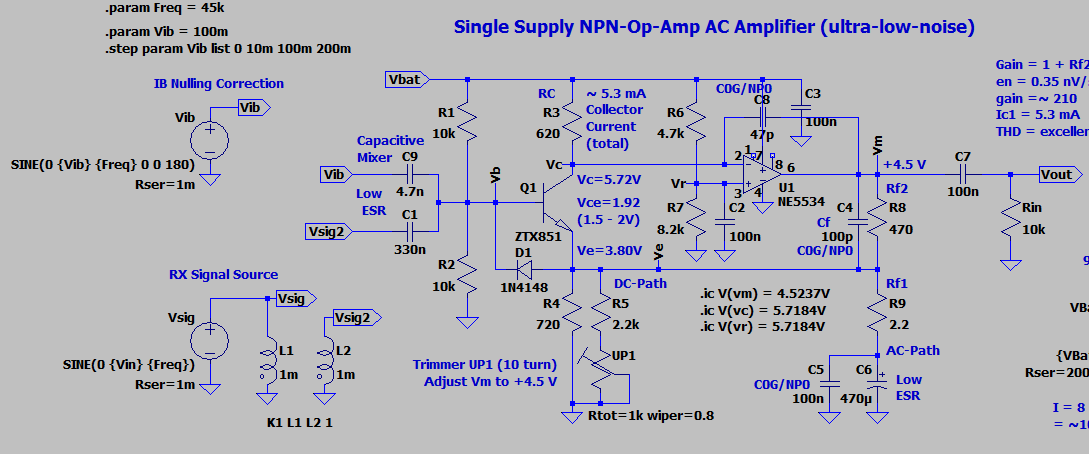

                  • Hi all,
                    regarding the IB nulling:
                    We specify a maximum residual IB RX-coil voltage of 50 mV peak. The RX-coil must be induction balanced to meet this specification. This is a manual process during the making of the coil.
                    The residual RX-coil voltage alone would totally overload our amplifier of course. So we have to electronically null the residual RX-coil voltage.
                    And we specify an IB nulling correction voltage source of 3 V peak (standard output voltage of the sound card).
                    Line output of the sound card:
                    Channel 1 will feed the LC-tank (TX) and
                    Channel 2 will deliver the IB nulling correction voltage
                    So we need a nice mixer to electronically induction balance nulling the residual RX coil voltage to avoid the overloading the amplifier.
                    Output impedance of the mixer at operating frequency must be very very low for ultra low noise operation however.
                    Fortunately, the amplifier has a built-in mixer in the input stage. Let's add an additional input line to the amplifier.
                    Input 1: RX-signal out of the IB RX coil
                    Input 2: IB nulling correction voltage.
                    If we look at the amplifier, the input signal will be fed via C1 (330 nF) capacitor to the base of the transistor Q1.
                    Let's take it and make a capacitive mixer and realise the second input line to the amplifier for the IB nulling correction.
                    We have to translate the high 3 V correction voltage to 50 mV range.
                    Factor: 3 V / 50 mV = 60
                    If we have for C1 330 nF, the second line capacitor coupling input must be:
                    C = 330 nF / 60 = 5.5 nF -> nearest is 4.7 nF
                    There we have our good mixer and saved some additional parts.
                    The following schematic shows the modified amplifier with two input lines:
                    Click image for larger version  Name:	Amplifier+Mixer1.png Views:	0 Size:	53.7 KB ID:	452308
                    The ultra low noise operation is not affected by the mixer as the RX coil impedance line is still very very low. The impedance of the IB nulling input is high. The voltage Vib (+noise in the channel) will be divided by factor 60. The signal (Vsig2) will not be attenuated much (1/60, approx 2%).
                    In the schematics above, L2 is my RX coil. This is not showing the real situation of course. It was required to confirm/review the bull$hit the AI was telling me (post #427, #428 ) .
                    So we have an amplifier with two inputs now.
                    Cheers,
                    Aziz

                      • Hi all,
                        I have used the original Zetex ZTX851/ZTX951 spice models. For exact noise analysis, RB parameters are set wrong or set for (high current) switching characteristics in those models.
                        The typical measured RB parameters are:
                        ZTX851: RB=1.6 Ohm
                        ZTX951: RB=1.2 Ohm
                        So all the nice noise analysis get slightly worse.
                        No worries, we are still below en=0.4 nV/rt Hz.
                        I have to change all the spice model files now.
                        Aziz
                        • e are still below en=0.4 nV/rt Hz. = in Upp nV for 10 kHz signal ?
                          • Hi pito,
                            if you rise C1 a bit, then yes: (Gain=210, Rf2=470, Rf1=2.2, Rs=2 Ohm)
                            C1=330n, en=0.42 nV/ rt Hz @ 10 kHz
                            C1=470n, en=0.40 nV/rt Hz @ 10 kHz
                            C1=1ยต, en=0.39 nV/rt Hz @ 10 kHz
                            But I want to use frequencies above 30 kHz up to 48 kHz. This is the reason, why I kept C1 as low as possible.
                            Aziz
