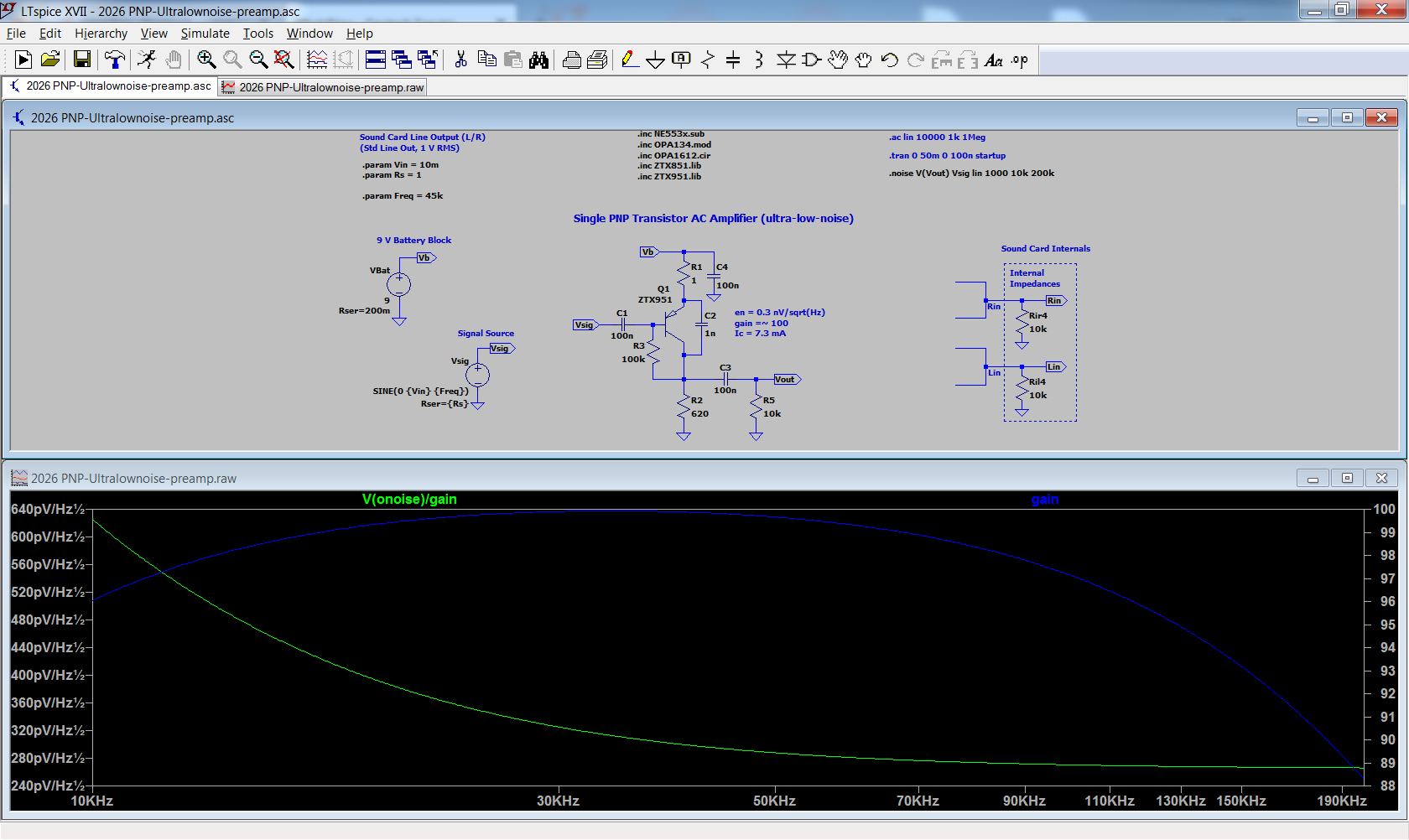

        • Hi all,
          back to the roots.
          This basic single stage PNP transistor AC amplifier outperforms any op-amp designs. Single supply (9 V).
          At my operating frequency of 45 kHz, en is 0.3 nV/sqrt(Hz).
          Oh fck!, the PNP ZTX951 isn't available and is much more expensive than NPN ZTX851 now. What happened?
          No problem, we can do this amplifier with NPN ZTX851 type too. Would get approx. same low noise performance.
          I have to check it out yet, whether temperature drift and gain stability would cause much problems.​
          Aziz

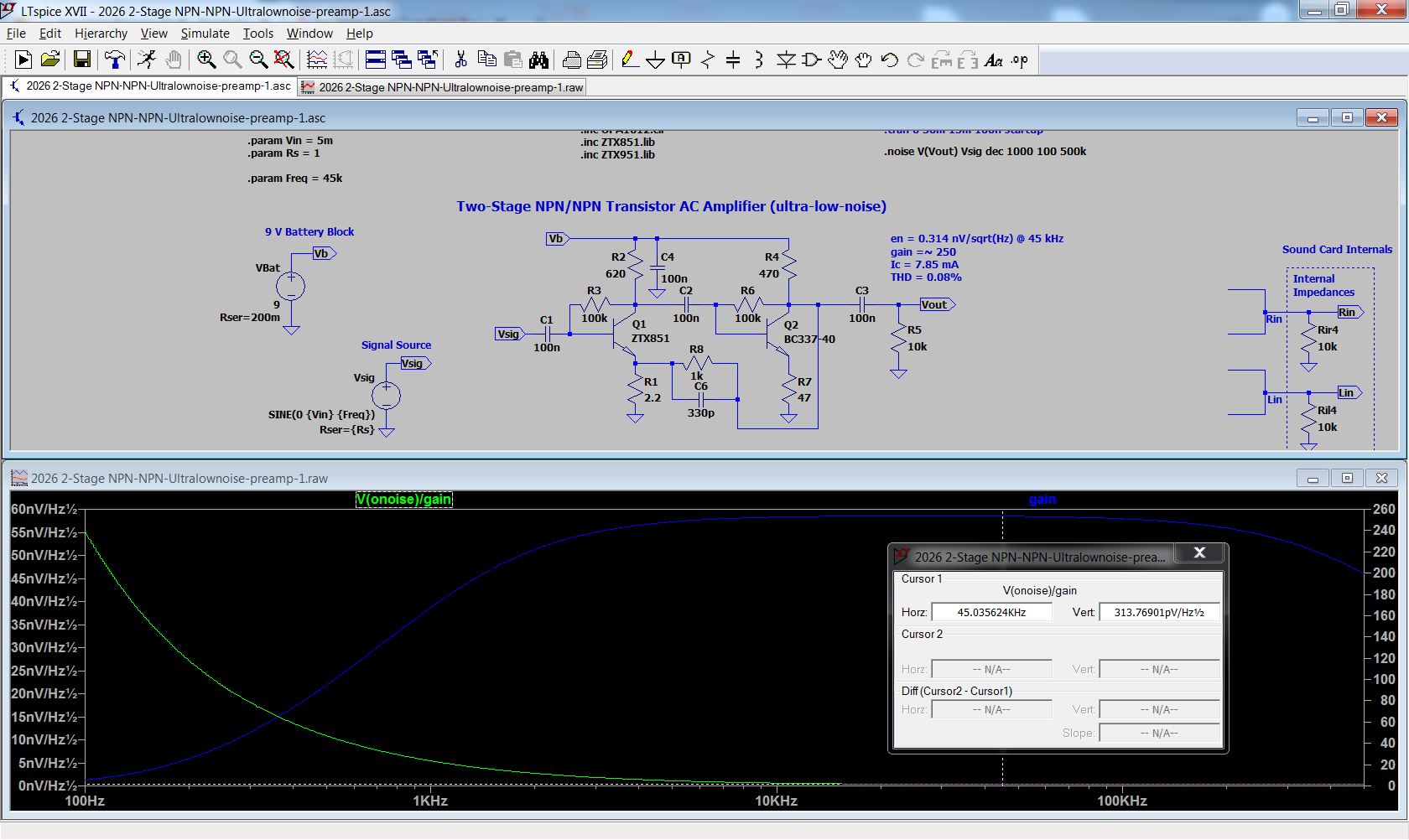

            • Hi all,
              after simulating over a dozen discrete transistor AC amplifiers, I have finally found a good solution.
              Features:
              - two stage discrete transistor amplifier (2x NPN transistors)
              - enough gain (> 200)
              - auto biasing, simple design, with gain loop back compensation and high frequency filter
              - ultra fkn low noise design (0.314 nV/sqrt(Hz) @ 45 kHz operating frequency)
              - less distortion (THD ~ 0.08 %)
              - good voltage swing (between GND and source voltage rail)
              - single supply (9 V)
              But it has it's price: ~ 20 mA supply current. The 9 V block battery will get quickly empty.
              On the other hand, it is an ultra low noise design and still a simple circuit. No op-amps required.
              Single NPN ZTX851 (the low noise transistor), which is cheaper than the PNP ZTX951 variant. The second NPN (output stage) is a very cheap NPN transistor (what you have in your box).
              This is the current schematics:
              It might work well for my application. But I have to try it out.
              :hat
              Cheers,
              Aziz

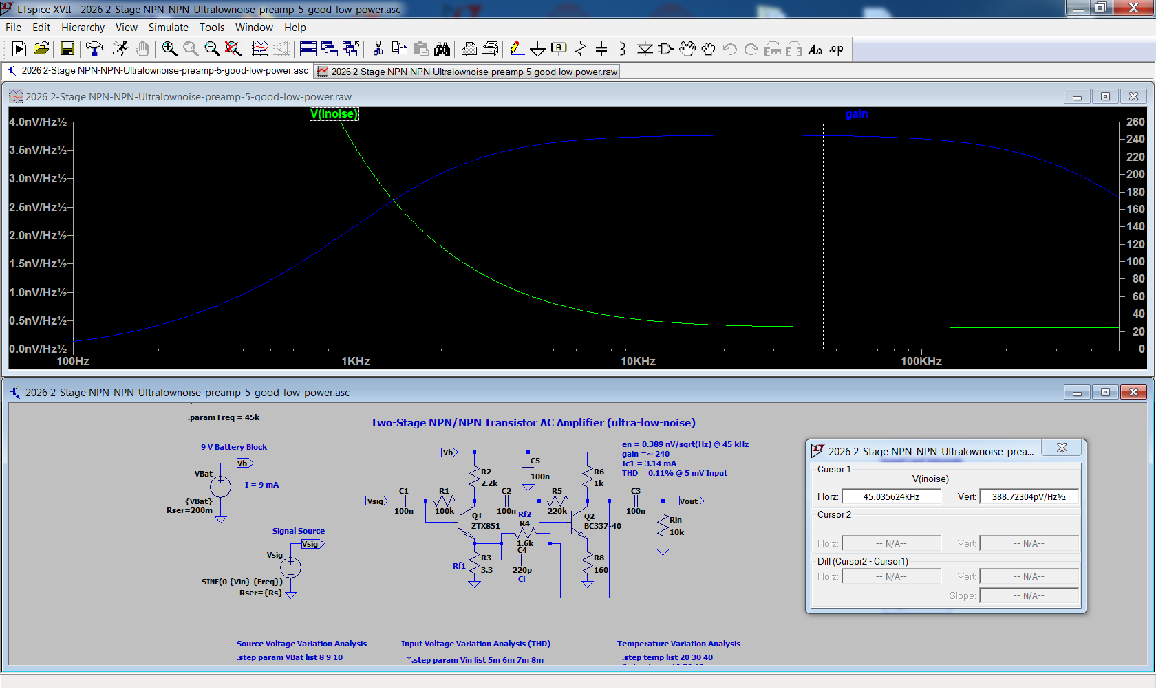

                • Hi all,
                  the power consumption was too much of the latest discrete amplifier. By reducing the collector currents and changing some parts value, it is still possible to get good low noise performance.
                  I have reduced the power consumption to 9-10 mA now.
                  This simple circuit has two major disadvantages however:
                  - Gain is dependent on temperature changes (can change up to 5 %)
                  - Gain is also dependent on battery voltage level (battery voltage diminishing)
                  It may cause heavy drift issues on ground balance part. I'm sure, this can be solved in the software part. This is the price of being simple circuit.
                  To overcome the issues, we have to use an op-amp for the second stage. I have to look for an old design yet.
                  I have prepared the LTspice commands for the simulation. Just activate them and look at the circuit simulation.
                  Cheers,
                  Aziz

                      • Hi all,
                        the dual op-amp version gets even much more quiet. The load drive resistance of the NE5532 can even go below the specified 600 Ohm. And we can go with the input referred noise density (en) below 0.3 nV/sqrt(Hz) at 45 kHz. This is a new record.
                        With a single ZTX851 (NPN) only. Paralleling ​of more ZTX851 isn't required at all. Would not give any benefit.
                        More later...
                        Aziz
