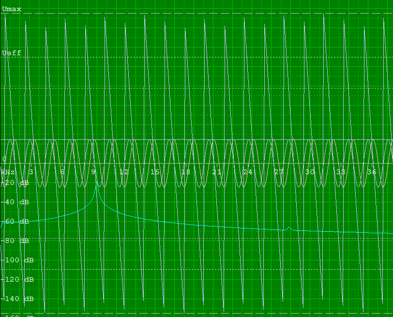

                • Hi all,
                  The Google AI isn't perfect. The posted code for unwrapping the phase doesn't work. I have taken another (simple) solution, which works.
                  This is the reason, why we urgently need the phase unwrapping, before we can calculate the d Phi()/dt correct.
                  You can see below, that the phase ist switching between pi (Umax-Level) and -pi (-Umax). This is the input of the LC Franklin oscillator. With I/Q channels, Envelope(t) and Phase(t).
                  The Oscillator is running at appr. 9.2 kHz.
                  If we take all the linear phase lines and put them together, we would get a very long straight line. This is what phase unwrapping does.
                  Aziz
                  • Hi,
                    I'm using the following basic phase unwrapping function (it was the first proposal of Google AI):
                    Code:
                    // Phase Unwrapping (Phase linearising)
                    // [OUT] REAL *pOutput: Pointer to Output Phase Data (Radiants)
                    // [IN]  REAL *pInput:  Pointer to Input Phase Data (Radiants)
                    // [IN]  int n:         Number of Phase Data
                    void unwrapPhase1D(REAL *pOutput, REAL *pInput, int n)
                      REAL wrap_count, diff;
                      int i;
                      ASSERT(pOutput);
                      ASSERT(pInput);
                      if (n <= 0)
                        return;
                      wrap_count = 0;
                      pOutput[0] = pInput[0];
                      for (i = 1; i < n; i++)
                        // Current difference
                        diff = pInput[i] - pInput[i-1];
                        // Detection of phase jumps > pi or < -pi
                        if (diff > PI) {
                            wrap_count -= 1;
                        } else if (diff < -PI) {
                            wrap_count += 1;
                        pOutput[i] = pInput[i] + wrap_count * PI2;
                      } // for i
                    PI2 is 2.0*PI
                    It's not perfect but it works. I am able to calculate d Phi(t)/dt and therefore the instantaneous​ frequency of the demodulated signal. In this example above, the Franklin LC oscillator frequency. It is quite stable (+/- 1 Hz or less).
                    Cheers,
                    Aziz

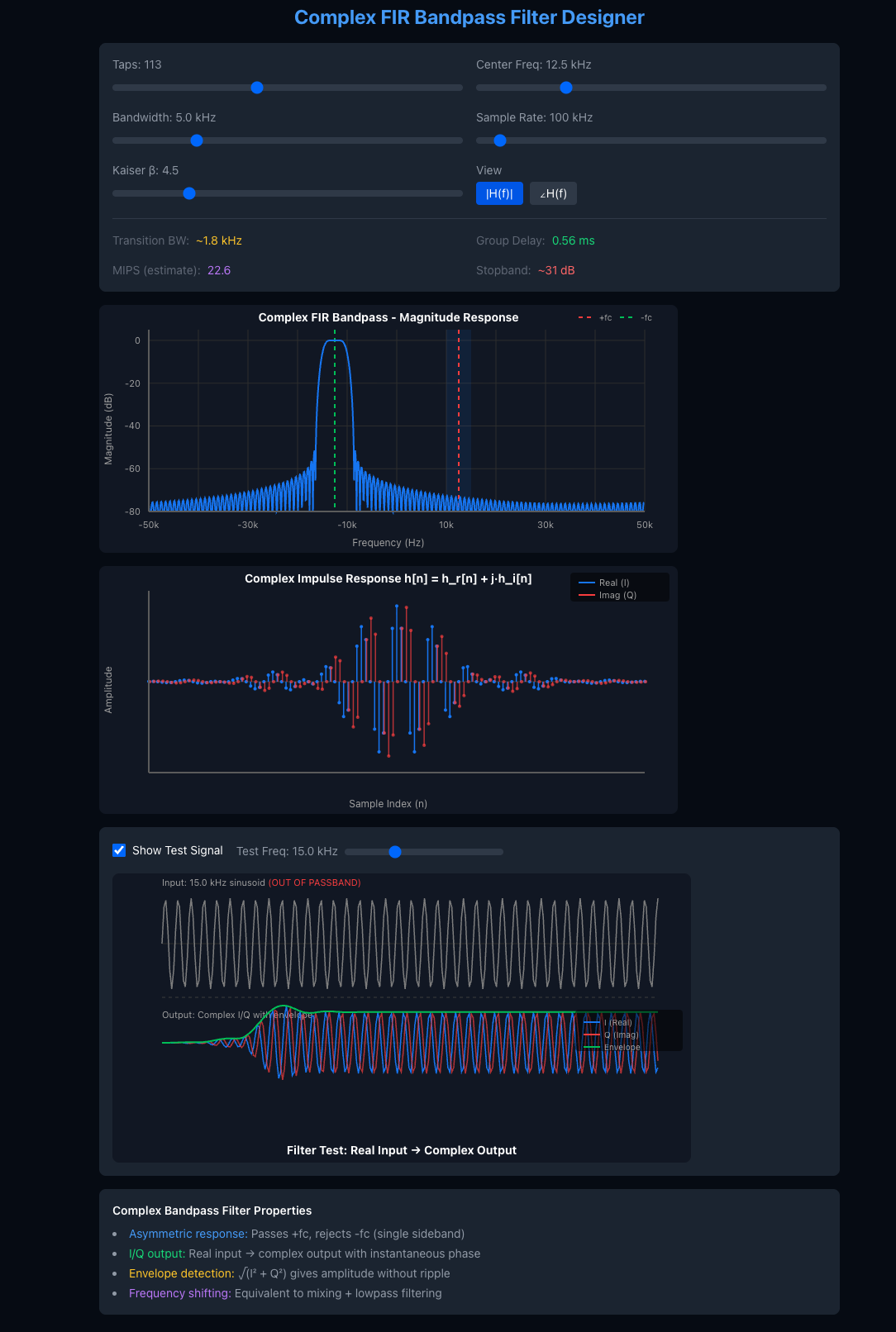

                      it get's even better with a Complex FIR-Bandpass-Filter design (it is based on Hilbert-Transform of course).
                      Both I/Q-channels will be bandpass filtered.
                      I hope, the magic AI does not make any bugs in the coding. I will feed in magic input.
                      Aziz
                      • Hi all,
                        the Complex FIR-Bandpass-Filter design​ seems to be too complex for AI.
                        I'm on the 7.th version of the AI code. It made lots of bugs.
                        fir_process_block()

                          Hi all,
                          fir_process_block()
                          fir_process_block_fixed()
                          fir_process_block_optimized()
                          fir_process_block_fixed_final()
                          fir_process_final()
                          fir_process_verified()
                          fir_process_perfect()
                          ​:rotfl
                          What's missing?
                          fir_process_ultimate()?
                          Enough for today.
                          ...Aziz you are using the wrong AI. This demo took 2 minutes to build in javascript ( first attempt ) and generates C or python code outputs.
                          Click image for larger version  Name:	image.png Views:	0 Size:	168.1 KB ID:	445145​
