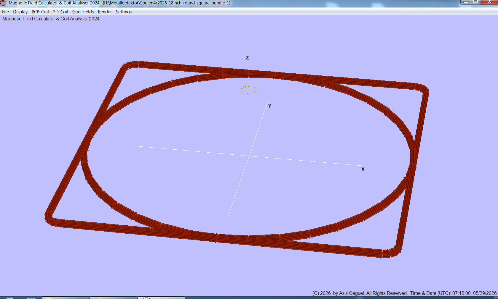

            This is the coil model (both shown at same position). The super cheat: "same size coil". You swing a "same size coil".

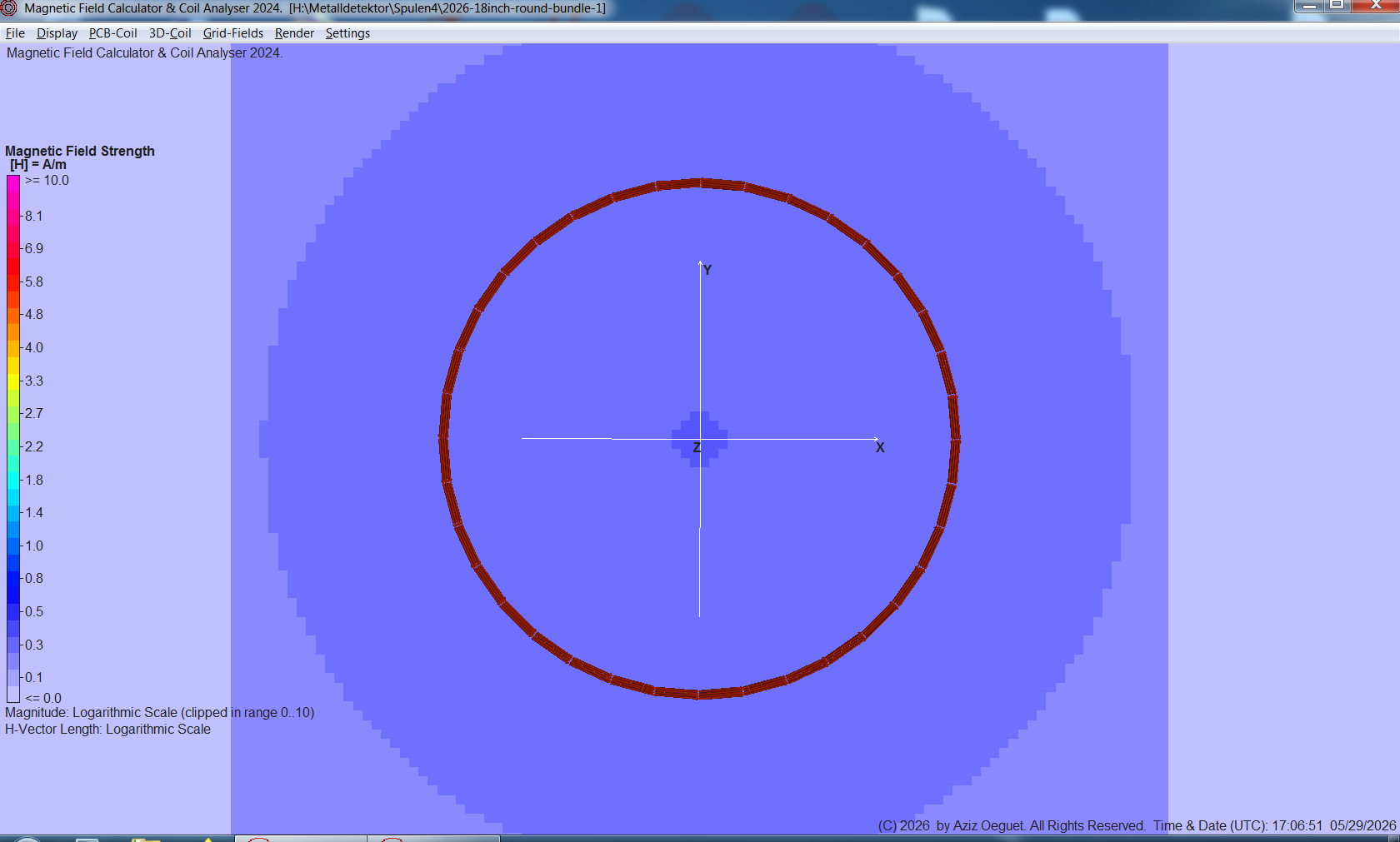

              • Hi all,
                this is the target response comparison of the 18 inch round vs square mono coil (see zipped Excel file in the attachment).
                I am still using my 20 mm diameter standard target.
                My coil bundle is 8 x 8 mm in this example. It is very compact. This is the worst you can ever do.
                If you wind a mono coil, you should have 20 x 20 mm or 30 x 30 mm coil bundle thickness. The more, the better.
                -> more Ampere-turns count
                Note, that the square coil has more space to be well wasted in thicker coil bundle.
                Aziz

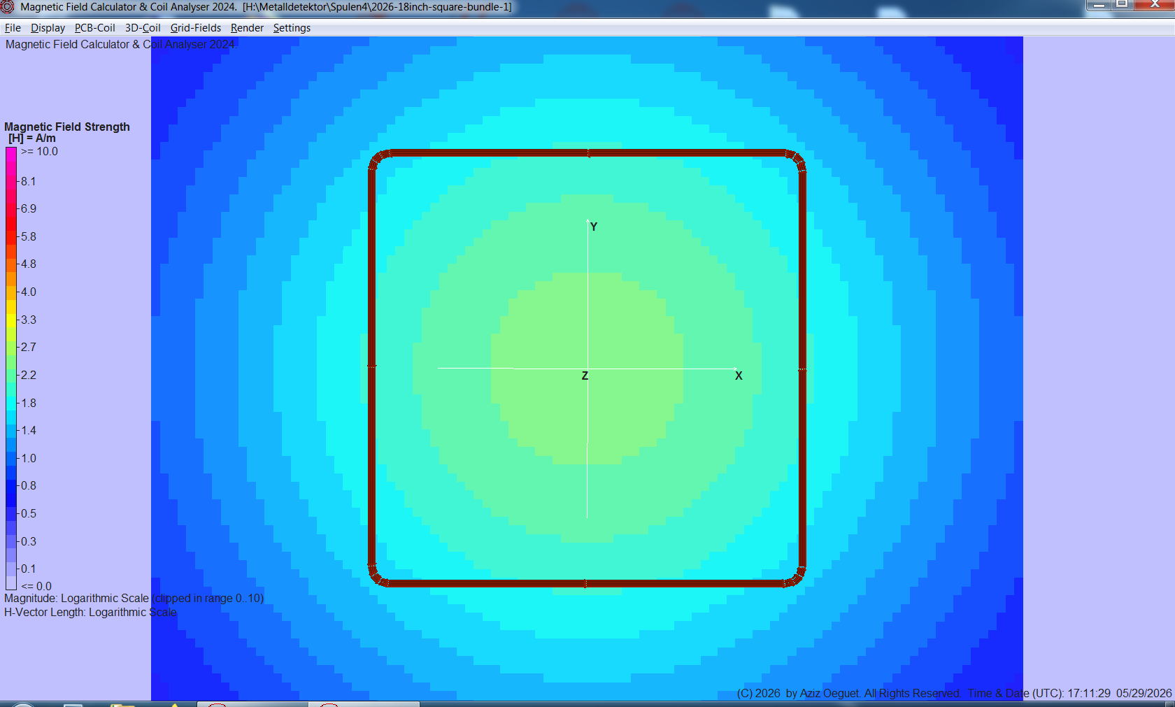

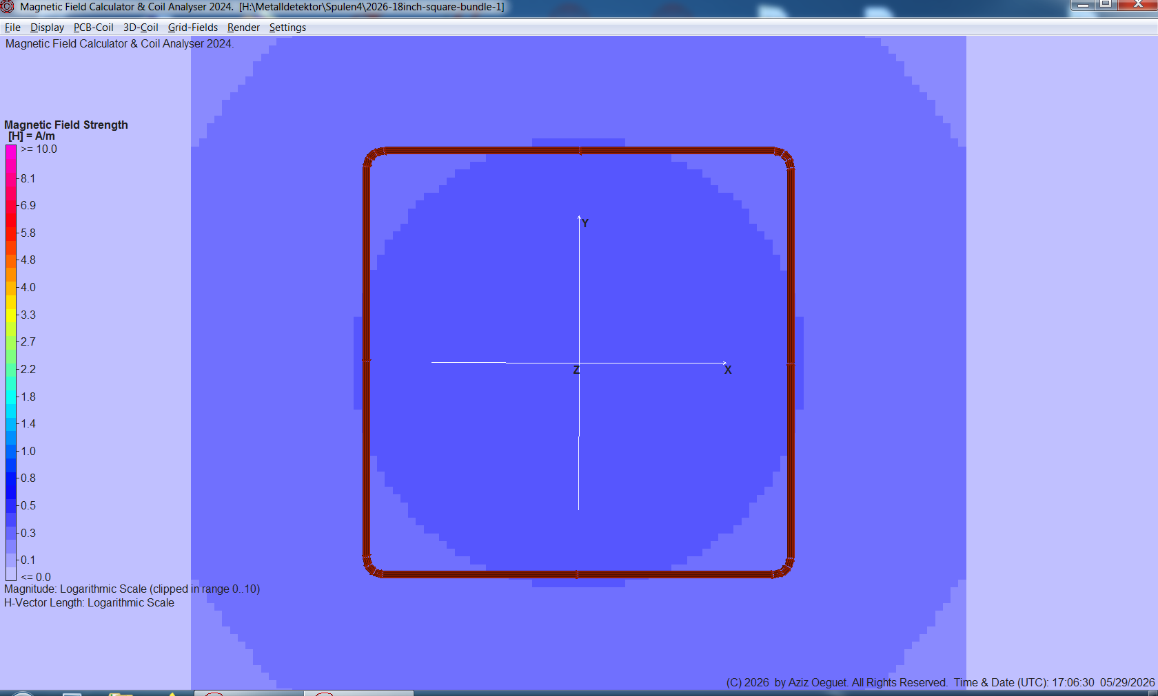

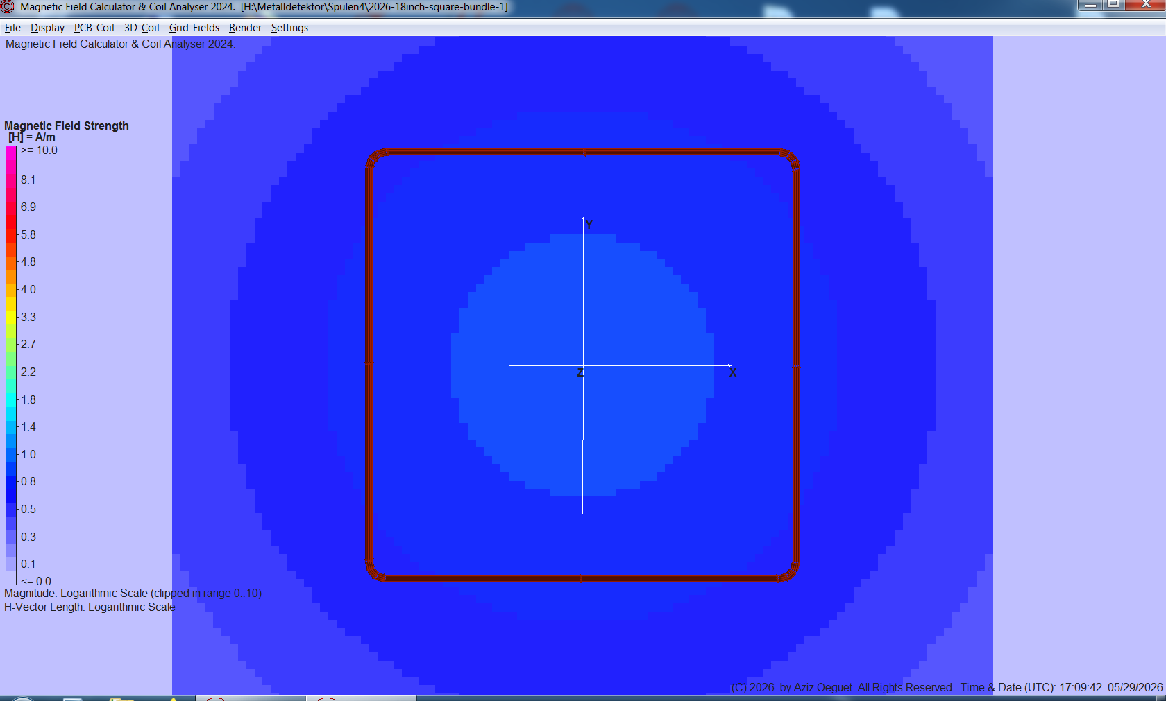

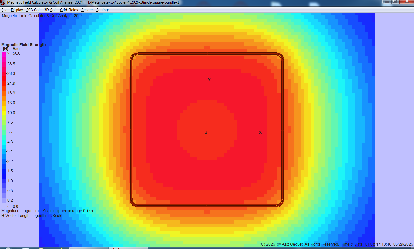

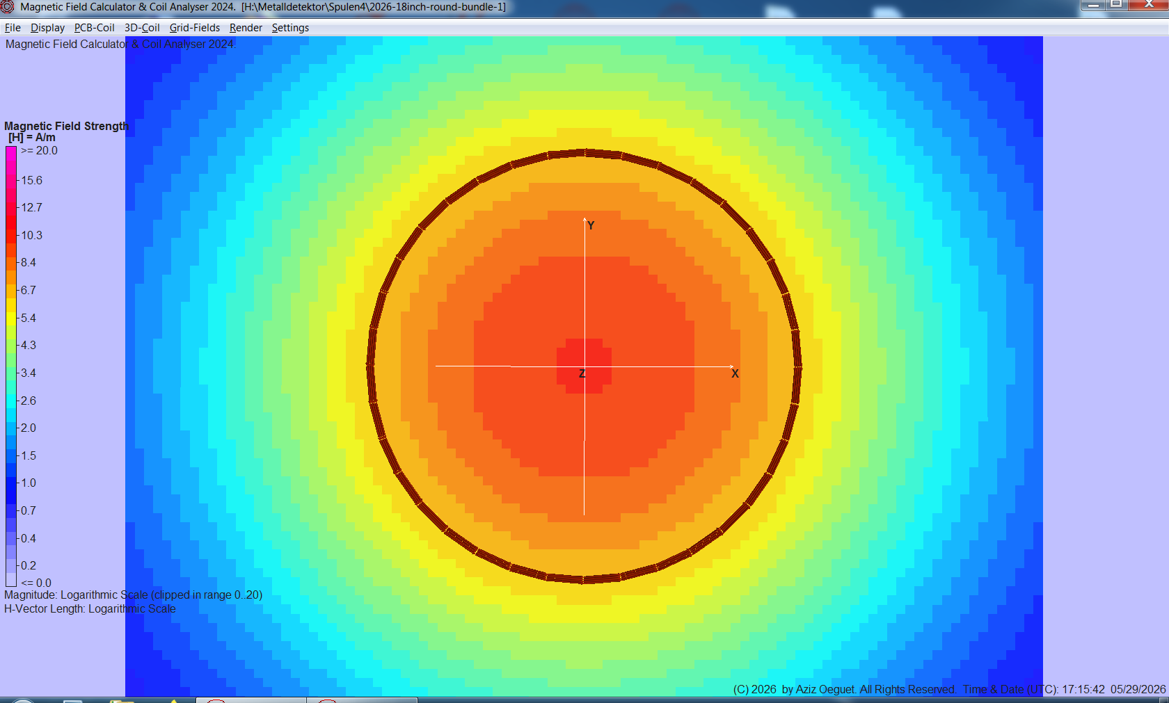

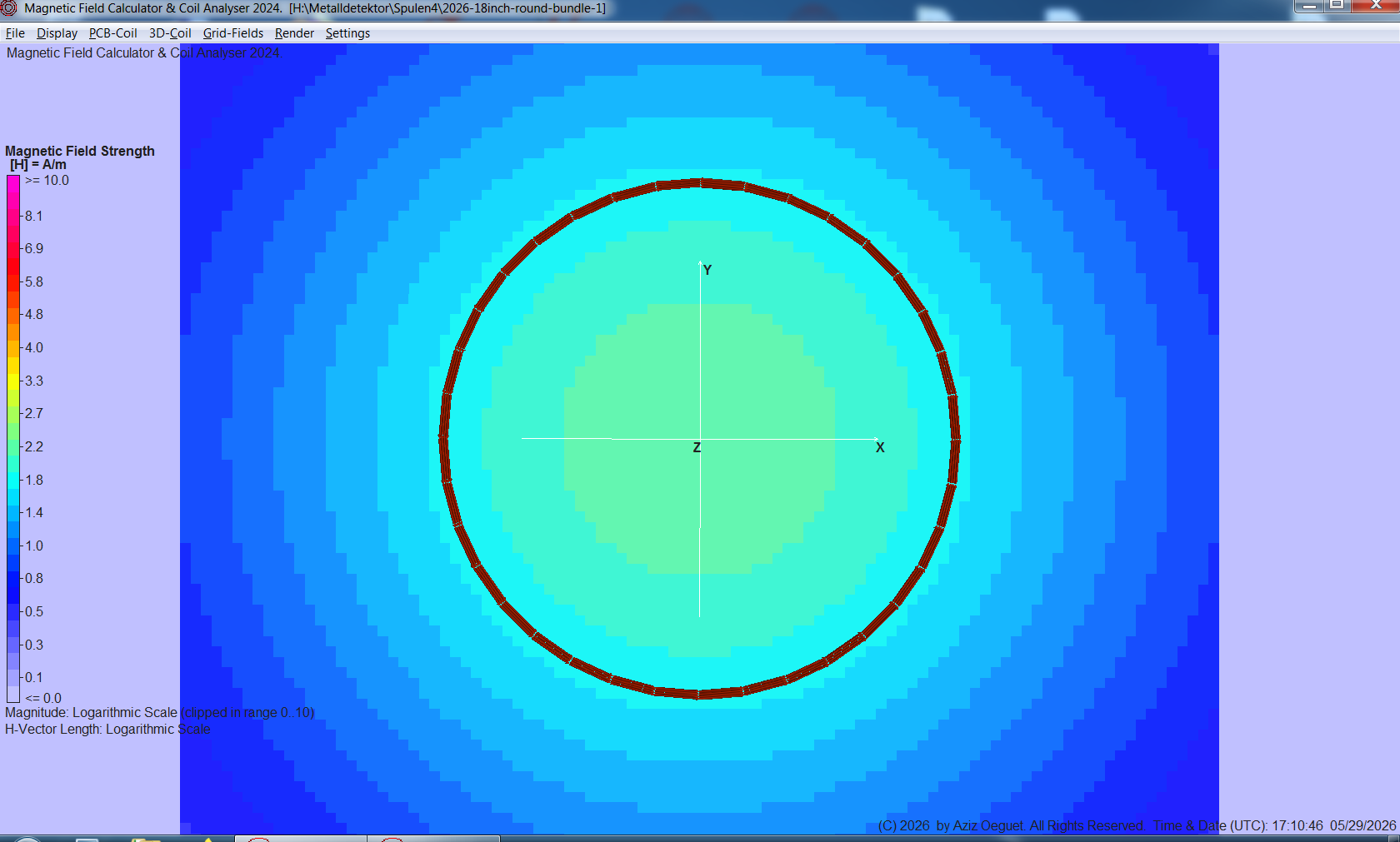

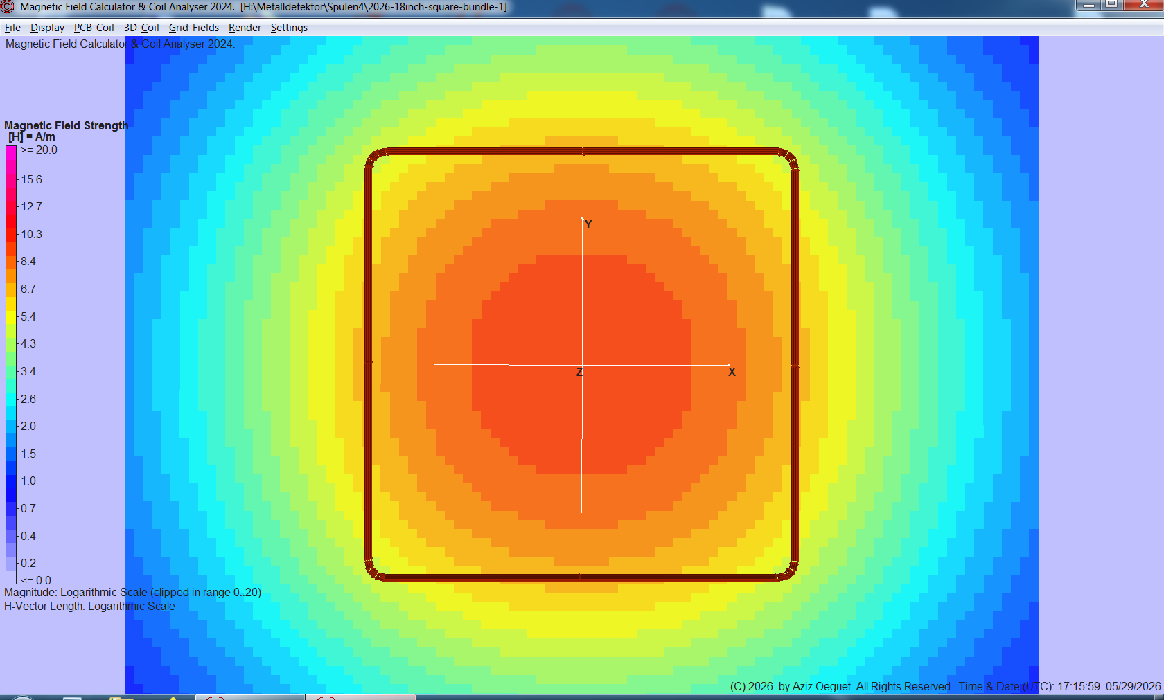

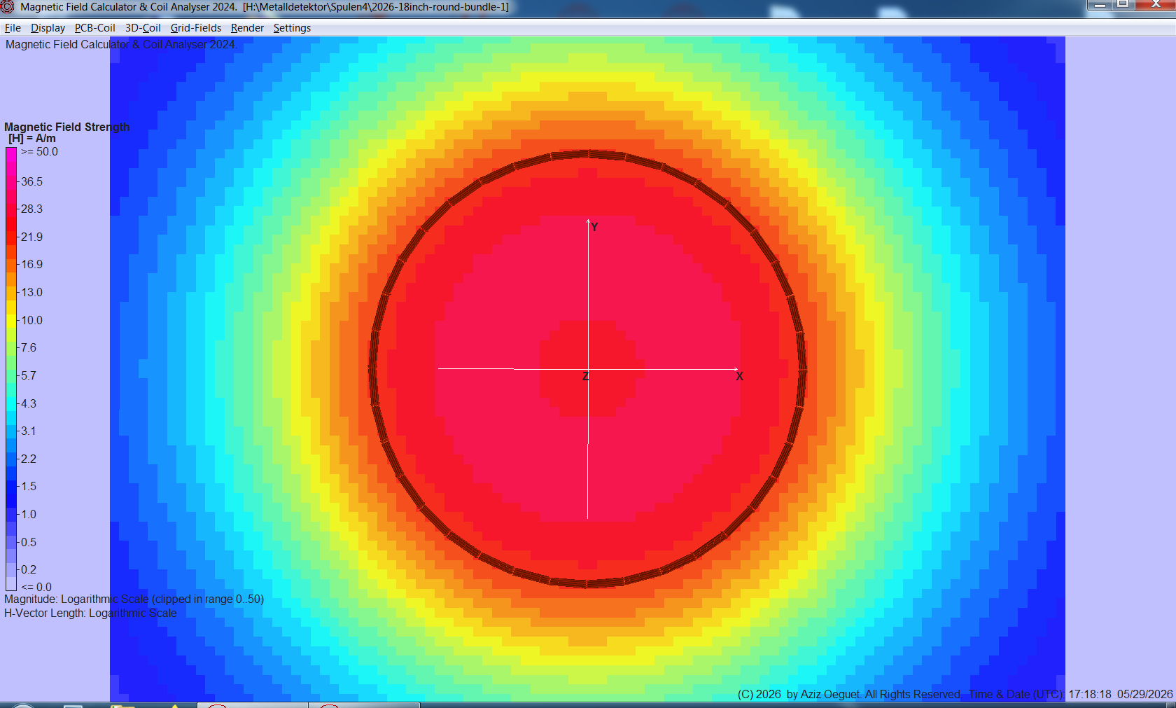

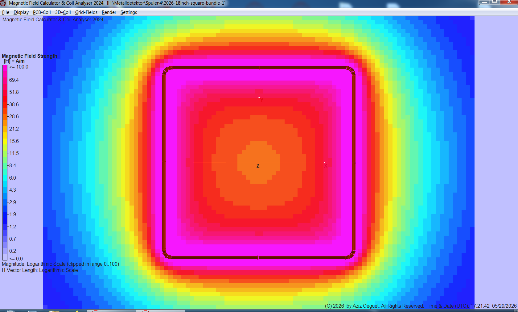

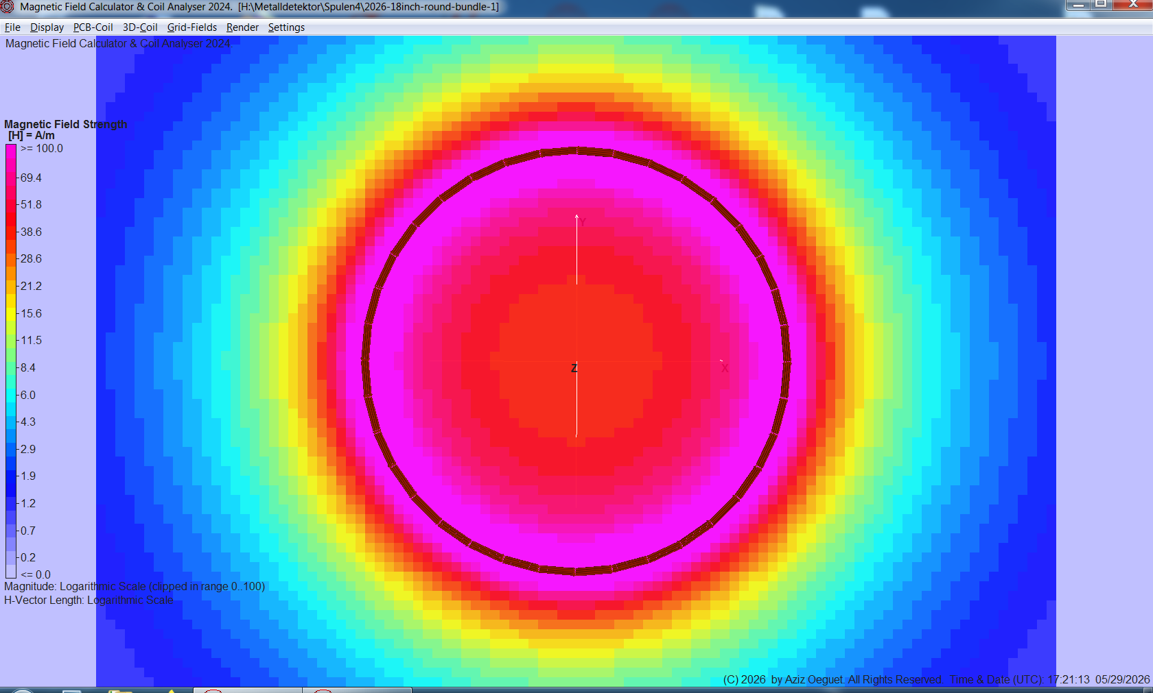

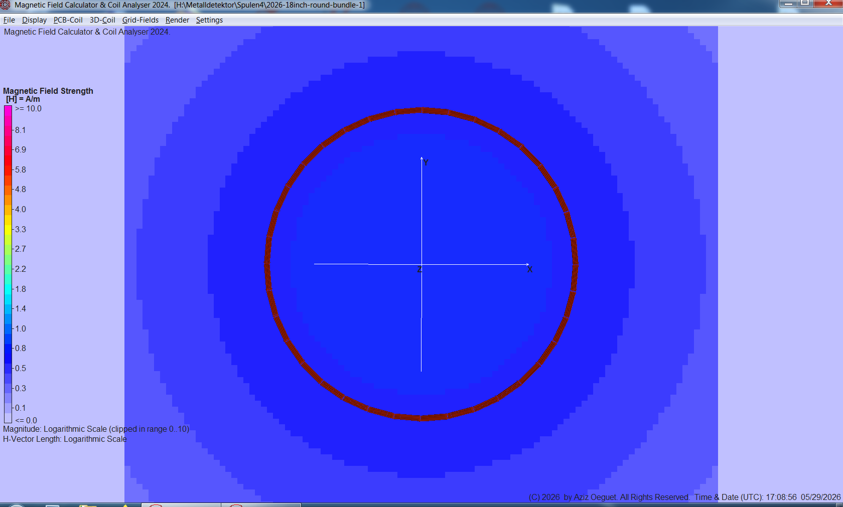

                • Hi all,
                  now the comparison of magnetic field cross-sections at different z below the coils.
                  I have reduced the number of palette colors to have discretised magnetic field strenght regions.
                  And I had to change the scaling range.
                  File names describe the coil name and z position.

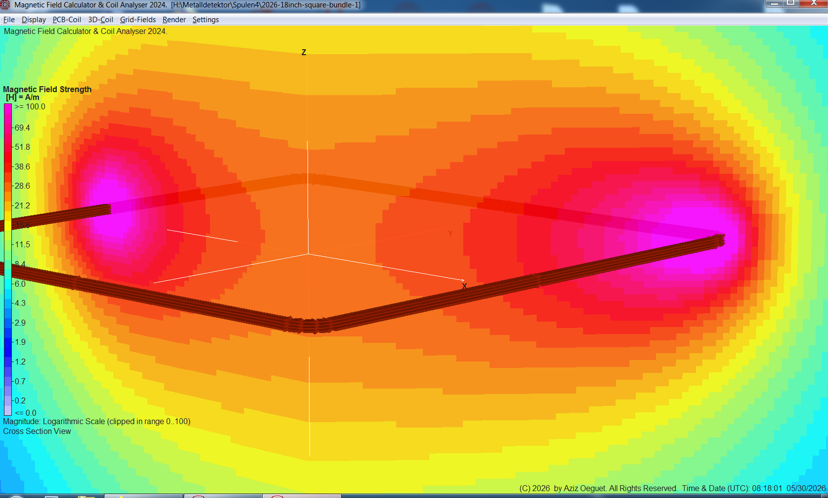

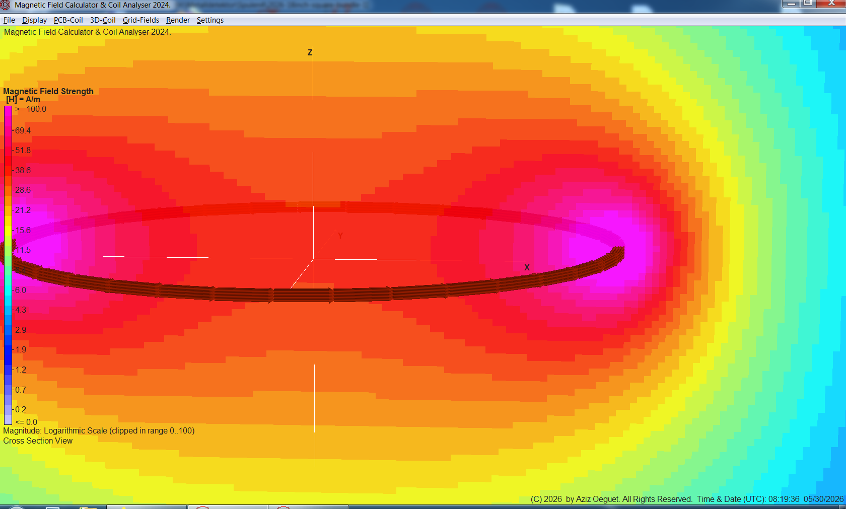

                  • two more
                    • side view cross-section
                      • Originally posted by Tinkerer View Post
                        Have you taken into account the uniformity of the coil field?
                        With the round coil the field(lines) is the most uniform and gives the biggest depth.
                        With the square coil, the field is less uniform. In the 4 corners the field it "pinched". The "pinching" produces more divergence of the field(lines) when coming out of the "pinched" area.
                        The divergence is greater with a small diameter coil than with a large diameter coil. Because of the divergence, the same field (strength) at the coil level gets more "diluted" at distance.
                        Agreed, a round coil is the most efficient structure at generating a magnetic field. A square coil with the same size and N will always have lower inductance.
                        It also happens on the RX side: a round coil is the most efficient structure at coupling to the target's eddy field. An equivalent square coil will always produce less EMF.
                        The easiest thing to do is wind a round coil and equivalent square coil and see which one detects deeper.
                        • Hi all,
                          oh well, I had expected a higher magnetic field strength at the inner corner regions. This is not as much as I have really expected.
                          So the rotation of 27 degree angle of the coil can be totally neglected.
                          But the 90 degree rotation makes still sense for the larger search area coverage during swinging.
                          Nevertheless, this cheat is a great improvement. For big deep gold, the detection field area at depth is larger compared to round coil.
                          I for one would prefer square coils now. Simple to build with rectangular coil frames.
                          No more round coils anymore.
                          Aziz
