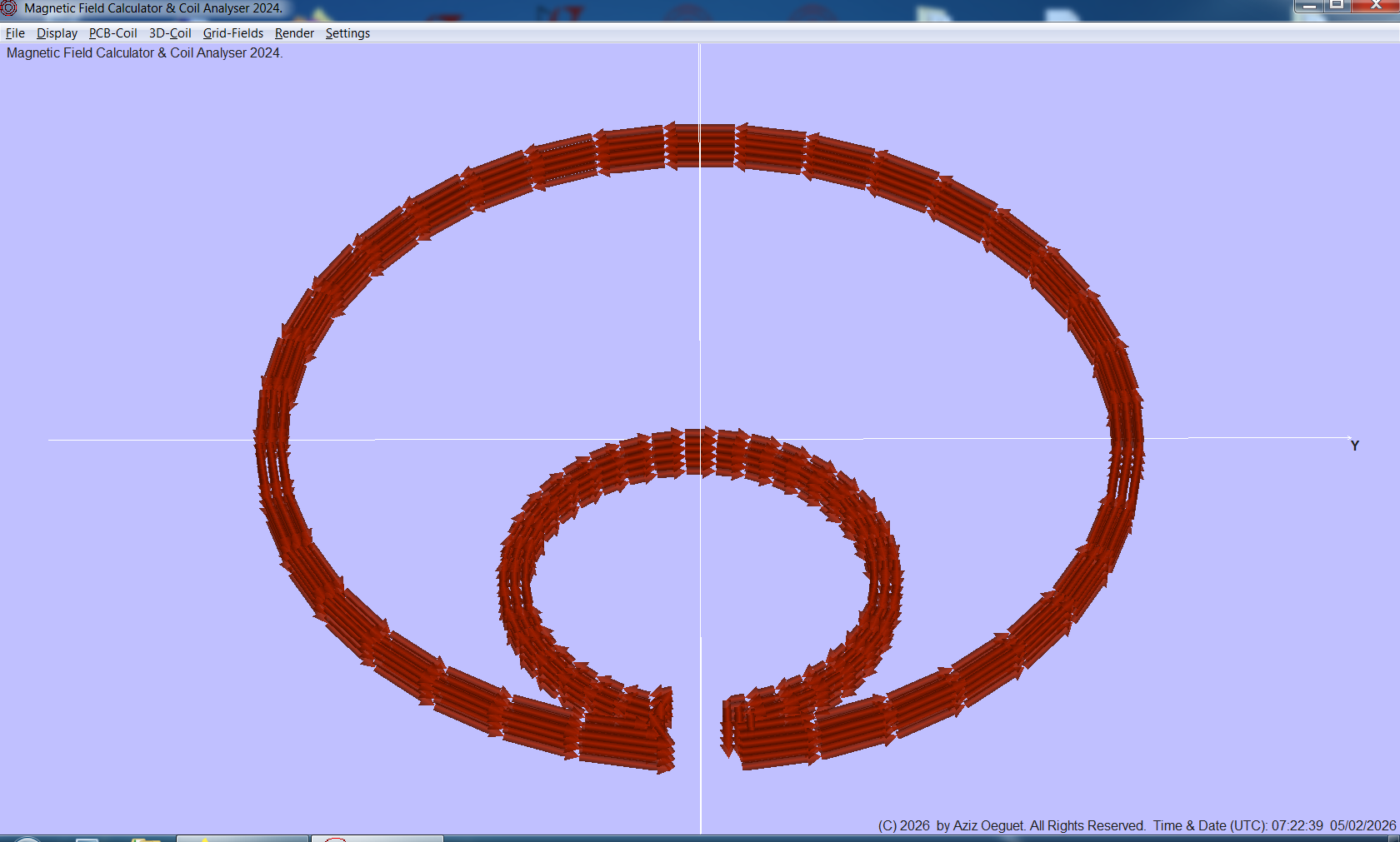

    there are obviously some restrictions and limitations in the coil geometry definition. Dilate and contract will not work if the coil has concave and convex structure at the same time.
    Best example is the omega coil shown below.
    At the bottom part, the connections from the inner to the outher coil are wrong.
    This will lead to little inaccuracy in the numeric calculations.
    But there is a work-around possible. Define each path individually and build the bundle.

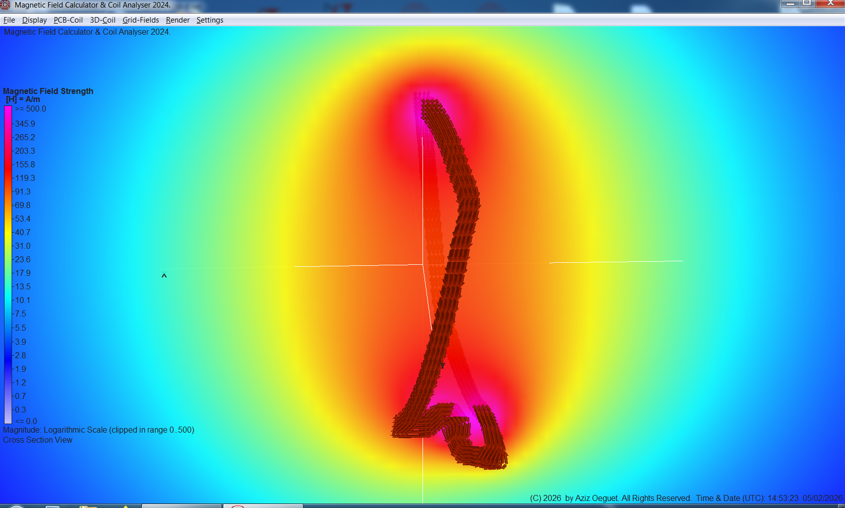

      • Have a look.
        A completely irregular coil bundle.
        I am testing the coil software.
        Click image for larger version  Name:	Irregular-Coil.png Views:	0 Size:	552.8 KB ID:	448011
        Nuclear fusion coil should be possible to model.

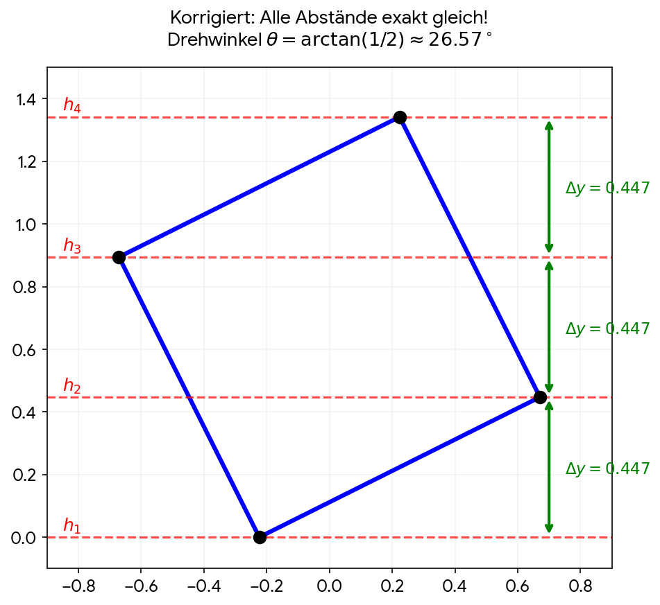

                    • Hi all,
                      and what consequences have the square coils during the swinging?
                      And how the square coil is rotated to the swinging direction?
                      0 degree, 45 degree (max diagonal), or the optimal 4-pin-point coverage degree?
                      More ground coverage?
                      More pin-pointing regions (at the corners), evenly distributed to the ground coverage depending on the rotating angle of the square coil (up to 4 pin-point regions possible)?
                      You see, the question is not trivial.
                      • The AI says, if rotating the square coil by approx. 26.6 degree,
                        we would have an evently distributed pin-pointing coverage (4 pin-point regions).
Name:	optimal 4-pin-point coverage.png
                        This orientation would pickup small targets as well. You won't miss the target anymore, if you swing a large square coil.
                        :examine
                        This is a rocket science now. Nobody has thinked of it till now.
                        :rotfl
                        Aziz

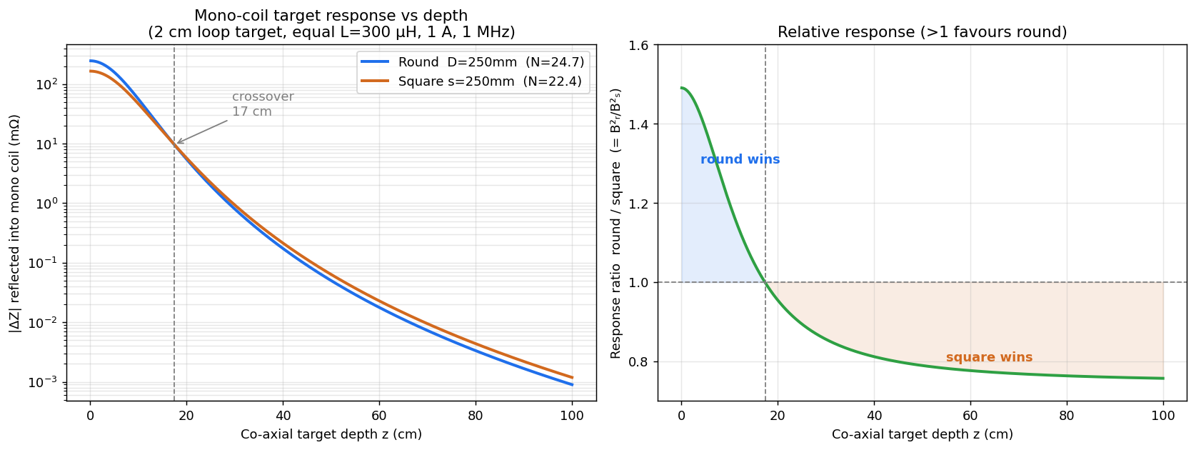

                          • Ran your prompt, Aziz — and your 7.9% holds up.
                            Setup (your spec): round coil dia D vs square coil side D, both wound to
                            L = 300 uH, 15 mm bundle, 1 A. Target a shorted 1-turn loop, 20 mm dia /
                            1 mm wire. Concentric on-axis z-sweep, 0 to 1 m. Mono coil, so the target
                            response goes as B-squared.
                            To hit the same 300 uH the round needs ~24.6 turns, the square ~22.4 — the
                            square encloses 27% more area per turn, so it gets to 300 uH with 9% fewer
                            turns. Net magnetic moment: square +15.8%. Expressed as your "equivalent
                            radius" (m scales as R^2), that's +7.6% — basically your 7.9%, the gap is
                            just inductance-formula constants. So the AI and your coil software land in
                            the same place.
                            Two things the "simple cheat" framing skips though:
                            1) +7.9% radius is NOT +7.9% depth. A mono coil's response falls off as
                            1/z^6, so the +15.8% moment = +34% signal at depth, but only ~+5% actual
                            detection depth once you take the sixth root. Real, but small — reading the
                            7.9% as a depth figure overstates it by about half.
                            2) There's a near-field crossover at z ~ 0.70 D (~17 cm for a 250 mm coil).
                            Shallower than that, for a small co-axial target the ROUND coil wins — up to
                            +49% right at the surface — because it stacks all its turns at one radius
                            and gives a tighter, higher central field. The square only pulls ahead past
                            the crossover. So it's specifically a deep-target cheat; on shallow small
                            gold it's a slight penalty.
                            Bottom line: square buys a few % more depth on deep targets, paid for with
                            some near-surface punch on small ones. Not a free lunch, but a genuine (if
                            modest) deep-target edge — and your "equivalent radius" intuition was right.
                            Plot attached: |dZ| vs depth for both coils, plus the round/square ratio
                            showing the crossover.
                            (All for a concentric co-axial target — off-axis / swing geometry is a
                            separate question, which is where your 26.6-degree pinpoint idea comes in.)
                            ​Click image for larger version

                              Now the big suprize is comparing against big deep gold (larger target sizes, lets say 4-10 cm diameter target).
                              The square coil definitely wins!
                              This is really nice.
