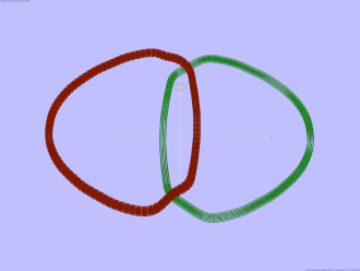

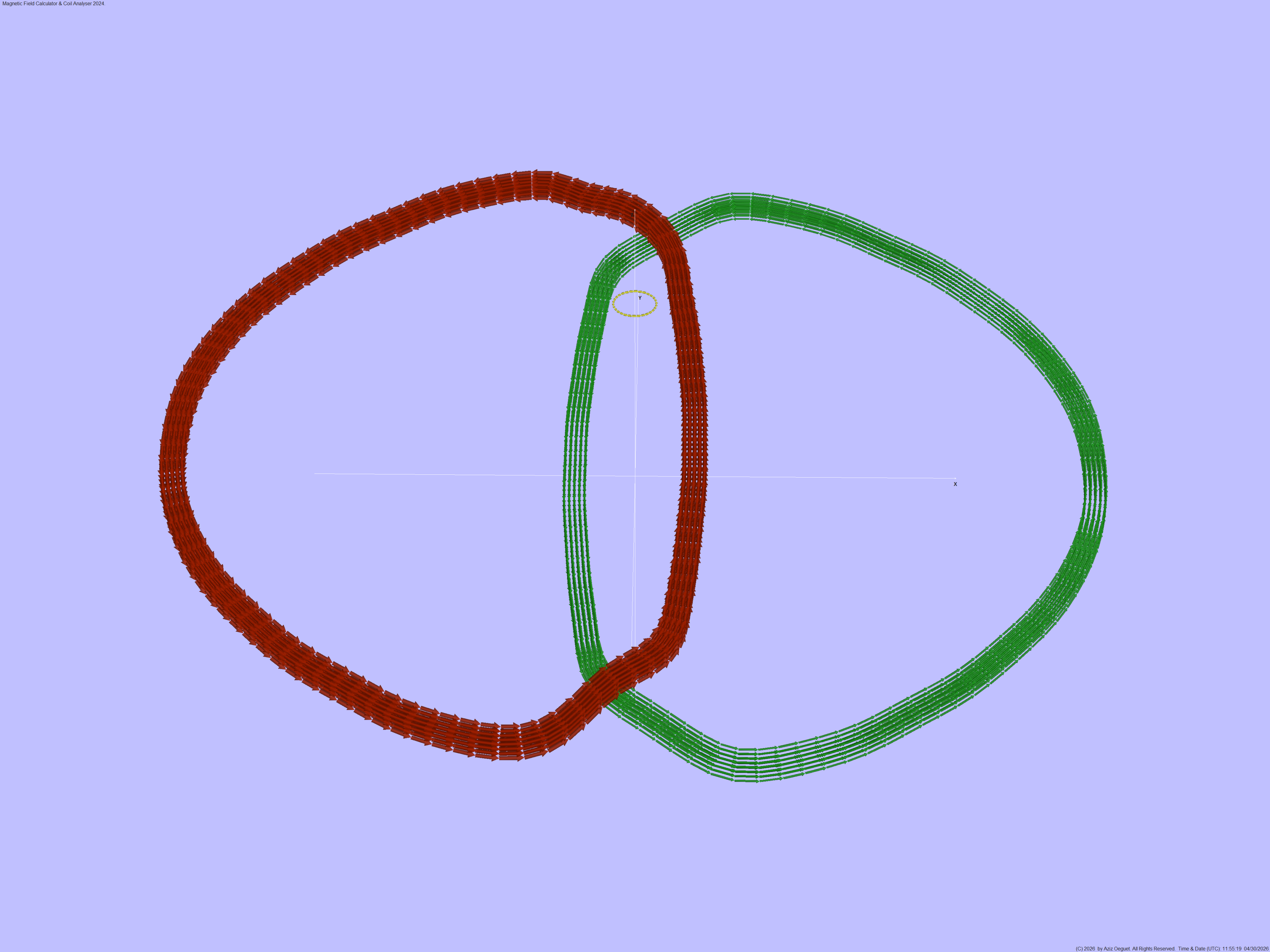

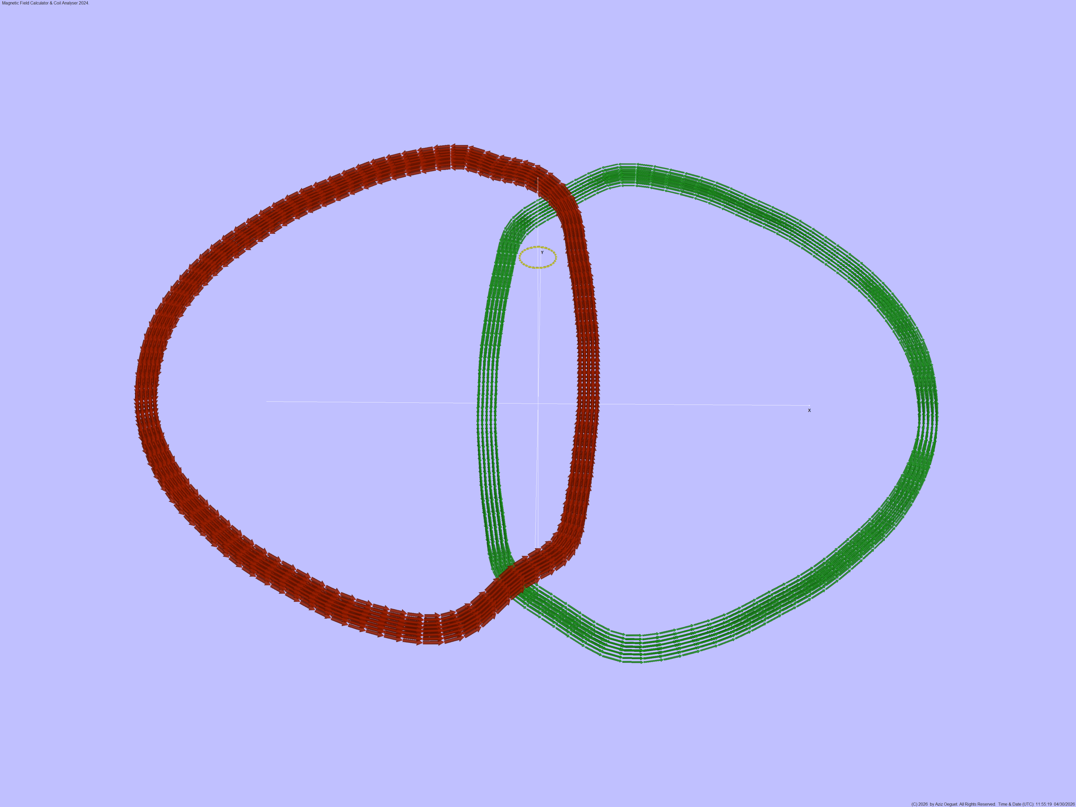

          • Hi all,
            now lets try with a different AI approach to solve the dilate/contract issue. I am sure, it can solve the issue with ease this time.

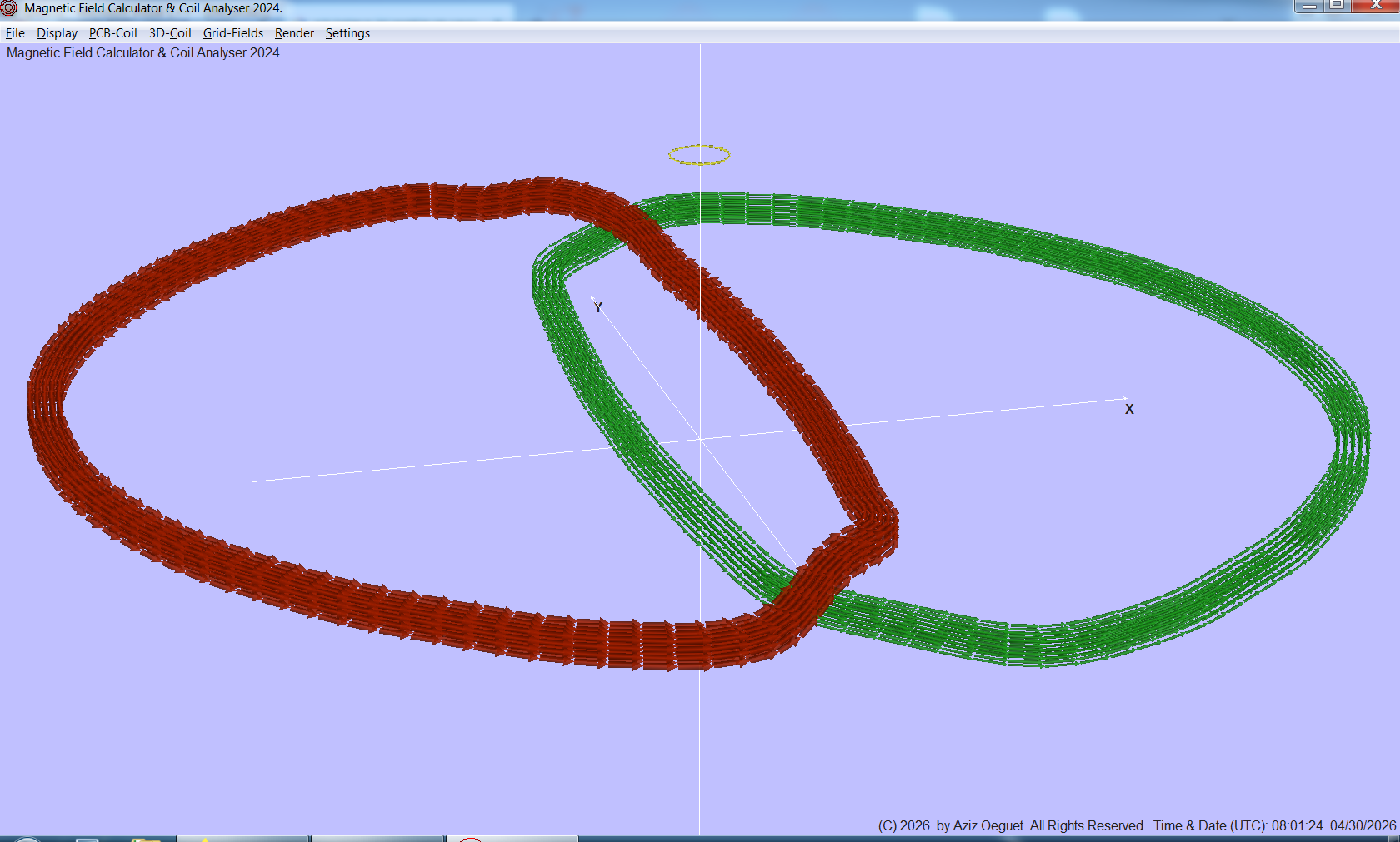

            • Hi all,
              the dilate/contract feature works now perfekt. Even with z-coordinate variation.
              The coil bundle is perfect now.

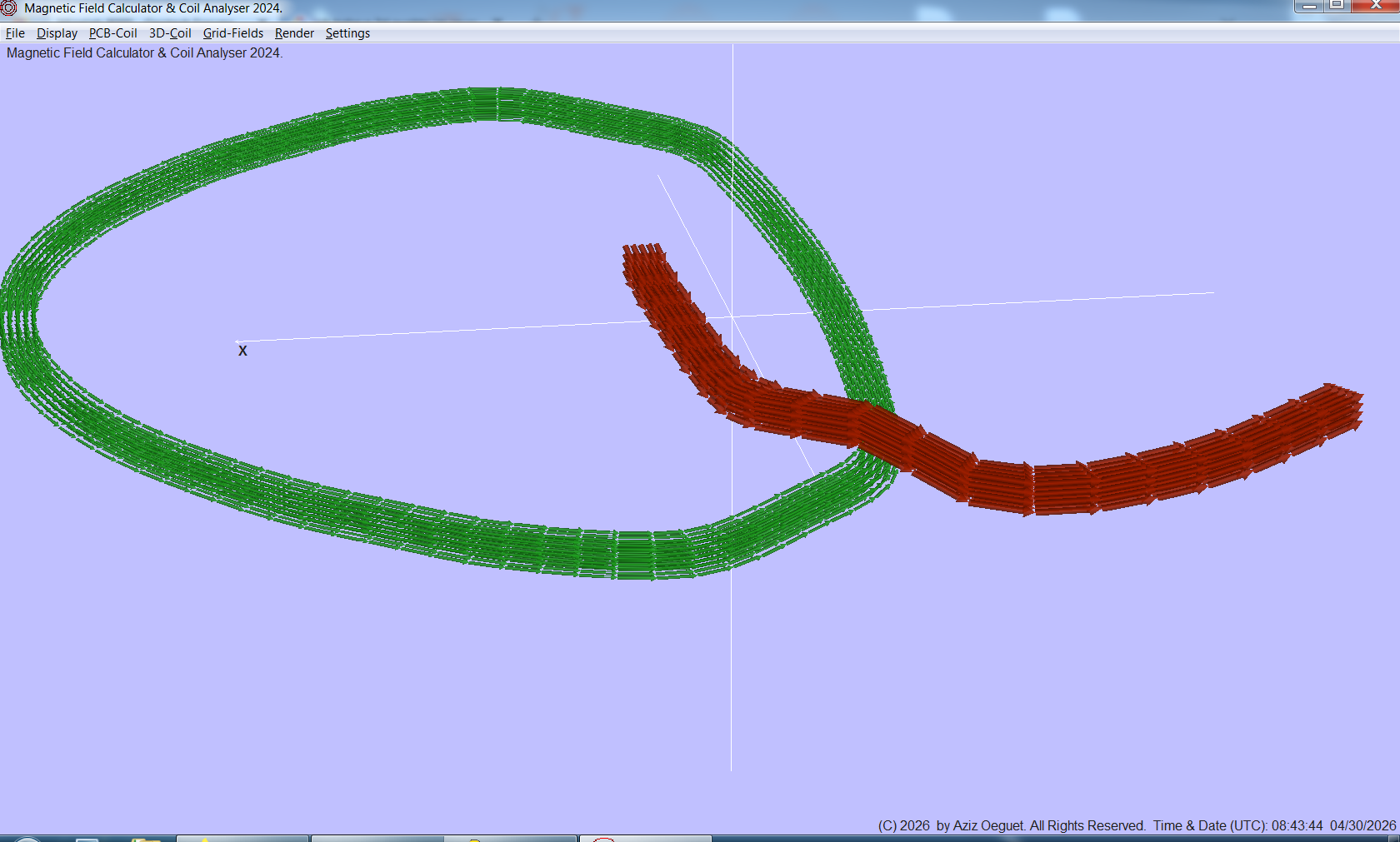

              • It is even working correct for an open coil bundle.
                Nice.

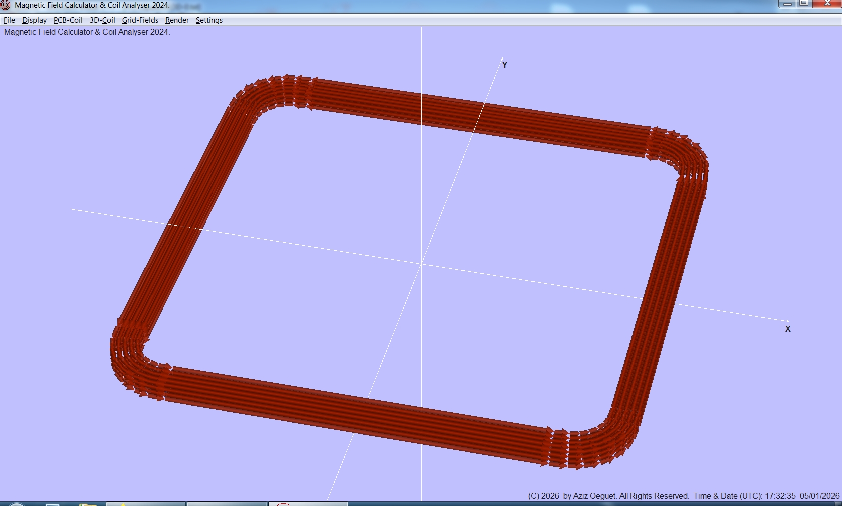

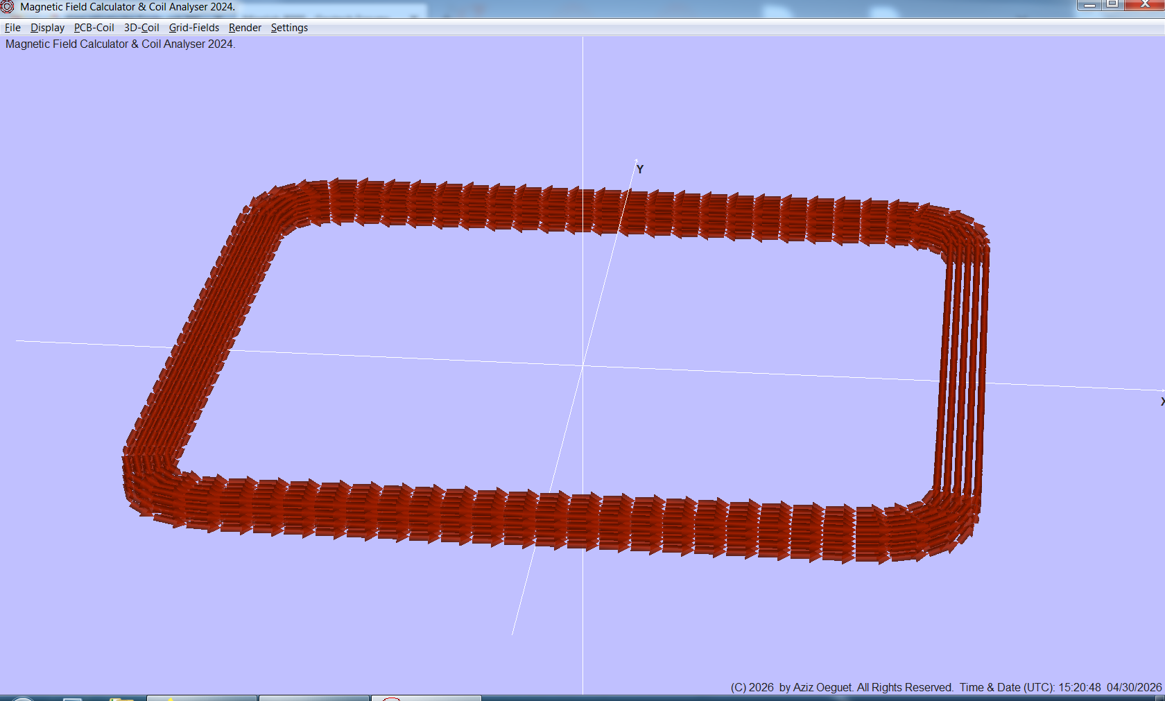

                    • Oh man!,
                      the AI on spline interpolation fails, if there is a collinear path. I had to fix it. And it deforms a rectangular path with round corners too.
                      But there is a work-around in the geometry description language, which fixes it.
                      Code:
                      //round rect 20x20 cm (mean), 2 cm radius on corners
                      ref 0, 0, 0
                      xyz
                      0.1    0 0
                      0.1    0.08
                      sec path
                      secspl 10
                      ref 0.08 0.08 0
                      pol 0 0.02
                      dpol 30 0.02
                      dpol 30 0.02
                      dpol 30 0.02
                      ref 0, 0, 0
                      sec st
                      xyz
                      0, 0.1
                      sec path
                      secspl 10
                      sec all
                      dups -1 1 1
                      sec all
                      dups 1 -1 1
                      sec all
                      secspl 100
                      dupd 0.0025
                      dupd 0.005
                      dupd -0.0025
                      dupd -0.005
                      sec path
                      dupm 0 0 0.0025
                      dupm 0 0 0.005
                      dupm 0 0 0.0075
                      end
                      This is the outcome:

                          • Well ok,
                            3d spline interpolation issue solved now. This was a quick fix by the AI itself.

                              • Hi all,
                                compacting collinear wires is also working fine now.
                                With the help of Google AI. I had to fix it by myself however. The AI couldn't do this on the special case (begin and end points handling).
                                Look, after making spline interpolation and having lot's of short wires, all collinear (straight) wires are now one long wire.
                                This feature is good.
