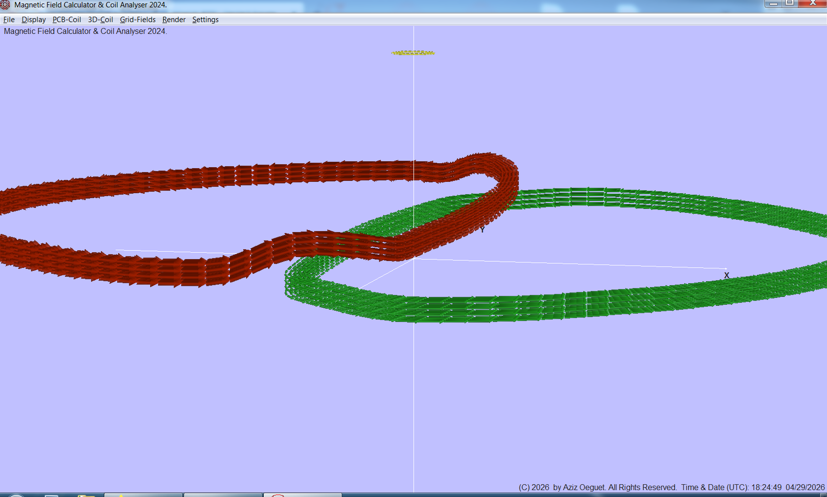

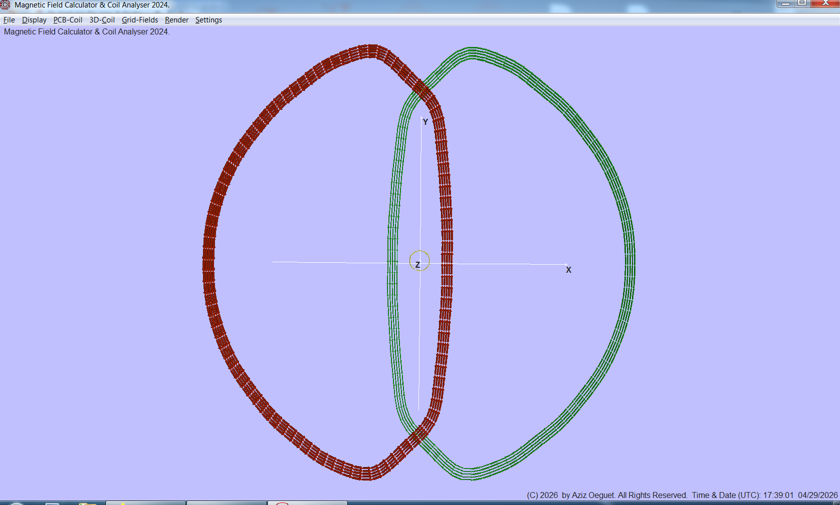

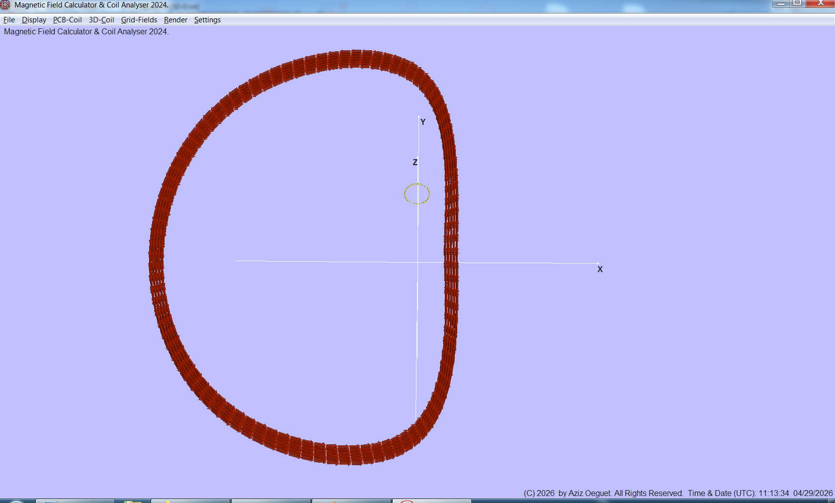

            • Ok guys,
              I have solved the 3d spline interpolation now.
              But it produces a lot of wire filaments now. Look how smooth and fine the coil geometry now is. Single loop contains 200 wire pieces. There are 1000's of wire filaments.
              Now the following D shape is reduced to 6 interpolation wire filaments and then increased again to 100 wire filaments.
              Nice.
              Seems to work fine now.
              I have to solve the dilate/contract issue next time.
              Cheers,
              Aziz

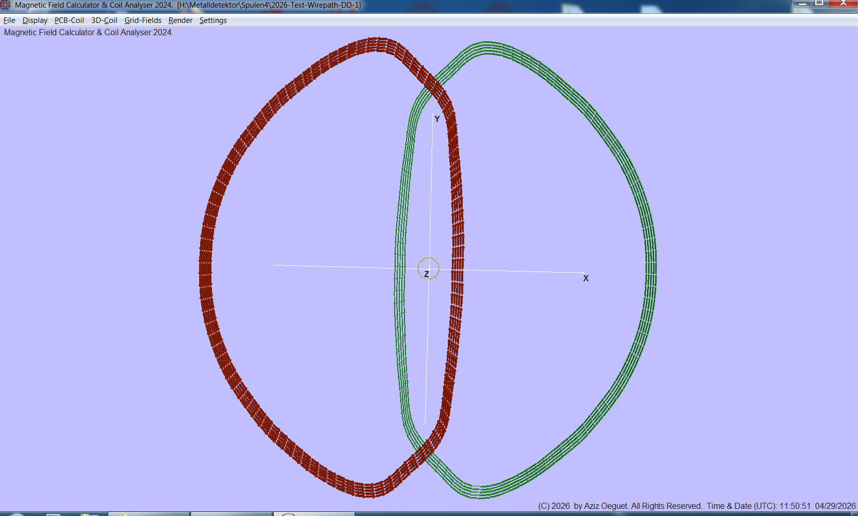

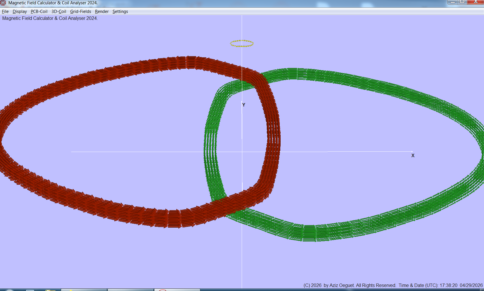

              • ​This is the finaly result of the latest DD coil configuration with the 3d spline interpolation (100 wire filaments per loop count). The wire filaments have approx. the same length before dilate/contract.
                I should be able to model fusion reactor coils now.

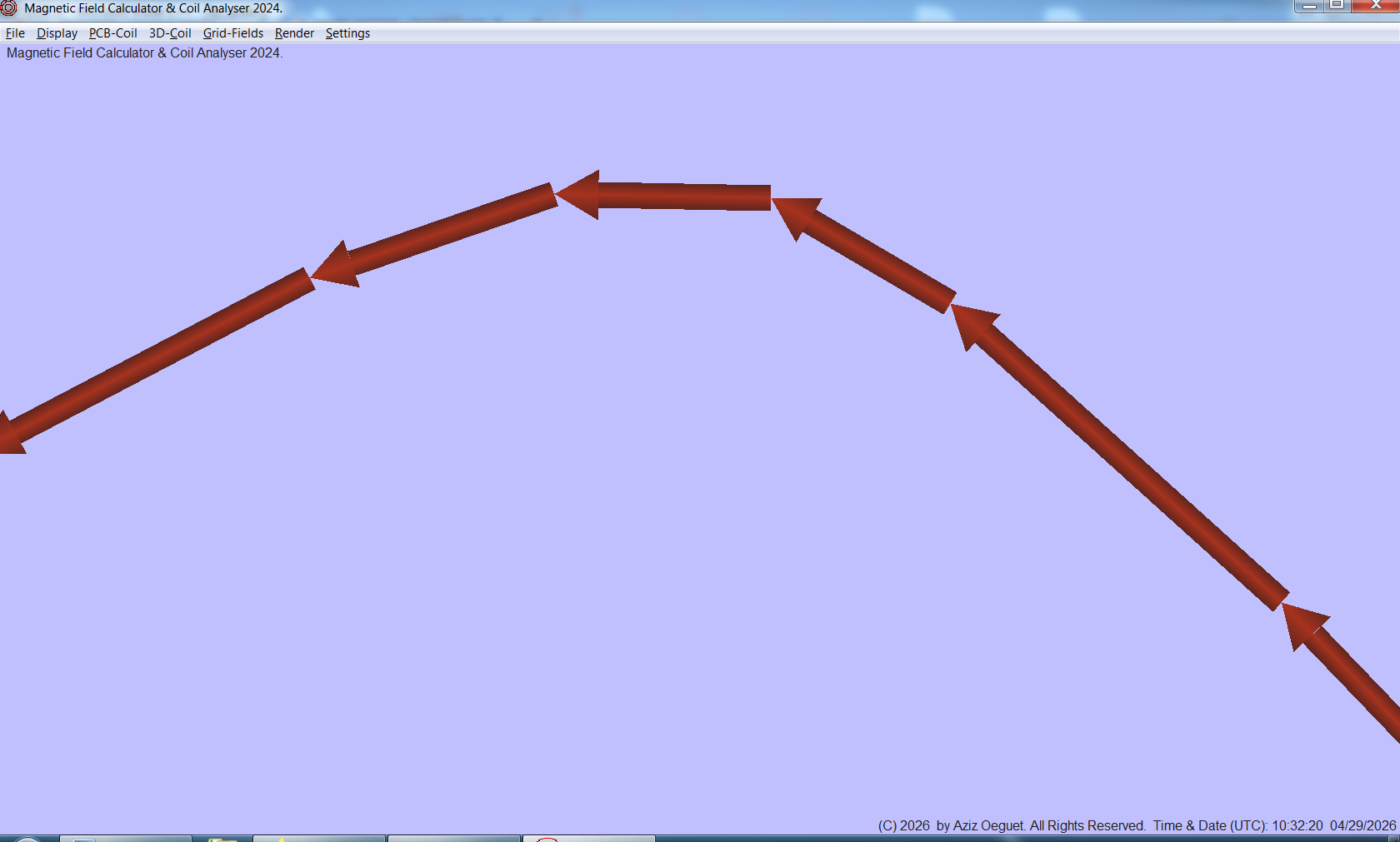

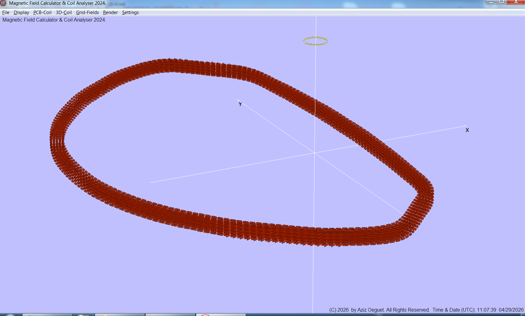

                        • Good news regarding dilate/contract feature!
                          Google AI made it perfect now. I gave him thumbs up!
ID:	447861 Click image for larger version
                          Now this is looking like a real coil bundle. The 3d cubic spline + dilate/contract features have been finalised now.
                          Aziz
ID:	447864 Very nice.
                            • Watch out, you might convince Ivica that AI is actually useful!

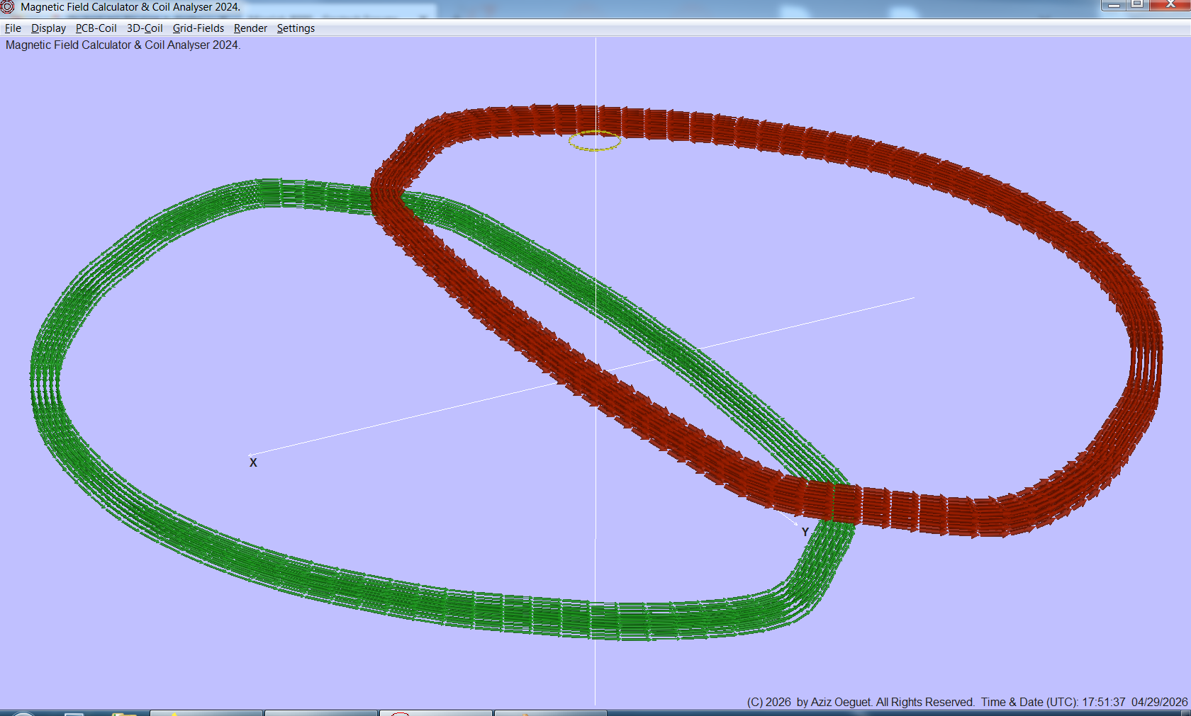

                              • Damn it! AI makes bugs.
                                It doesn't work, if z-coordinates vary.
                                My own work-around works however.
