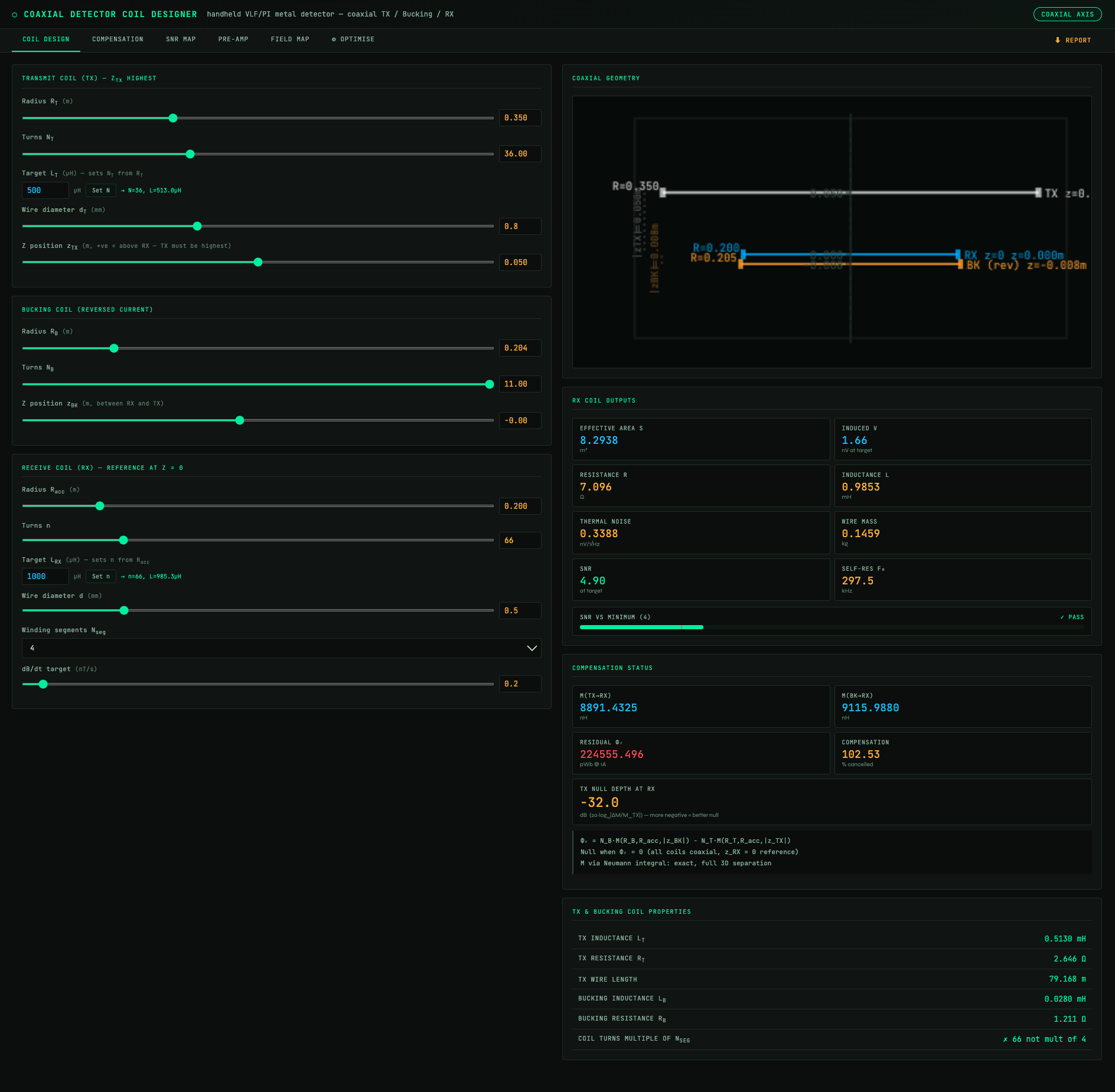

                          • #43
                            I have challenged the AI to build a Z space coil designer with "optimiser" button ... and it just works like magic. Just tap in your TX coil parameters and RX parameters and it works out the bucking and Z spacing.
                            It shows a nice BS / complete integral field map of the magnetic field on the field map tab.
                            what is interesting is that a simple 3 coil system can achieve nearly 90 db of null at the rx coil but only under certain conditions.
                            The maths identified that field "uniformness" is very very important if you want to have any hope of nulling using only mechanical means ... that means CNC accurate coil formers and precision machine wound coils on an absolutely rigid former.
                            There is a PDF of the report generated attached below ... the null is a realistic 32 db.
