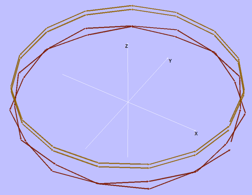

        Hi all,
        ok, I have added a very basic vertical basket weave coil model to the coil software now (red coil). There is a reference solonoid coil above (yellow) to check the code.
        I have zoomed in, out, rotated, moved and checked its correctness. It seems to be correct.
        Click image for larger version  Name:	Vertical-Basket-Weave-Example.png Views:	0 Size:	31.1 KB ID:	446472
        This gives us more flexibility to design better new and easy coils. Let's weave some baskets soon.

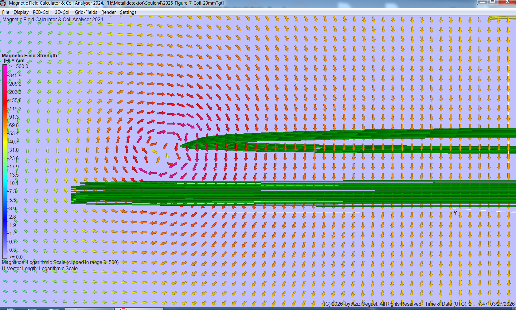

            I see a good potential and chance to outperform the Z18 coil with a new coil design.
            By just looking at the magnetic field strenght lines shown below (transmit coils not shown):

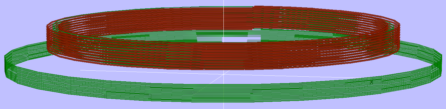

                      Look, this is beating Z18 coil:
                      You can make it basket-weave too.

                        • #87
                          I did do almost perfectly induction balancing with a DAC feedback system down to the noise floor level (in my case -120 dB).
                          But this isn't really required. 10 - 20 mV residual RX voltage is good enough. A stable phase angle calculation at low level RX is more important.
                          BTW, the coil above is much easier to build and balance. Fine IB is done with slight distance variation of big RX coil to the other coil arrangement. Just add more or less distance spacers.
                          I like solenoids now!

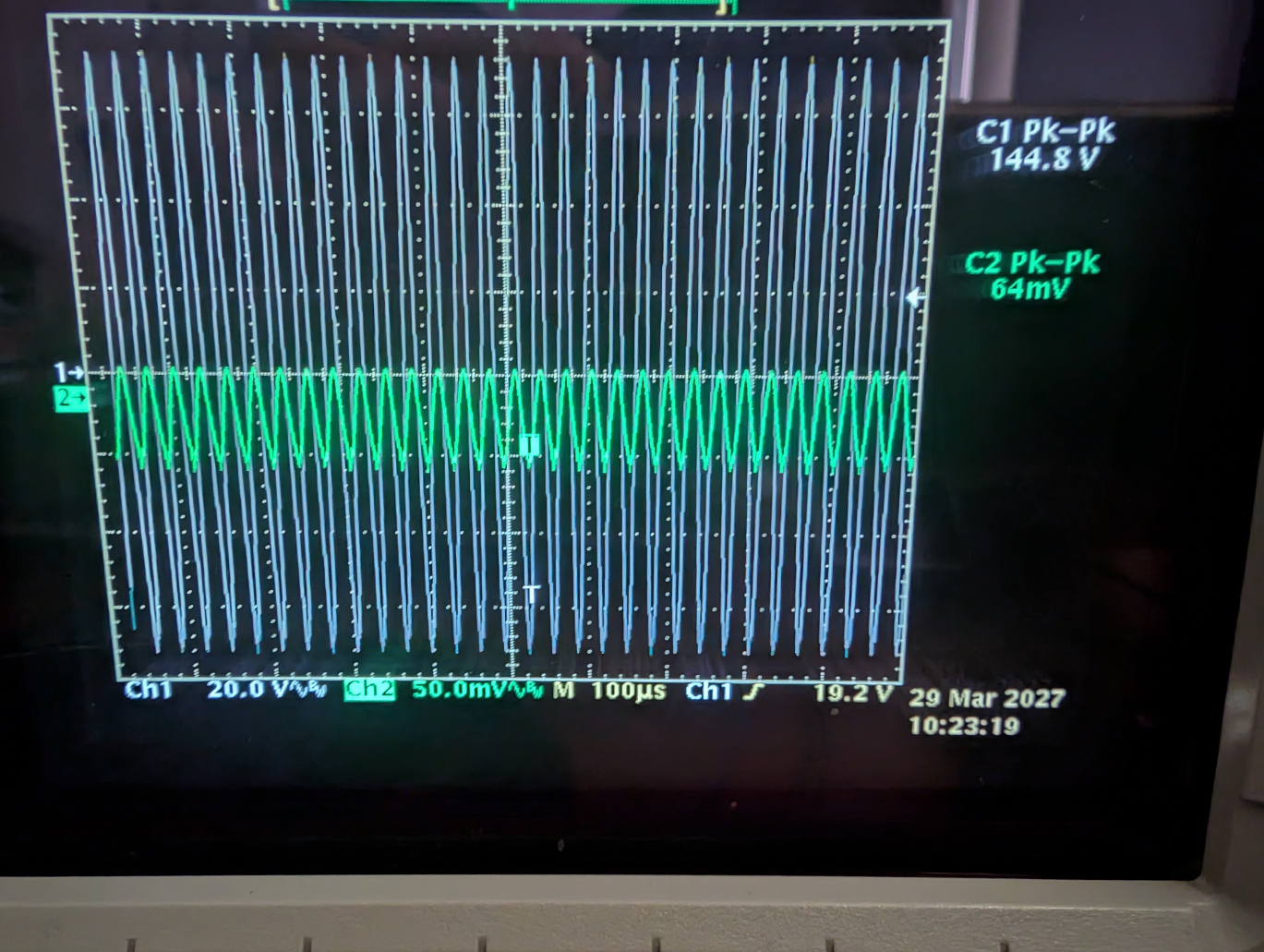

                            It's rare that you can ever get a null below 60dB. Electric field coupling and parasitic C in the coils, cable, and connector inject just enough signal that the resistive null limits how deep you can get the total null, even if you could get a perfect reactive null. Also, there is little reason to get a better null because as soon as you put the coil to the ground, you lose almost all of it. It almost makes sense to shoot for a 30dB null @ 180° so that when you lower the coil to the ground, the null always gets better.
                            hmmm... below is my DD coil operating with 148 volts PP on the transmit and 64 mv on the RX .... its connected to the "breadboard" ... you saw one of my boards ... this is a new one though and has the modified E class driver but no preamp and the same software you saw running no shielding no filters just a blocking cap connected to the 1.5 volt bias before the RX hits the ADC.
                            The coil is a DD minelab ... stock .... the one you saw also. 64 mv / 148 volts is -67 db of nulling. It would possibly be a little better if I had a layed out board with better sheilding.
                            This gives us an interesting insight into the coils used for PI and VLF .... its probably true what you say regarding 60 db for VLF type coils ... because the inductances are much larger ... more wire, more capacitances, harder to balance. However this DD coil is a PI coil but I am using it for VLF. Less wire, less capacitances and it would have been balanced in the factory for a wideband signal much higher than the maximum frequencies I use ( 100 khz tops ).
                            The TX coil in this DD is 410 uH ... this has a reactance of 82 ohms at 32 Khz .... its plenty of impedance for this type of work. You can put big TX power through it without rediculous voltages like you get on the 1 mH plus coils.
                            I will tweak the software to see if I can extract a db reading from my software null.
                            Aziz I dont agree that you need a baseline phase reading .... whether its phase or signal amplitude .. there is an integration going on inside the software to extract weak targets ( phase and amplitude ) ... at the noise floor the baseline phase is all over the place so you dont want it .... to get to the noise floor you need to remove the leakthrough... otherwise your measuring the leakthrough which is an imbalance signal ... not a target signal.
                            There is a difference between coil balance and a change in mutual inductance between a target and the RX coil ... if the balance changed ... my ground balance method would not work and this can be proved by moving the coils mechanically with respect to each other vs approaching ground.

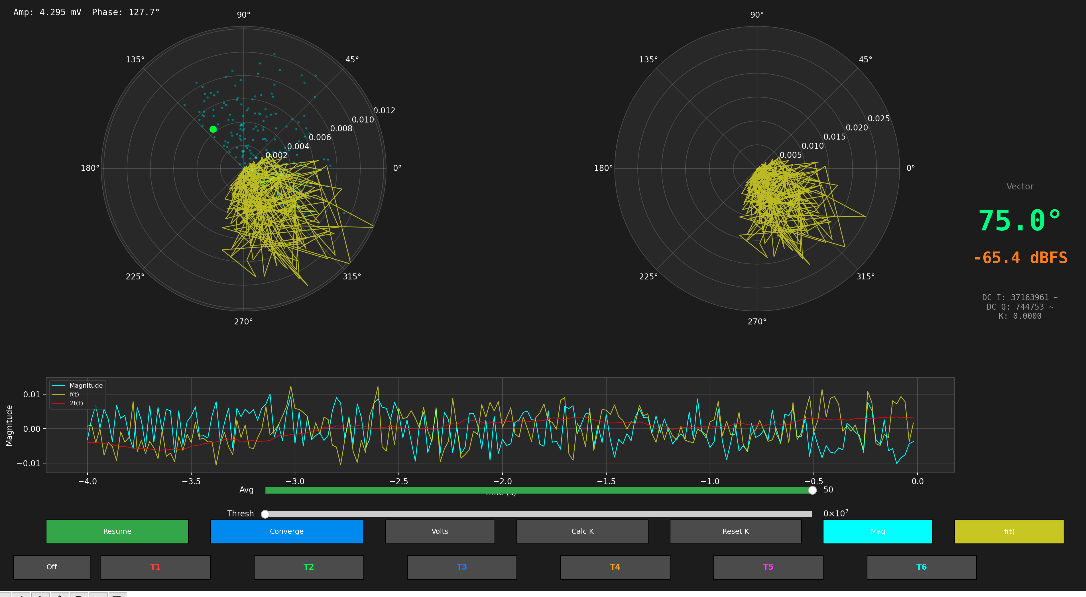

                              Just looking at the noise floor in the FCMD with no target no ground the we get a figure of -65 db which is the residual signal after we have software cancelled the residual input from the unbalance of the coil.
                              So our effective balance from the coil is -67db from the mechanical balance of the coil and -65db from the software cancellation so we end up with -132db.
                              This is pretty accurate given the unsheilded board .. the noisy lab environment etc.

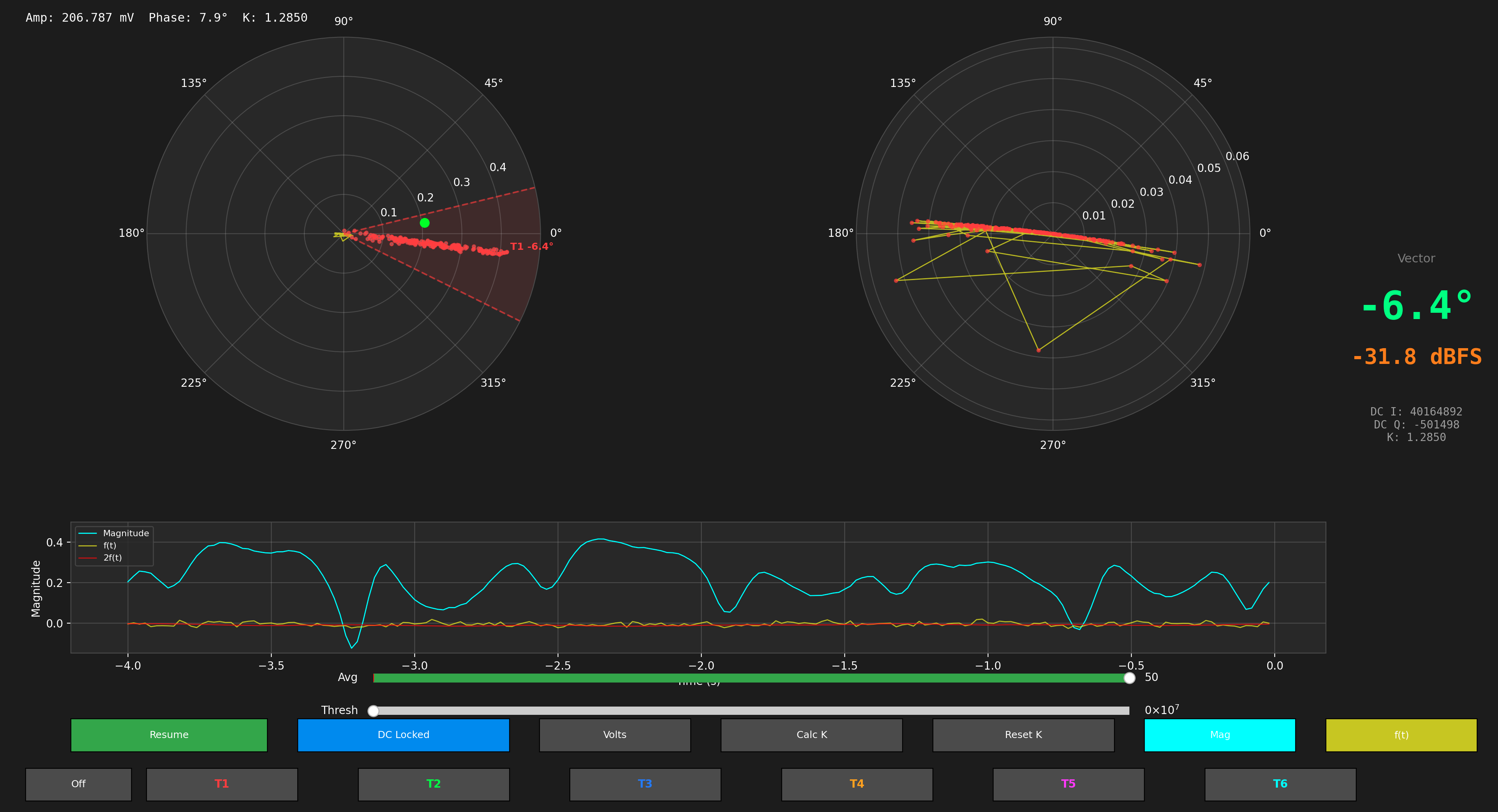

                              I bring a ground sample in till it touches the coil ( when ground balanced ) and this figure will not change .... so that means the "balance" of the coil is not affected by ground.
                              This is shown in the second picture ... we are present a ground signal to the coil with ground balance on. The target detection ( red and yellow ) does not respond .. but the magnitude and angle does does ( this is calculated without the ground balalance applied ).
                              The signal level has increased from around 4.8 mv to 206.8 mv ... an increase of 32 db. The rejection says -31.8 db .. and thats the point .... the input has increased by 32 db so the difference is still around -65 db.
                              This means the overall coil balance is still around -132 db.
                              I am using a noisy 16 bit ADC and no amplifier from the RX coil to the ADC. I am pretty confident this will be a very good detector when I move to 24 bit and preamp.
                              No need for fancy coils. ( yet )
