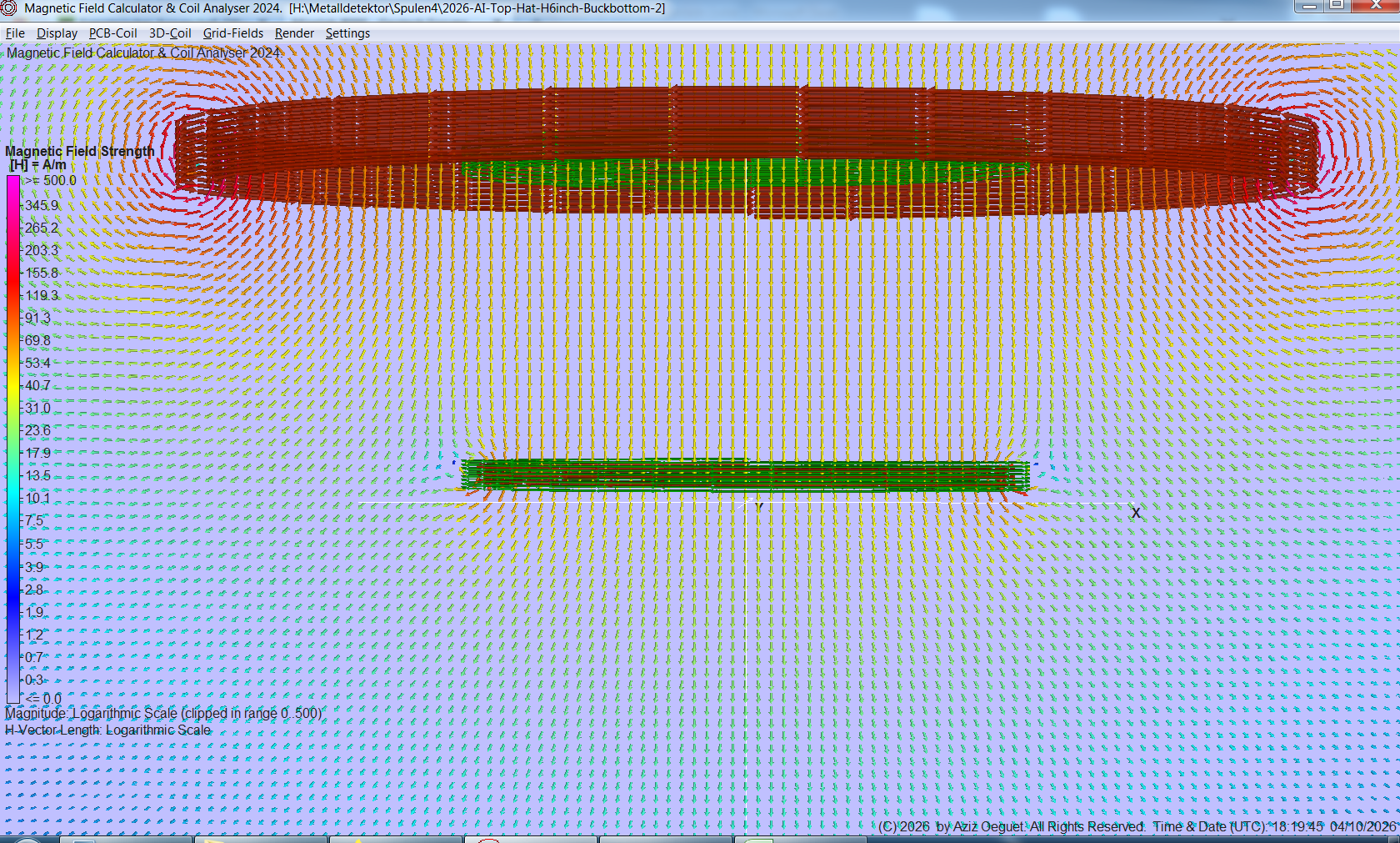

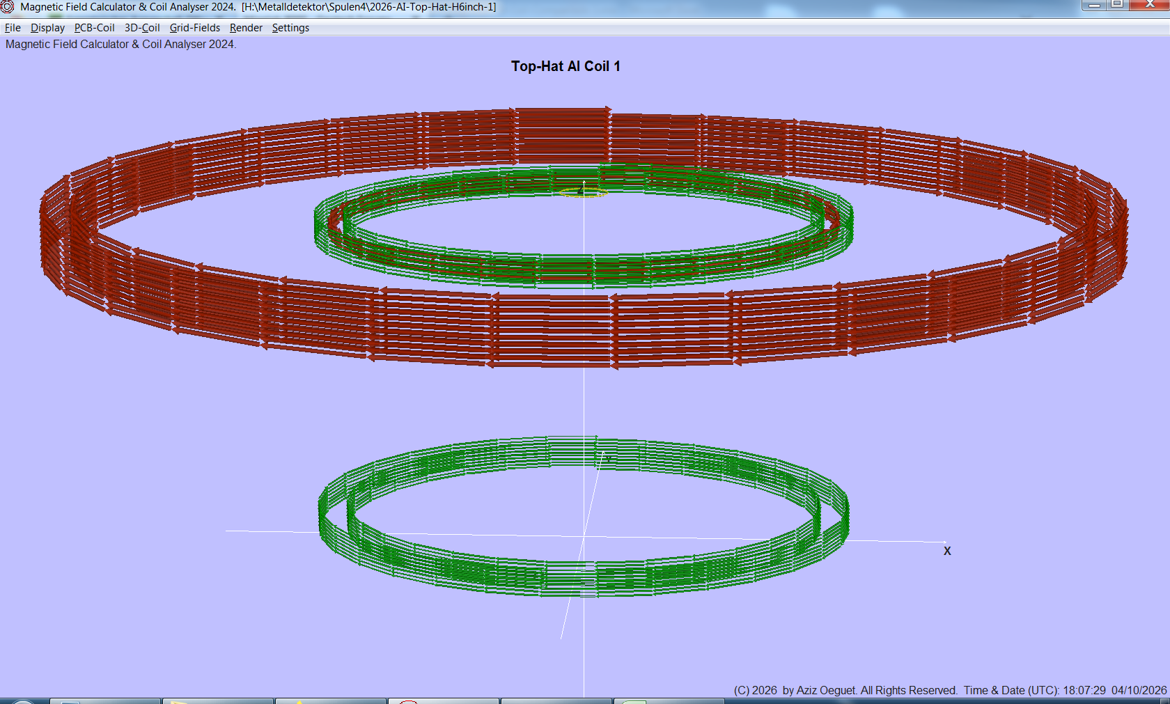

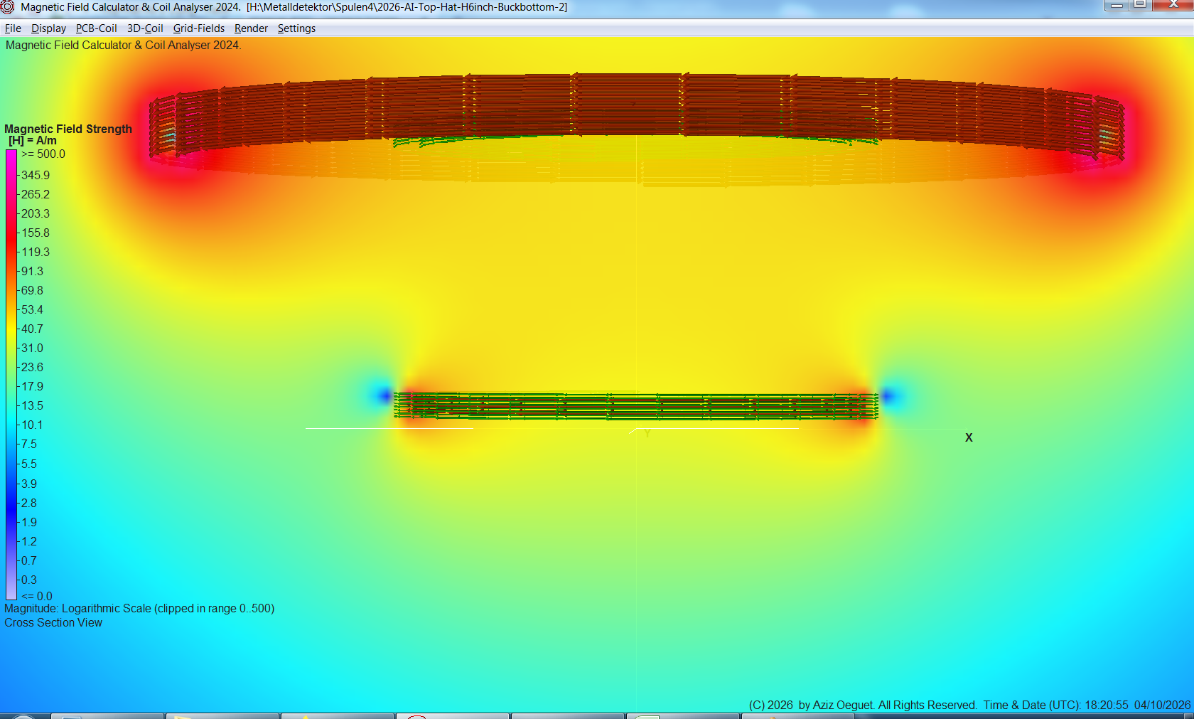

                      • Hi all,
                        the first AI (anti-interference) Top-Hat IB-coil didn't do well enough. The top and bottom RX coils (green) have the same number of turns count but are wound in opposite direction. The coil structure fits into 6 inch coil housing height. Approx. 5 mm space is left at top and bottom side of the coil for the coil housing. So total 6 inch coil height.
                        Click image for larger version  Name:	Top-Hat-AI-1.png Views:	0 Size:	381.3 KB ID:	446904 Lets see the second one in the next thread.

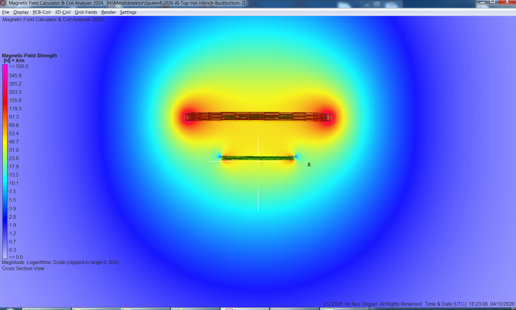

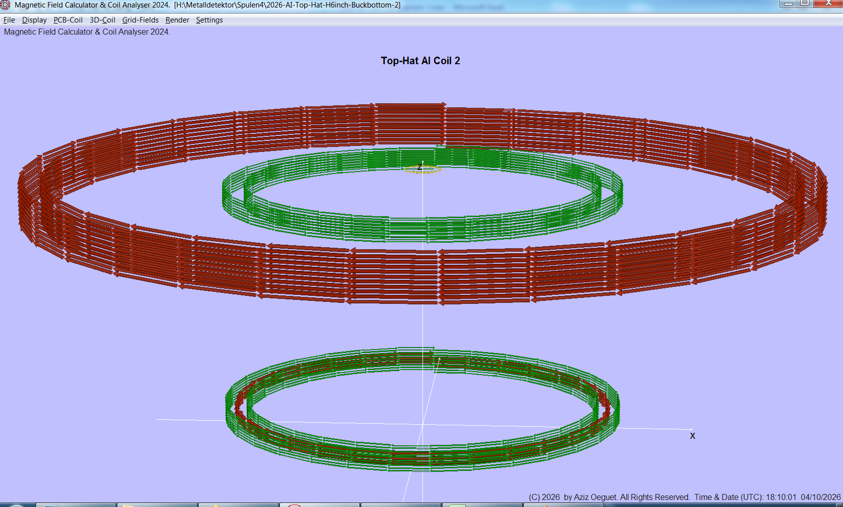

                        • This is the second AI Top-Hat IB-coil. The TX bucking coil is now at the bottom place and has same winding direction as the TX main coil.
                          Will there be at least 20 dB EMI noise reduction at approx. 6 inch vertical offset of the RX coils?
                          If yes, we can crank up the RX front-end amplifier by additional factor of x10 (+20 dB) and can compare it's performance compared to other coil configurations.
                          It is coming very close to the mono coil performance at the bottom side at depth. Or even outperforming in the low depth region. Be careful comparing the top side. As the coil is 6 inch height, subtract 6 inch from target height.
                          Now the pics:

                          • And the mild ground side (top region) of the AI Top-Hat IB-Coil 2 is really an outperformer!
                            Provided that, we can achieve 20 dB EMI noise cancellation.
                            One reason more for dual-side search coils.
