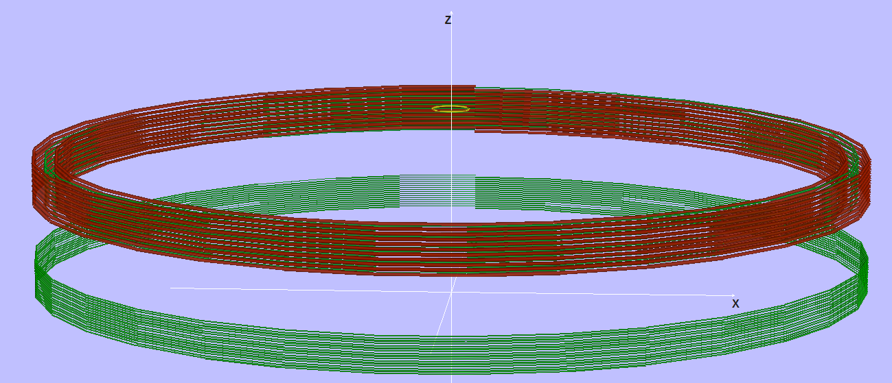

    the following simple IB coil is slightly better. Even if I rise the TX/RX-bucking coil structure slightly higher. The RX-bucking coil turns count minimizes a bit and the RX coil can have more turns.
ID:	446533 This coil goes really deep.

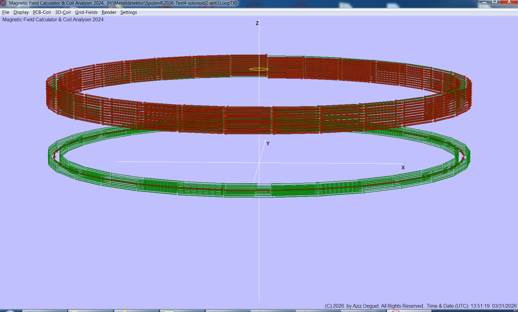

                            • This coil design is now much better.
                              It has both RX bucking and TX bucking coils.
                              TX bucking coil is a one turn loop anti phase relates to TX windings.
ID:	446597 The coil model is prepared for basket-weave coil. This will increase it's performance more. I will show this soon.
                              Note, that the one turn TX bucking loop reduces the number of RX bucking coil turns and will lead to less target signal reduction.
                              Do not count the number of turns yet. This is a rough geometry finding process at the moment.
                              For the exact IB coil parameters, we have to specify the RX and TX wire parameters yet.
                              Aziz

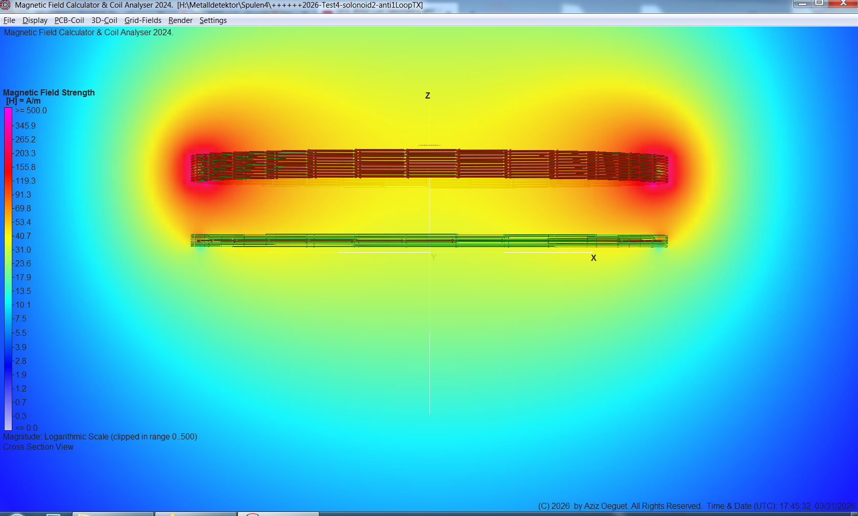

                              • Look,
                                the one turn TX bucking coil loop reduces ground noise a bit on hot mineral grounds further. Bottom part would be for very hot grounds. The upper part of the coil (flipped-over for operation) would be for mild grounds with extended detection depth. Note, that both TX and RX coils have maximum possible sizes.
                                Magnetic field strength cross-section of the latest IB coil design:
