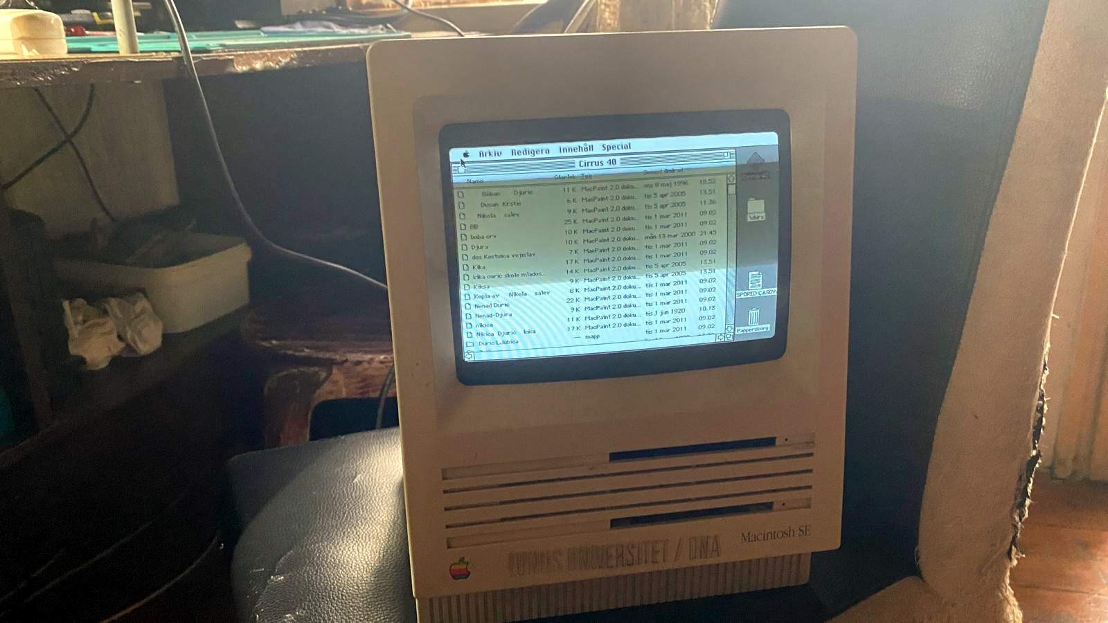

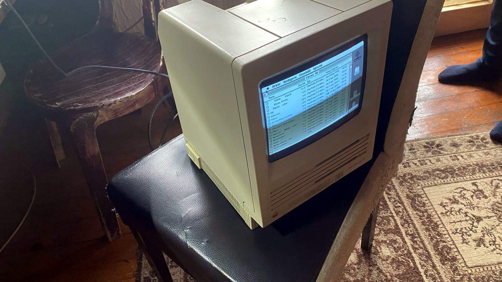

            Paul where are you? I just cut you three lengths in the AI ​​field with this game changer!
            Click image for larger version  Name:	Mac2.jpg Views:	0 Size:	287.0 KB ID:	445773Click image for larger version  Name:	Mac3.jpg Views:	0 Size:	208.6 KB ID:	445774​
            I can't believe it! It even has a SCSI hard drive (instead of the top floppy)!!! Please tell me which is the hardest AI model so I can take action right away!
            :rotfl​

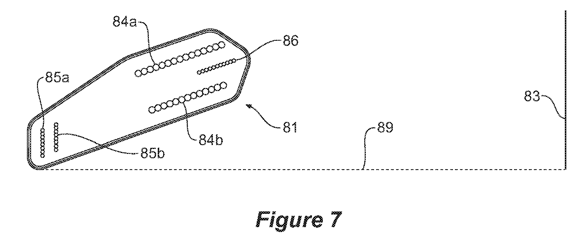

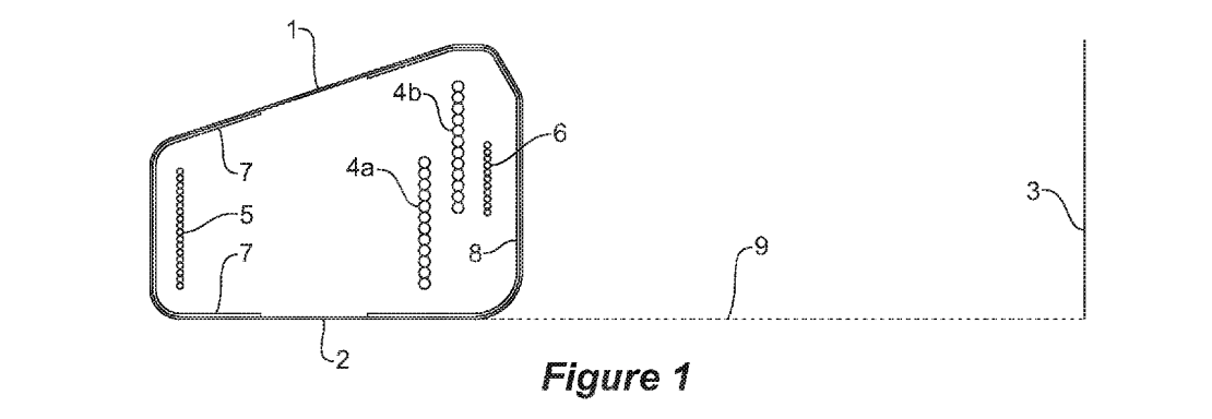

                  Don't make fun of these probes, they have 3 coils, with the receiver above the plane of the transmitter, and feedback coil . I just don't like the way it's attached to the stick​
                    ... and if we lift the "lid" here is what we see :
                    coil profile ( one of several )

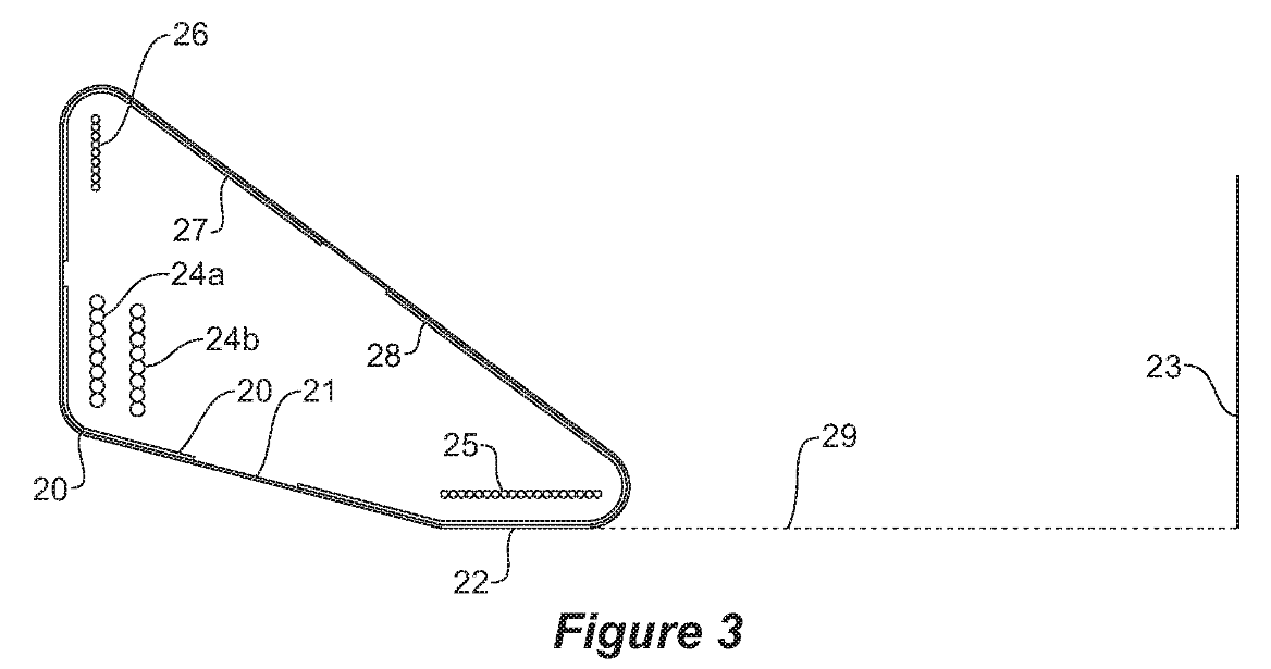

                      I saw the 8000 last week at the Wedderburn Jamborie. I also heard a lot of dunny seat jokes. Based on the shape of the coil and what the engineer told me, I think the 18" (and also the 13") most closely follow this configuration:
                      I was told the main RX coil is on the outside perimeter, the TX coil is smaller and elevated, and there in an RX bucking coil near the TX. The 17" coil is designed for high EMI and is different, more like the classic coaxial coils of the 70s and 80s:
