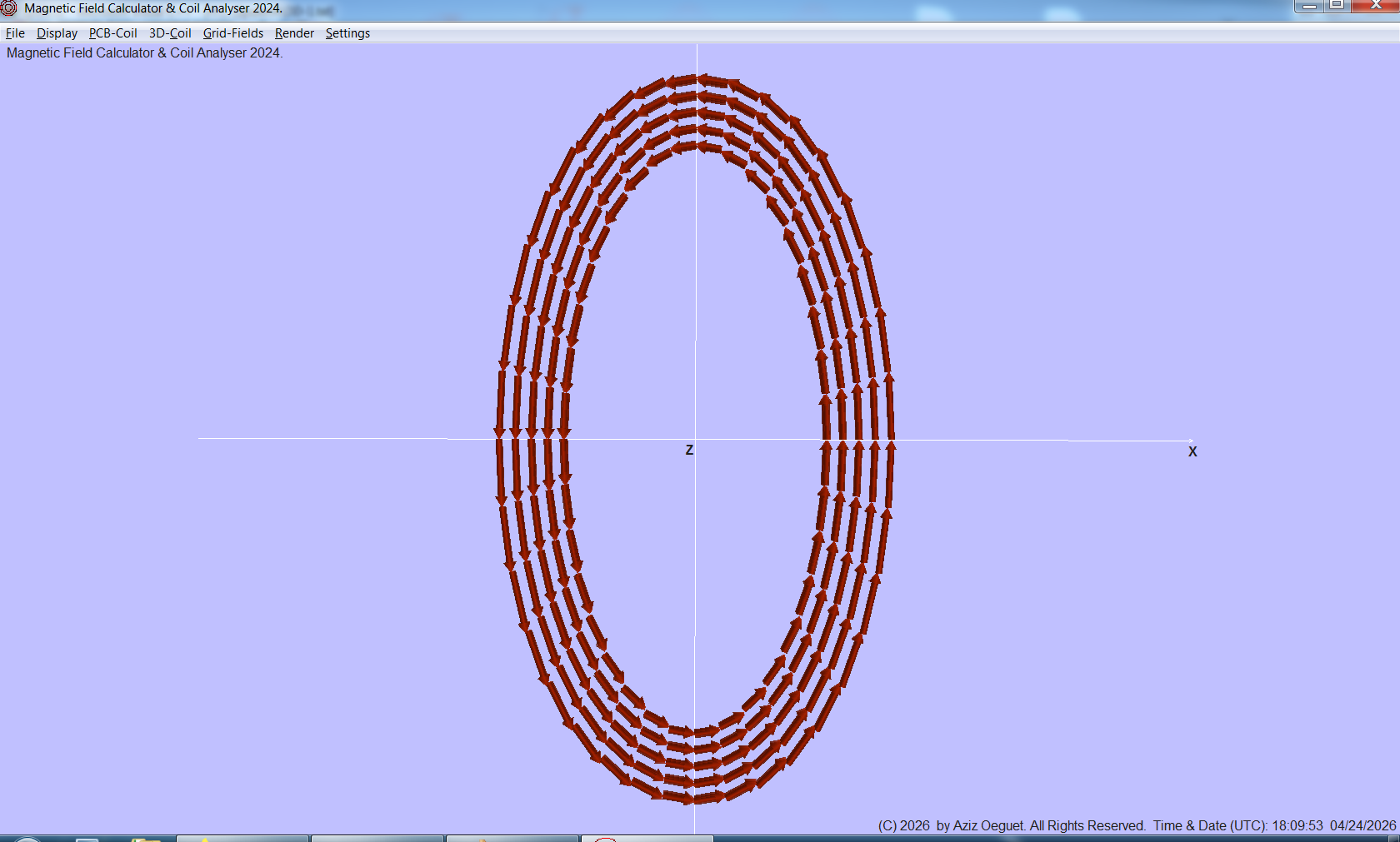

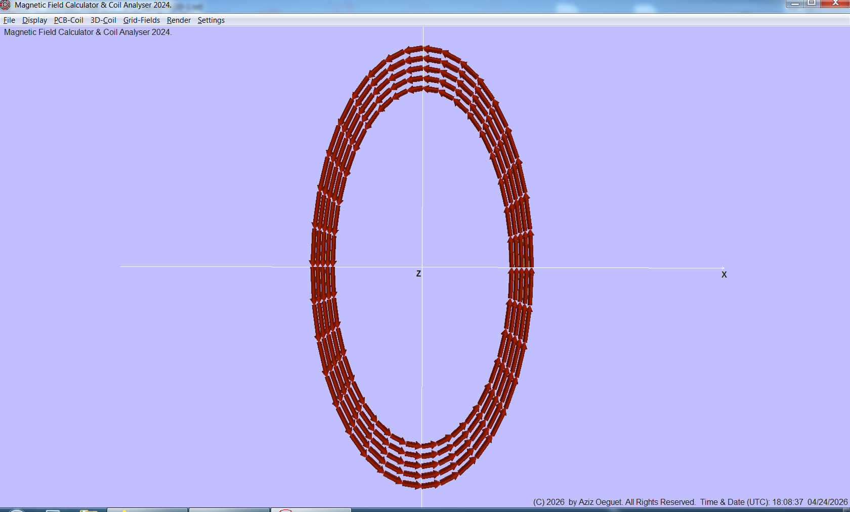

          • Well ok,
            dilatation/contraction of a path needs a more accurate solution.
            This elliptical coil is done with duplicate scale modifier. Note, that the bundle thickness scales too.
            And this is done with dilatate/contract modifier. The bundle thickness stays same.
            But the latter one produces inaccurate wire locations.
            Back to the black board.

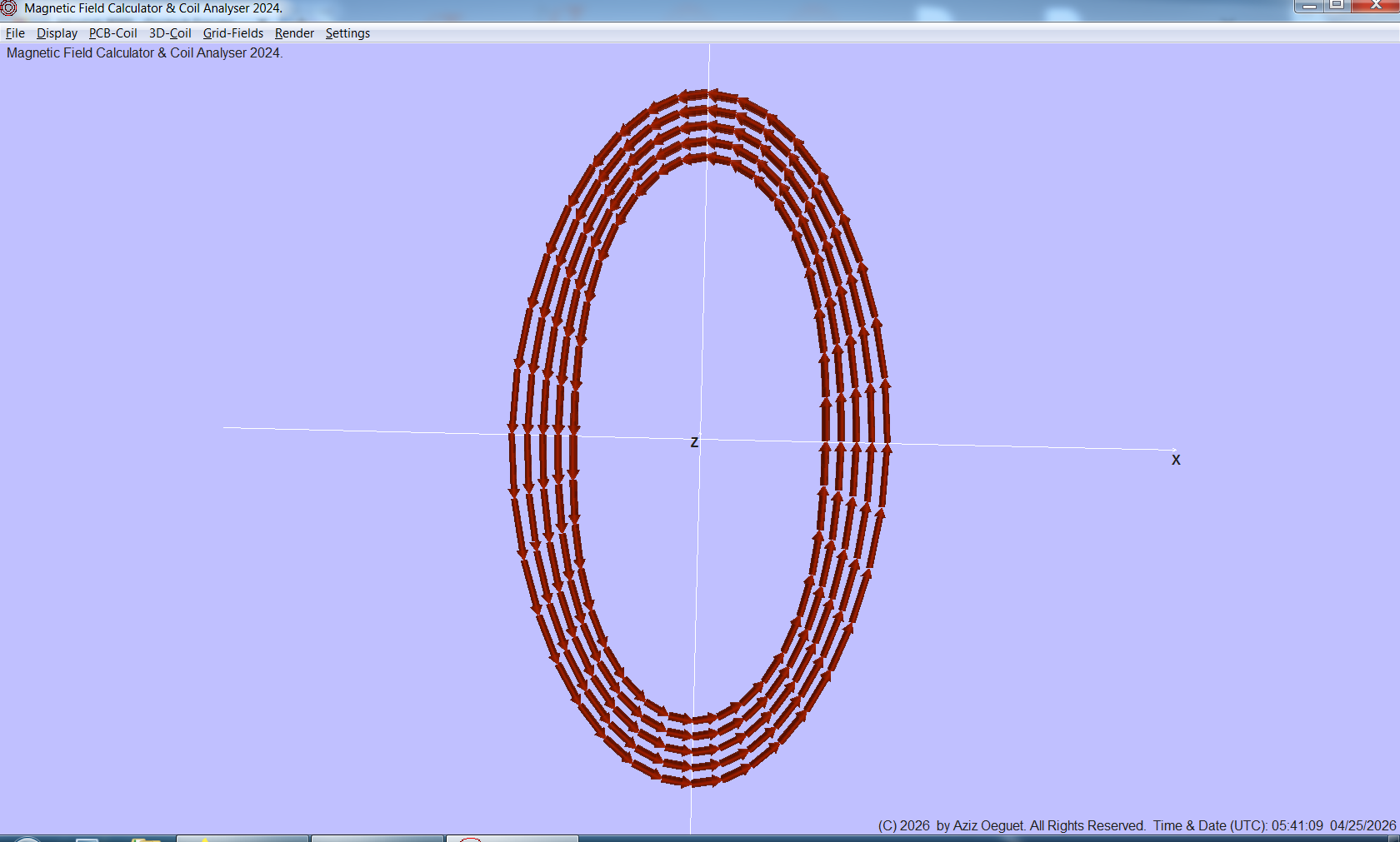

            • Hi all,
              well, the very basic dilatation/contraction variant could still be enough to use it. Slight model inaccuracy on special shaped coils won't really matter much.
              For circular coils, there won't be any inaccuracy.
              Click image for larger version  Name:	Elliptic-Dilatate-Contract2.png Views:	0 Size:	174.8 KB ID:	447532
              The wire element start and end point locations are consistent.
              We can define each wire path individually for more accuracy without using the dilatate and contraction function at all.
              I'll look for another solution with better results.

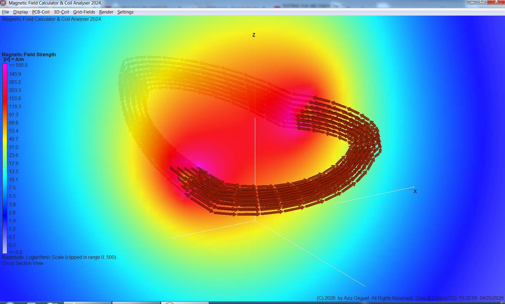

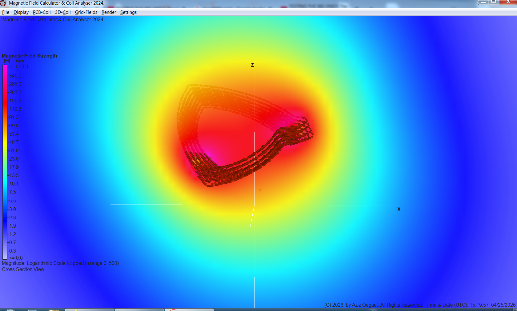

                    • Hi all,
                      I have now integrated the new geometric definition of special coils into the coil software.
                      Scaling, Rotating and Movement of coils already implemented.
                      We are very close to simulate fusion reactor coils.

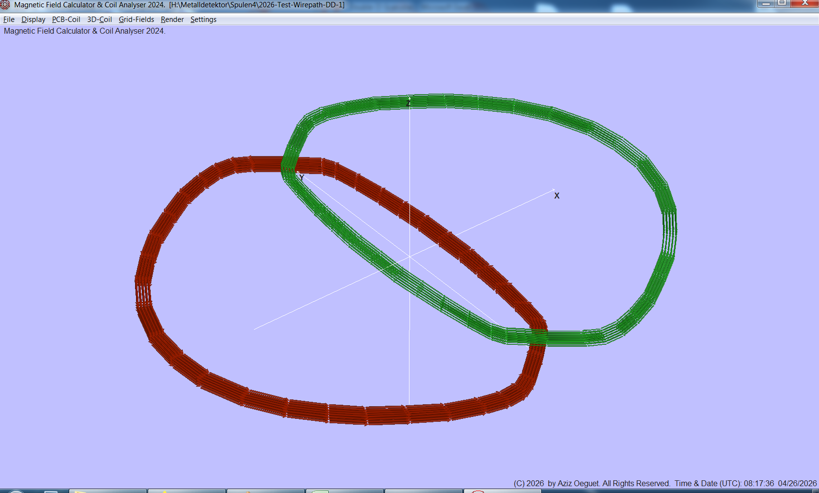

                              • Hi all,
                                this is my first attempt and experience on any shape coil design. I have scanned upper half of a picture of a commercial DD coil (left part only). Translated pixels into a coordinate system. Scaled the coordinate system to a fixed coil size. The calculated coordinates were taken into the coil description file. There is a good work-around for dilate/contract problem at the moment. I have to change my reference point to the mean center of the coil. Then made the dilate/contract commands (horizontal). Then made the bundle by duplicate move commands towards z-direction (vertical).
                                The receive coil does use the same coil geometry definition file. Just mirrored the x-coordinates by the scaling vector (-1 1 1).
                                That's all. This is the coil geometry code:
                                Code:
                                ref 0, 0, 0
                                xyz
                                0.031778    0,000000, 0
                                0.031778    0.027995
                                0.030008    0.052964
                                0.027902    0.078689
                                0.024412    0.106684
                                0.020429    0.130139
                                0.015132    0.141488
                                -0.006810    0.161917
                                -0.030265    0.180833
                                -0.043127    0.187642
                                -0.059017    0.188399
                                -0.077175    0.183859
                                -0.102144    0.174023
                                -0.127113    0.158134
                                -0.152081    0.140732
                                -0.172510    0.121060
                                -0.192939    0.097604
                                -0.210028    0.068853
                                -0.222447    0.031778
                                -0.225000    0.000000
                                sec path
                                dups 1 -1 1
                                ref -0.085, 0, 0
                                sec sort
                                sec path
                                dupd 0.0025
                                dupd 0.005
                                dupd -0.0025
                                dupd -0.005
                                sec path
                                dupm 0 0 0.0025
                                dupm 0 0 0.005
                                dupm 0 0 0.0075
                                end
                                This is the generated DD-IB coil system.
                                Click image for larger version  Name:	New-DD-Bundle-Coil.png Views:	0 Size:	261.4 KB ID:	447593
                                We should even be able to work at this current stage of the coil software.
