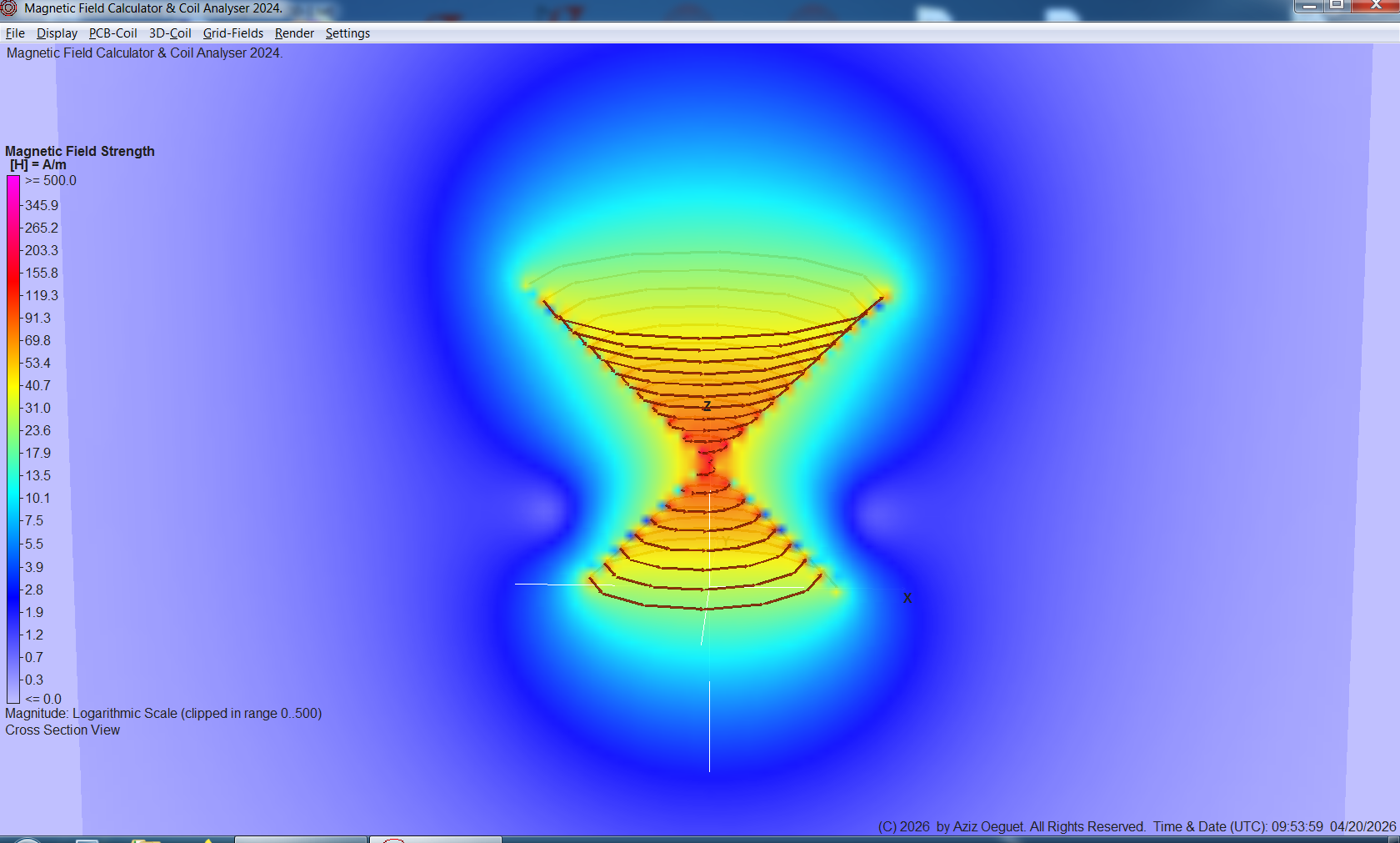

                        • Hi all,
                          the basic coil geometry description language is getting better. I have added a dmod command (delta modifier). So I can modulate angle, radius and z-position of wires.
                          Look at the chalice coil..
                          Click image for larger version  Name:	chalice-coil.png Views:	0 Size:	442.8 KB ID:	447321
                          The simple code generates the coil.
                          Code:
                          ref 0, 0, 0 // <x>, <y>, <z> reference point, default 0, 0, 0 (for dxyz vectors), optional
                          path // New path definition (optional)
                          pol 0 0.1
                          dmod 0 -0.001 0.001 // delta modifier, <dAng, dR, dz>
                          rep 240
                          dpol 30, 0.1
                          end // End of definition, stop parsing
                          But I am still far from the ultimate solution. The description language has to pass a lot of use cases and needs an evolution.
                          Aziz

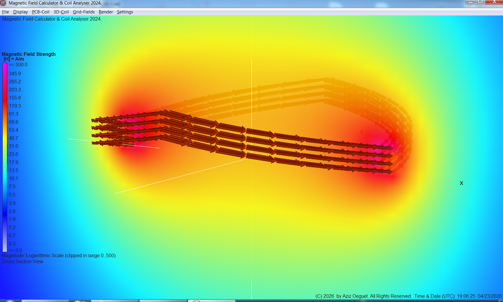

                              • Hi all,
                                I am making a good progress now. It was really a good idea with section and duplicate section commands. This will allow me complex shaped bundle coil generations easy.
                                I am defining a very small part of the coil (1/4 single coil winding in the following example). Then defining a section and doing duplicate scale and duplicate move on the sections several times.
                                Code:
                                ref 0, 0, 0
                                pol 0 0.1
                                dmod 0 0 0.003
                                rep 9
                                dpol 10 0.1
                                sec all
                                dups -1 1 1
                                sec all
                                dups 1 -1 1
                                sec all
                                dupm 0 0 0.005
                                dupm 0 0 0.010
                                dupm 0 0 0.015
                                sec all
                                dups 1.05 1.05 1
                                dups 0.95 0.95 1
                                end
                                There it is:
                                ​ Click image for larger version  Name:	bundle-coil-example.png Views:	0 Size:	614.9 KB ID:	447470
                                I will focus to the most important functions first. More features will be added and implemented bit by bit.
