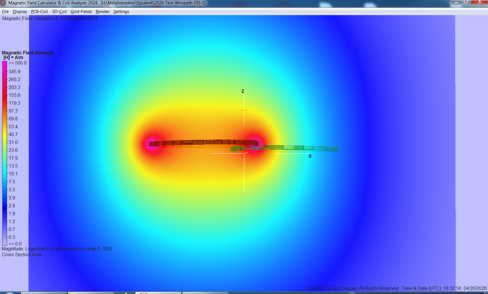

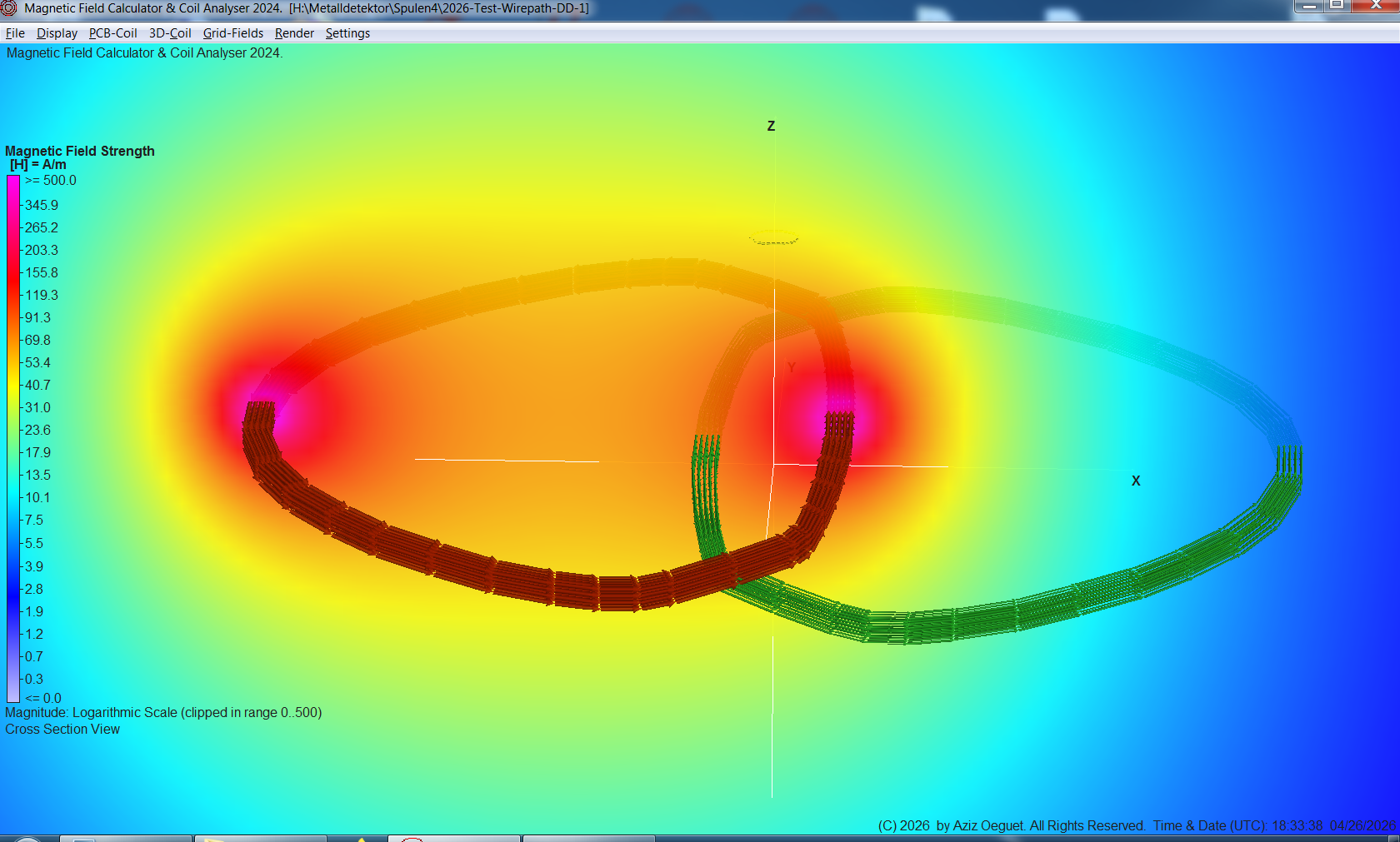

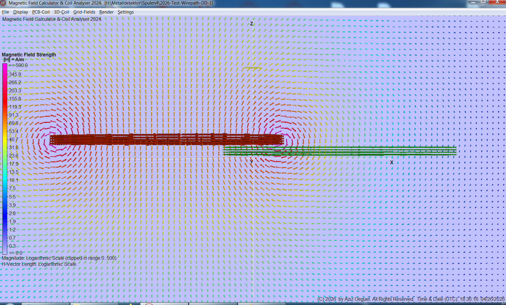

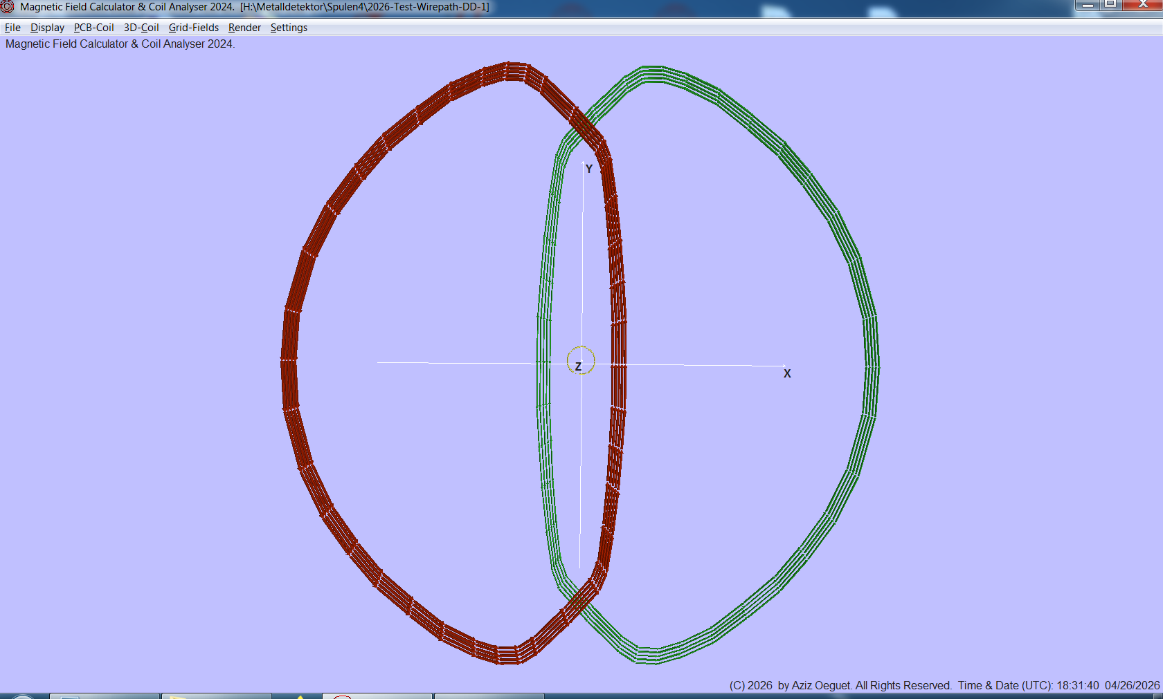

    I have finally added an 18 inch DD-IB coil to the coil comparison.
    It is not good performing. The TX/RX coils are relative small compared to other coils. This is the reason for.
    The zipped Excel-file of the comparison data is attached.

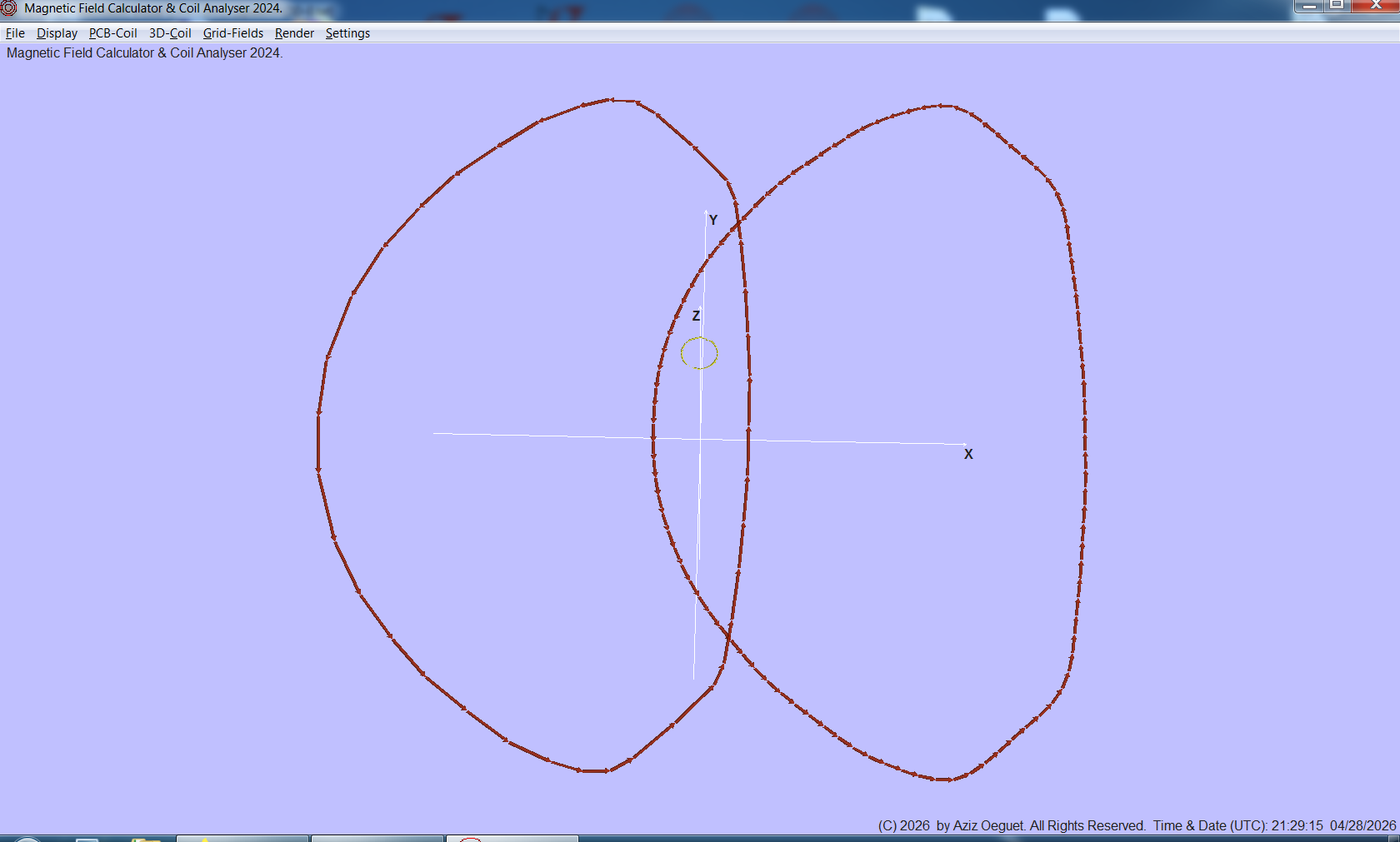

              • The 3d cubic spline interpolation core functions do work now.
                This is a check for debugging. Source shape is on the left. The right part is the 3d cubic spline interpolation of the single section of a D-shaped wire loop.

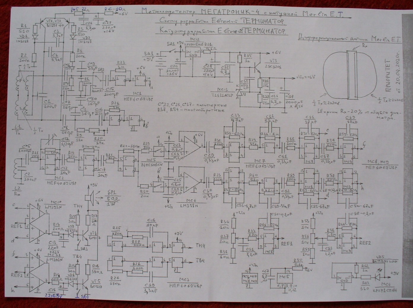

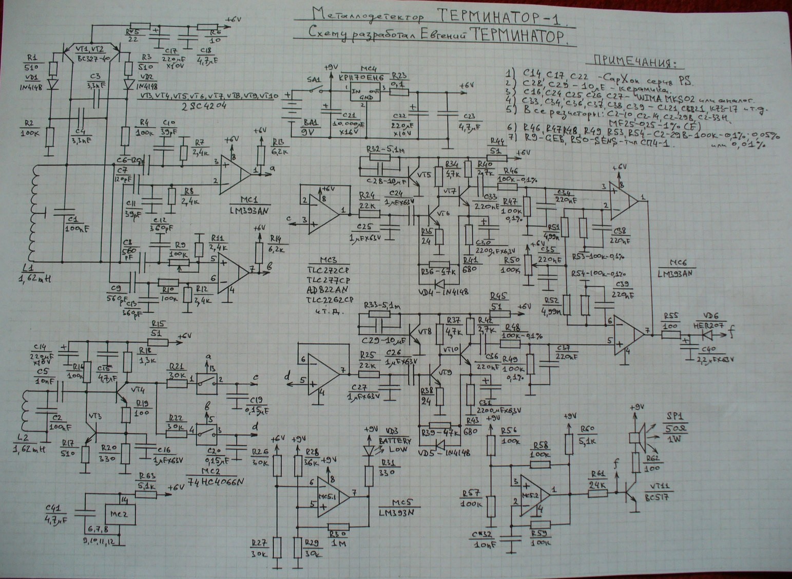

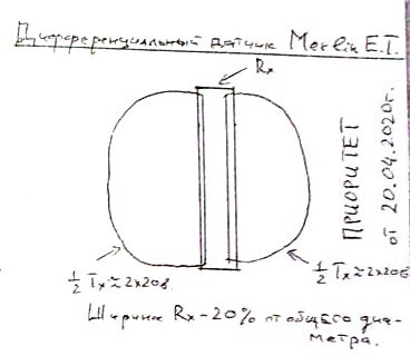

                • Azis check this innovative coil design is not built by any manufacturer yet:
                  Click image for larger version  Name:	MerlinE.T.jpg Views:	0 Size:	21.8 KB ID:	447804
                  it striped from russian engineer Eugeny R&D circuit::
                  Click image for larger version  Name:	Megatronik 4 с датчик Merlin E.T..jpg Views:	0 Size:	297.8 KB ID:	447805
                  His Last shared Circuit for DIY-ers:
                  Click image for larger version  Name:	TEPMNHATOP-1.jpg Views:	0 Size:	404.6 KB ID:	447806

                  • Hi Hristo,
                    according to the Geometric-Mean-Rule for coils (what a nice name), the coil configuration will not give any benefit.
                    GM = sqrt(a*b*c*..*..)
                    The variables a.. could be total flux area of the coils, dimensions (width/height/radius/diameter), etc.
                    It is very obvious, that the RX coil has quite less flux area. The geometric mean would be quite small compared to the whole flux area of the equivalent round coil.
                    Coils follow strictly to Geometric-Mean-Rule. One can estimate its comparable performance before making any complex simulations.
                    Aziz

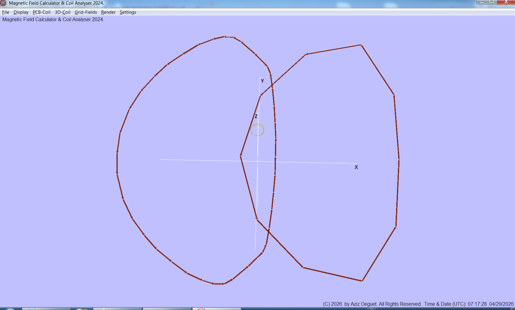

                    • Hi all,
                      the 3d cubic spline interpolation is also capable to reduce the number of wires (not smoothing, but making it more rough).
                      This makes the wire/path management functions a bit complex. I have to invest more time & effort to find an elegant solution.
                      It's also a nice feature to speed up the numerical calculations.
                      Or convenient for making same length wire pieces.
