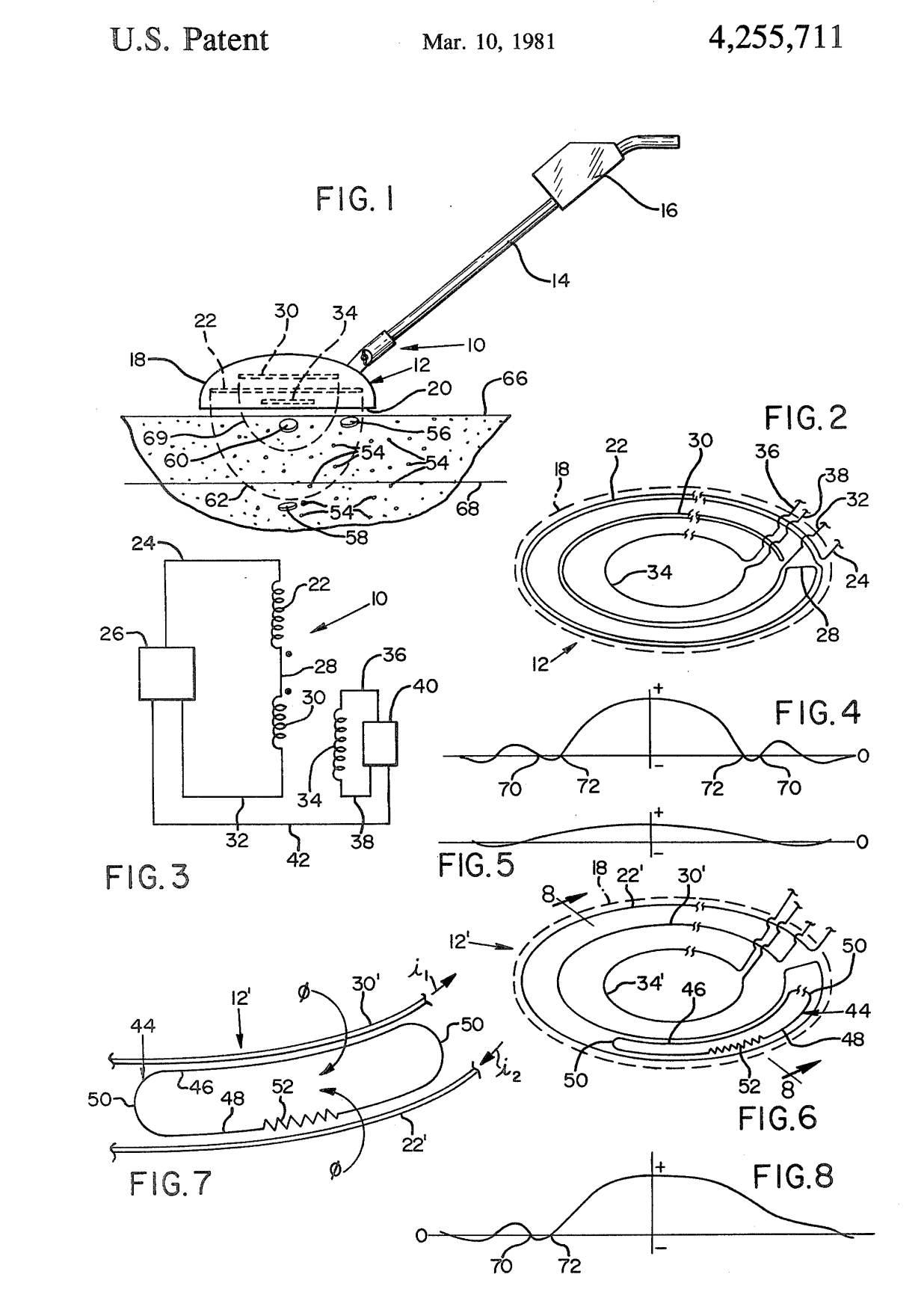

    There is no elegance in this design ... I cant see the mathematical principle that makes it superior to any prior art.
    Ferinstance this patent is the same thing AFAIK. Fig 2 even has the dunny seat profile.
    It describes a Z space bucking coil system with the Rx coil placed lowest / closest to the ground.

        Click image for larger version Name:	image.png Views:	0 Size:	419.9 KB ID:	446238
        In figure 2, there must be a mistake. The bucking coil displayed in the patent doesn't make any sense.
          Yeah, I think someone messed up on the drawing.

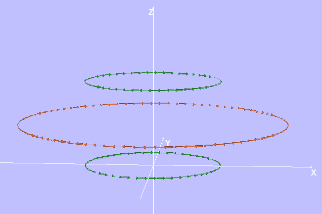

            Here is a better seat invention for all tired bones in the outback.
            It doesn't require any bucking coil. And it has EMI noise cancellation feature. RX bottom and RX top as anti serial connected.
            Red is the TX coil. Green are the RX coils.

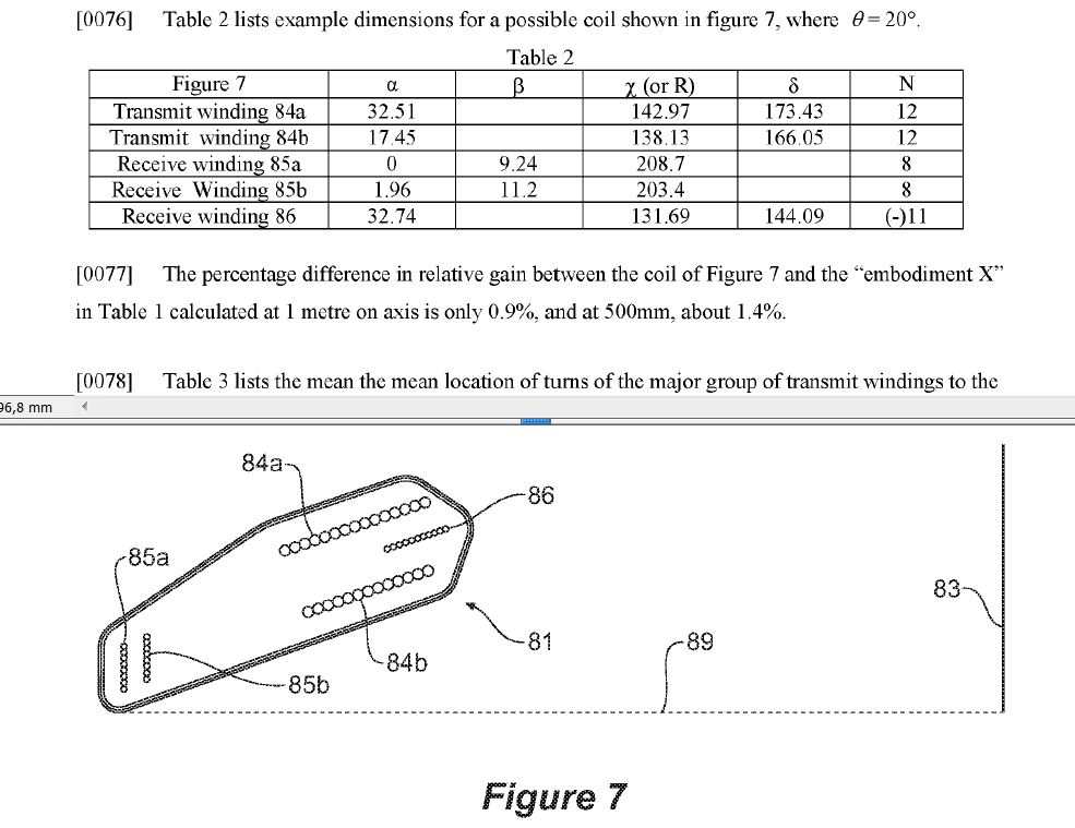

              This might be one of the 18 inch coils. Below is the cross-section view of the coil. Found this in the patent office.
              There is no bucking coil. Two anti-phase RX coils (85 and 86). TX (84) and RX (85) coils are split into two halves to reduce the coil capacitances. This will make early sampling easy.
              The coil axis is 83.
              There are other coil configurations in the patent (WO2022126185A1).

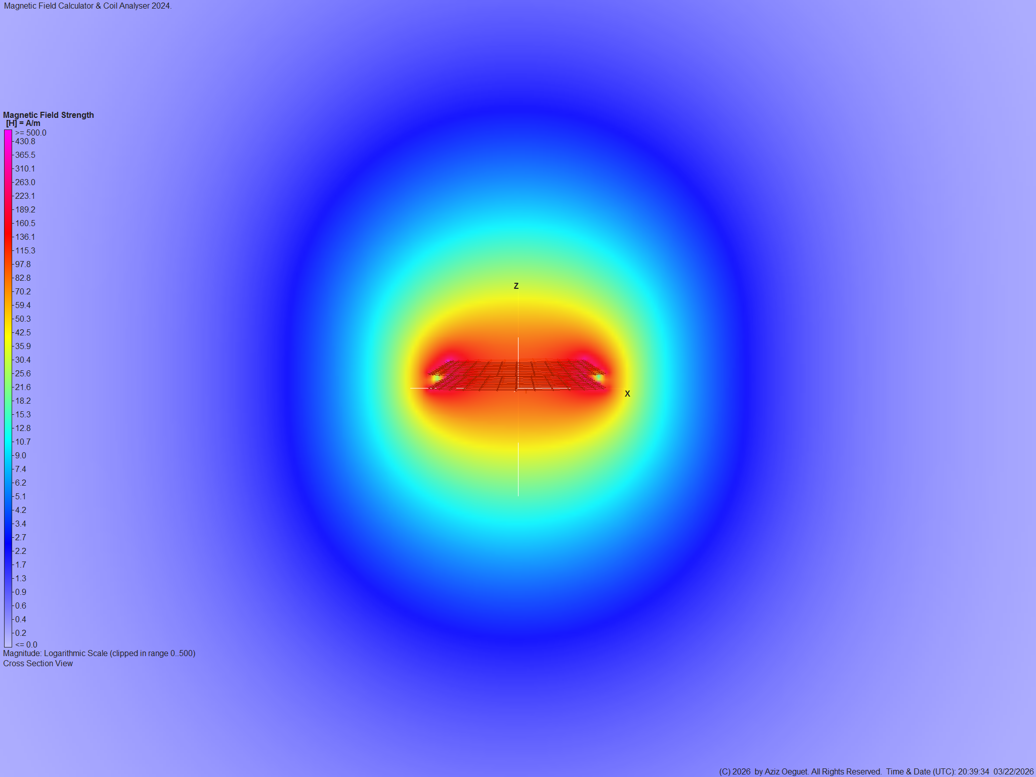

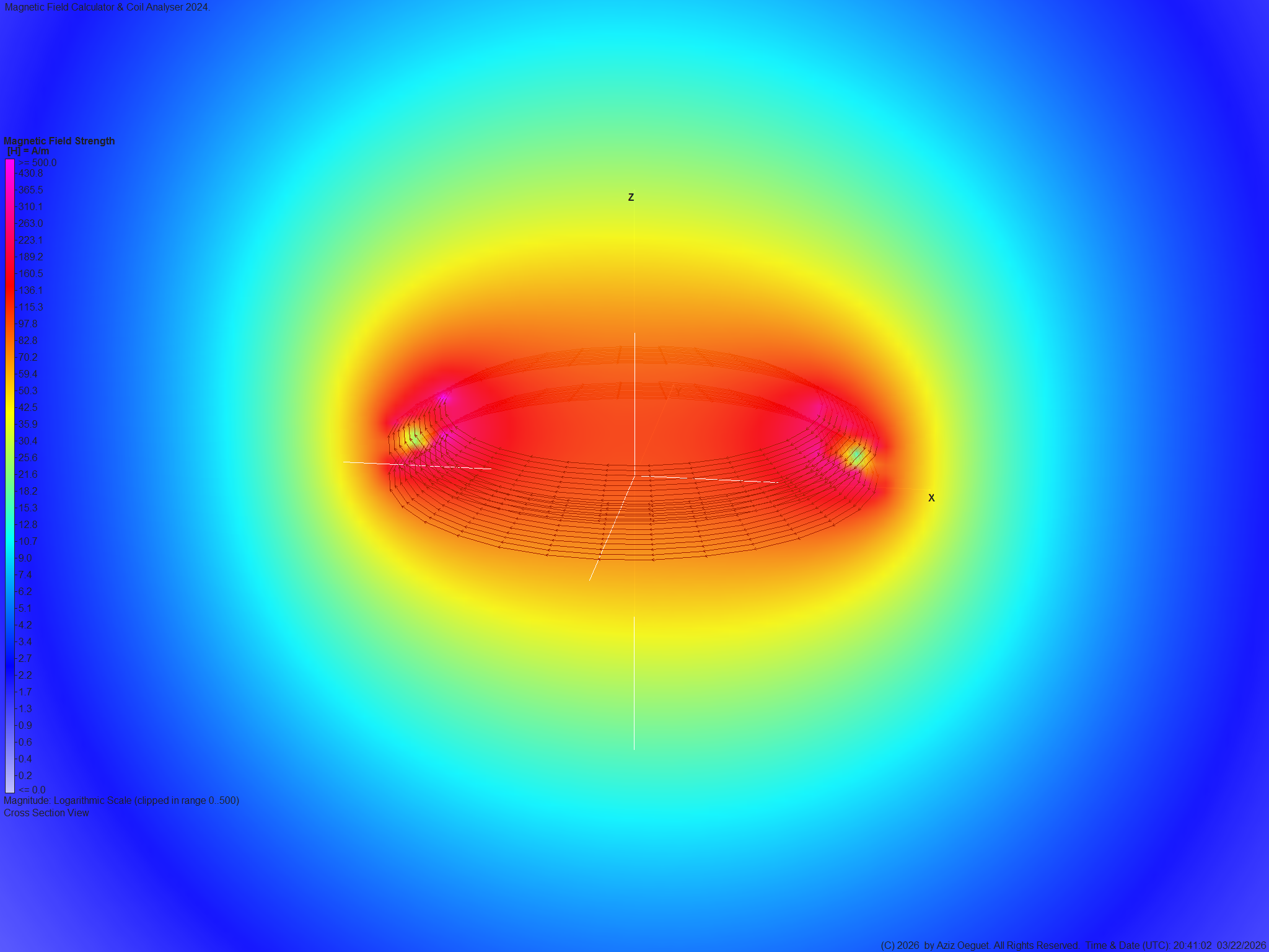

              My coil software is capable of simulating such coil arrangements. But I don't have much time right now. Below is a similar TX coil arrangement.

                And in which application do you model the fields of the coil?
                  Self coded Win32 application using Biot-Savart law developped since 1992 or so.
                    Here is the current active AU patent: https://patents.google.com/patent/AU2021398587B2/en
                      Is it freely available? Is it possible to model a DD coil in it?
                        No, it is a closed source application. Way to complex to use and there is no documentation there.
                        Yes, I can model DD coils too. Induction balance optimization is also implemented.

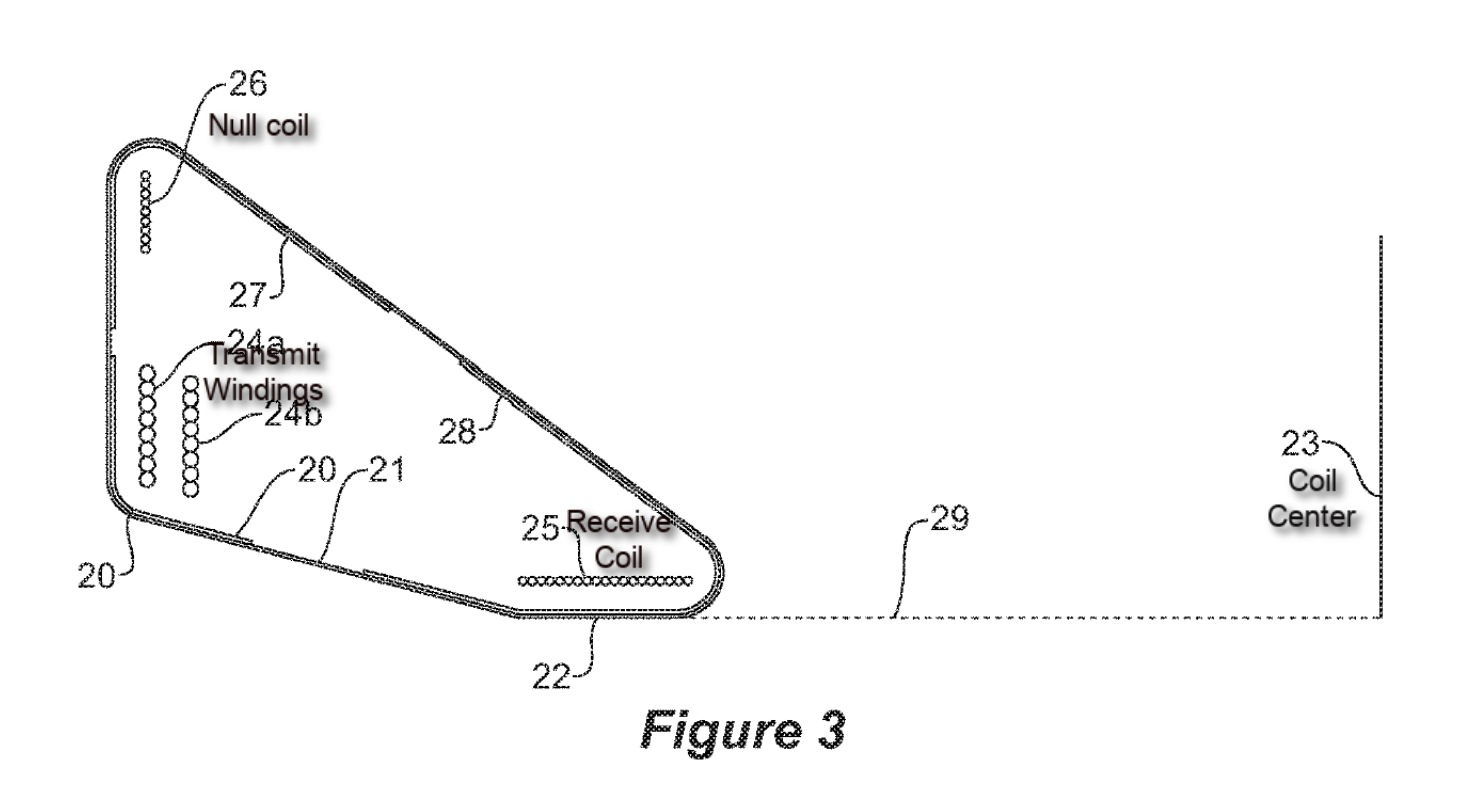

                          This is also interesting. Figure-3 coil configuration.
                          Click image for larger version  Name:	Figure-3-Coil.png Views:	0 Size:	200.2 KB ID:	446302 If the flux area of the RX coils 25 and 26 are approximately the same, a good EMI cancellation is possible. Note, there isn't any real TX bucking coil.
                          TX bucking coils do increase the coil weight (more copper) and weaken the total magnetic field emitted. So the IB is achieved with a second anti-phase RX coil (26).
