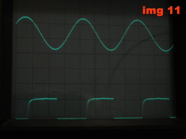

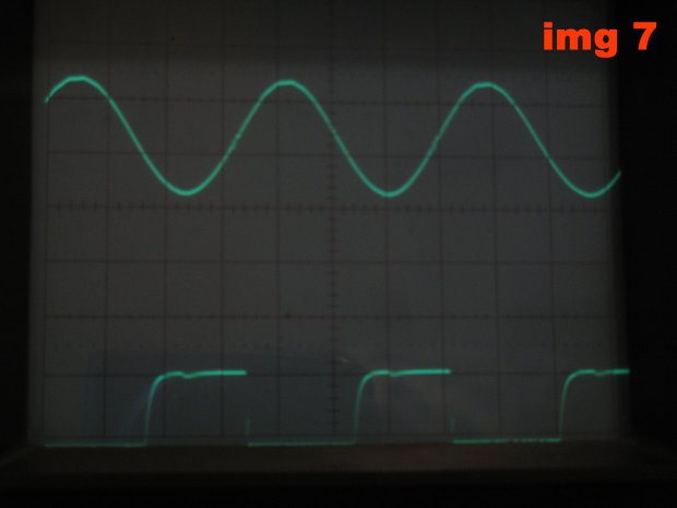

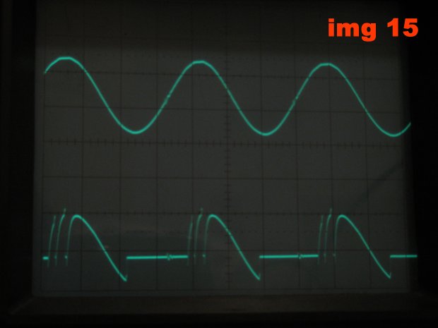

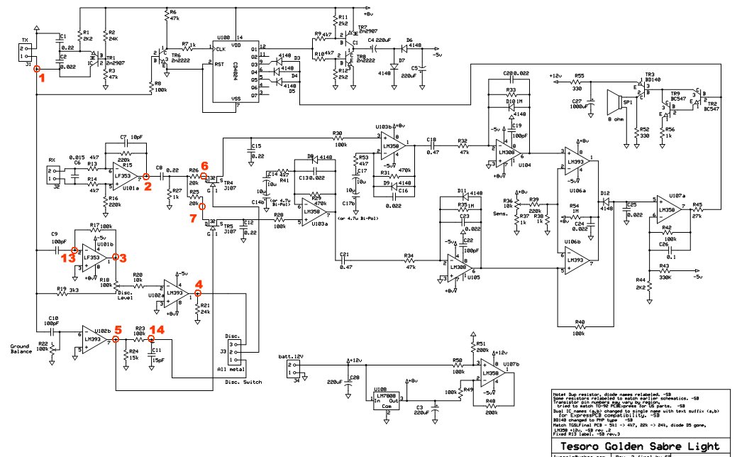

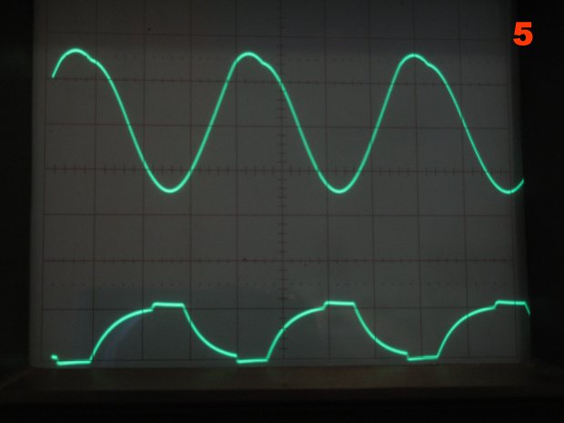

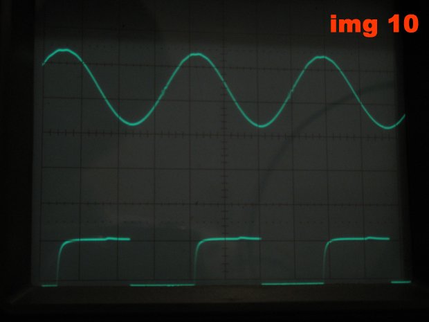

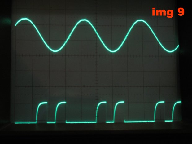

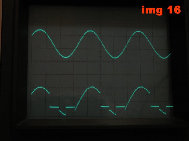

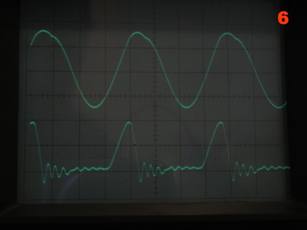

Well, this is my situation:
The circuit basically works, I mean that it detects metallic object but there are often chatters (cracks, noise) and iron is detected in both discriminating and not-discr. switch position.
The coil being used is a Laser Widescan 8" coil which I bought as faulty on internet but: I checked resistance and impedence and seems to be correct. At the beginning I noted something wrong in the resistence value so I opened it and found that it was intentionally center tapped, I've removed the center tap and got a standard values coil.

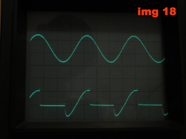

The first picture attached is the signal I got from the coil: it is driven by the TX stage but the RX is connected just to a 1K and 15nF in parallel, not to the circuit.
Scope setting is: Ch1 (upper) 5V/div Ch2 (lower) 10mV/div timebase 20us

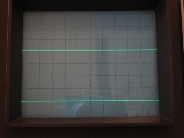

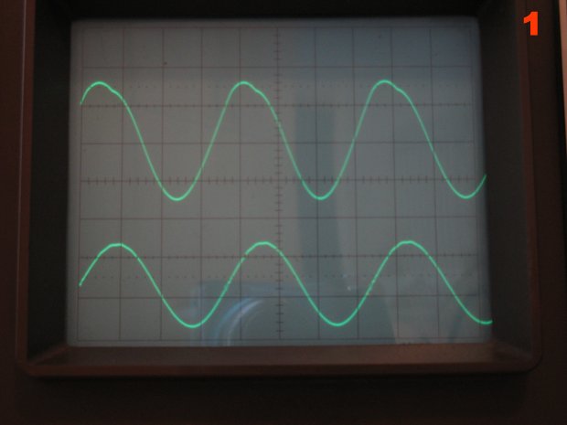

Second picture is the scope 0V trace position

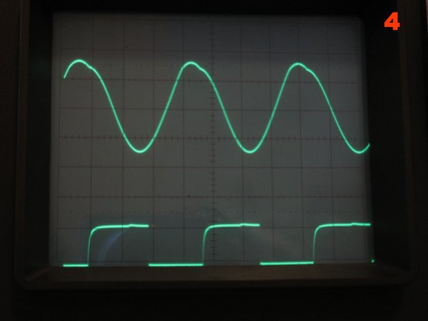

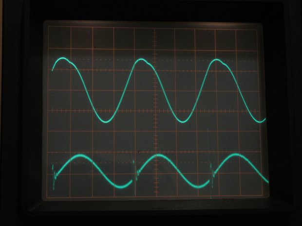

Third picture is the output of U101a (pin7), setting is: Ch1 (upper) 5V/div Ch2 (lower) 0.5V/div timebase 20us
Now, I got about 13.8 KHz at TX. It's not correct. How change it? Should I decrease C1 or C2 (I think C1 but I noted that changing any of them gives result... so it's just to be sure....)
Then what if, in future, I 'll make my own coil and got a slightly different impedance? I mean: is it so important to get exactly 14.5-14.7 KHz (I can measure it at the moment only by the scope signal shape period, and it seems 72us...).
Then, should C6 be tuned? if yes how to proceed?
...and this just to start.....
