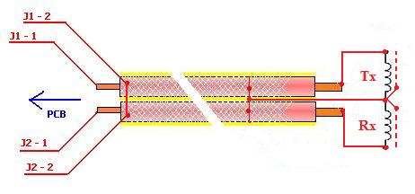

        Playing around with two shielded coils and null at LF353 output pin 7...
        6 foot USB cable... only Tx J2-2 wire and cable shield grounded at PCB.
        With Rx J2-2 wire, Tx J1-2 wire, cable shield connected at coil end of cable:
        1. No coil shields connected -- null = .3V pp
        2. Tx shield connected to grounded wires -- null = .4V pp
        3. Rx shield connected to grounded wires -- null = .25V pp
        4. Coil shields connected to each other and to cable wires -- null = .2V pp
        5. Coil shields connected to each other, but not to cable wires -- null = 6V pp!!!!!!!!!!!!!!!!!!!!!!!!!
        Coils were re-nulled for each test.
        Air depth hard to test due to noise and loose coils, but seemed fairly same regardless of shield connections.
        Test 5 very hard to understand, will check some more.
        -SB
        Yes, I can confirm your observations. Deepest null achieved with configuration #4
        If I read everything right, this is the choice that Tesoro uses as well.

                The use of coaxial cable does not make sense here. It does not matter that the hot wires are in the middle, so the circuit and closes the top, although the balance.
                The measuring technique used two separate wires from each coil above the common screen or two coaxial cables for each coil, it is equivalent.
                Coils connected together in one point, and nothing more.
                At the top of braided coaxial cables together at one point to GND on PCB. Braided coaxial cable is not connected to anything at the bottom.
                A separate simple (in isolation) data cable between the point GND / PCB at the top and bottom shield.
                Then there is no possibility of countervailing currents.
                It works well in the UHV technique, and MD / PI also have high di/dt.
                Best regards Chris.

                  UHF and MD have only a theoretical resemblance. If you to be used by your recommendations in practice, you will see that it will not want to do. The basic problem is that you do not understand the essence of metal detectors. The picture I posted is a proven method that works for a long time in the real field. I found a lot of money, the detector is very stable and I am proud to make changes and updates that I did. If you did something you can practically give the presentation here on the forum. Theory, unless supported by practical testing, it makes no sense.
                  P.S. This picture does not show coaxial cable !.... You'll carefully read the previous posts

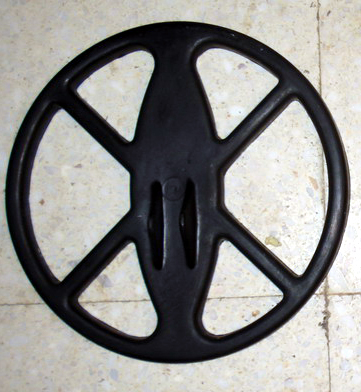

                      DD coil, diameter 27cm. 0.27mm wire
                      RX = 6.5mH, 21-23oma (107 wires)
                      TX = 6.0mH, 19-22oma (98 wires)
                      "D" shape size 255 * 137mm
                      Both Rx and Tx coils were pinched synthetic thread and then taped with super glue. Over this is a layer of insulator strips, a layer of Al foil - self-adhesive - and the final one more layer of insulator strips. Both coils are adjusted and tightened the plastic body with epoxy resin and then pour the Polyurethane-insulation , the body of the coils final closed with reinforced fiberglass.
                      Way of connecting with a cable I gave in previous post # 304
                      In this way, I got a coil with good electrical, mechanical and thermal stability. Coil is lightweight and does not change the characteristics of different weather conditions.

                            Well, your 304 posting certainly looks like coax cable - I don't know of a flat braided cable. In any event, the wire that feeds current to the Tx coil is also part of the RX circuit and will cause a voltage drop in both circuits due to the resistance of the screening wire. The Rx current introduced in this way will be in phase with the Tx current so overall the circuit will act like the coils are overcoupled. Obviously, you take care of that when you null the coils.
                            I wouldn't mind betting that if you separated the screens along their length and only connected them at the PCB, you would need to null the coils again - but the screening would be just as effective.
