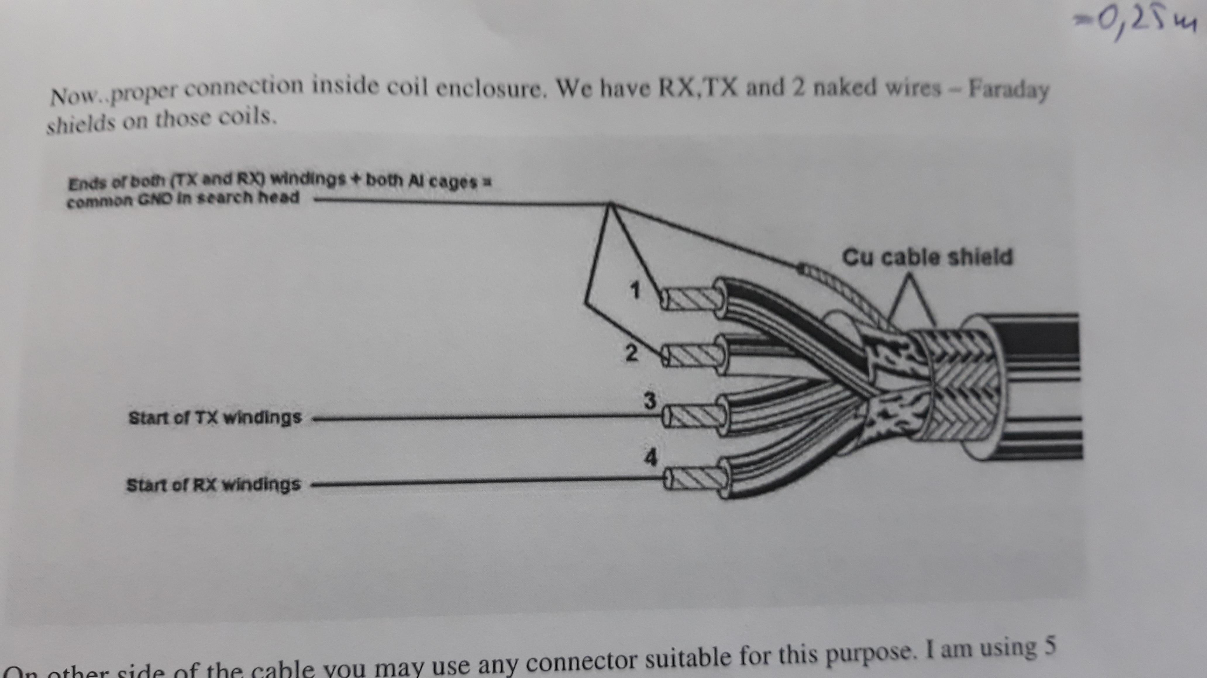

            • Hi,
              Is correct to connect a pole of Rx coil to ground, like in picture attached?
              Thanks.
              • Originally posted by vas View Post
                Thanks.
                I did connect ground like in the picture. You do need to experiment to find if it is better or not with ground connected.

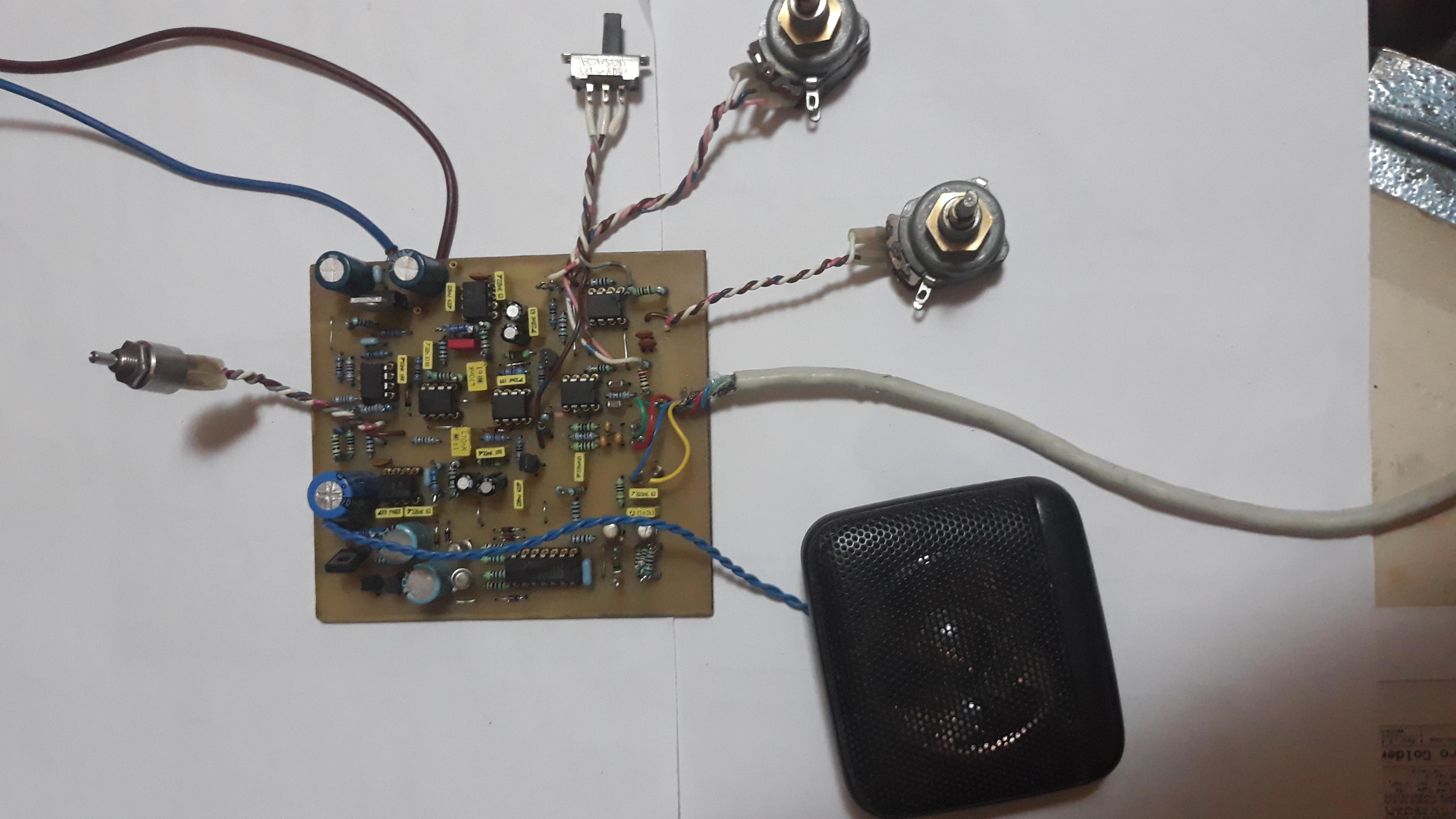

                      • Hi everyone,
                        The synchronous detectors work very well and extract the useful signal from the noise. This is my experimental model, it detects 1euro from 32cm, it discriminates and large targets are also detected from 1m!
                        I'm trying to make a reproductible printed circuit in China and maybe change the sound. Thanks to those who made this interesting experience possible.

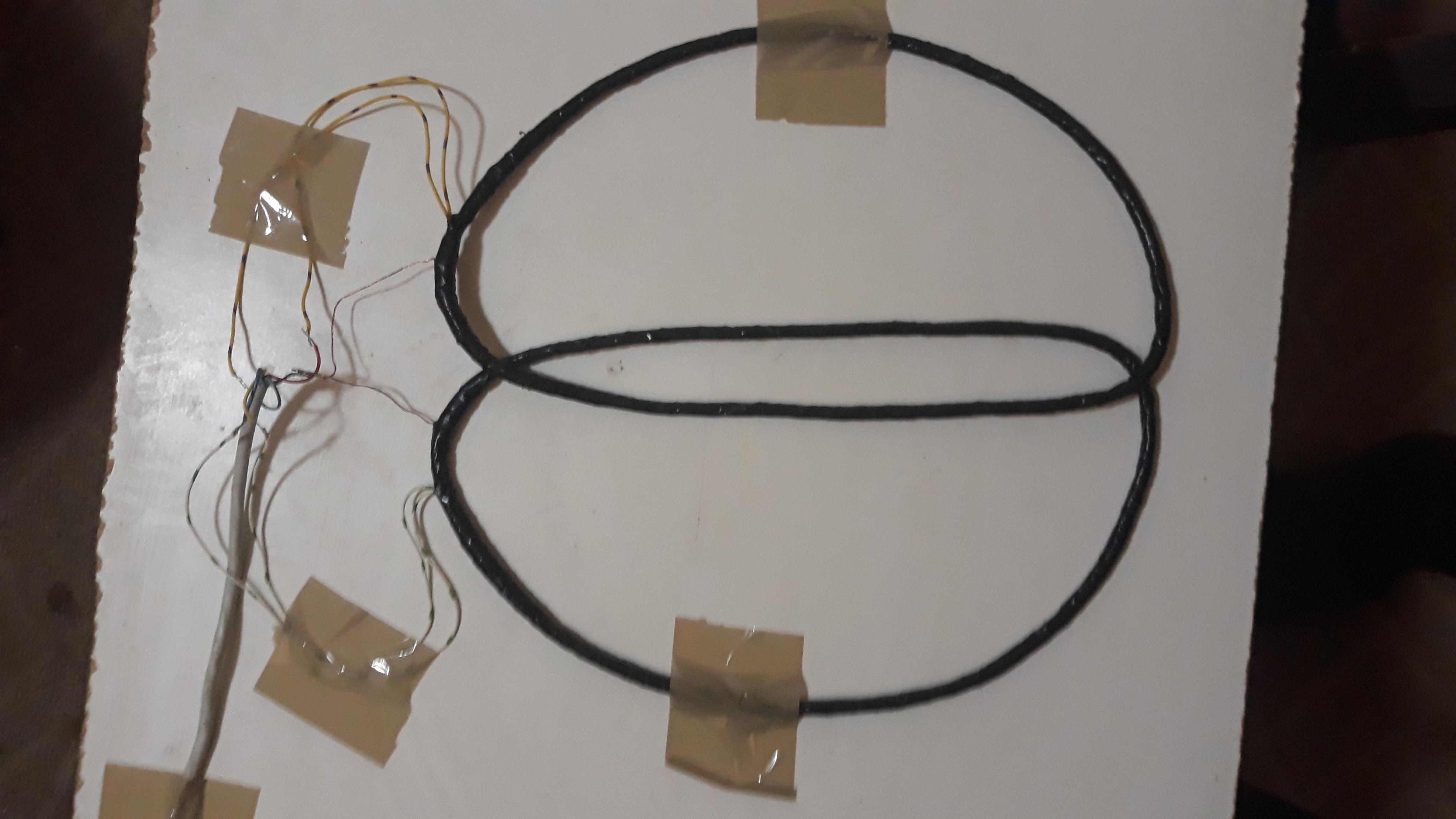

                        • One doubt about the ~30cm distance for a 1 euro coin, is this value usually got with coils shielded or unshielded? What position of ground balance pot? I'm asking this because I'm testing nulling the coils without shield (because I want to put the graphite in the coil shell later). Thanks.
                          • The tgsl detector has always been my favorite! I think I've built about 15 devices so far. The inductances never worked for me. At the time of winding they were correct, but after tightening them with insulating tape and applying aluminum tape they always gave different measurements I always adjusted the null of the coils by testing with different metals
