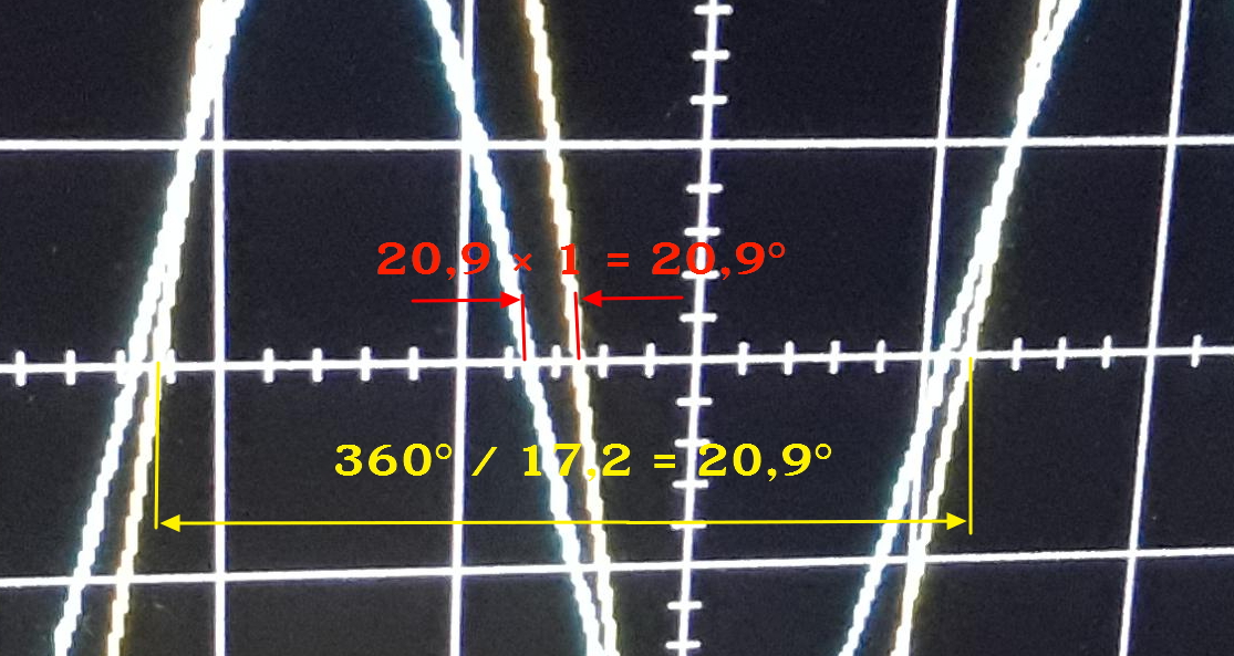

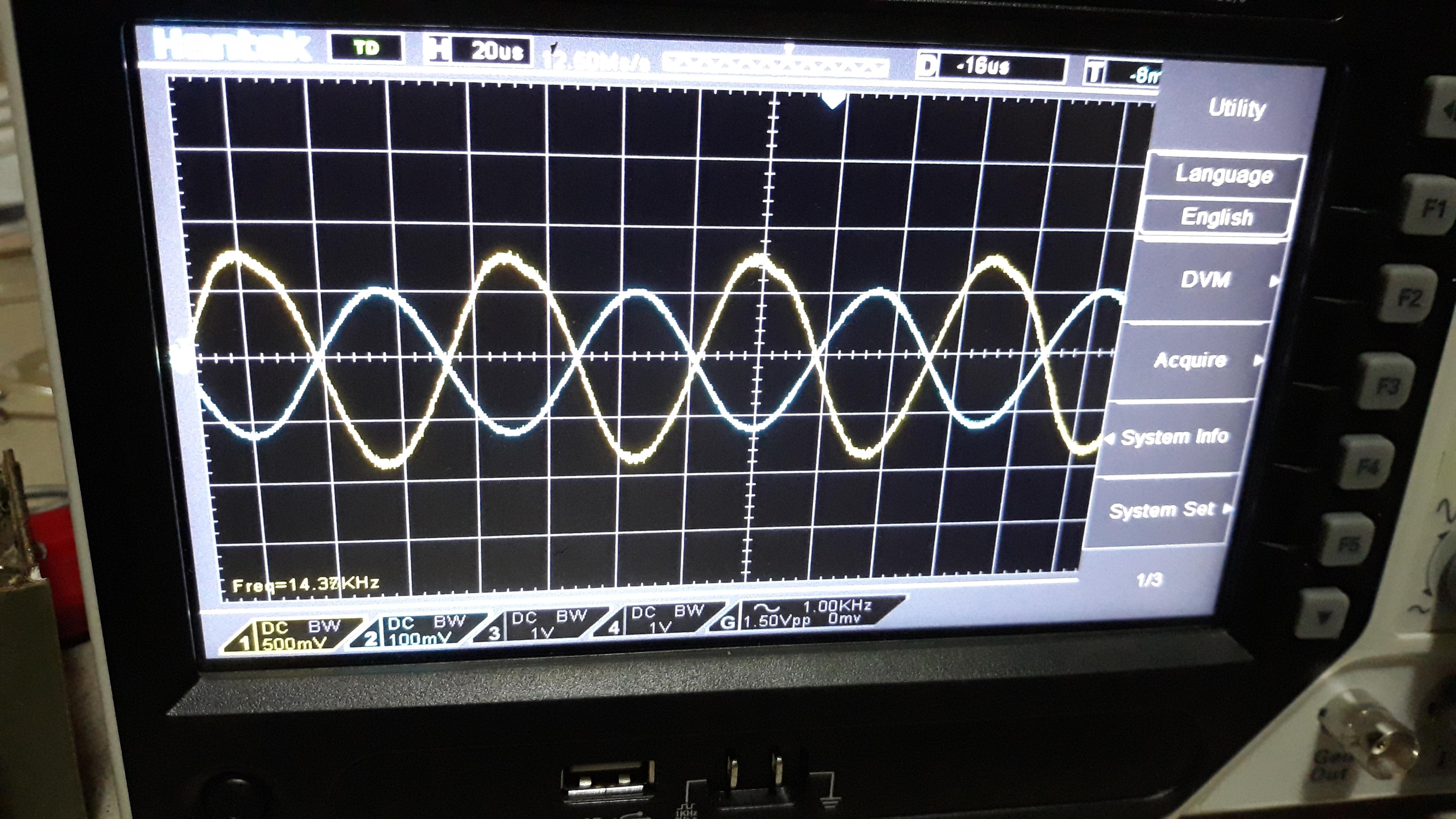

                      I promise I will read the pdf document very carefully. These are the signals Tx and U101, pin7. I think I need to change the phase of the Rx coil, right?
                      • Channel Tx is 1:10, channel U101 pin7 is 1:1.

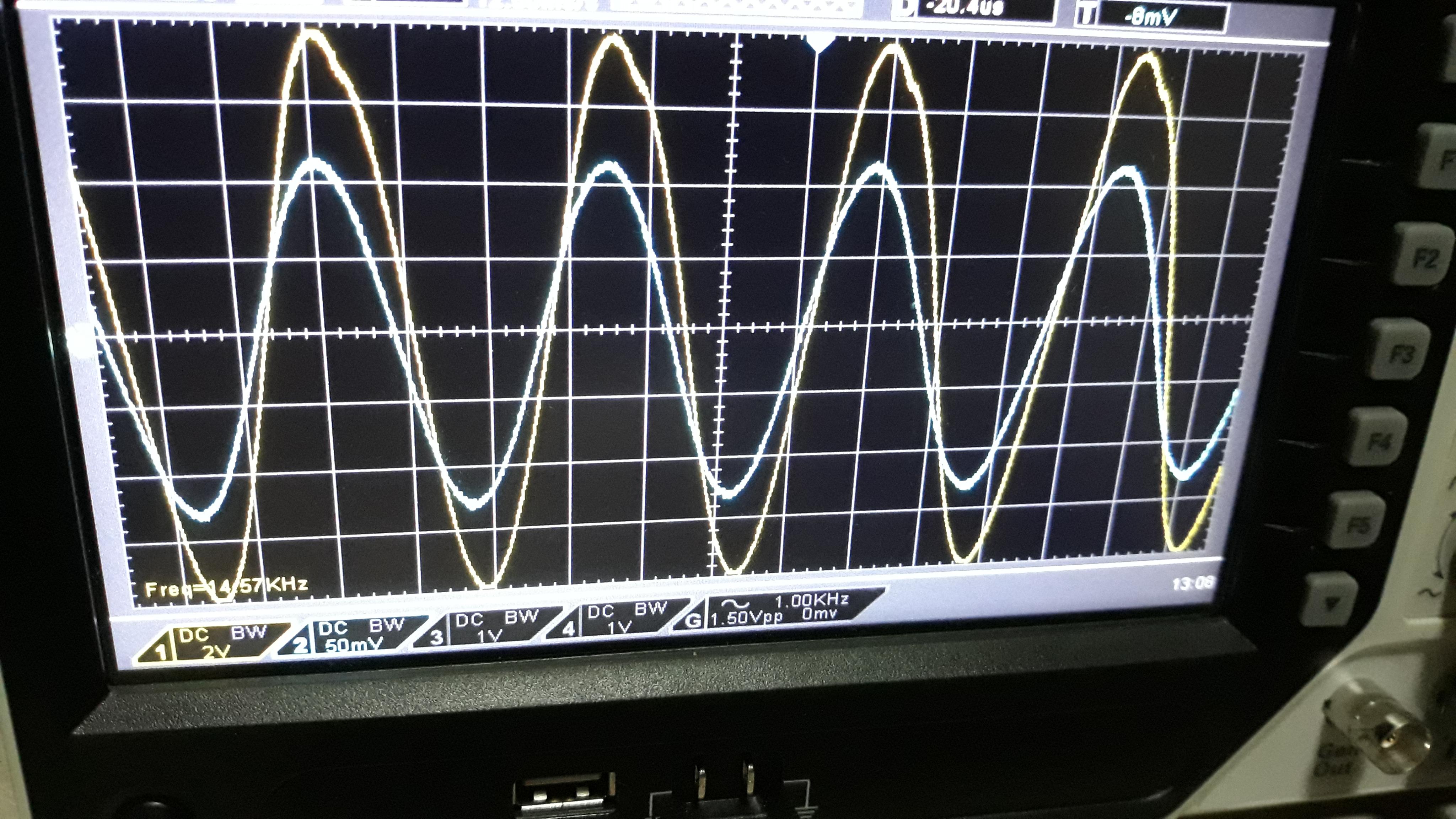

                        • Hi Waltr,
                          These is new Tx and U101a pin7 waveform. Is it ok with the phase shift between them? Unfortunately, the voltage at output U101a cannot drop below 200mV a.c.
                          Thanks again.
                          • Normally
                            • Last scope images look good. The first had a 180? shift which is usually fixed be swapping the RX coils leads.
                              I'd say it is time for you to put more parts on the board.
                              Next check is the JFET switch driver (gate) . Then the RX op-amps.
