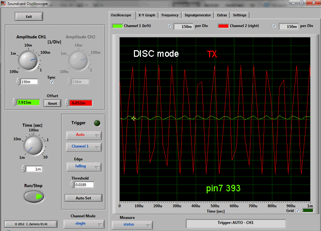

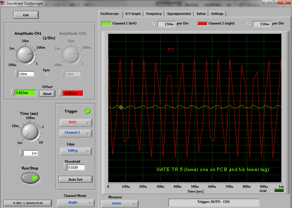

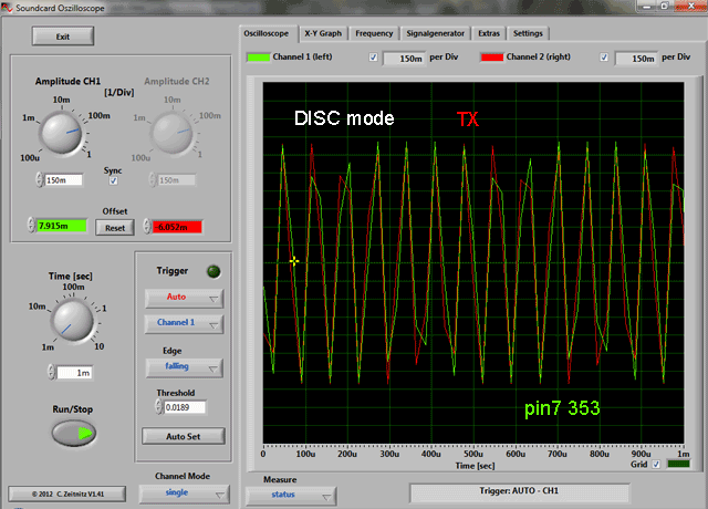

  • two more for Simon
    TX and pin 7 on 353
    TX and pin7 393
    • Thanks, those graphs are better for comparing phase -- although we cannot trust the scope too much because of bandwith limitations. I'll try to compare them to some graphs of a working TGSL -- there are photos on this web site that should help if we can locate them. I have been busy lately and forget where they are.
      We will continue to think about what may be wrong. Sometimes making a different set of coils solves such problems, although these coils should be capable of working.
      We will continue to think about other tests to perform. If you can somehow get a real oscilloscope, it would help greatly.
      -SB

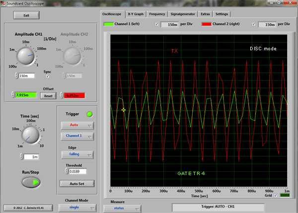

      • tx and gate TR4 and TR5 in disc mode

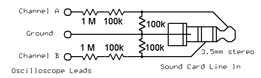

            • arranged probe like this and still doesn't stop beeps from MD...
              maybe 1M should be between GND and signal ?

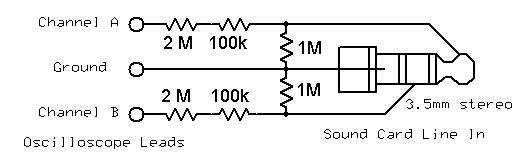

              • new configuration stops beeping (it doesn't start with more resistance)
                EDIT - tried one more combination - one channel scope 4 M + 100k ...
                stops it and until it is disconnected it don't start beeping again
                • Simon,
                  it took 9M ohm resistors to stop it and it continues to beep after that connection... slower rate of beeps

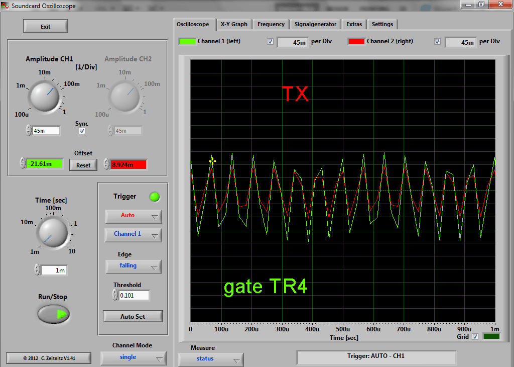

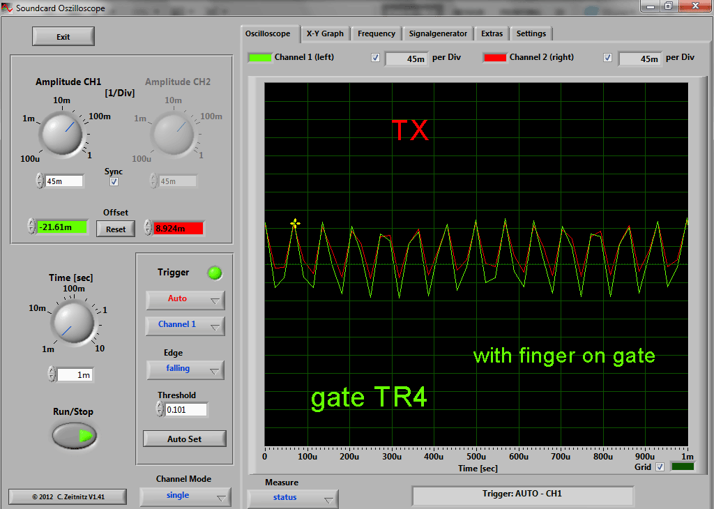

                            • "oscilloscope" is connected with tx and gate of tr4
                              all metal mode - beeping - probe has 8 M Ohm + 200k resitors (both channels)
                              with finger on tr4 gate and without
