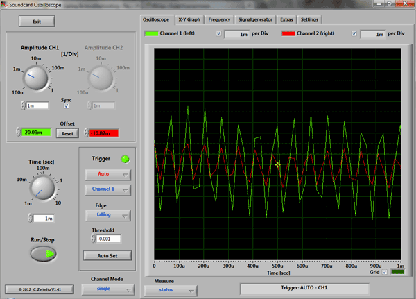

          • Originally posted by sdesic View Post
            "oscilloscope" is connected with tx and gate of tr4
            all metal mode - beeping - probe has 8 M Ohm + 200k resitors (both channels)
            The phases look wrong to me -- 180 degrees wrong. I was measuring same signals on a TGSL I have and when the TX signal is high, the gate of TR4 is low.
            Are you sure you are measuring the correct test points?

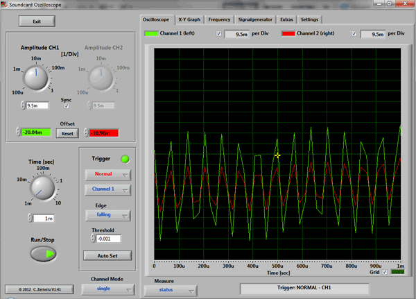

              posting two more screenshots
              probes connected with 8M ohm + 200k ... yes MEGA OHMS
              to gates of TR4 and 5
              point of contact are J3 2 middle point of switch and LM393 U102B pin 7
              and another screenshot when I touch wire connecting to TR4

                  • Can we see the gate signals to both FETs, maybe at the same time? What you should have is two approximate square waves that overlap depending on the DISC and GB controls.
                    If there is any question of your scope's ability to display signals because of bandwidth, the input to the CD4024 should also be an approximate square wave with the same frequency. CD4024 pins 12, 11, 9, 6, should have square waves at f/2, f/4, f/8, f/16, respectively. Compare the edges of those signals.
                    The amplitude of gate signals should be approximately 3/4 that of the CD4024 outputs (but the signals will not have the same DC level, and they might not look quite so perfect as the 4024 outputs should look).
                    If you do not have a frequency meter but can measure the period of any of these signals, you can calculate the inverse of period (1/P) and multiply by the appropriate ratio to determine transmit frequency (in case you're wondering).

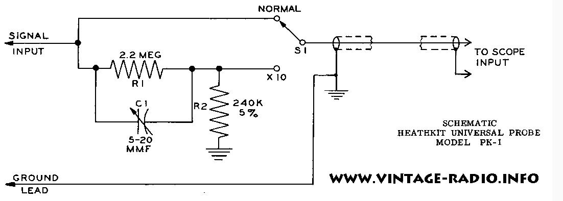

                                When you attach the leads via the potetial dividers, you also need a ground connection - or screen gound - this will take the huge mains hum away that is modulating the traces
                                S
                                How can I do that ... two channels are connected to PC line in of audio card ... both channels GND are connected to TX GND
                                PC is making so much noise in this mangnification.
                                I was trying connecting capacitor in signal serial to resistor but I don't know if it changes graph ... AD... DC ... something
                                maybe this kind of probe ...
