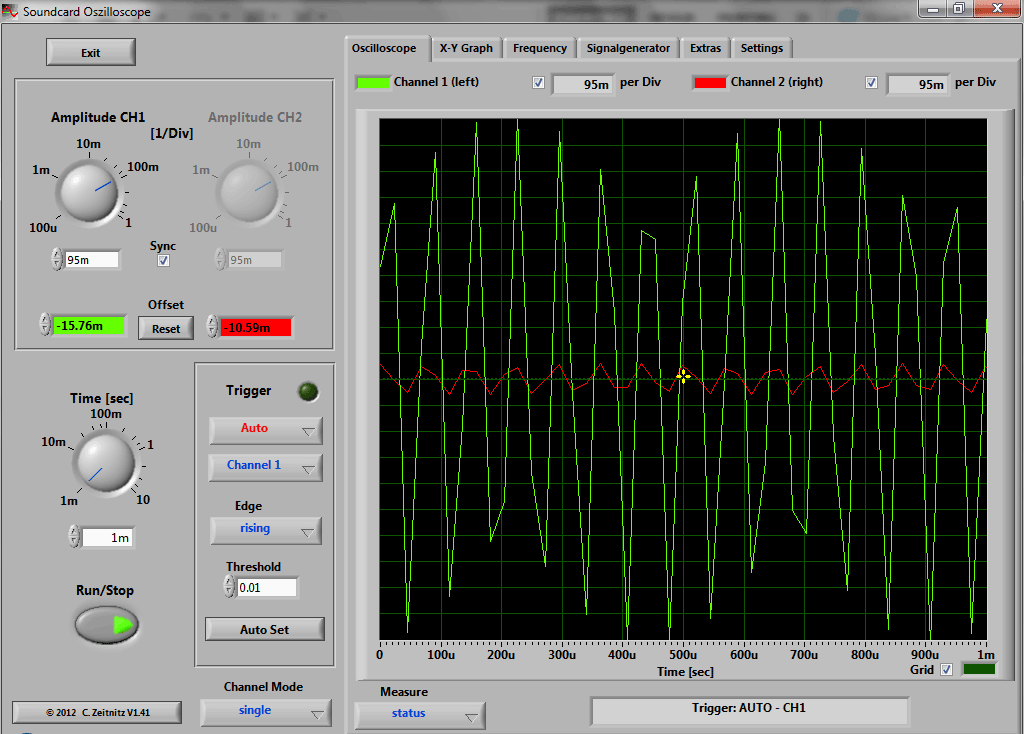

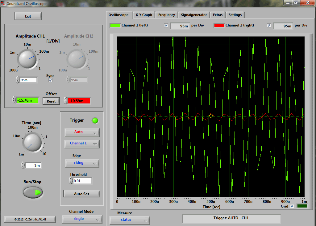

      Those gate signals look like severely anemic. But, they are consistent and I am unsure about the capability of your scope. Maybe what I should have asked more directly is: (in DISC mode) how does either gate signal look in a side-by-side comparison to the signal at CD4024-1?
      • porkluvr,
        I have made screenshots of Disc mode TR4 and TR5 separately vs pin1 4024 (green on both)

            One channel scope is almost useless for most metal detector troubleshooting, since phase relationship between signals is so important to many functions. But it will tell us the shape of signals, which can be useful to see distortions.
            If the scope has an external sync probe, it can be used for phase, but with great difficulty.
