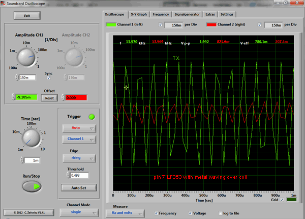

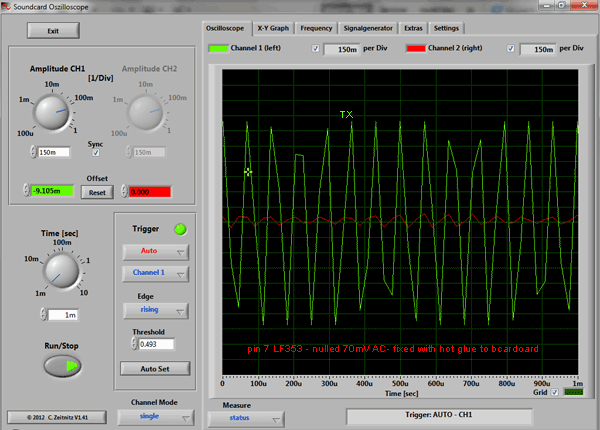

    First we need to see your TX signal (J1-1) and RX amplified signal (LF353 pin 7) on your oscilloscope as two traces with exact same channel settings.
    It is still possible that the large voltages are normal for the RX signal you have -- if you are quite far from minimum null.
    Otherwise, we will look for a short or bad part somewhere.
    -SB
    • TX signal (J1-1) and RX amplified signal (LF353 pin 7)
      on 393 pin 7 -6
      on 358 U103 pin 1 -6.1V
      pin 3 -5.99V
      pin 5 -5.96V
      pin 7 -6.10
      voltages are changing from -5.95 to -6.11
      I have nulled coils on pin 7 of 353 ... about 60-70mV AC

        Excellent work -- Your traces of signals of TX and LF353 pin 7 look OK -- pretty standard.
        It now seems that the problem must be some connection to your negative rail somewhere that is causing these bad voltages at the LM358 inputs.
        1. Try removing the LM358 chip (if in a socket), and test those DC voltages at the same pins again. Then try removing the LM393 chip also (if in a socket) and test voltages.
        2. If still get -6V on those pins, probably need to check your traces for solder bridge or something like that.
        3. Have you posted good photos of top and bottom of your PCB? If not, can you do that?
        -SB

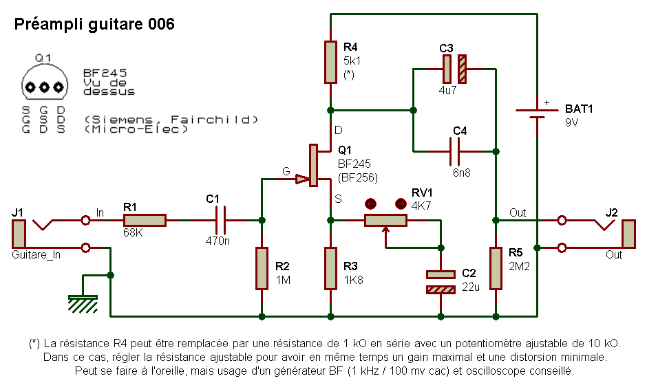

                            Thanks, that tells us something -- problem is not a bad LM358 (at least not entirely).
                            I am wondering if your JFets TR4 and TR5 have wrong pin assignments. I think there is a difference between European and US parts, not sure. In any case, it is worth carefully checking which pins of your JFets are the S, D, and G leads, and making sure installed correctly. If improper, they could have been damaged, maybe, or at least could be passing the signal from LM393 pin 7 to capacitor C12 and charging it negative through a diode. If in ALL METAL mode, same could happen to C15.
                            1. Another quick test -- switch to DISC mode and check DC voltages again, and see if U103 (LM35 pin 3 is still -6V, or if it is near zero. Might as well keep LM358 out of socket for test.
                            -SB

                                I just found one schematics that confirms your claim that EU, US and OTHER BF245 are not same pinout
                                I have not placed it by not looking at few pinouts myself ... and on PCB there is printed placement to right
                                it can be that it reversed or switched legs ...
                                don't know which is which ... where from silverdog bought these ...
                                marking for producer is FBG 62 or 82 BF245B
                                I am going to desolder them and try to see if they are blown and to try MD without them
