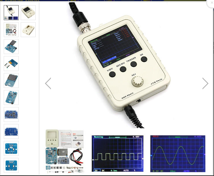

  • LOL, Dang man. Just buy a DSO and get things done.
    You can use it to monitor you heart when you find the first gold ring.!
    • I already know this thing and it has only one channel.
      How can i use it to make my coil?
      And which testpoints at the board should i use to connect it?

        If it doesnt work then i will use my Multimeter or i will buy a dso and sell it after that but i saw that the dso are only 1 channel oscilloscopes.
        I think i will need 2 channel for it.
        Can i see the 20 degree lagging?

        One channel - is better than no channel. You will see exact frequency, residual voltage and it is enougn. There is only 20 and 200°. If you have overlap, you have 20°, if you have underlap, you are on 200°. I can shoot short video on this in the evening... Also you can see if there is geb, dics with shape which it should have. Check frequencies CD4024 and so on. Better than nothing anyway.
