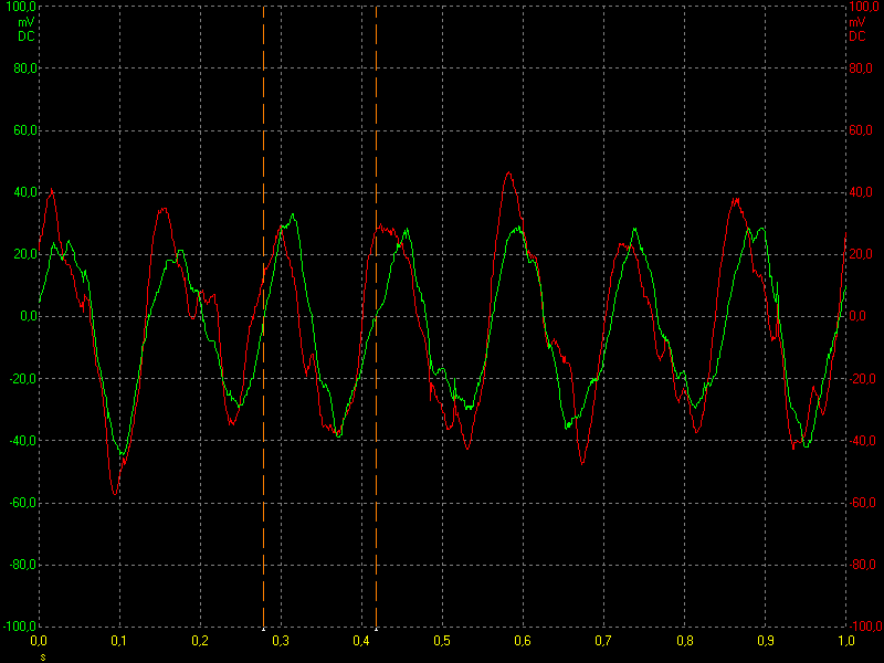

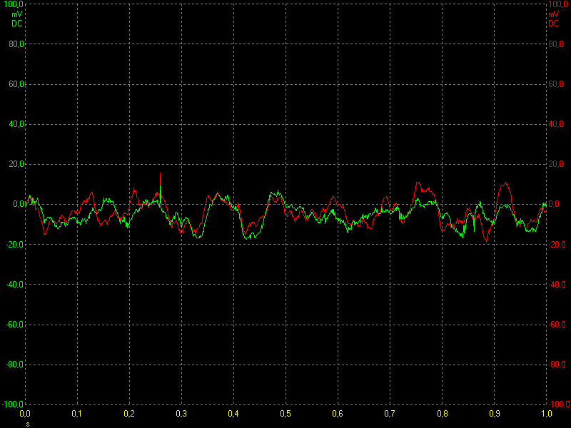

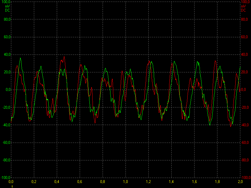

                  Hi MD107 ,
                  Perhaps another thing to check is to get away from all indoor noise , go outside far way from all EMI sources !
                  You would be surprised !
                  In my case the noise in my house is very inpredictable and the noise average is around 30 -40 mV top top (I think it's too high) , even in my garden [10 meters away from my house] there is still a high noise ...
                  I have a small advantage of having an USB scope ; here is an example of noise measured on the outputs of the LM308's.
                  Please note that in my case ( the TGS ) the system starts to crack around 25/30 mV top-top and starts to alarm around 40mV t-t
Name:	animatedgif noise .gif
                  I even caught 'motorboating' in a graph : due to the inpredictable noise you get 5 or 6 alarms a second continuously ( in this specific example)
ID:	329321 Click image for larger version

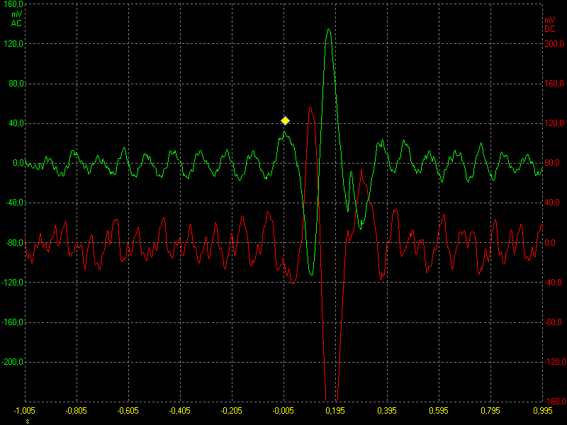

                        I had the same problems with my Aluminium shielding : I was trying for ages to get everything right .
                        When I tried the Mylar shielding( as DFBowers decribed in his manual ) lots of problems disappeared ... , don't forget the naked wire .
                        So all credits to DFBowers !!! Mylar should be the material for shielding !!!!
                        The TL071's I've tried didn't have a big difference compared to the LM308's under workshop conditions .
                        The conditions you've described for shielded- and unshielded coils match with my experience ... but the only the shielded coils do matter ( less sensitive ( to noise) ).
                        The chatters you have in AM mode are still there in DISC mode but most likely they are nulled like in this example were also the target presented is disc'd out or nulled:
