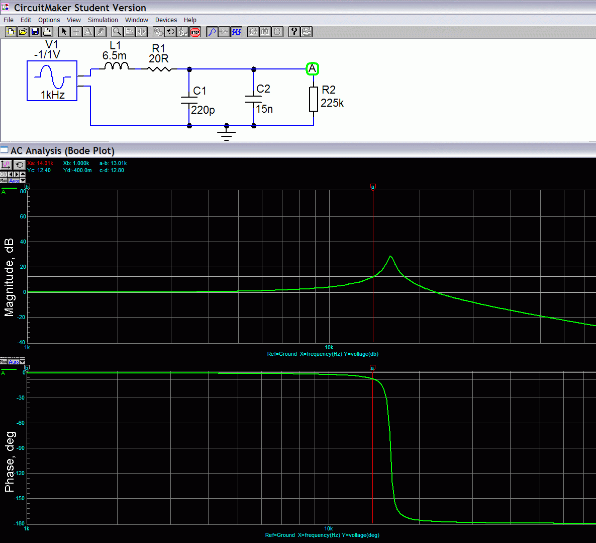

    Unfortunately the only simulator which I'm able to use is CircuitMaker. I'll try with it a.s.a.p., however I'm not saying that the +20° phase is not achievable, but that to get it I'd have to use cap values much too far from the prescribed one and with that the circuit dos not behave well anymore in all its aspects.
    Stefano, the CircuitMaker makes it correct:

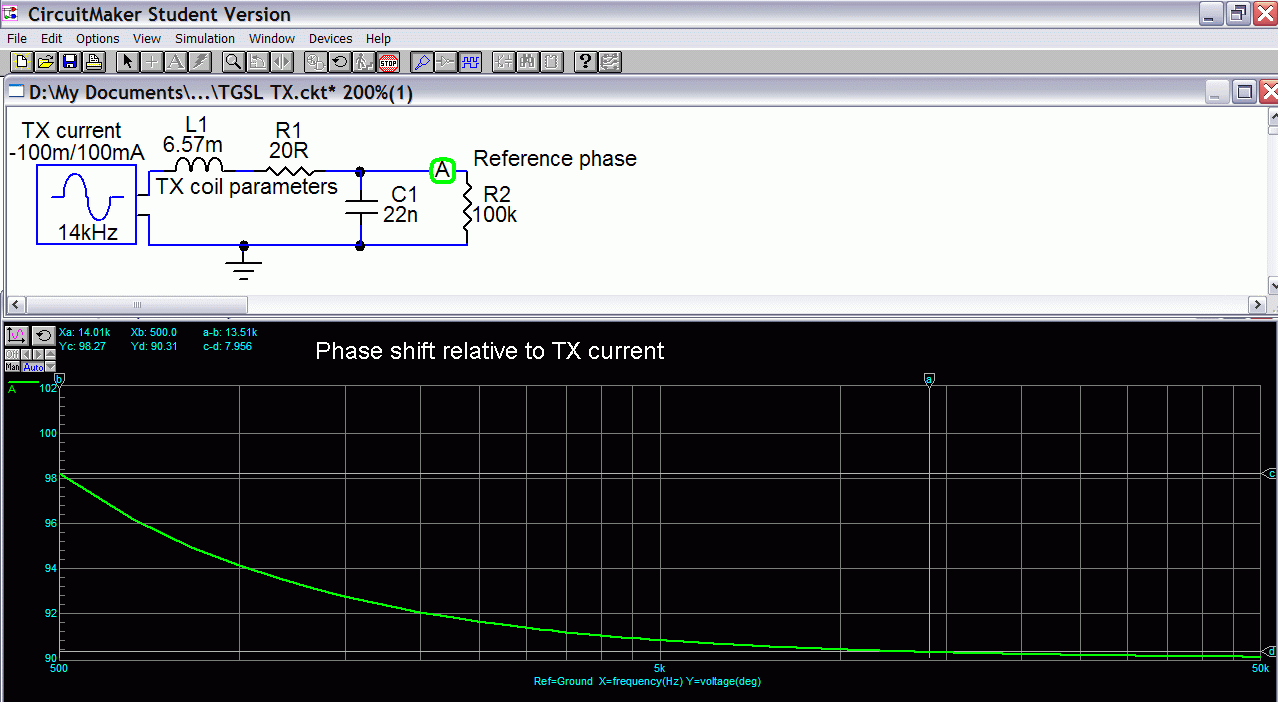

      • Phase shift in TX tank circuit
        This simulation shows how R1 and C1 cause phase lead in reference voltage. In ideal case (without energy loss in TX tank circuit) the reference phase should be 90 deg, ie the same as the phase of electromotive voltage E induced in the RX coil (see posting #376).
