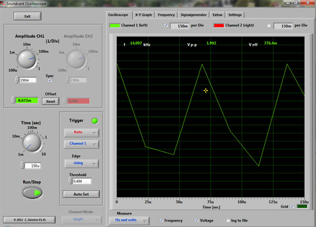

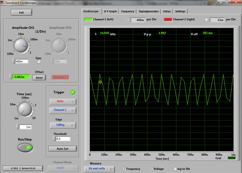

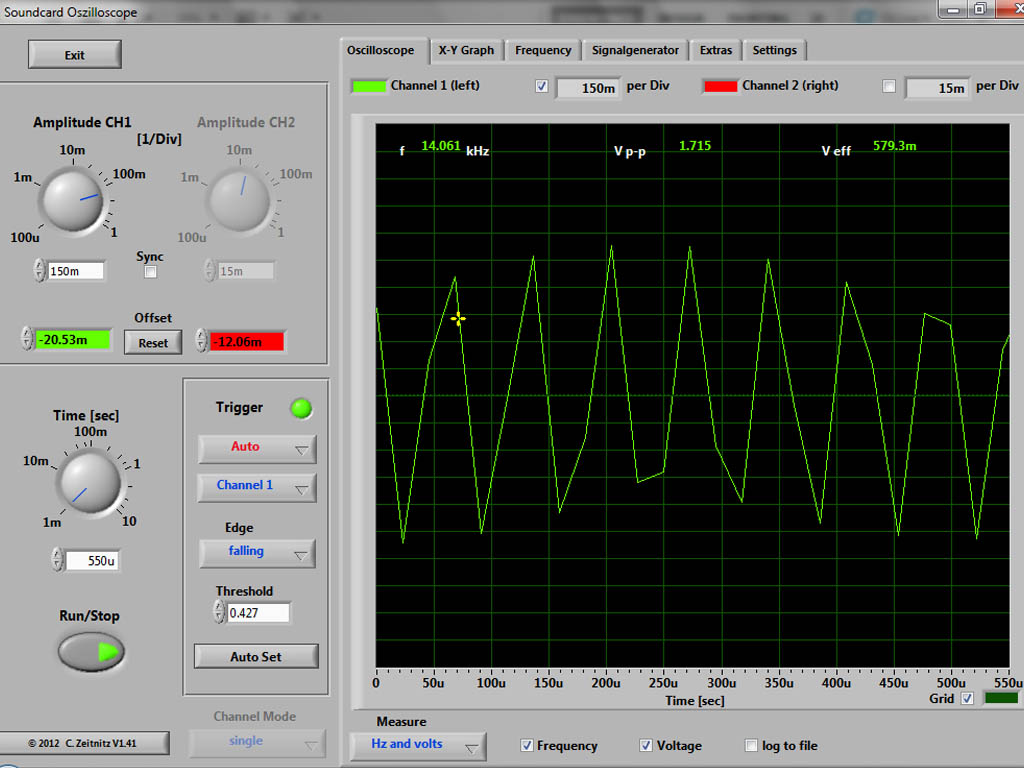

  • Two scope screenshots TX signal
    Difference is time scale
Name:	scope tx 2.jpg
      You must find points with low impedance to avoid loading your device with a long cable and low impedance.
      Start with Tx, but make a 1:10 or so attenuator, just reverse the resistors as seen in http://www.ledametrix.com/oscope/
      Next connect a scope (with 1:1 probe) to output of preamp, and re-do coil nulling.
      The most important thing is to supply your device with batteries, as a PC PSUs are not famous for their isolation.

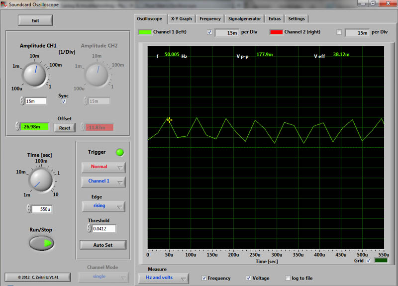

        • Made new nulling and got RX coil to get 2.1mV from starting 150mV
          BUT after that I can't stop detector from going beep beep ... 4x second
          if I flex coil it stops little and starts in few seconds again... pots are not responsive

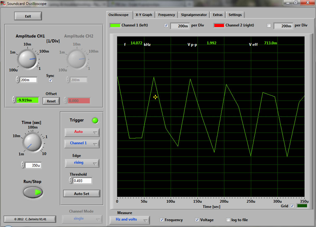

          LF353 PIN7 soundcard probe capture
Name:	scope pin7 and gnd.jpg

            • Originally posted by sdesic View Post
              Moved coils from that nulling point an it is working Ok again ... less depth but working
              From looking at your oscilloscope photos in #1126, you have a bad problem either with your test apparatus/technique and/or the transmit section has serious issues.
              Don't fool yourself into thinking #1126 is OK. That looks like nothing but noise.
              Fix your transmitter, and then you can worry about null.

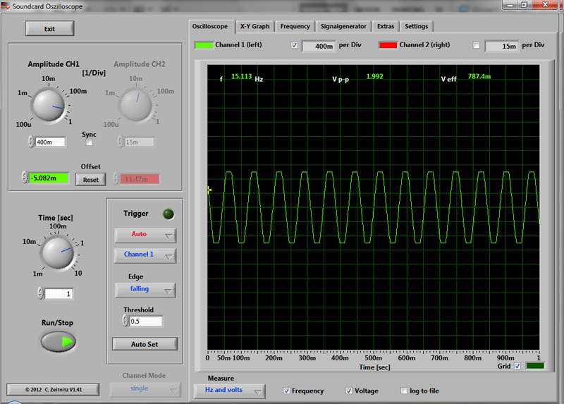

              • I don't know if it is my audio card oscilloscope or it is problem with MD.
                I will try second probe - with resistors only and post screenshot again

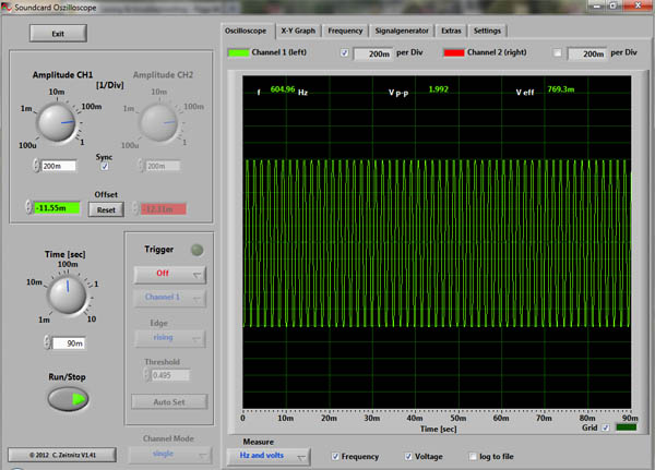

                • This is screen capture - sound card oscilloscope with 100k and 22k resistors
                  connected parallel to TX coil
Name:	without connection.jpg
                  and with nothing connected to it

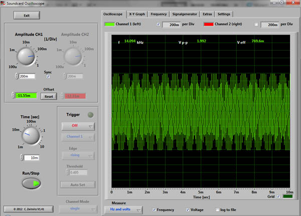

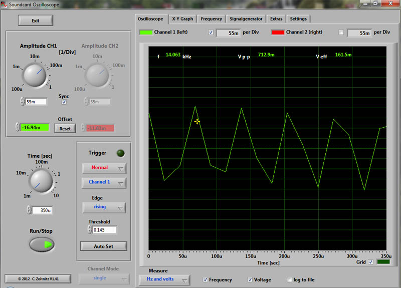

                  • Scope with pot and one capacitor - with short cable gave good results without signal connected
                    with connection parallel to TX - screenshot

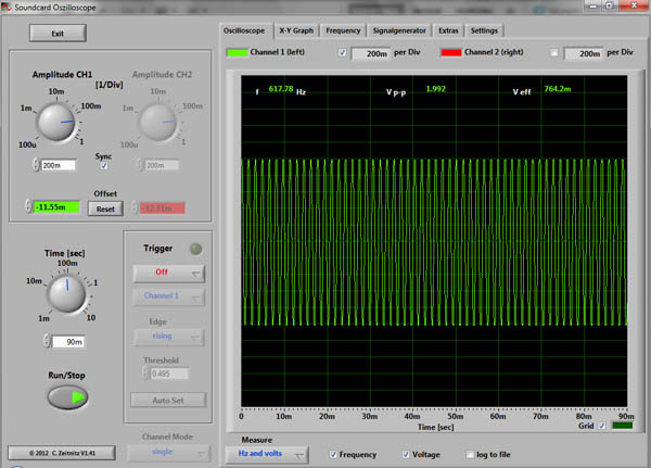

                    • and RX on pin 7 of preamp and ground
Name:	RX - pin 7 preamp.jpg
                      • same pic ... sorry about that
                        here it is again
Name:	RX - pin 7 preamp NEW.jpg

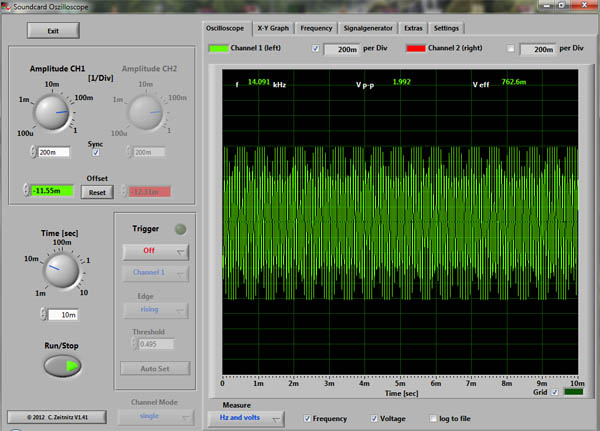

                        • You are mostly interested in envelope of the signal, so you may increase a time base to 10ms, or even 100ms and it will give you a somewhat less confusing display. This is a nice display of a signal sampled near Nyquist frequency, and there is nothing you can do to make it better with the existing soundcard. It would improve if your sampling rate is 96k, but it is unlikely that your soundcard supports it.
                          • Here are two screenshots 10ms and 90ms
                            • and two more from RX preamp point on pin7 LF353

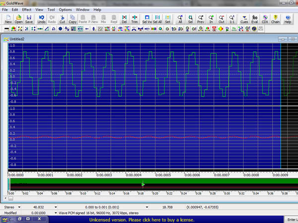

                              • If it matters here is one made in goldwave 96k sampling
                                it is audio software so I don't know what sapmle it is ... 9s or something else ...
Name:	goldwave 96k sampling.jpg
