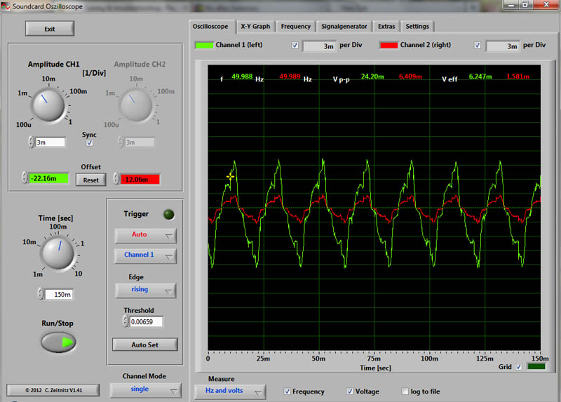

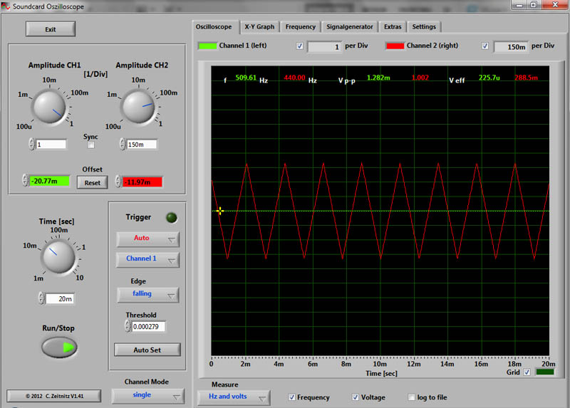

                            • Done first two and now I have some kind of scope. Soundcard scope.
                              Here is screenshot.
                              Fist test without anything connected
                              Tested output from speakers - loop - sound generator from this fine software
                              Triangle from signal generator
                              What to test first on MD ?
                              Where are test points ?
                              Looking at TGSL 101 from Don but don't know what are safe points for my audio card scope.
                              • You must find points with low impedance to avoid loading your device with a long cable and low impedance.
                                Start with Tx, but make a 1:10 or so attenuator, just reverse the resistors as seen in http://www.ledametrix.com/oscope/
                                Next connect a scope (with 1:1 probe) to output of preamp, and re-do coil nulling.
                                The most important thing is to supply your device with batteries, as a PC PSUs are not famous for their isolation.
