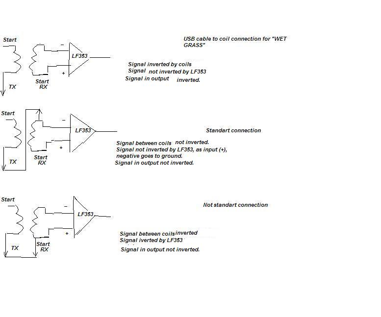

            I attach picture, which explains why i think connecting ground to LF353 pin 5, or pin 6 will give the same results.

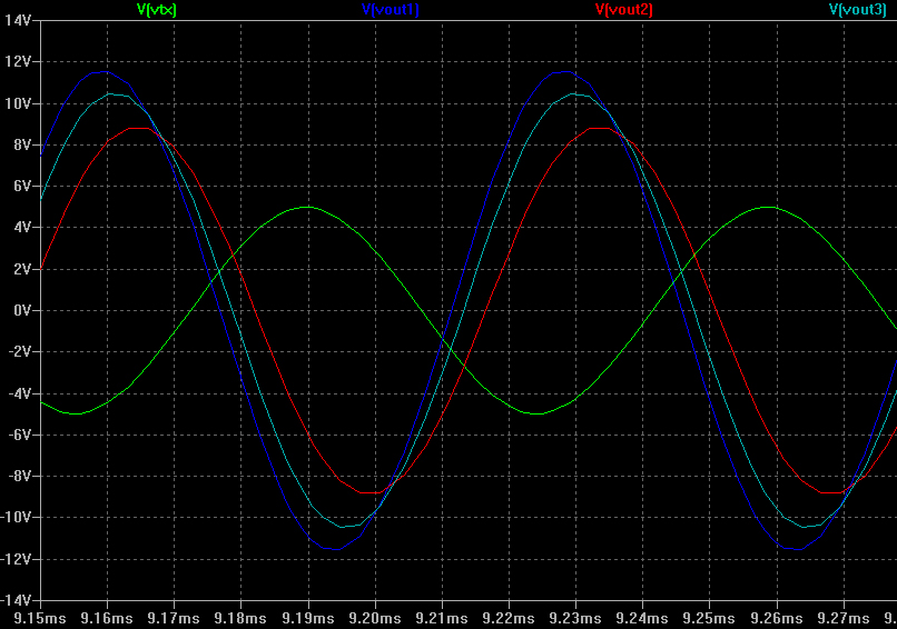

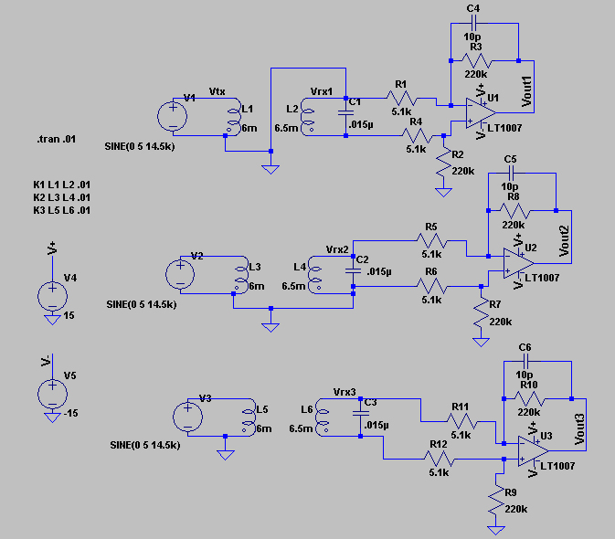

                      • Originally posted by johnsmith77 View Post
                        Interesting question.
                        I tried LTSpice simulation and attached photos shows my results. They don't match yours exactly. However, I don't know if correct. Did you try with actual circuit?
                        I can't explain slight phase shift between the cases; maybe due to different impedance of op amp inputs???
                        These waveforms are of course just the "null" signal, does not show how target signal phase would be affected if at all.
                        -SB
                        P.S. I don't trust this yet because I recall trying a similar comparison for dfbowers and did not see difference between his "wet" grass version (vout3) and the TGSL standard (vout1). So I need to doublecheck.

                                Tx and Rx coil are winded in ddifferent directions. Then Tx coil start is correctly marked in LTspice simulation, Rx coil start - not.
                                I agree with different phase shift, inverting and noninverting inputs shifts phase differently.
                                When i made mistake grounding lf353 non inverting pin, then coil rejects ferrite almost at min position. When grounded lf353 inverting pin, coil rejects ferrite at gb trim middle position.
